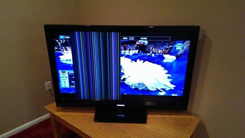

    Picked up this TV today and thought it may be a loose connection but that is not it. Can someone tell if it is the screen itsself that is bad?

        I've seen this before with Toshiba. Its a bad SMD connection on one of the surface mount components on the top boards behind the metal frame where the ribbon cables go into the panel. the problem would be associated on the left side board.

          Thank you for the reply. I will check on it this weekend. So will it just need to be resoldered?

            quite possibly first try lightly tapping on the components on that long board that spans half way across the top of the screen on that side and see if the picture comes back momentarily.
            be careful not to run it too long as you will overheat the driver ic's. just do it long enough to see if the picture straightens out

              I want to ask before I take it all back apart if there is a possibility that the problem might be the T Con board? What is the chance that it may be?

                This is not t-con problem, and most probably not fixable, go for parts.
