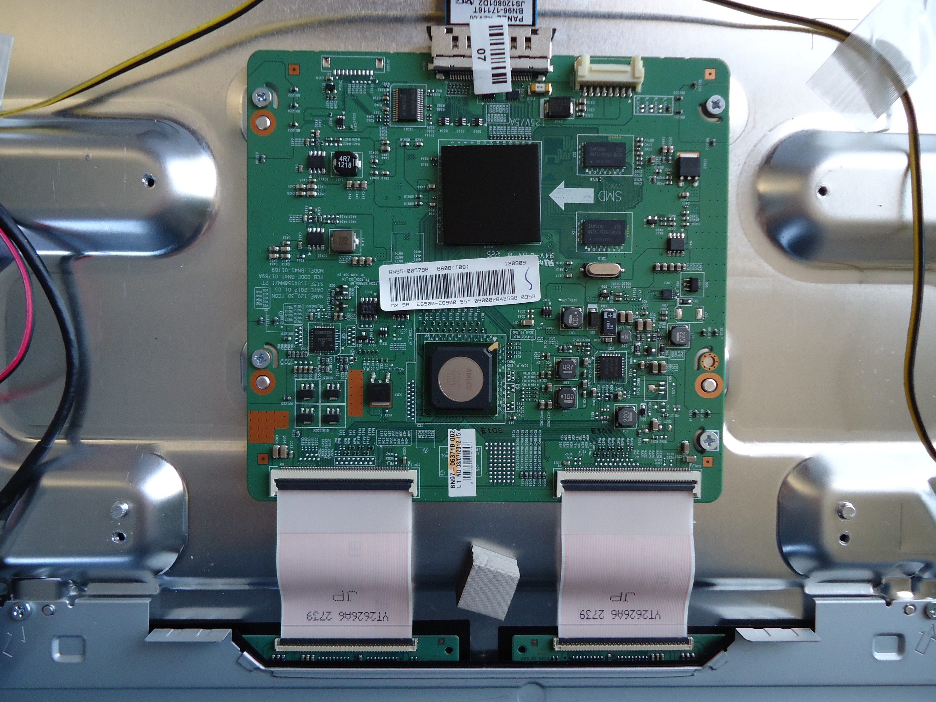

    This LED TV suddenly developed video problems while watching. Sound is o.k. Video is distorted and appears saturated and solarized with high persistence such that movement shows as a blur. This problem also exists on menus and the built in test picture and appears on all input sources including USB. I suspect the T-Con board. Have disassembled unit and tried to check cables and connectors. Not sure how to disconnect T-Con ribbon connectors. Looking for Service Manual or any info to help with disassembly and testing. Have tried service menu to access test patterns. Is there a test pattern originating on T-con? Is there a possible gate tab bond failure? I have attached a video showing problem. Any help appreciated.

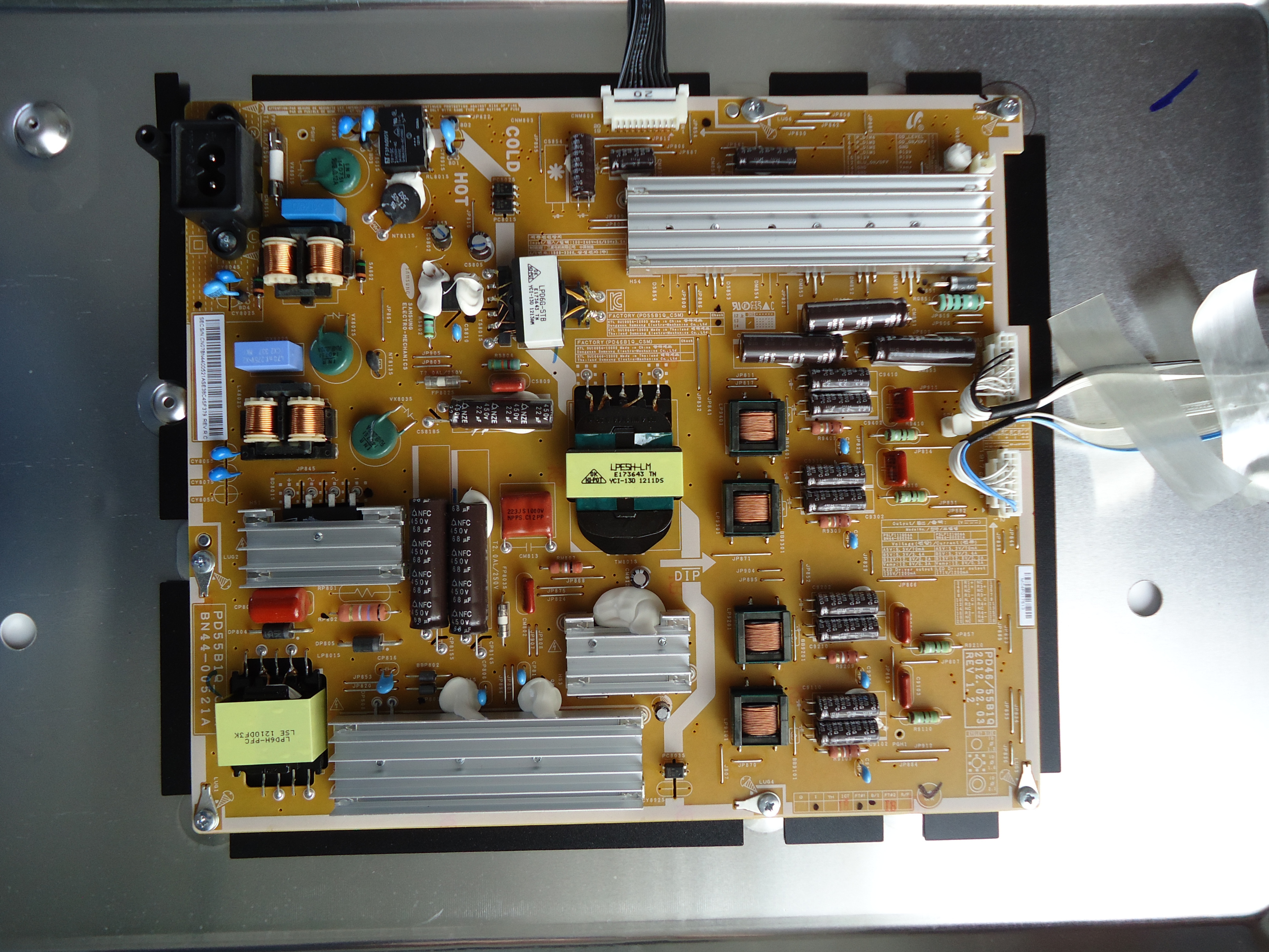

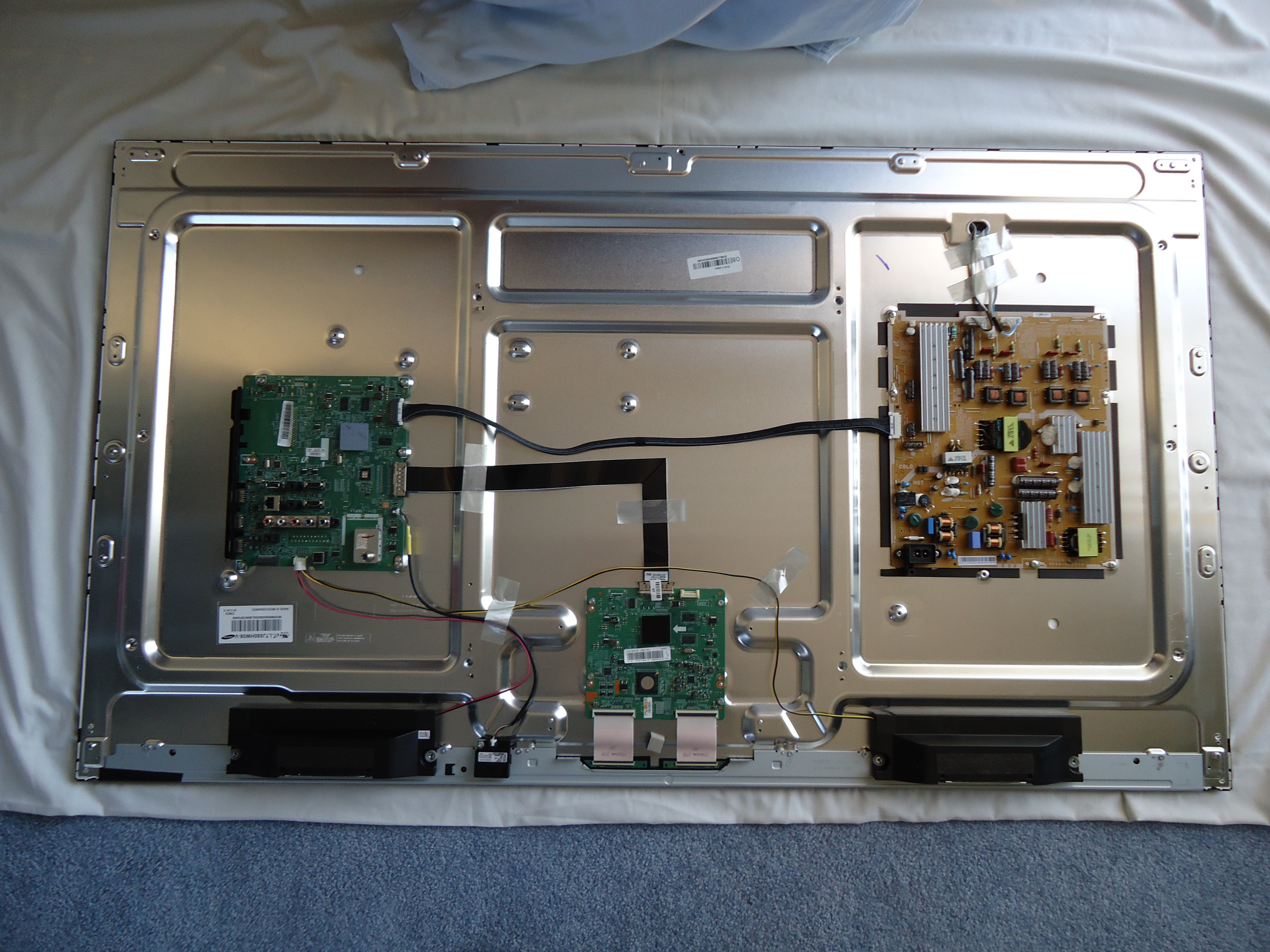

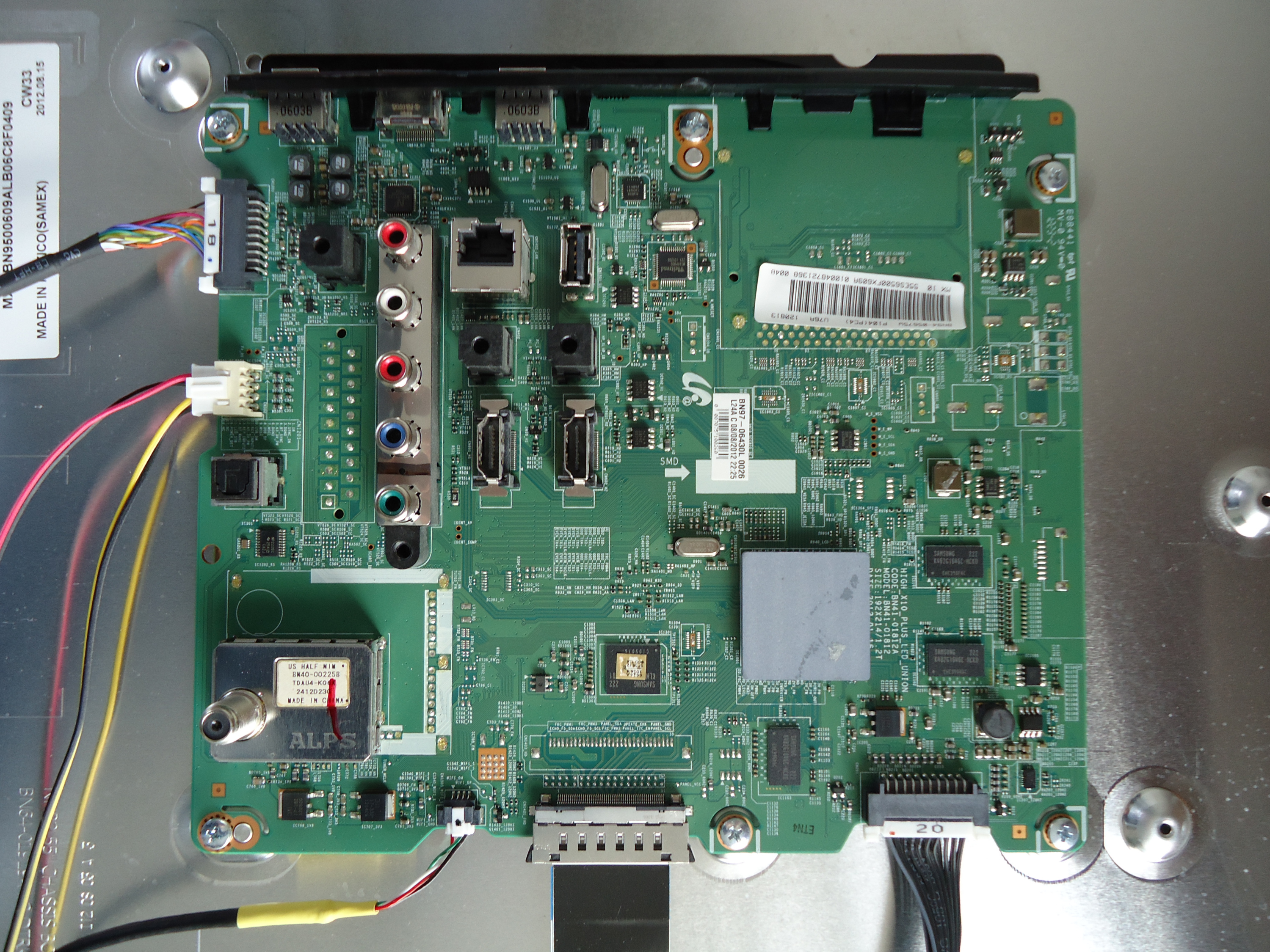

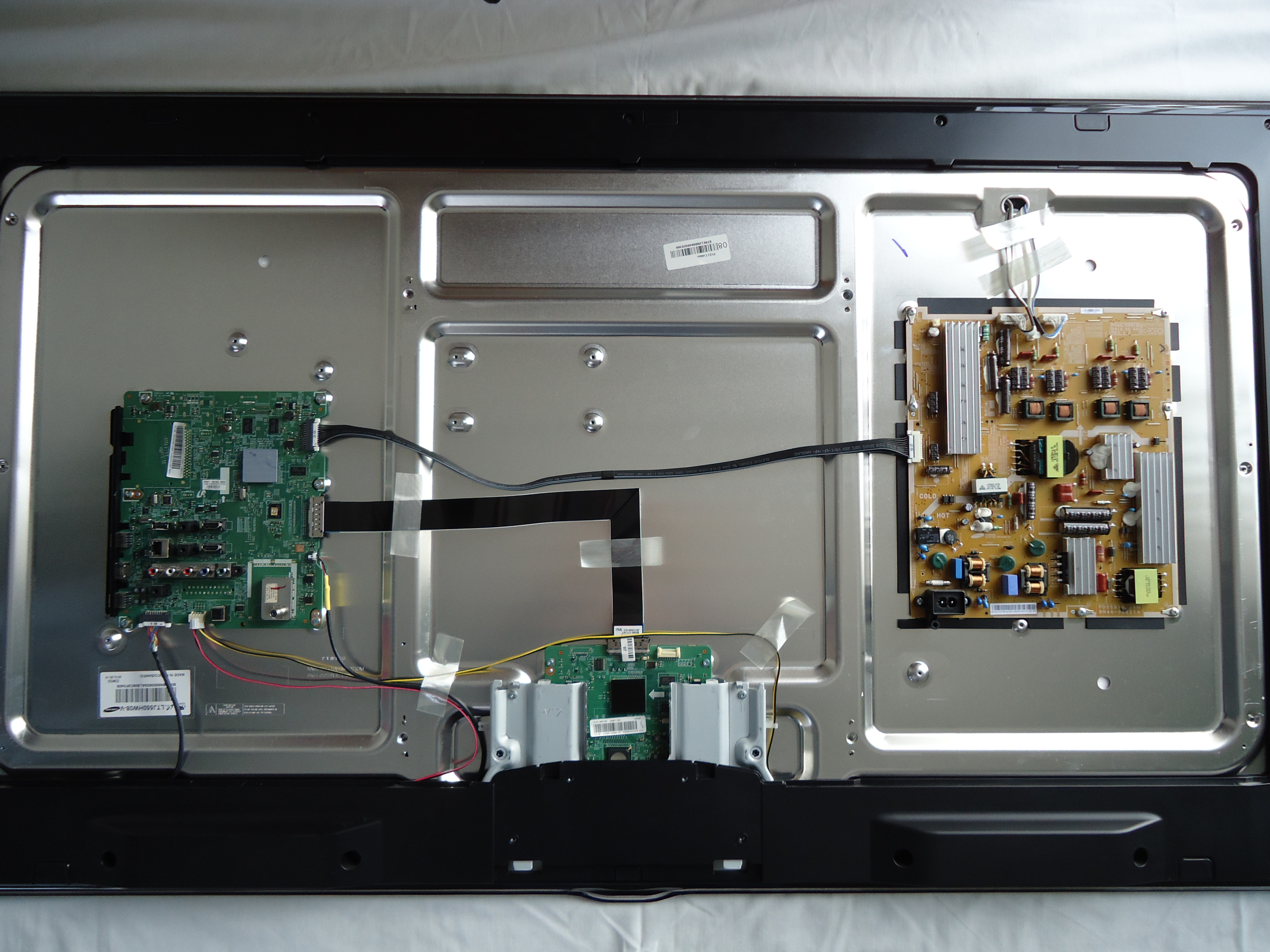

    I am providing photos of the chassis and boards.

                  i have the un55es6500 also. question: if i unplug both t-con ribbon cables to the display,should i have a black screen or should i still see a picture on screen even thoug there are NO signals coming from the t-con board?
                    Re: Samsung UN55ES6500 - video problems, need info
                    Already answered this in another thread where you asked.
                    There will be no image with tcon disconnected, If there is a ghosting effect afterwards it is the panel at fault

                            Try disconnecting the ribbon(s) one side at a time from the tcon to the panel and report back what you see when you power it up.
                              ok did as instructed
                              first one removed lead to the broken side and yea basically just got a black screen
                              second one lead to the working side and could see the on screen message up the other side was just off.
                              makes me wonder if i can / should dismount the board and move the broken side ribbon into the working side of the t-con of if that would even work and not break it more lol
                              so in your experience does that mean its a failure somewhere on the t-con board or somewhere else. im crossing my fingers that i can just get a different tcon.
                              thanks for the assistance.
                                i wrote that backwards.
                                removed lead to working side, leaving the broken side connected and could not see anything. however no inputs were connected at the time. and im not sure what on screen messages appear on that side i did hit the menu button but did-int see anything
                                then swapped the connections and on screen message was there and looked normal. with exception that the other side of the screen was disconnected.
                                  I would say it's the panel. The tcon rarely causes faults on only one side of the screen, at least to my knowledge.
                                    Quite possible VGH (Von) typically 20~30Vdc is missing on the Gate Driver side...If you have the VGH (Von) voltage on the T-CON look for it on the X/Y Tab Bond Board.....Most likely it's missing......so to solve this problem just solder a thin wire connection to the Tab bond Bd and this may fix your issue.......Other signals may be present on the Source Bd and perhaps be absent on they-Tab Bond like Voff, CPV1, VCOMG1, VST1, STV, CPV2, VCOMG2.....
