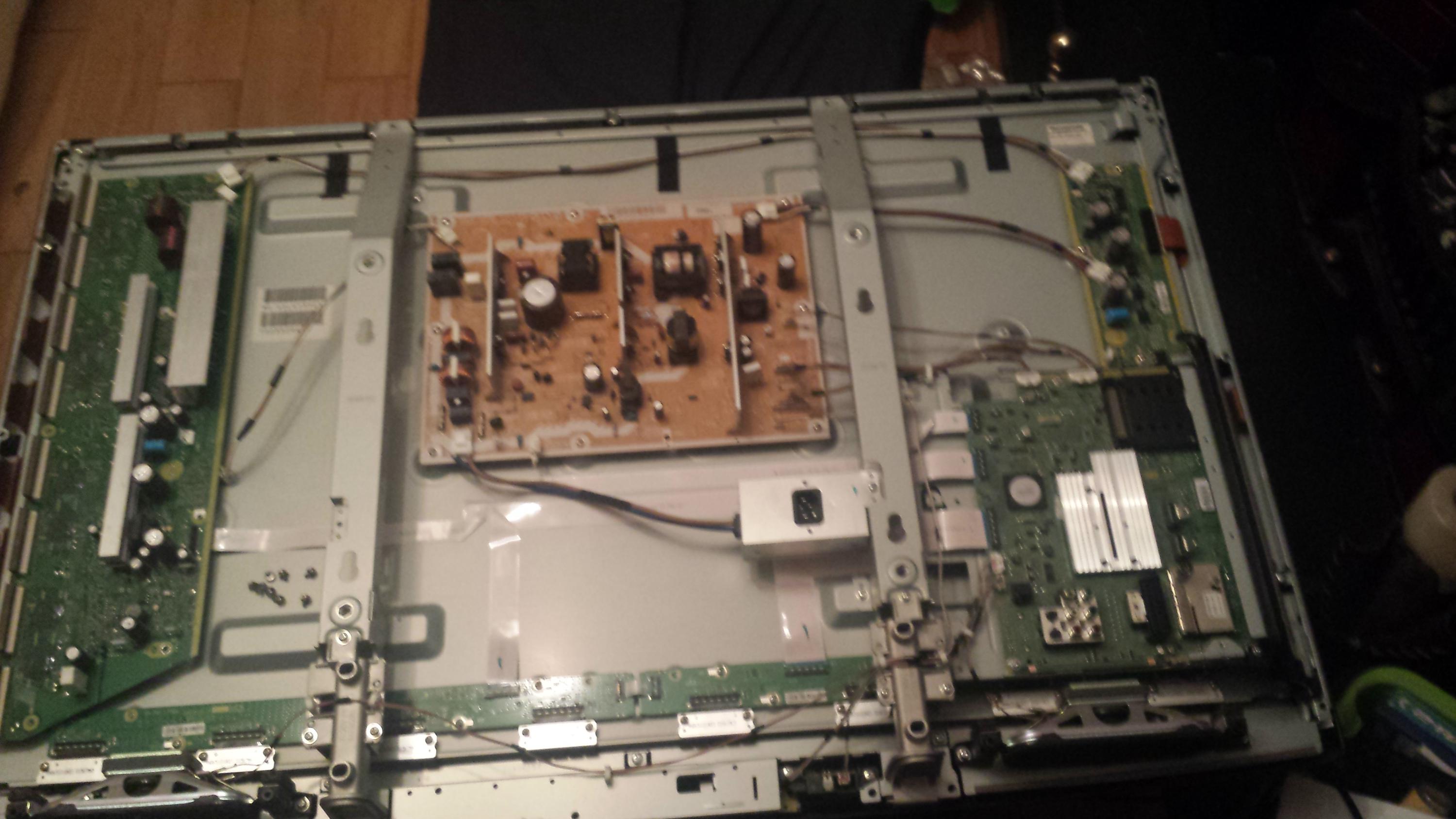

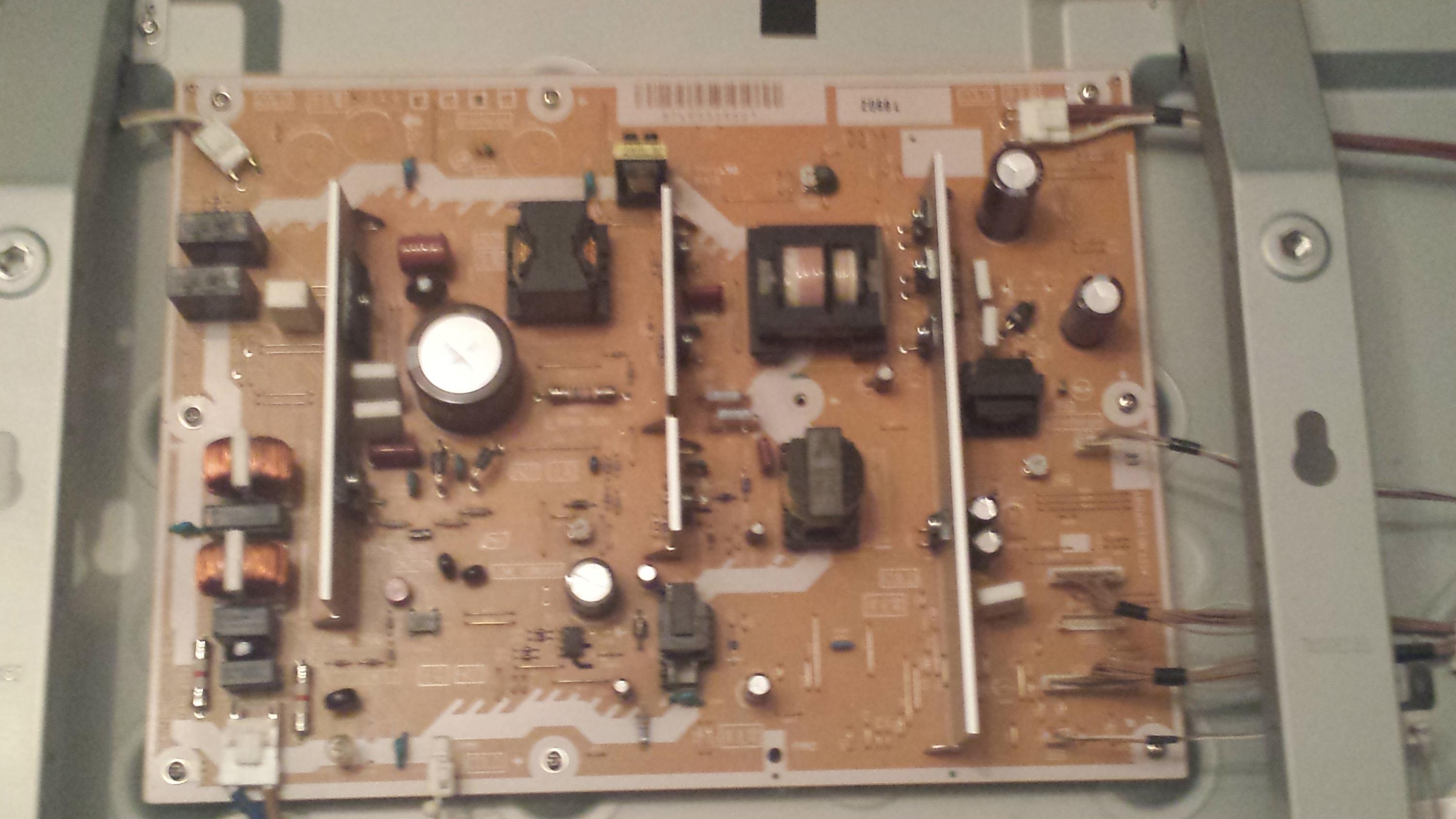

    Could you perhaps supply pictures of the parts inside the TV, and one of the whole TV with the cover off? So we can see what we are dealing with.
    • bigbadtom
      • Oct 2014
      • 11
      • Ireland
      Re: Panasonic TX-P42C2l : No Power with 4 LED Blinks
      Please see attached any help gratefully accepted

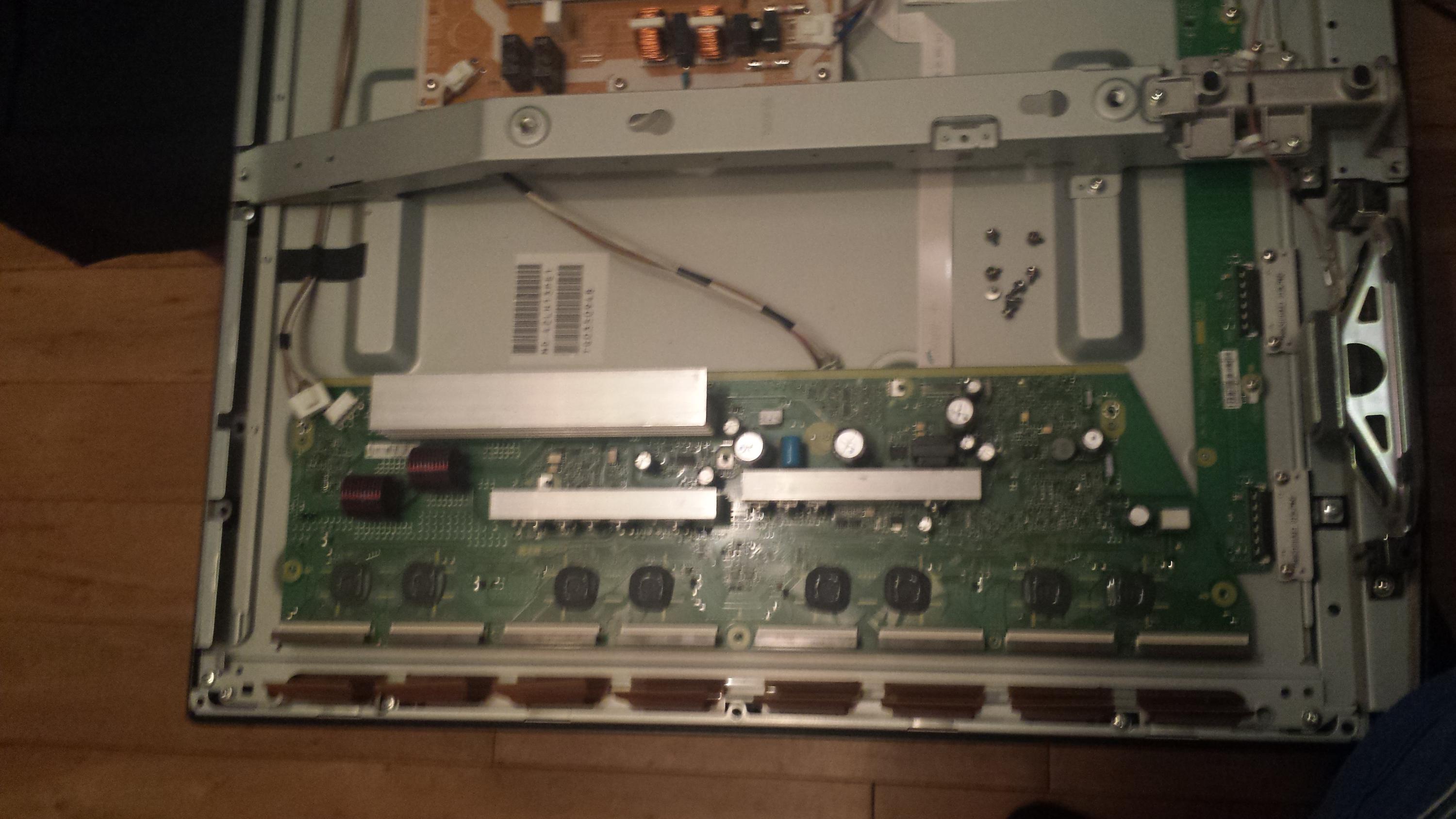

        Ok, so in the condition there you still have the SS connected to the P board. Have you tried disconnecting that and powering the TV up again?
        • bigbadtom
          • Oct 2014
          • 11
          • Ireland
          disconnected the ss board. and sc board at same time light changed to six blinks
          reconnected the sc board without ss connected and went to seven

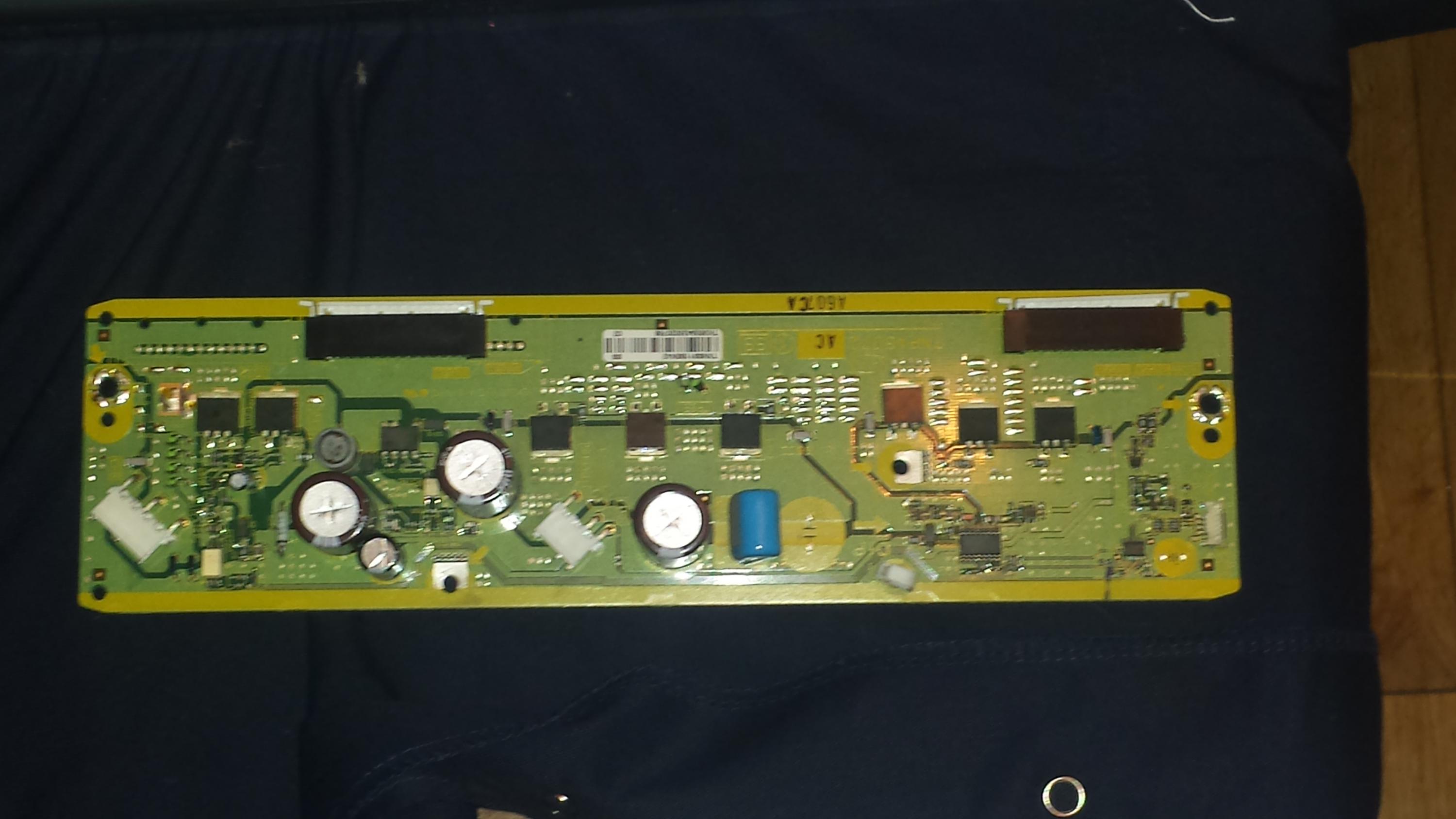

                Ok, my guess would be the SS board is shorted. Can you remove the board and get clear photos of the top and bottom of the board? Do you have a digital multimeter available?
                • bigbadtom
                  • Oct 2014
                  • 11
                  • Ireland

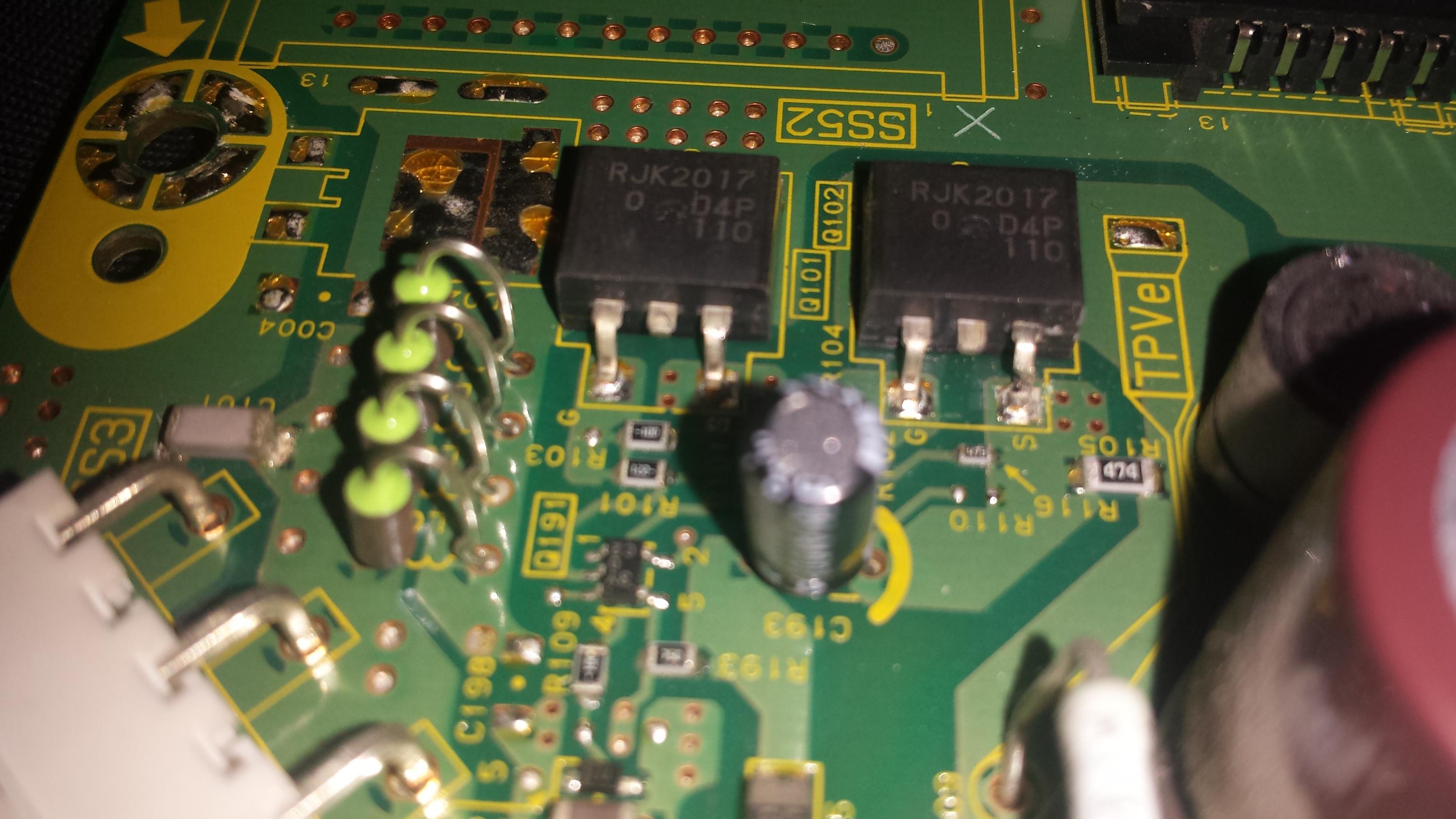

                  removed board hope you can see I found issue all eight same component have blown one of its legs.
                  solution is to buy second board?
                  but what caused it may cause it again?

                    If you can't find a board, I've had success repairing these by replacing the 4 RJP30E4 transistors. The M817135FP FET driver seems to survive although not a bad idea to replace it.
                    easiest way to remove the transistors is either snip the legs close to the body without twising them or the track will tear or heat the solder and lift each leg whilst the solder is molten. Then you tin the meatl tab and heat until it bubbles and get the body off. I get away with a 40w iron and medium tip.
                    I did have one board I used fail again after a few days. Not sure why, I got the parts from china so maybe that but my second bpoard I had a 50" board I stripped the transistors from that and that has been fine, also I replaced the FET driver. The first one I did not, again possibility.
                    Glad I asked what model you had, kind of makes a big difference with the answers you get.

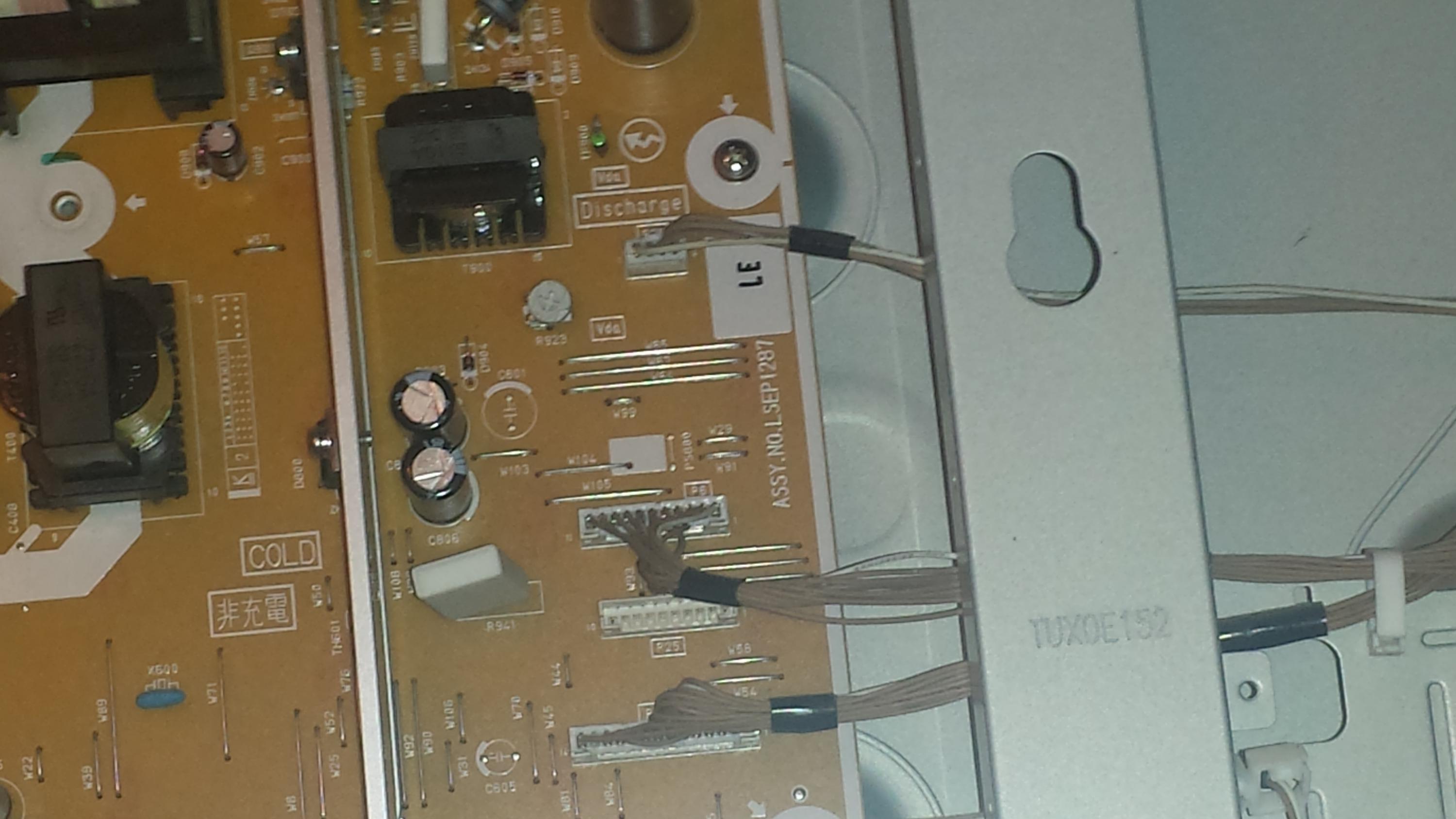

                    The SS failure in these is very common but it can also take out the SN board, hopefully you had SS3 disconnected when you powered up isolating the SS.
                    May pay to bell out the large transistors on the SN too. There's a couple of SMD diodes that can blow too, D441,452.

                            When you say blown off the leg... you're not talking about the stub leg right? That is normal for those devices.
                            You should check if they are shorted with a multimeter.

                              I'd still be checking out the SN as a precaution. I have read a post where a new board got killed by another and they went around in circles for a bit. Would have to do a search. Going back a bit now.
                              • tw2005
                                • Oct 2011
                                • 6458
                                It was this one I think. https://www.badcaps.net/forum/showth...npa5072&page=2
                                the way I read it , SOS 4 cleared with new SS, (no SN) after everything hooked up he ended up with another fault, then somehow ended up with shorted SS again so I'm presuming his SN was damaged also and killed the SS again.
                                Just something to be aware of as there is an assumption the SN is still good at this point.

                                      Not sure if my multimeter read transitors maybe just solder legs and cross fingers
                                        You can check for shorted transistors with the diode or 200 ohm range of your multimeter. Just check across all pin combinations of the transistor.
