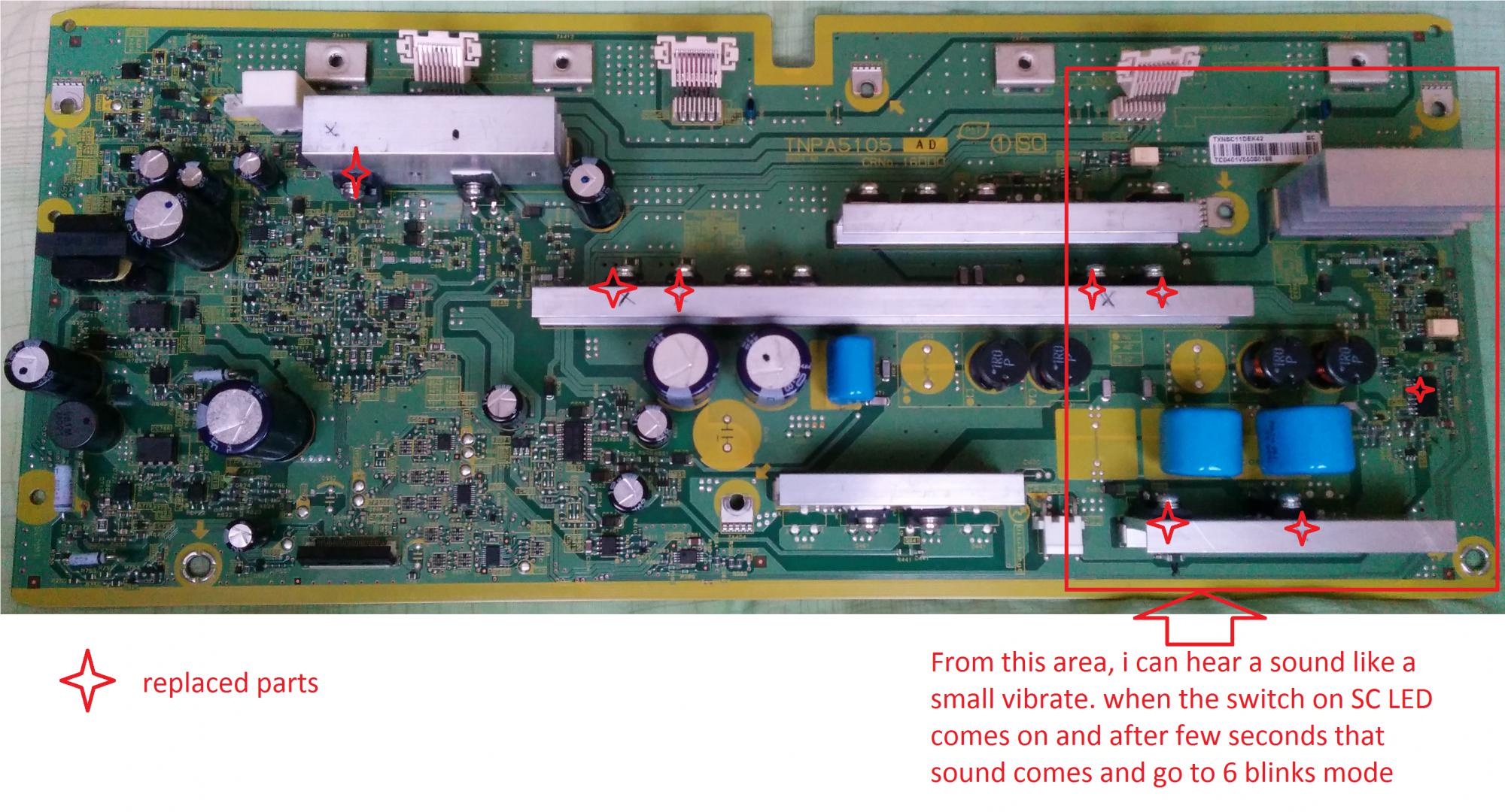

                      #50
                      Re: Panasonic TX-P42C2l : No Power with 4 LED Blinks
                      do you think still it is SC board? please let me know what should i check now.

                        #51
                        Not good I guess. Not sure how I'll go recovering from a failed attempt.
                        Are you able to take a hi res photo of the board so I can see repairs? Can you list the parts(locations) replaced?
                        Did anything go pop when you powered this board up?
                        have you gone back and now checked all those parts to see if any are damaged/shorted after the power cycle?
                        Q661 is one that comes to mind
                        I'm hoping you ordered extra quantities of parts for more than one attempt.

                          #52
                          Please check the attached pic. checked the Q661 and its not shorted. and the other parts i replaced are looks fine. not shorted.

                            #53
                            I'm going to dribble out the info as I work out what those parts are.
                            Check D451 for short cct
                            Also looks like no 30f125 transistors replaced. Is that correct?
                            can you provide a summary of the part numbers of those heatsinked parts replaced, that will save me a lot of time.

                                #55
                                Replaced parts:
                                Q661, 401, 402, 421, 422, 451
                                D482
                                IC521
                                Q451 - C & E shorted
                                • tw2005
                                  • Oct 2011
                                  • 6458
                                  #56
                                  Replaced parts:
                                  D482
                                  IC521
                                  I think we're not understanding. I'd like the part numbers eg RJP63F3A etc
                                  Check the SMD diode D451! The fact you report shorted C-E I think is pretty much confirming D451 is shorted, that will cause 6 blink and funny buzz
                                  would like to know what Q621 is and also can you resistance that one g-c,g-e c-e.

                                    #57
                                    Actually if Q451 is short c-e, just remove that D451, recheck c-e, ,

                                        #59
                                        checked D451 after removed. it is not shorted. transistor is fine. But the C & E points on board is shorted.
                                        Pls can you let me know that diode part no on the board.
                                        • tw2005
                                          • Oct 2011
                                          • 6458
                                          #60
                                          Ok , this is weird. So out of cct, D451 is ok, so too is q451 out of cct but at the board c-e is?
                                          I was confident i was right but looks not. we're close. Thinking Q551
                                          Let me think. I may be misunderstanding the schematic.
