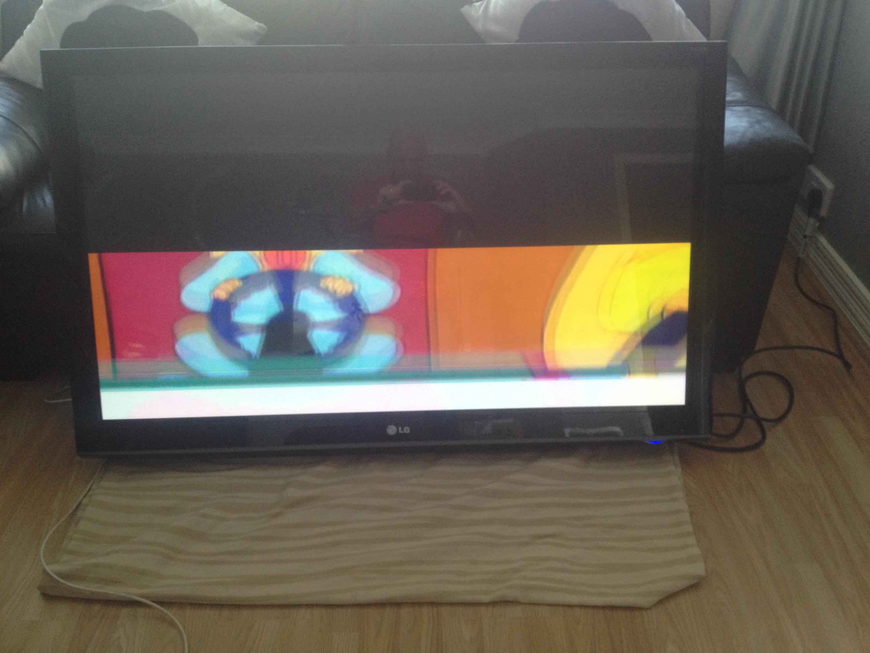

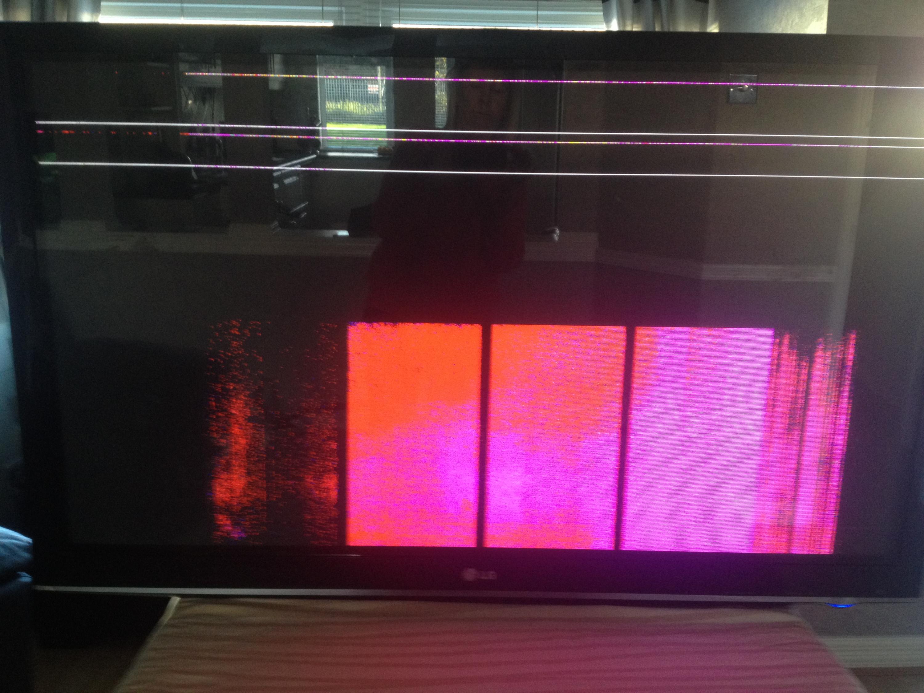

    bottom half of screen working, but jumping and flickering.
    top half flashes a pic every now and then for a split second.
    so looking at this, its defo top buffer thats gone, maybe bottom on way out,
    but what about Y-MAIN ?
    power supply volts are as should be,what is the best thing to test first ?
    Re: Lg 50ps3000
    Could be control board or Y-buffer IMHO.
    I would guess Y-buffer as LG's tend to have a lot of Y-buffer failures.
    Signal is chained down from top to bottom, so fault with top can cause bottom to glitch too.
    Y-sustain probably OK.

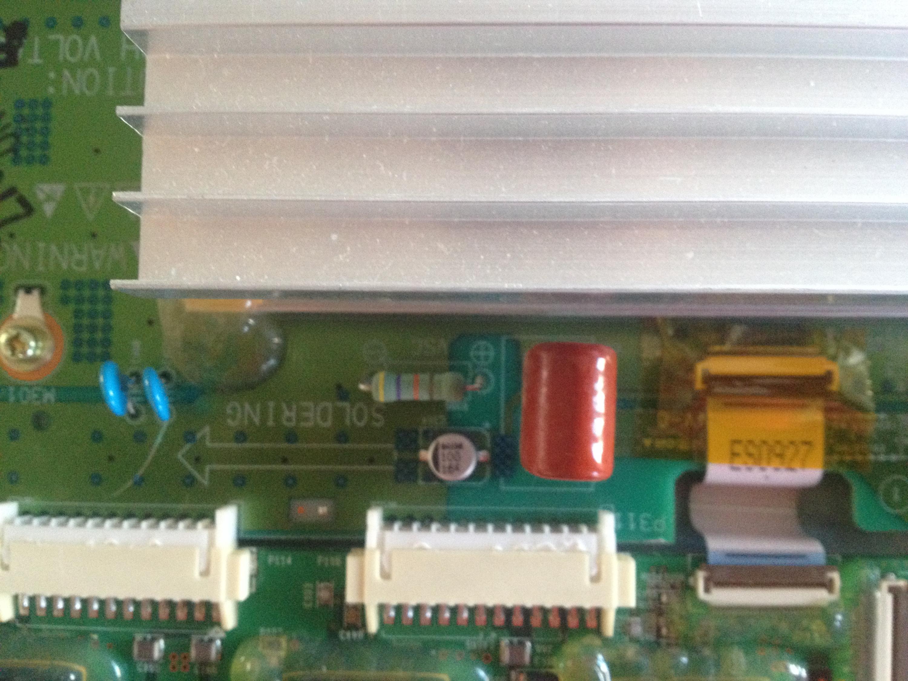

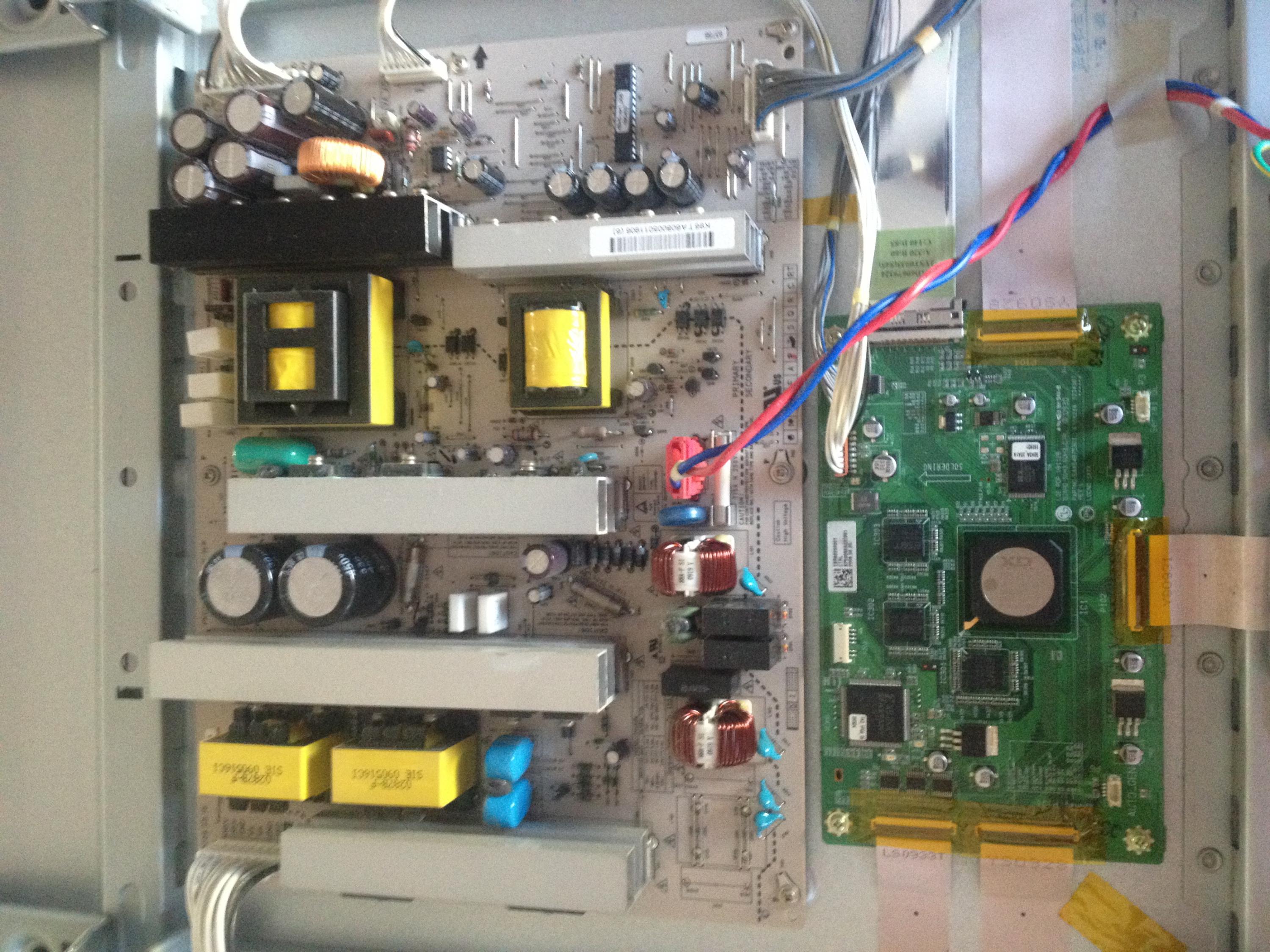

        Re: Lg 50ps3000
        pics
          Re: Lg 50ps3000
          Picture of panel sticker please.
          -Vy about -200V
          Vsc about 150V

            Re: Lg 50ps3000
            there you go tom
              Re: Lg 50ps3000
              Read in this order
              N.A. / -Vy / Vsc / N.A. / Vzbias
              So -Vy = -180V, Vsc = 150V, Vzbias = 105V

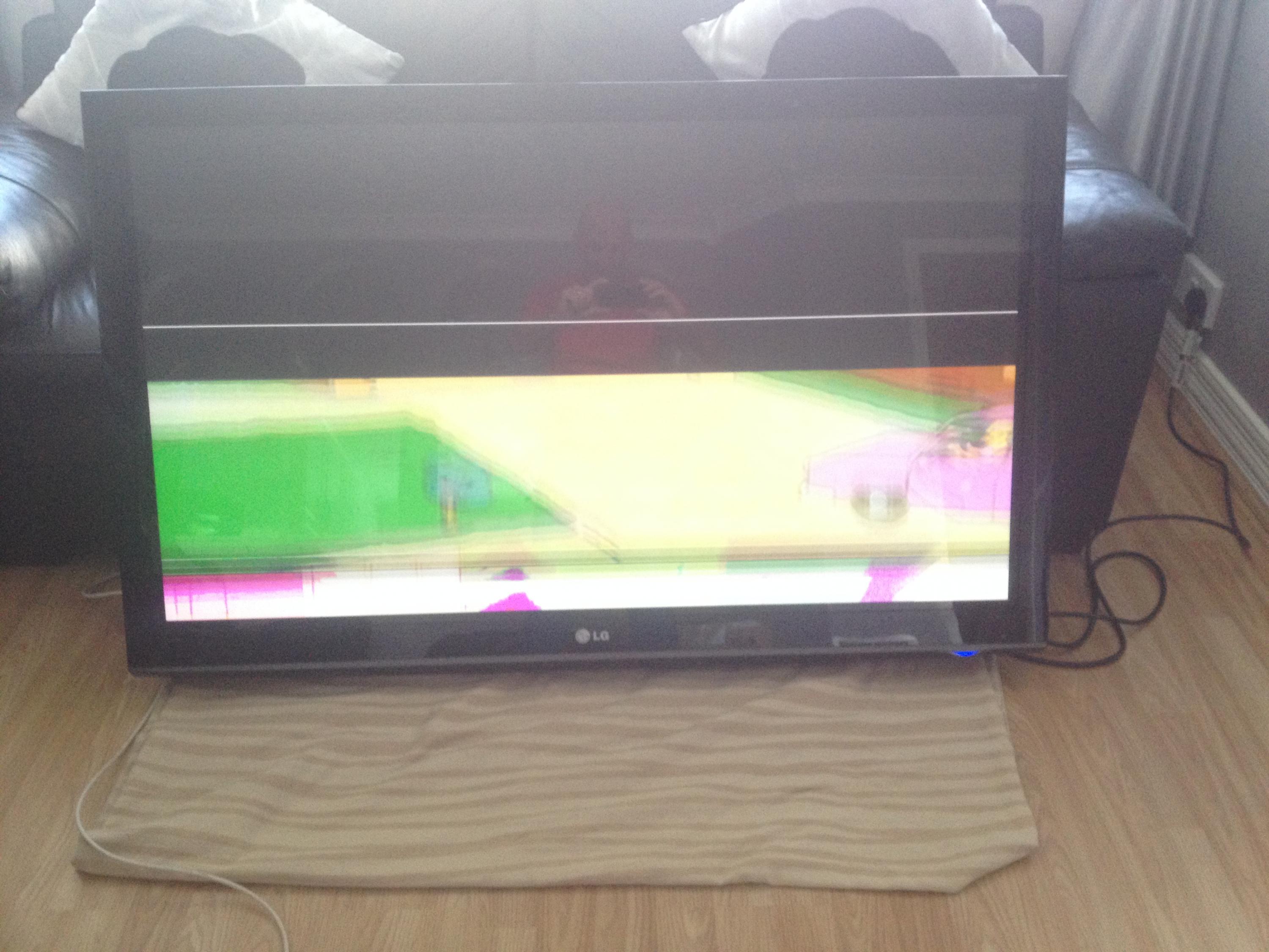

                Re: Lg 50ps3000
                well something very wrong here then
                vcs 110 - 130 up and down
                vy 140 - 160 up and down.
                and now going like this
                  Re: Lg 50ps3000
                  Looks like a buffer board popped. Try pulling the top board out and leave the bottom disconnected, do you get half a picture?

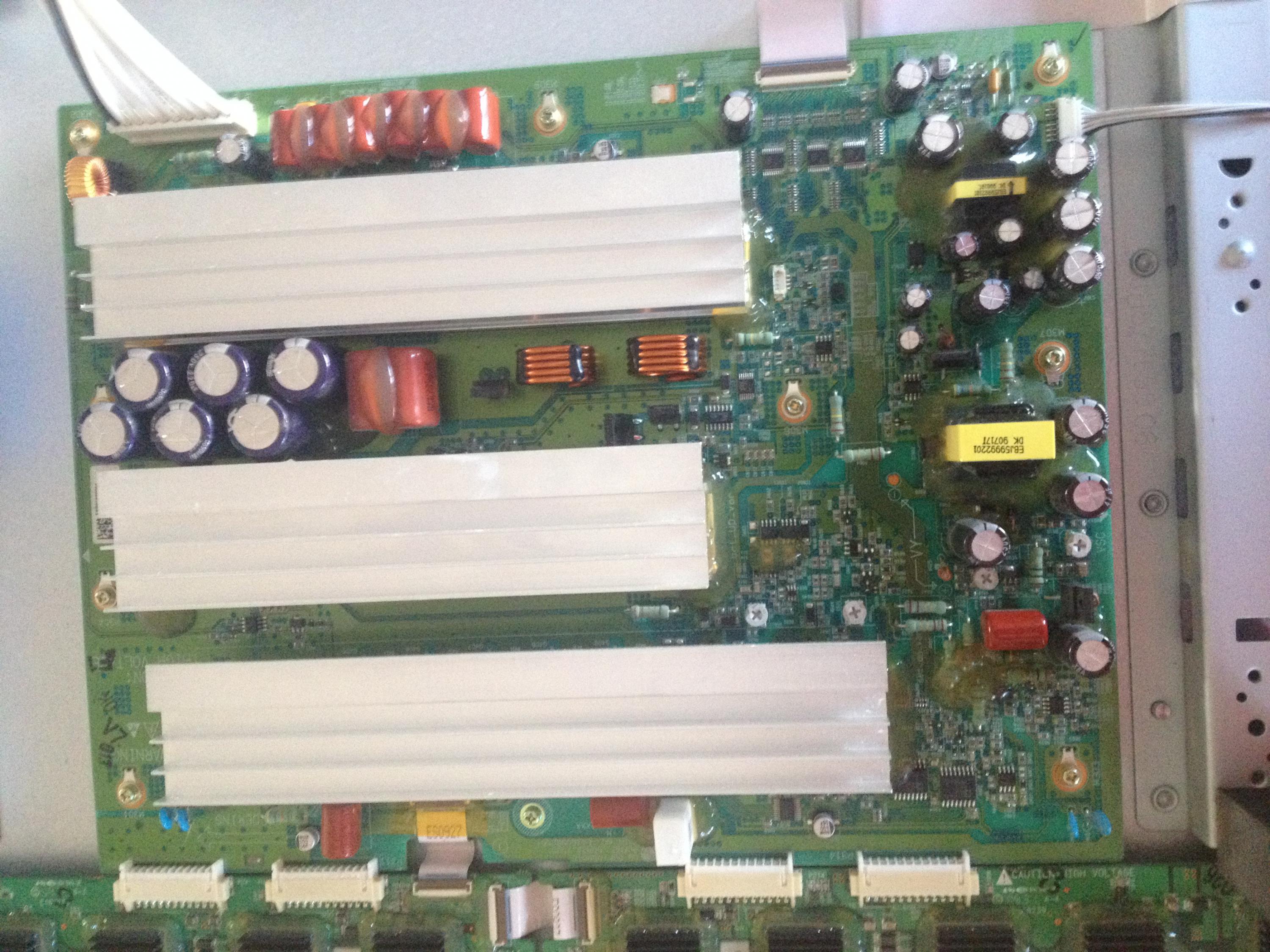

                    Re: Lg 50ps3000
                    removed top buffer from y sus,no pic, buttom buffer still connected to y sus but not to top buffer
                      Re: Lg 50ps3000
                      Ok, will have to do it the hard way.
                      Pull both boards out and test them like in this video:
                      https://www.youtube.com/watch?v=51SZ...Y&noredirect=1

                                      update on this tv,
                                      got a meter with the beep, checked the buffers and no shorts, bad news is i bought another pair before i got the meter,
                                      but i still installed the new ones and got the same results.
                                      thought id try auto gen, and just got red and pink spoty bars flashing on bottom of screen, not much different from pic above.
                                      i think control board now, as the buffers check out ok on both pairs.
                                      oh, and the voltages are 100% with this new meter.
                                      any thoughts ?
                                        Re: Lg 50ps3000
                                        Unlikely to be control board, as most plasma control boards do not treat the top and bottom halves differently.
