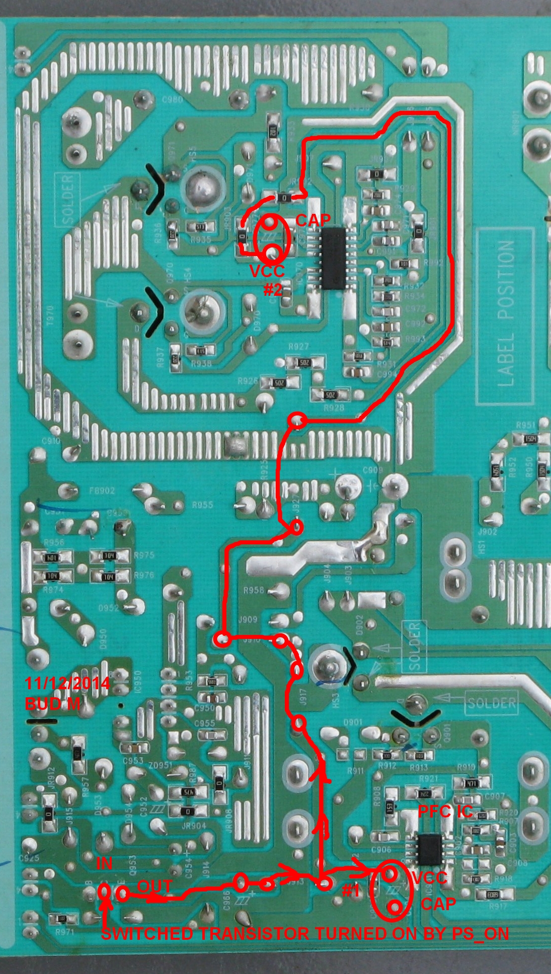

      OK, now I see why you are not getting the Voltage at the VCC pin, you need to have forced-on applied.
        Re: Toshiba 26AV600A
        Here is how the VCC gets to the ICs

          Bud, thank you very much for your assistance here. I am most impressed by your knowledge and the efforts you put in to get to the bottom of the problem.
          Your tracing of the Vcc path is very helpful. Thank you again.
          Based on the above I did more testing. This time I forced the PS board on with the 1k resistor between 5V and PS-ON pins.
          Voltage on the main filter cap jumps to 397V. The switched transistor Q953 (delivering Vcc to the IC970) appears working OK, with the voltage readings as follows: B 9V, C 9.15V, E 8.45V.
          That voltage signal goes all the way to the IC970, pin 12 (Vcc) where it reads 9.6V (not sure why it is higher there).
            OK, according to the spec sheet of the IC, the startup voltage at pin 12 is between 10~11.4VDC, once it starts it will keep on running as long as the VCC does not drop down below 8.15V (the range is between 7.45~8.85V), if it does then it will go into shut down.
            So right now it can be that the Voltage at pin 12 is too low for it to start up or, it is in shutdown due to false some where, or the IC is bad so it is not sending any Gate drive to the MOSFETs.
            I need you to check the rectangular grey cap just below the model number tag 715G3370-1.
            Can you read the number as printed on the body? we need to check its capacitance.

                  Oh, replacement of that IC may present a challenge for me. I am not sure if I can handle taking out and then soldering back the 16-pin chip using just a soldering iron. It is in a tight place and with many other SMD's around. May find it to be too difficult. Alternatively I can perhaps look for a new PS board.
                  Now, please allow me to ask you a few questions here. It is purely for my learning, knowledge seeking I would say. I am just trying to find some explanation for the system operation.
                  1. As the switched transistor that supplies the Vcc to the IC delivers 8.45V on its Emitter, and that voltage signal proceeds further to pin 12 (Vcc) of the IC, so why pin 12 reads 9.6V which is above the supplied voltage?
