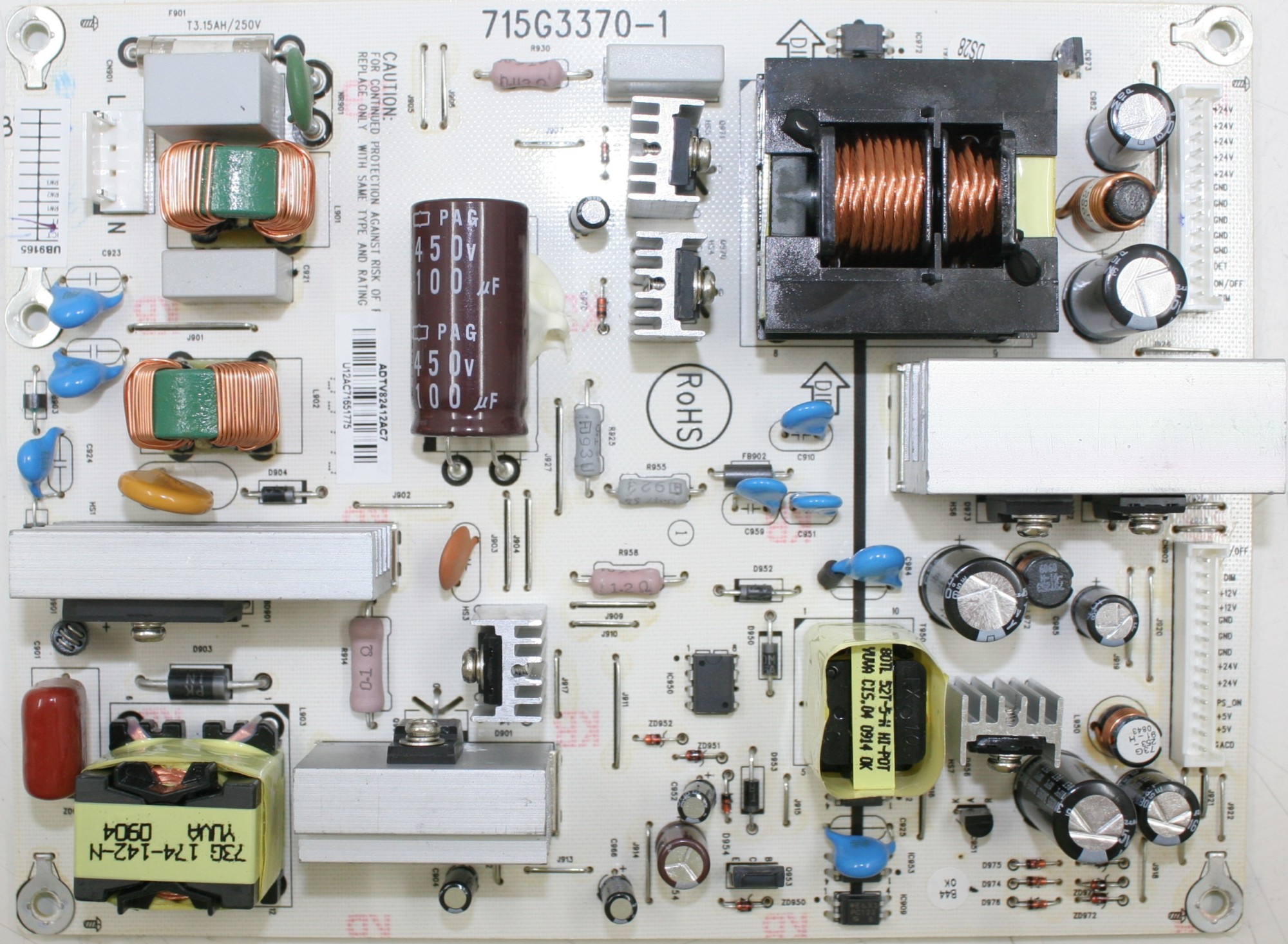

    Hi everyone,
    I would like to ask you for some help in identifying the problem with this LCD TV.
    It is Toshiba, Model 26AV600A. Its Power Supply board is marked 715G3370-1.
    I did try to locate the circuit diagram for the PSU but no luck, and without the schematics I am a bit blind in diagnostic.
    The symptoms are:
    -at powering the set the front LED shows Green
    -one or two seconds later it turns to Red
    -no response from the remote control or the side buttons
    -voltage at the main filter cap 340V
    -STBY 5V OK
    -no 24V, no 12V
    Power IC (designated on the board as IC950) is an 8-pin chip A6069H. I took some voltage measurements there, and they are:
    -pin 1 0V
    -pin2 about 6V
    -pin 3 GND
    -pin4 0.8V
    -pin 5 around 14V but varies
    -pin 6 not connected
    -pin 7 and 8 340V
    Attached below: picture of the Power Supply board and datasheet of the Power IC.
    I would be very grateful for your guidance here.
    Regards
    Markus1
    Re: Toshiba 26AV600A
    Please give the dc Voltage readings on that white connector (bottom right of your picture) that goes to the the main board, each pin has label on so report the reading on each pin when TV is OFF and when power switch is activated.
    BTW, this power supply has PFC Voltage booster so the DC Voltage at the two legs of the main filter cap should jump up TO >360VDC when power switch is activated and it gets PS_ON signal from the Main board.

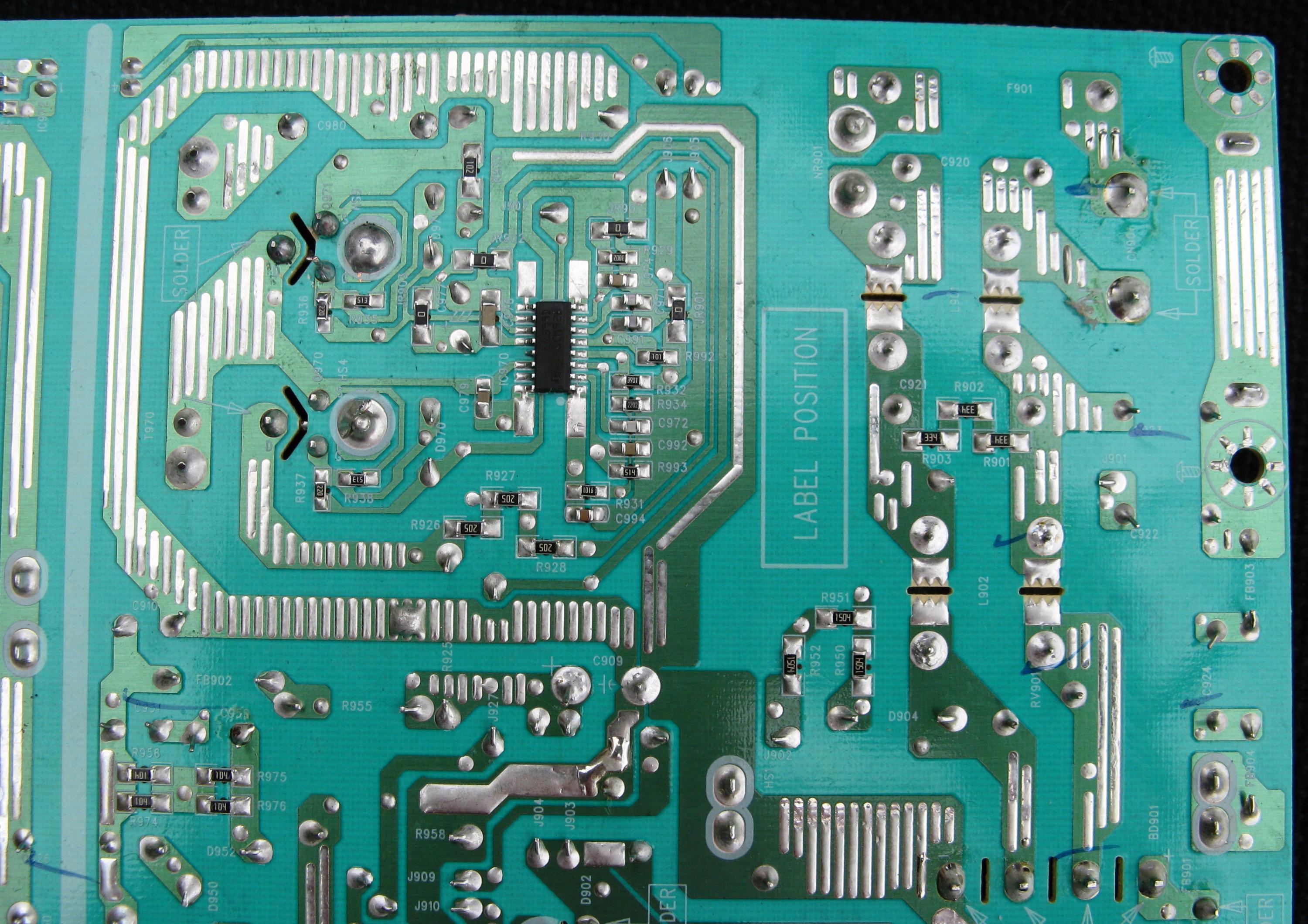

                      BTW, can you please provide good clear pictures of the bottom side of the power supply board?
                        Thanks for your patience Bud.
                        Here are further tests:
                        -voltage reading on the main capacitor with the force on the power supply (5V via 1k resistor to PS-On pin) is 396V DC.
                        -the results are the same whether its forced via the resistor or when the PS-On line is connected as normal from the Main bd.
                        I have reported previously reading of 347V on the filter cap. Perhaps that was incorrect, not sure about it now. I am surprised by this discrepancy.
                        I also would like to emphasize that the behavior of the front LED (green on AC powering from the wall outlet then red after 2 sec) is always the same in both forced or non-forced operation of the power supply. The Power On button is not being activated. It does not make any difference.
                        Picture of the bottom side of the power supply board attached as well.

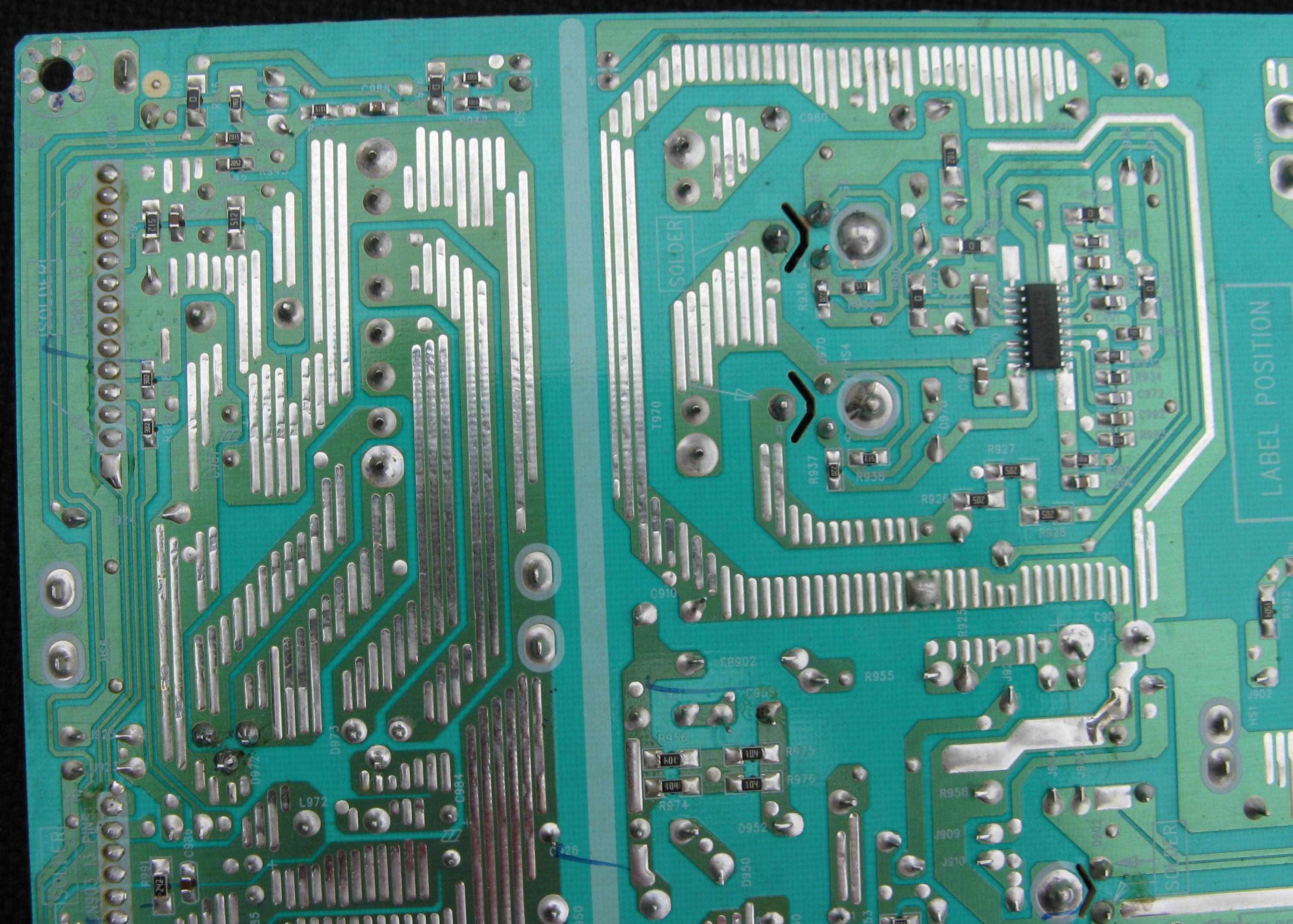

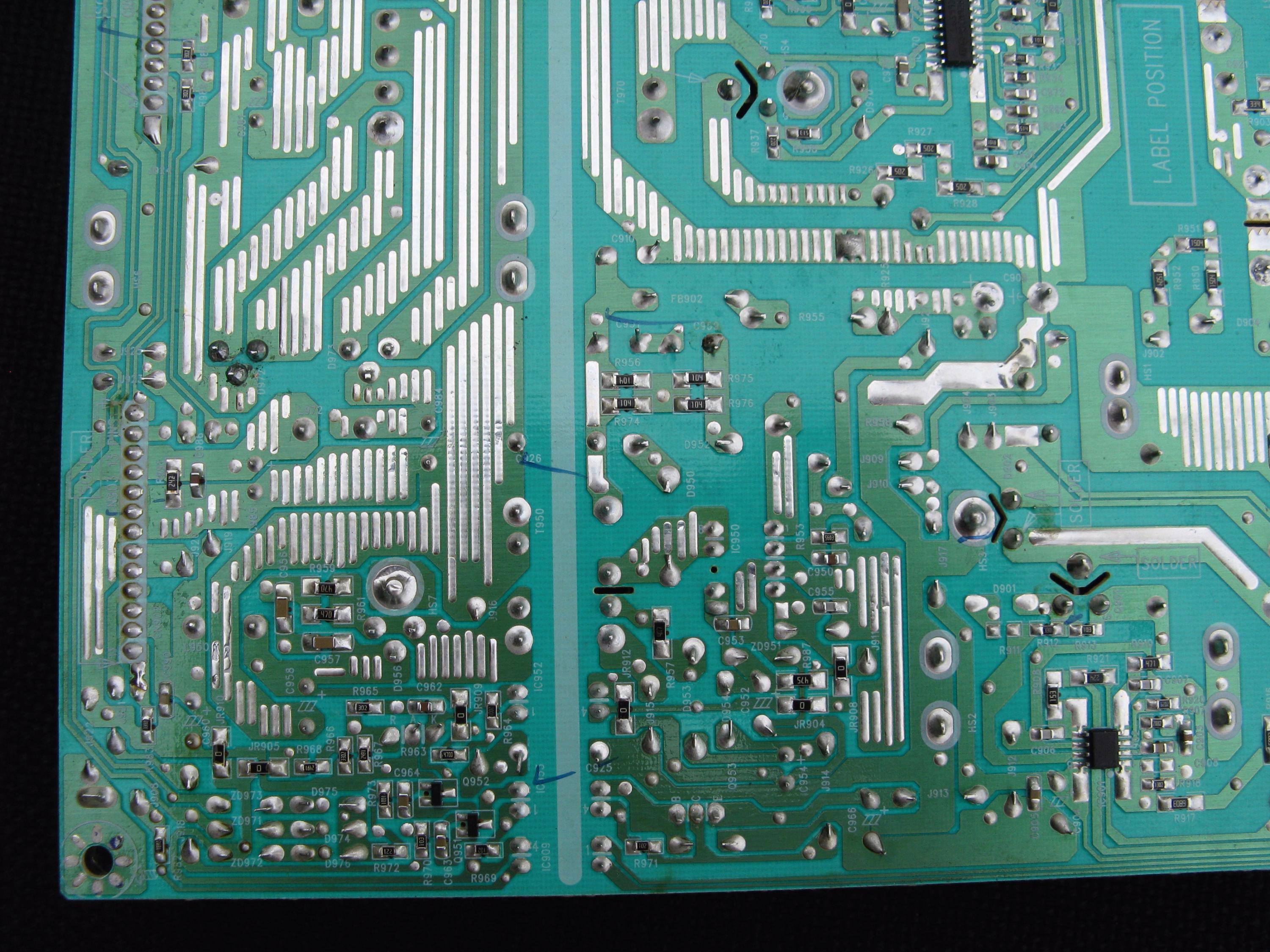

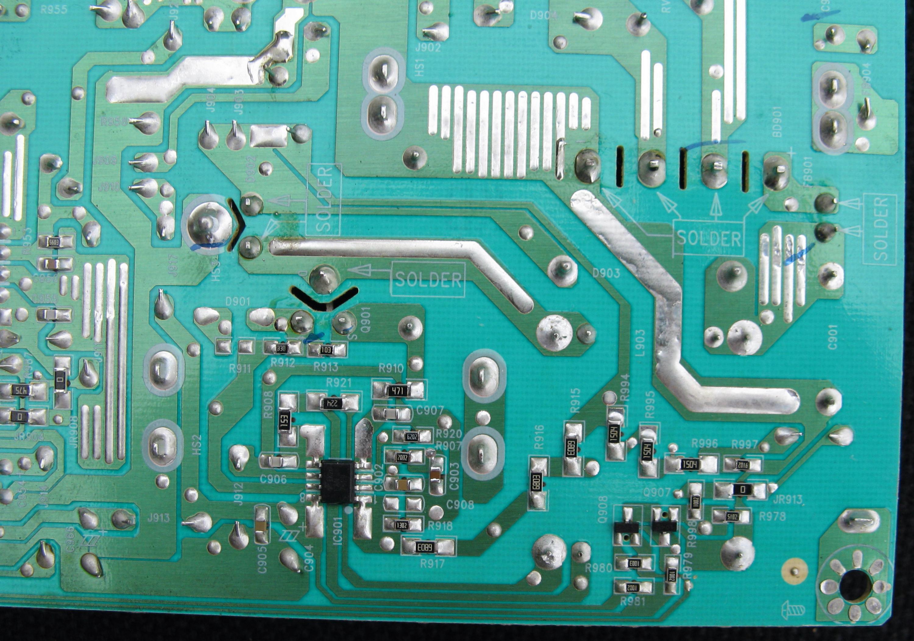

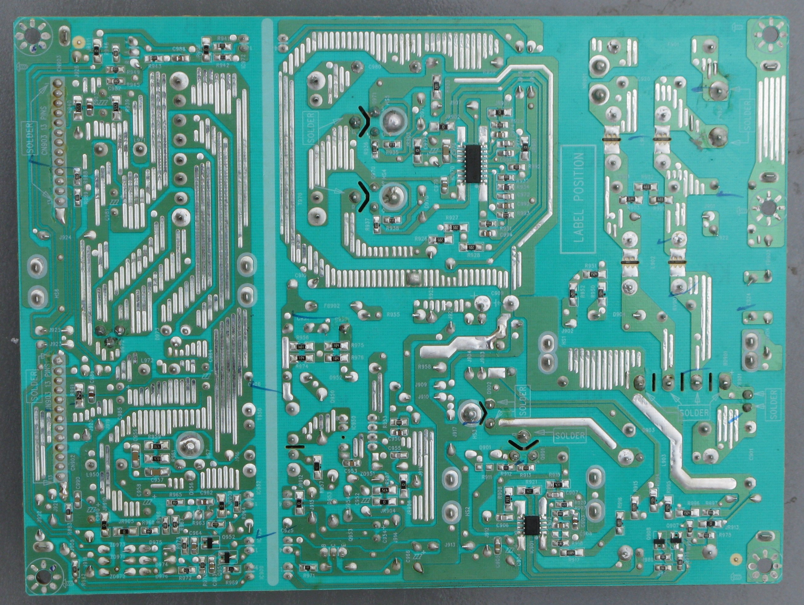

                              Yes, the 24V and 12V are missing.
                              I checked the fusible resistor R925, and all other low ohm resistors in the vicinity R955, R958, R914, R930. All appear to be close to 0 ohms when tested in-circuit.
                              Attached are pictures of the underside of the power supply board, in sections.
                              Hope it helps.
                                Thanks for good pictures.
                                https://www.badcaps.net/forum/attach...6&d=1415673799
                                Can you read the P/N of that SMD IC? We need to get the spec sheet to get the pinout so we can test the voltage on the pins.
                                      I should add that because the IC was located on the underside of the PS board I had to perform the voltage measurements with the board on the bench. All other connectors were off and I did not use the force-on resistor.
                                        Yes that is going to be lots of tracing on the board to locate the switched transistor that supplies the VCC to this IC, that transistor is turned on by the same PS_ON signal which turns on another switched transistor that supplies the VCC for the PFC circuits which is working.
                                        I will really have to look at the bottom side of the board real close to draw out the circuits so it take awhile.
