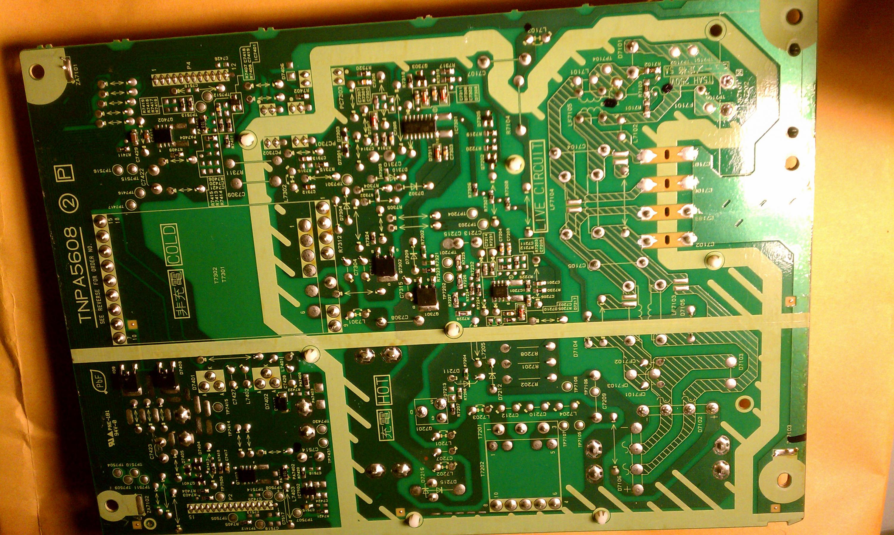

          Re: use spare led backlights from one tv to test the led driver of another tv?
          You know you have this:
          https://www.badcaps.net/forum/showpo...03&postcount=1
          So why don't you treat as an unknown board for you to try to figure out what kind of load you will need to make to test LED dummy load to hook up to this power supply board.
          And also do what I suggest here:
          https://www.badcaps.net/forum/showpo...9&postcount=14
          You have to do the research to understand how it works then you will know what you need to do.
          You have that working unit for you to do hands on learning with it.
          You can see the IC, the MOSFETs, etc, in the LED driver circuit as shown in the pictures.
          The power supply board in post 1 LGP4750-13PL2:
          http://www.shopjimmy.com/media/catal...801-bottom.jpg
          http://www.shopjimmy.com/media/catal...810801-top.jpg
            ok on the LGP4750-13PL2 i have ~30vdc on both of the VLED- pins and ~120vdc on the VLED+ pins...how do i test the resistance of the LED strips? ive tried putting the probes any way i can think of on the vled pins and on the strips themselves and its all infinite resistance

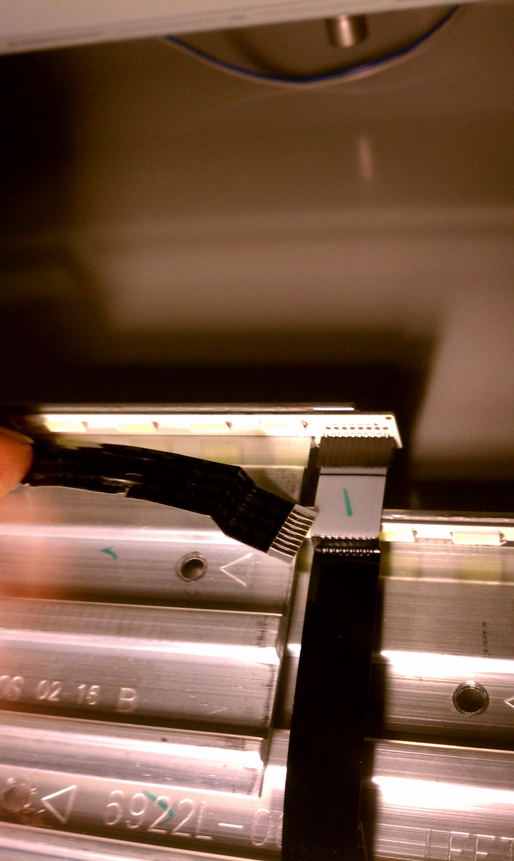

              ok so i got some edge lights from a panasonic TC-L47E50 that had a cracked screen. i also have all the other boards so i can probably get them powered. but what i would like to do is use the LGP4750 to power them.
              some things i discovered from looking at these edge lights for a bit:
              there are 48 LED lights in each edge
              they are broken into 6 groups of 8
              there are 8 pins going from the LED driver board (which is a separate board from the PSU in this tv) to the left edge light
              and 8 pins going to the right edge light
              2 of those pins are + and the other 6 are -
              on the edge led strip you can see that the 2 + pins are grouped together and shared by all 6 groups of 8 LED's
              the remaining 6 negative pins each go to the negative side of one of the 6 groups of 8 LEDs on the strip.
              so they all share the same + but they all have separate grounds?
              i dont know enough to guess at why its setup like this but im just in the observing stage...
              again i cant seem to get a resistance reading on anything. even putting the probes on either side of one LED yields infinite resistance..
              guess ill try put this tv back together somewhat and see what voltage is coming out of the driver board?
                You cannot test the resistance of the LED strip, your meter does not out out enough Voltage to bias on all the LED string which the LEDs are connected in series. Each LED requires 3~4V for the Vf (Forward Voltage). You need to understand how Diode function then you will know why. Do the research on how Diode function. Some meter also may not put out enough Voltage to test each White LED either.
