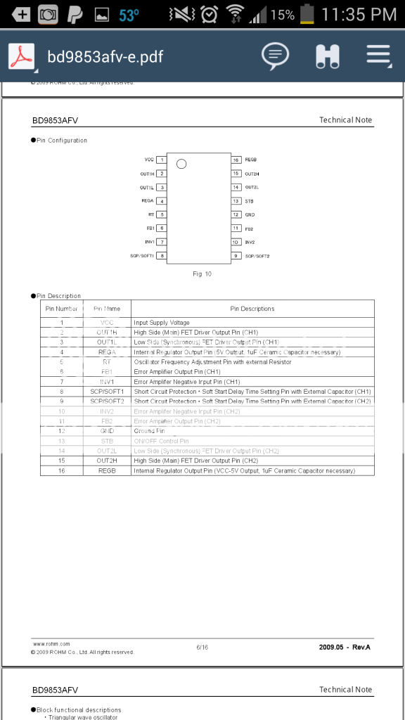

    This device is fairly simple. You can check if it is in regulation by probing the FB1/FB2 pins (6&11) - these should measure almost exactly 0.8V each.

          Re: sony kdl-46xbr6 slow refresh
          Got the tcon back working. It managed to blow a link resistor between pin 2 and 3 off the IC. This makes be back up my assumption that the IC is bad. Your thoughts? Altgough pun 1 and 2 are fet output pins and the link blew between the IC pin 1 and 2. Hmmm see pic
          http://i845.photobucket.com/albums/a...psd5wl5rea.png

            Btw. The tcon also took out the fuse on the mainboard. Replaced fuse and that resistor on the tcon and its back working. And I'm getting .8vdc in pin 6 and 11 of the bad board. So it at not be the IC after all
              Try measuring pins 7 and 11 too.

                well I went ahead and replace that IC No change. so its gotta be something else but I'm not sure what could cause this off and except for incorrect voltages going to the IC possibly?
                  Are the FETs it drives OK?
                  Output caps OK, not shorted?
                  Check volts across output capacitor on both.
