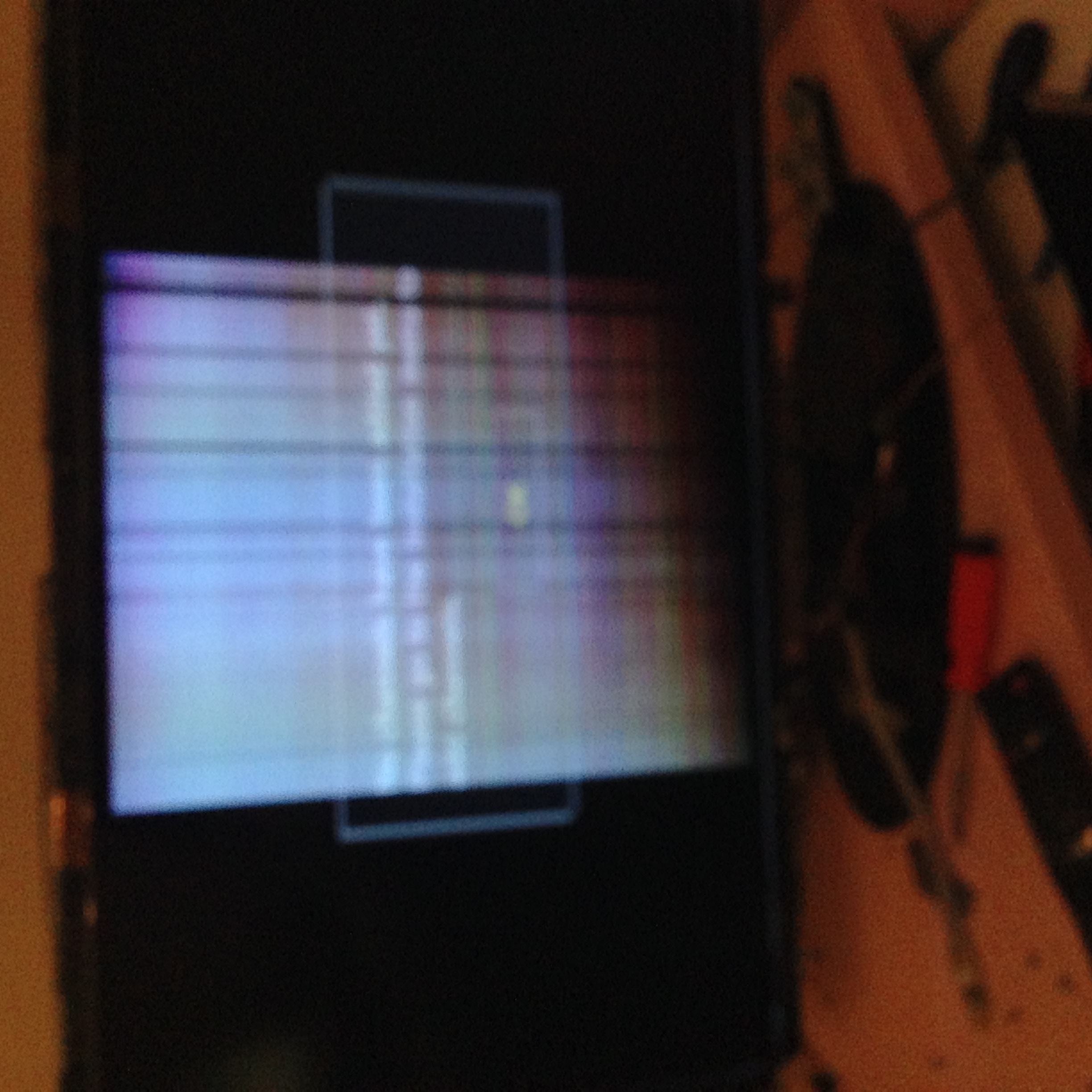

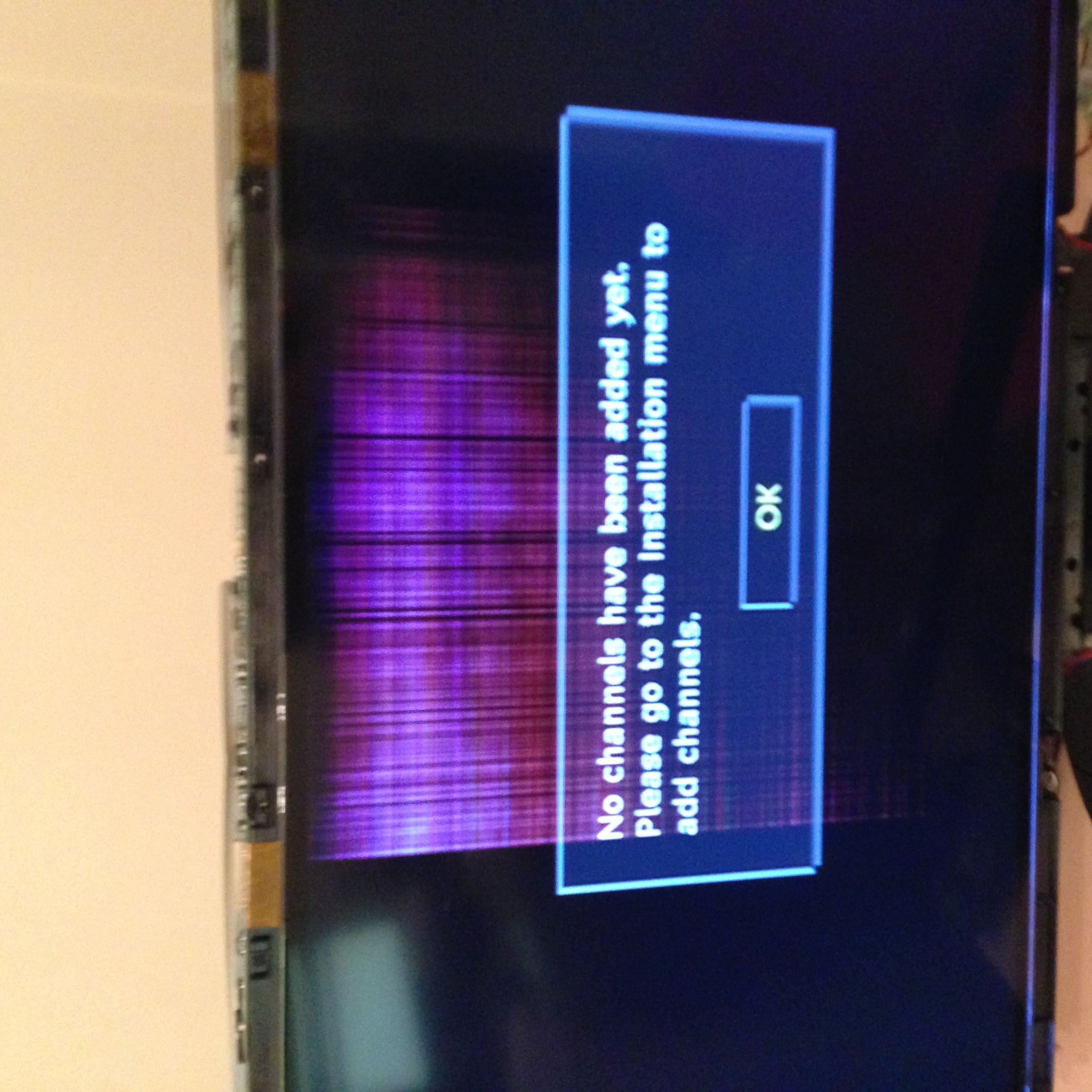

    Sanyo CE32L 32in LCD vertical lines
    Hey Guys got a Sanyo LCD, powers on all ok but after about 2 to 3 min I get red vertical lines down the middle of the panel slowly from the top all the way to the bottom, You think this could be a bad Panel?

    Re: Sanyo CE32L 32in LCD vertical lines
    Sorry about the poor quality of the picture
      Any ideas on this one?, can't see much of them out there, think it may be an old model
        From what I've seen before, bad LCD panel. Worth checking VGL/VOFFE and VGH/VONE voltages on T-con board though.
