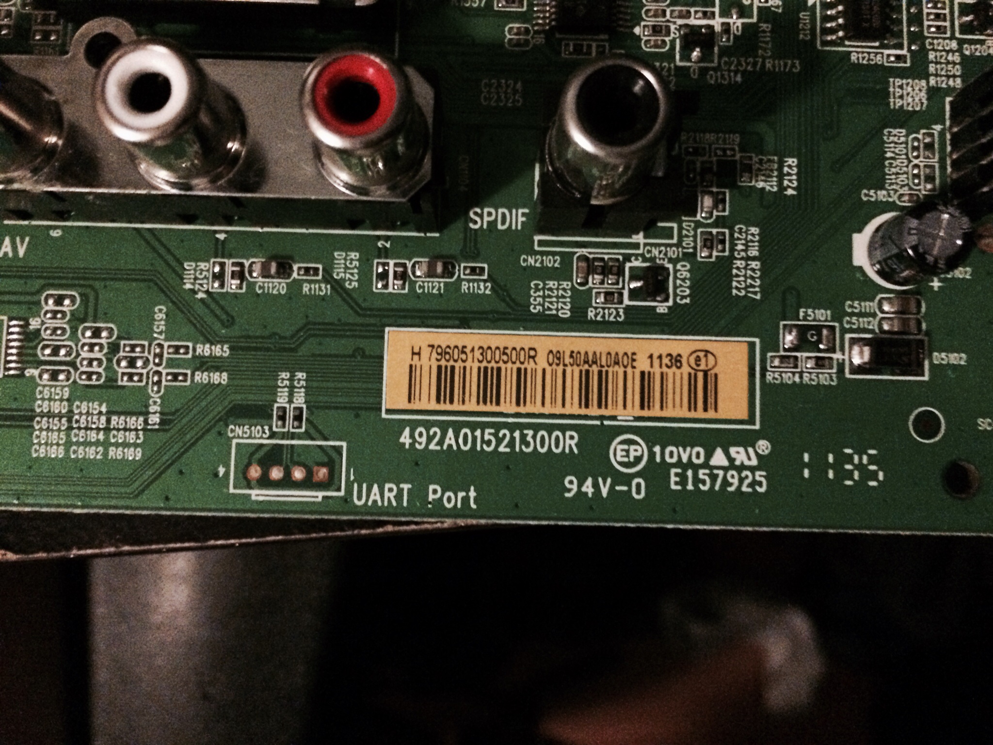

    Is this the right part?
    Model number of the tv I have is lc-42sv49u
    The part number on the main board is 492a01521300r. I found a part online with the same part number but the description says it's for another tv... The parts look the same but idk if it's the right part.
    Here is the link to the part
    http://populargadgetsale.com/index.p...product_id=619
    Help please

    Re: Is this the right part?
    Tough one especially since I don't have experience with these.
    795951300500R looks like the part number on the sticker. I'd run with that number because 492A01521300R appears to be the PCB number which may have several revisions.
    Jump onto SJ and try searching these numbers and models.
    I saw 492A01521300R for 32" and the 42" model you say advertised too which I'd be wary.
    Maybe ask for the number on the orange sticker and see if that lines up with yours.
    maybe the board can be reconfigured for a few panels within the service menu if that's accessible but i'm assuming now.
    really need a comment from someone who's worked on the sharp.
    Other than that not 100% sure what to advise

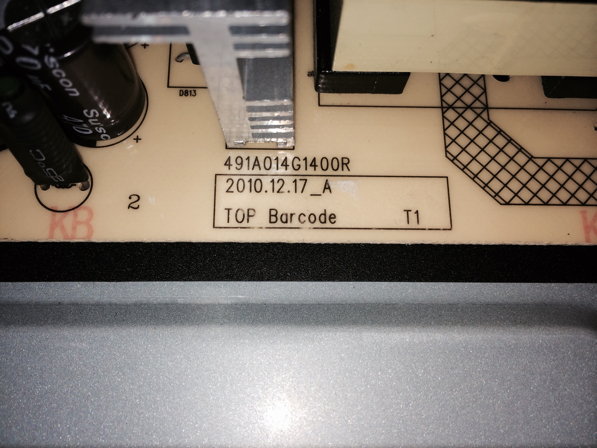

      This if the photo that I have from my board.
      The second picture is the PS. Unfortunately I took off the sticker in the power supply.
          So I'm trying to upload the pictures from my phone as it's giving me troubles but the first photo is the power supply and the second is the main board
            Me , I'd consider sending an inquiry stating the model, the pcb number and what's on the sticker to the seller and have them verify theirs matches and if it turns out to be incompatible will they take it back with no restock fee.
              "796051300500R" go by the P/N on the barcode sticker which is the PCBA (Printed Circuit Board Assembly- board that is stuffed with parts need for certain model, same blank board can be stuffed in many different way for needed modles)
