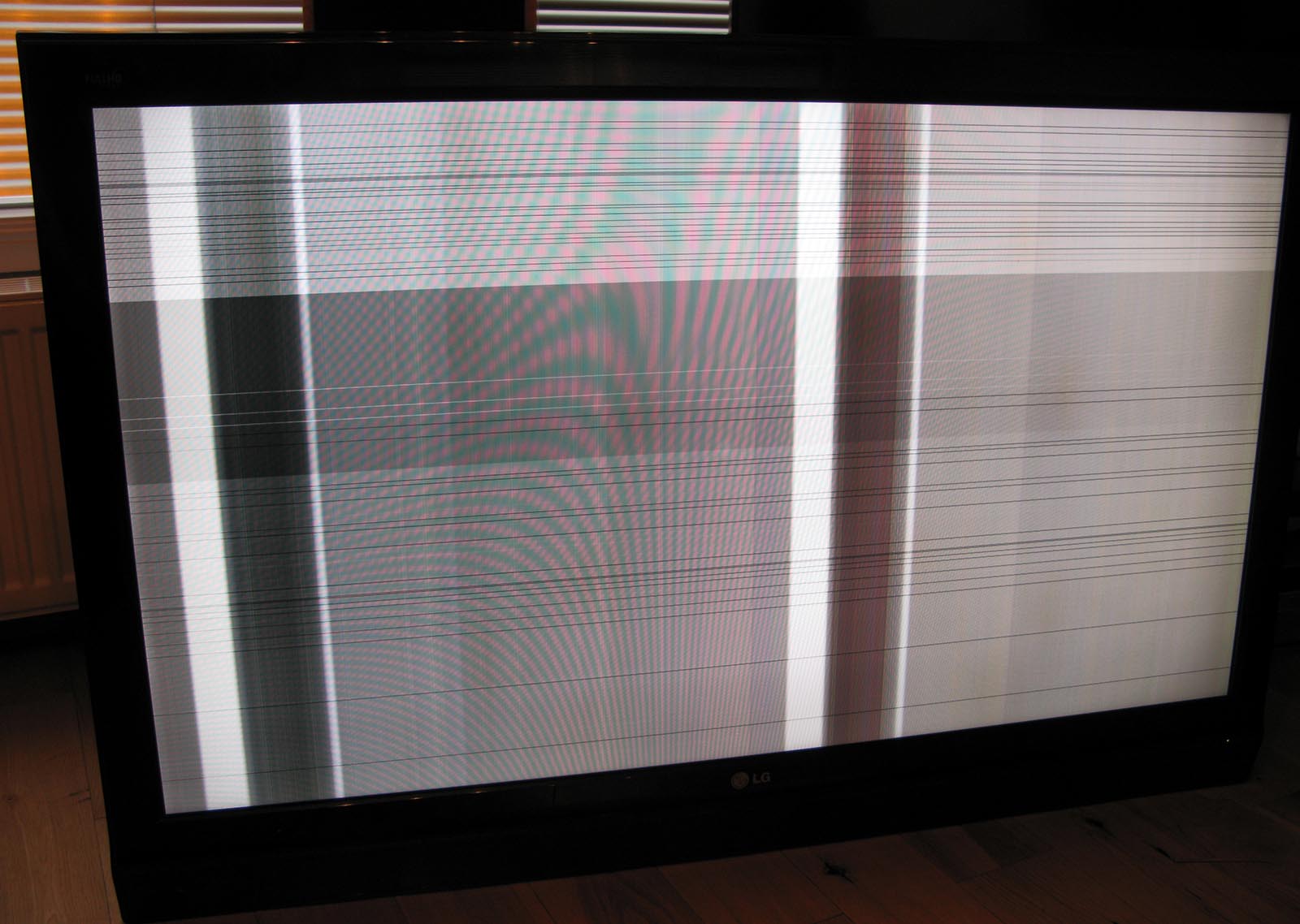

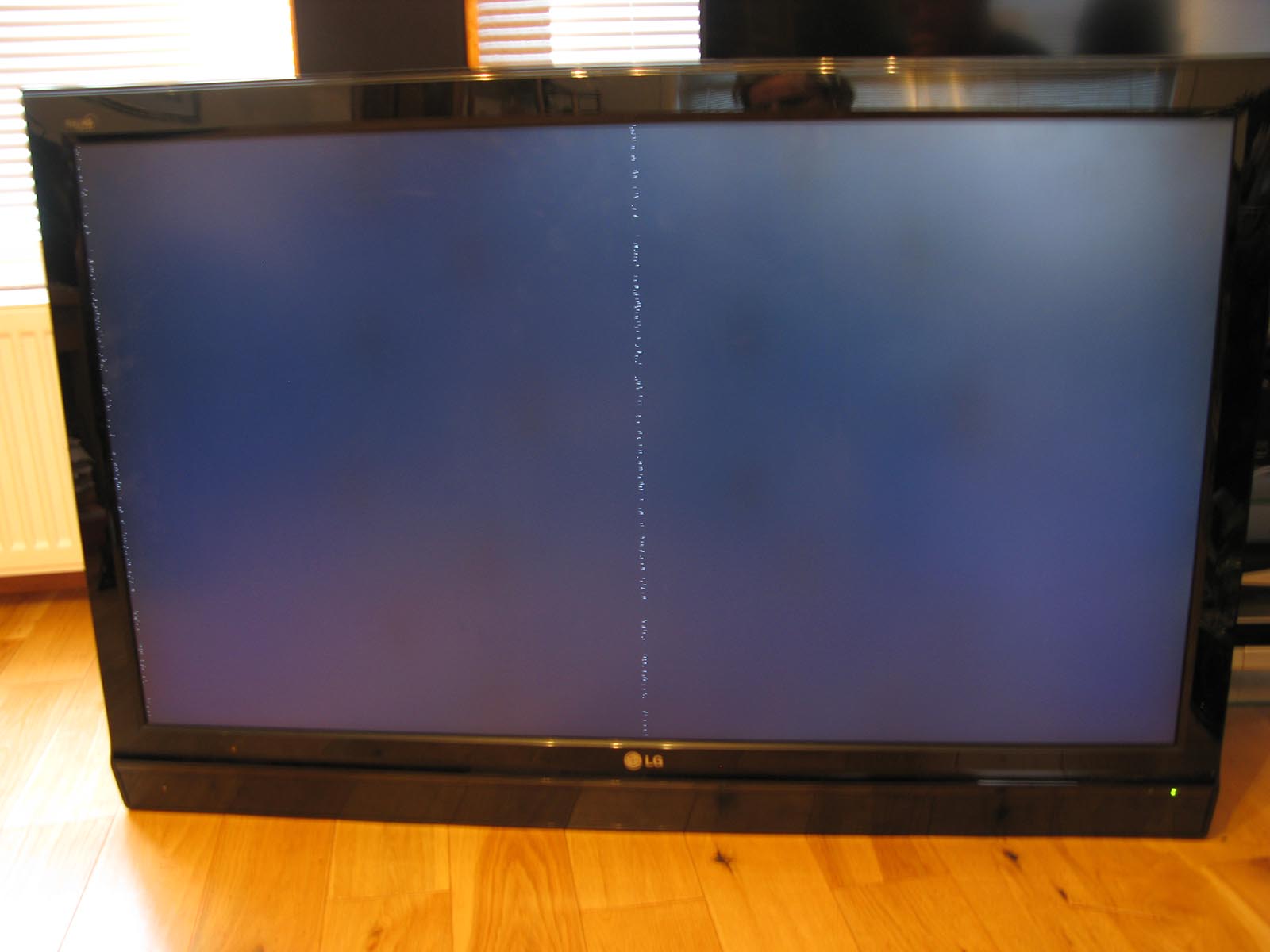

    Hi all
    I've got a LG 47LF66 47" LCD TV that has a screen issue shortly after switching on. Initially the screen goes black with 2 vertical dotted line then the screen goes to a cross hatch pattern. Still has sound. I'm thinking a faulty T-Con board. Any ideas (see photos).
    Many thanks
    Mac
  • kasfamily
    • Aug 2014
    • 774
    • Russia
    Re: LG 47LF66 LCD TV Screen Issue
    To verify disable CH2 or CH3 on the t-con
      Could be panel. I think that the main board on these can sometimes cause a similar effect - there's a tech bulletin that advises some ferrite beads be replaced on the main board.
