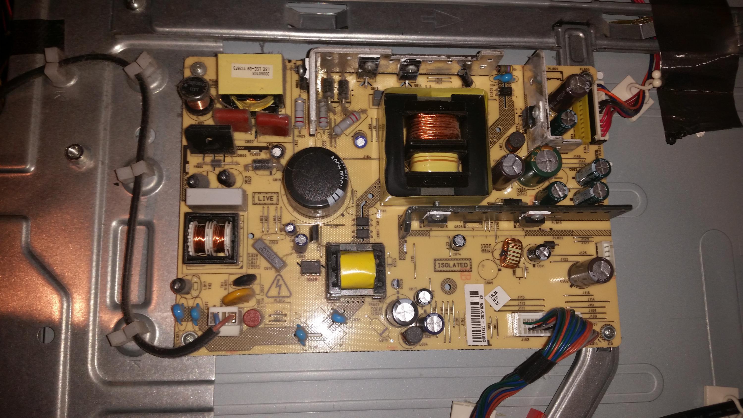

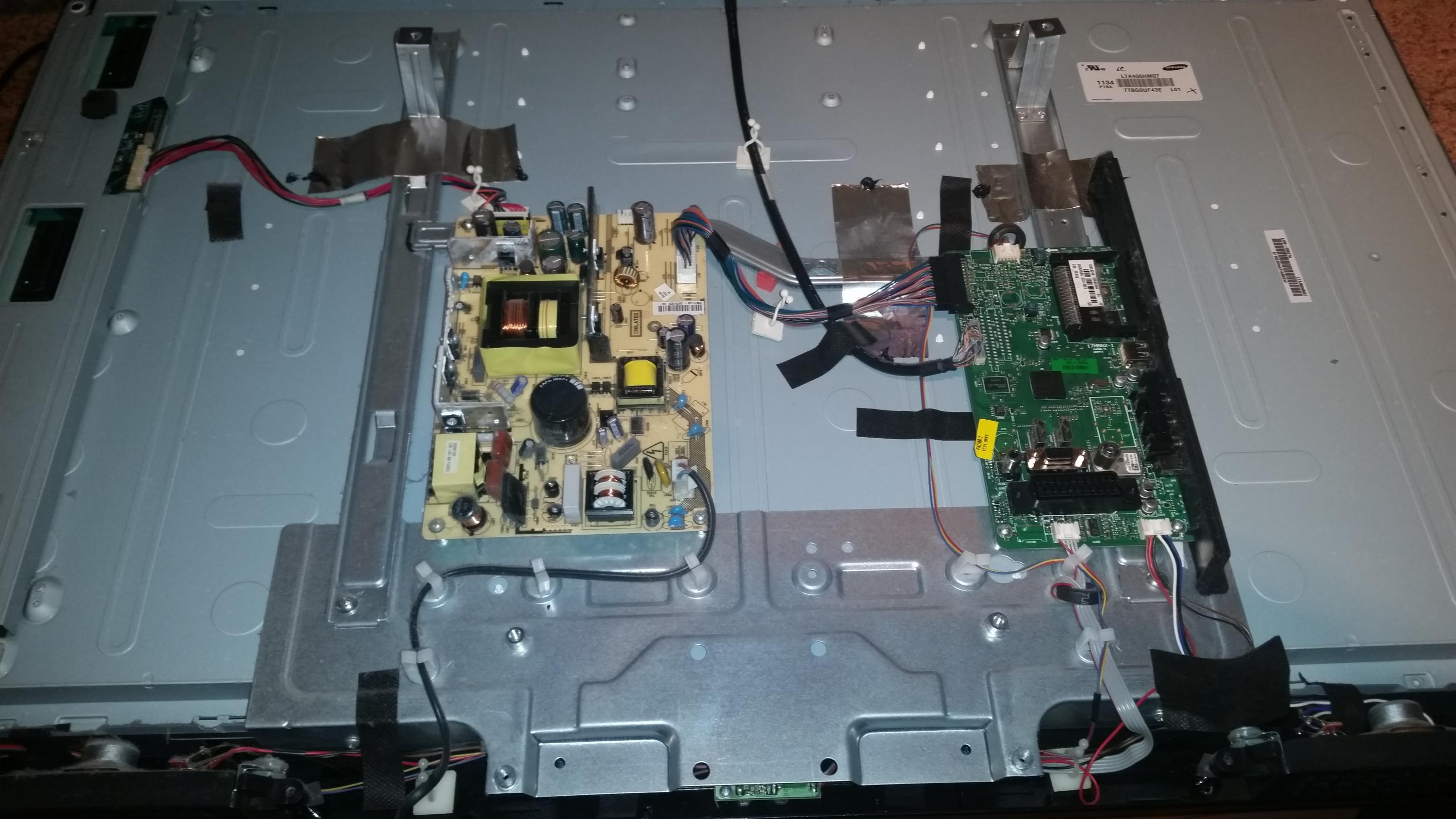

    got this tv today keeps losing sound every now and then
    PSU 17PW26-5 V3 250711
    MAIN 17MB62-1 V1 210411
    i cant find a schematic to check voltages or is it the same as 17pw26-4 ?
    thanks

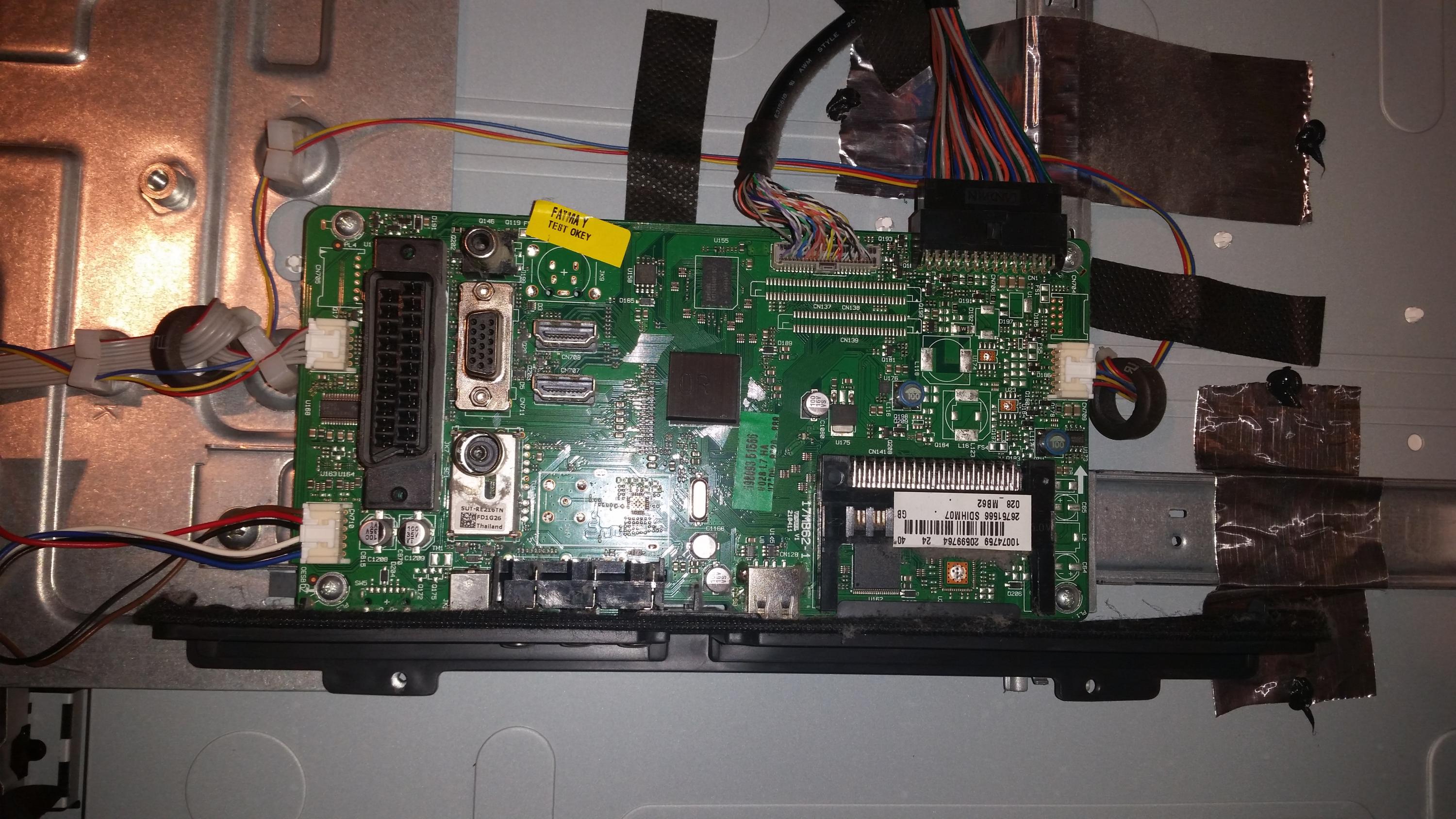

    on searching around it seems IC u168 when its faulty and gets hot it will cut out the volume anyone else experienced this ?
      Re: Lcd40883f1080p
      Common fault on these... requires a hot air gun to remove (has a thermal pad soldered on bottom of IC)

          Re: Lcd40883f1080p
          No need to spend that much:
          http://www.ebay.co.uk/itm/TPA3113D2P...item4ad7570897
          http://www.ebay.co.uk/itm/TPA3113D2P...item1e8d61e13e
          You will NOT be able to remove this without a hot air gun (at least, not without destroying the board)

            Re: Lcd40883f1080p
            Replace IC U168, or build a small sound circuit for the sound , if u happen not to get the same IC

              Re: Lcd40883f1080p
              Maybe I'm out of my element on this one but wouldn't it be easier to add a heat sink to the top of the chip, or is it done for by the time it starts cycling with the heat?
              Liberating magic smoke one part at a time
                Re: Lcd40883f1080p
                No, it'll only hide the problem. The chip has obviously suffered internal damage and will fail completely soon. Besides they don't run very warm in operation - maybe 10~15 degrees C above ambient - so the heatsink would have to be bloody good to stop that rise from occurring.
