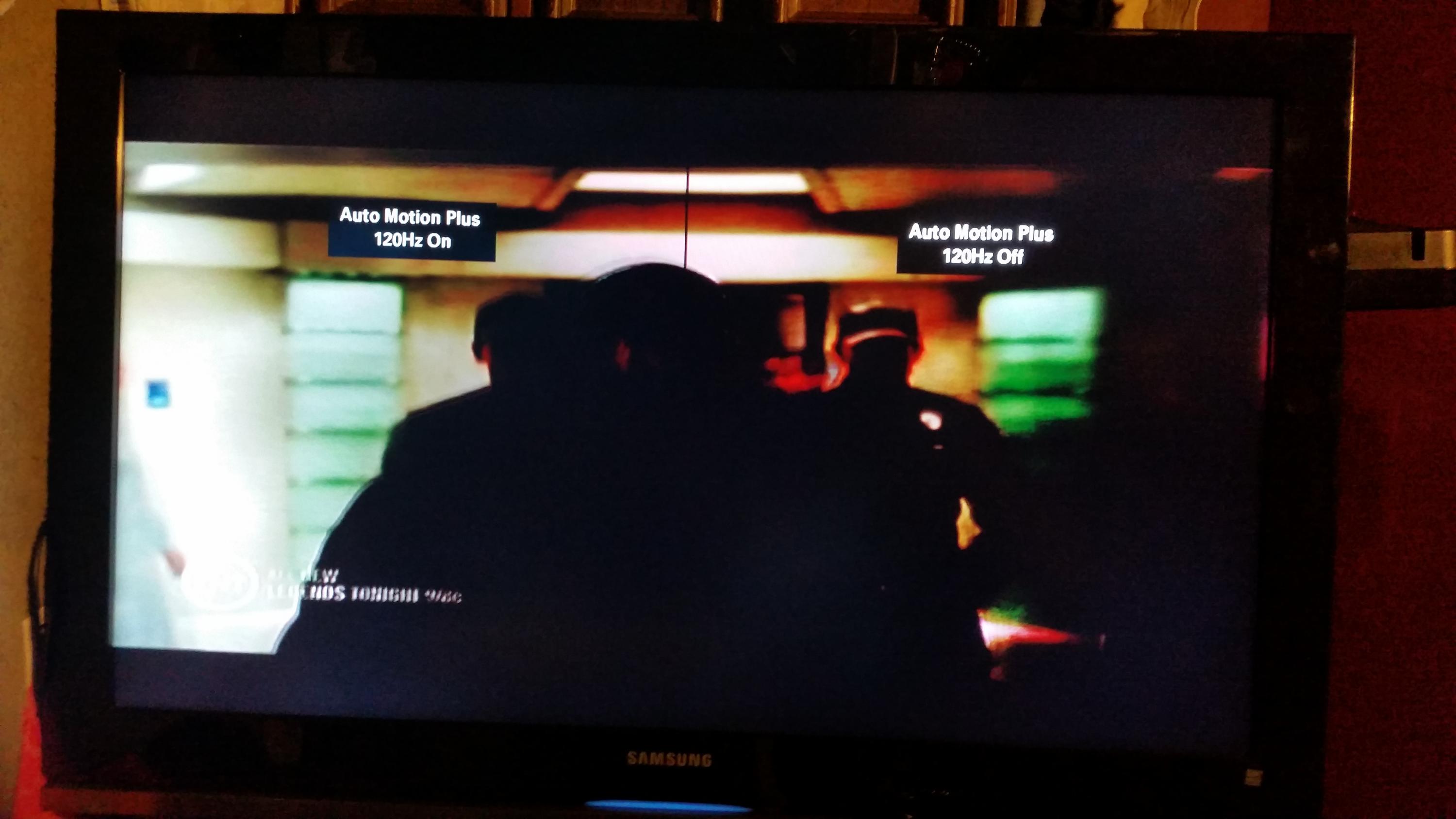

Samsung ln-t4069f right side of screen messed up.
    Just want to get some ppl opinions, I think It might be a bad screen. Someone just gave me the tv, So history I don't know. I had to replace the 4 10v 1000uf caps to get it working. when I turn the tv on the right side of the screen is messed up.

    Looks like a gamma chip failure, photos of the boards and t-con.
      Re: Samsung ln-t4069f right side of screen messed up.
      I'm gonna disagree and say bad panel because it looks like only half the panel is affected... gamma would affect whole panel.

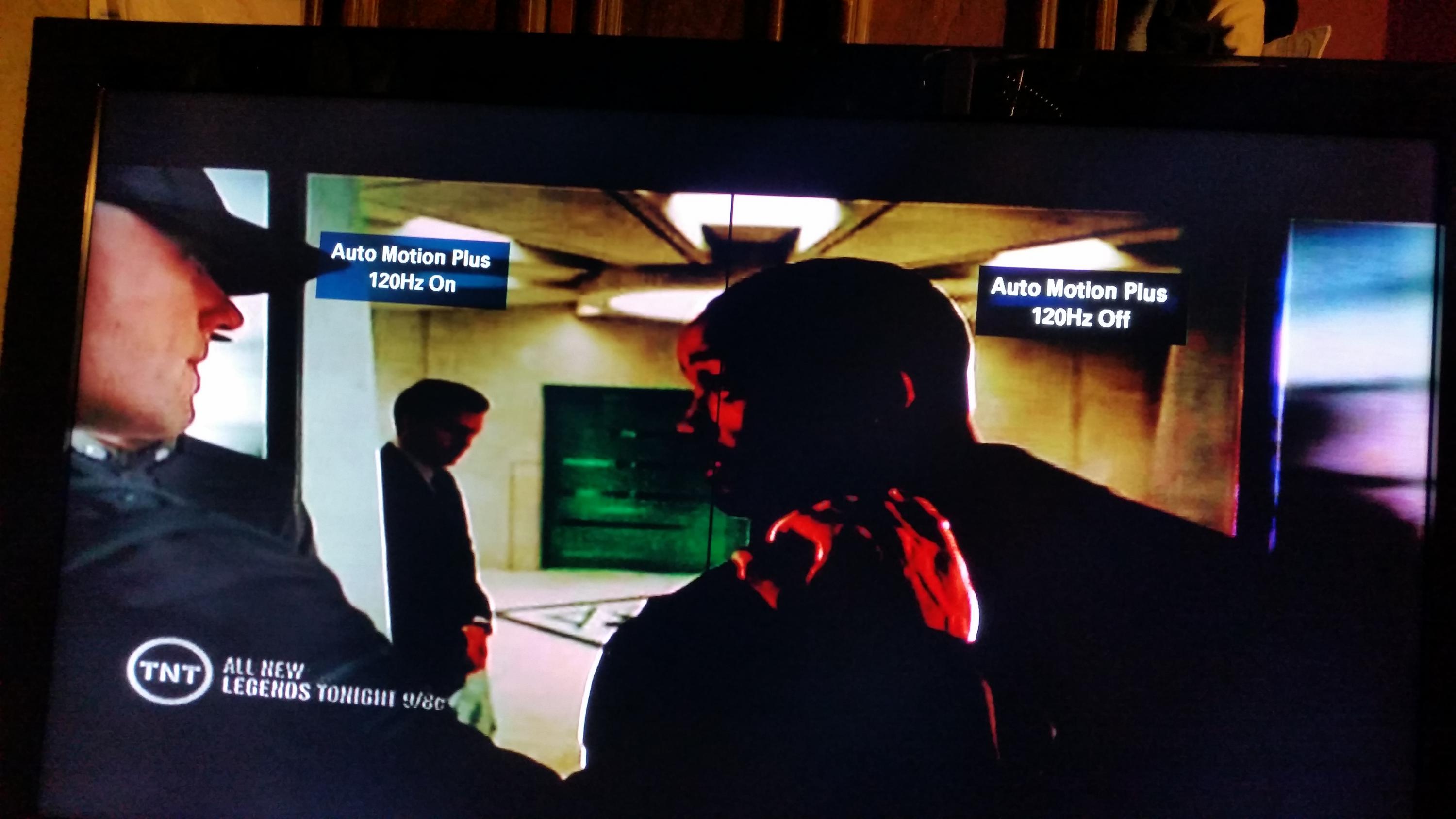

        Possible, BUT if you look at the ODS for the 120hz its not being affected on both sides.
        Also if you look at Bro's face in photo his face is crossing over the middle and it looks very solarized on both left and right. As well as the FBI agent in the backround.
        The Dude up close to the left, has a red halo around him.
        Try this op, with the TV off, if you have the original remote hit in sequence MUTE,1,8,2 and power. This will put you in to service mode from here locate the menu option that has the test patterns and run those and see. Using a TV signal is the worse way to trouble shoot as all sorts of things could be affecting the picture.
        Tom66 is probably right but eh might as well check it out anyway for your own piece of mind!

          I say might as well check the GAMMA Voltages just to see what they are like for future reference.
