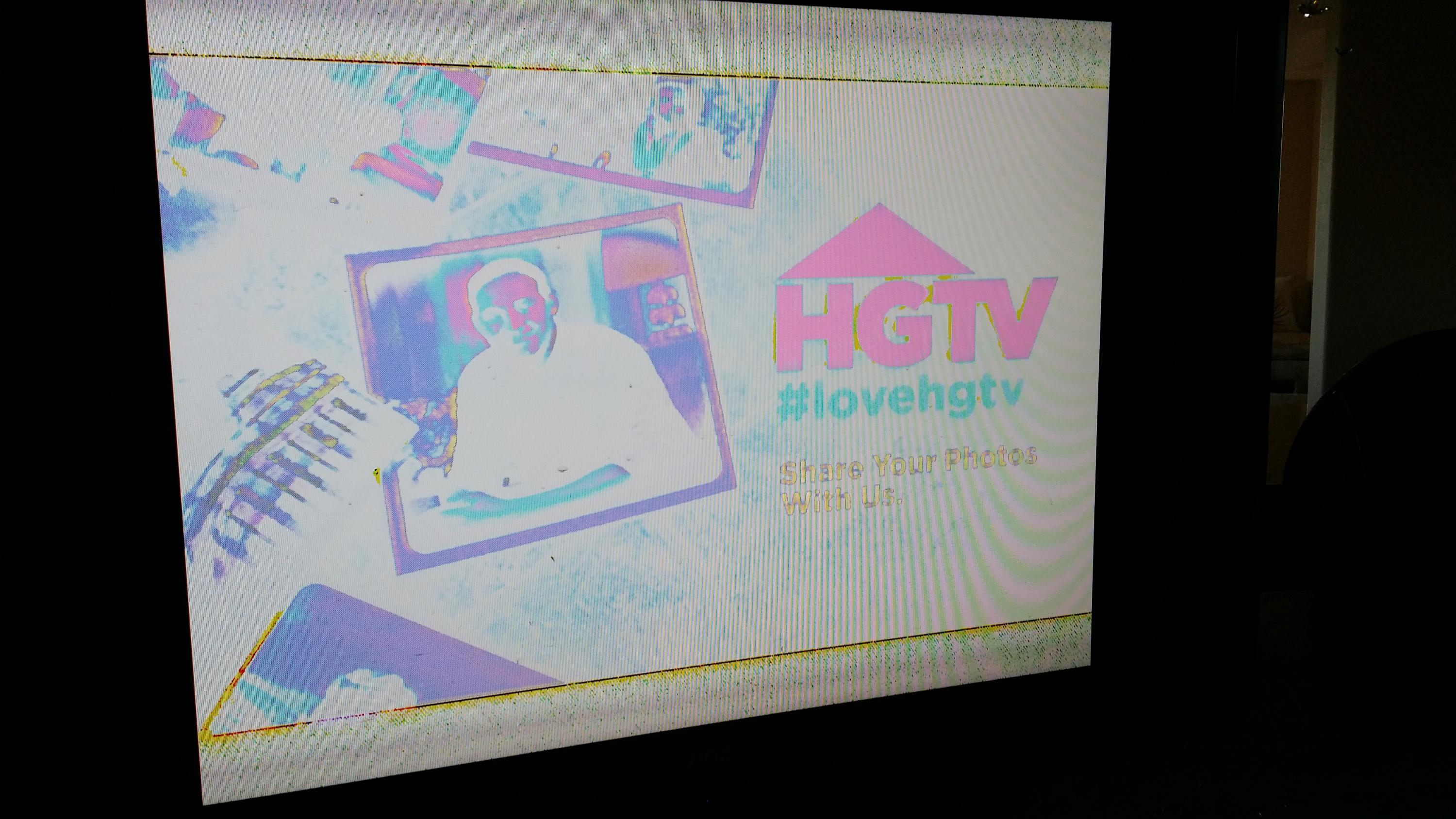

Envision/AOC L32W861 - incorrect (inverted?) color
  • X5-452
    • Apr 2014
    • 13
    Picked up an AOC L32W861 (along with a few other tvs ) before curbside pickup took them to a landfill. The color comes up looking like it's inverted. I haven't opened it up yet to see if there are any visibly bad components yet.
    Any help would be greatly appreciated.
    Re: Envision/AOC L32W861 - incorrect (inverted?) color
    That looks like bad GAMMA Voltage reference problem in the T-CON board.
    • X5-452
      • Apr 2014
      • 13
      Thanks, I'll tear it down tomorrow and have a look.
