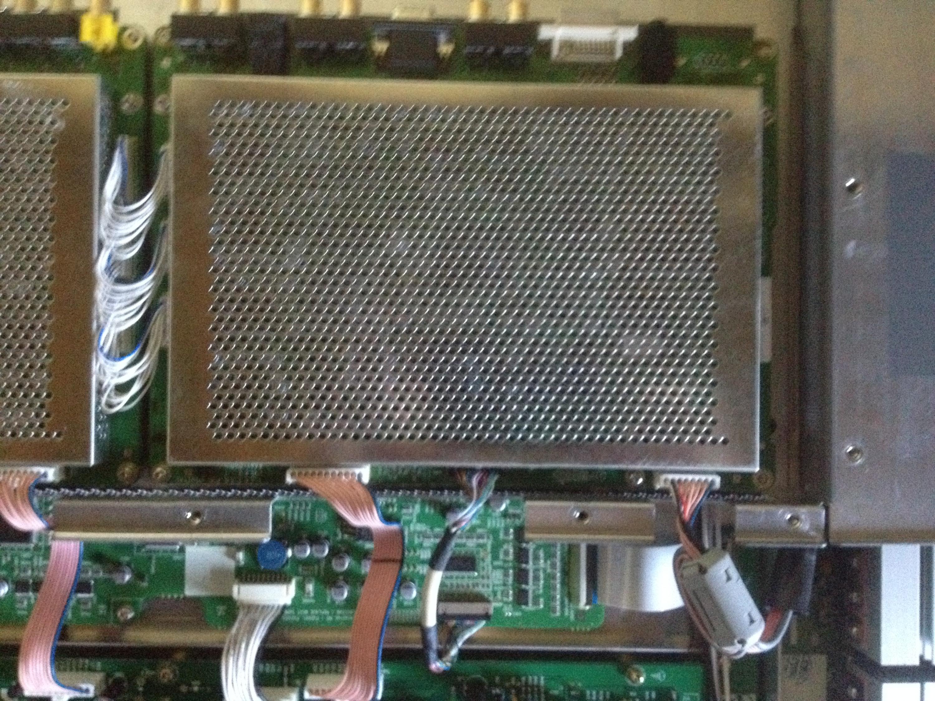

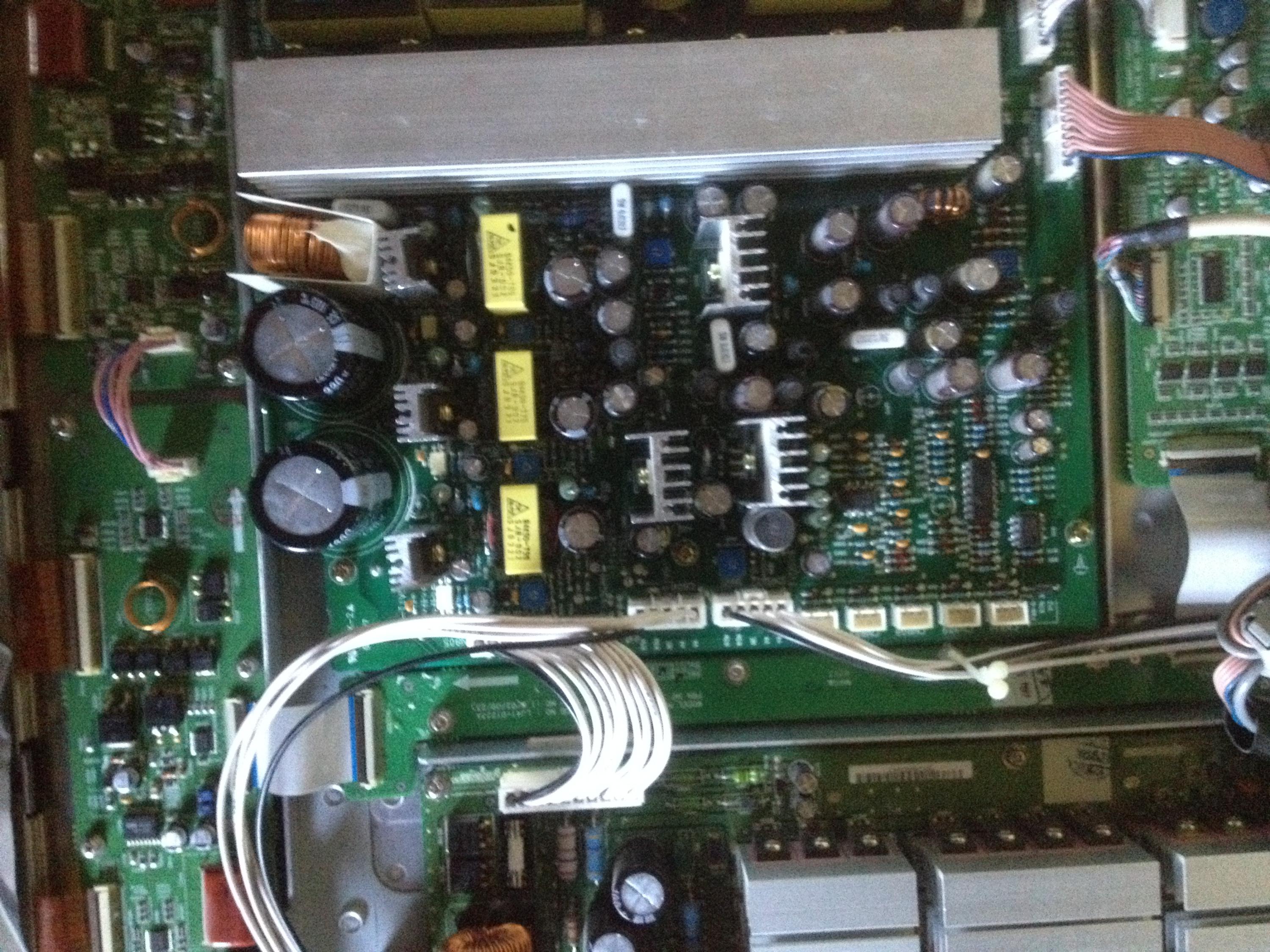

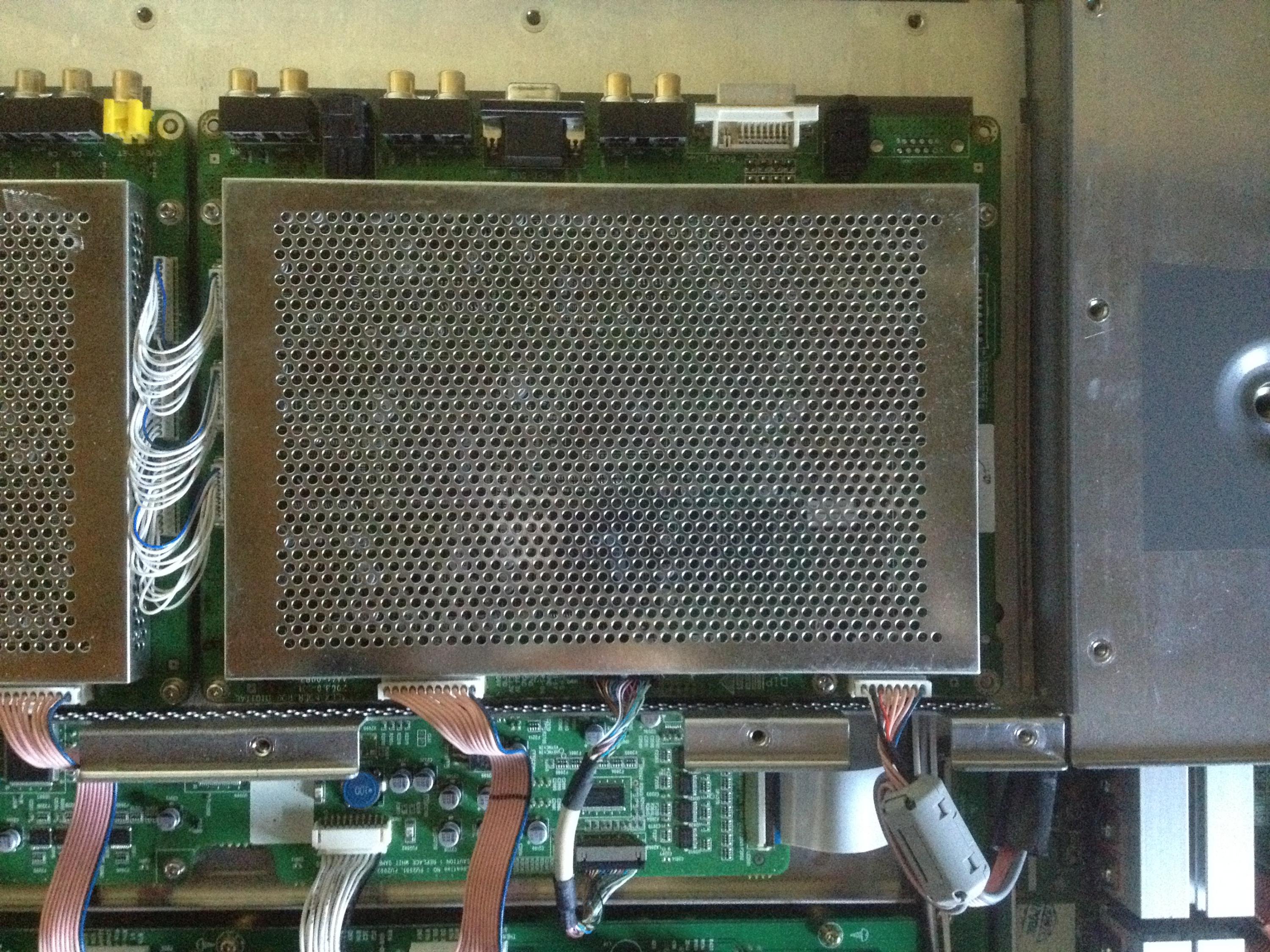

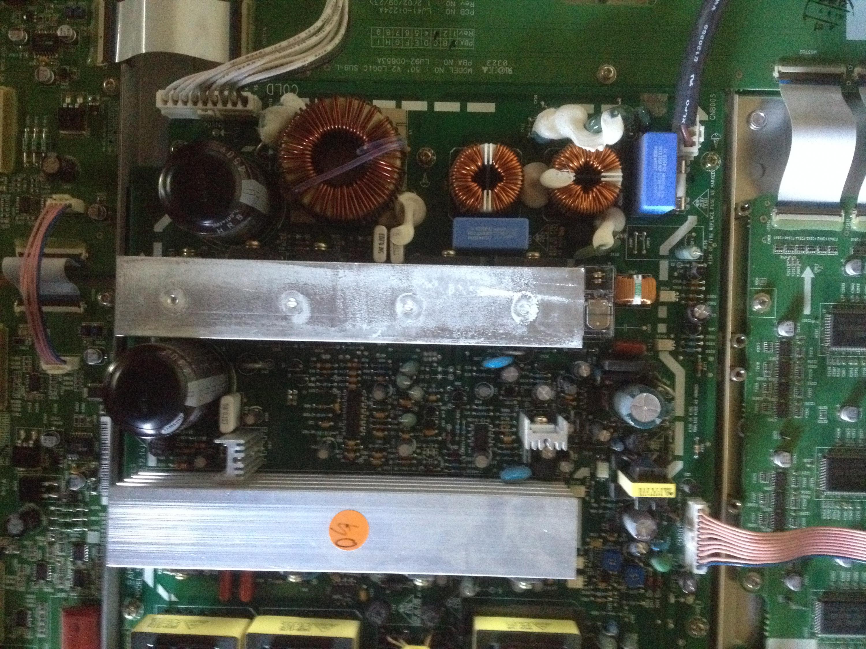

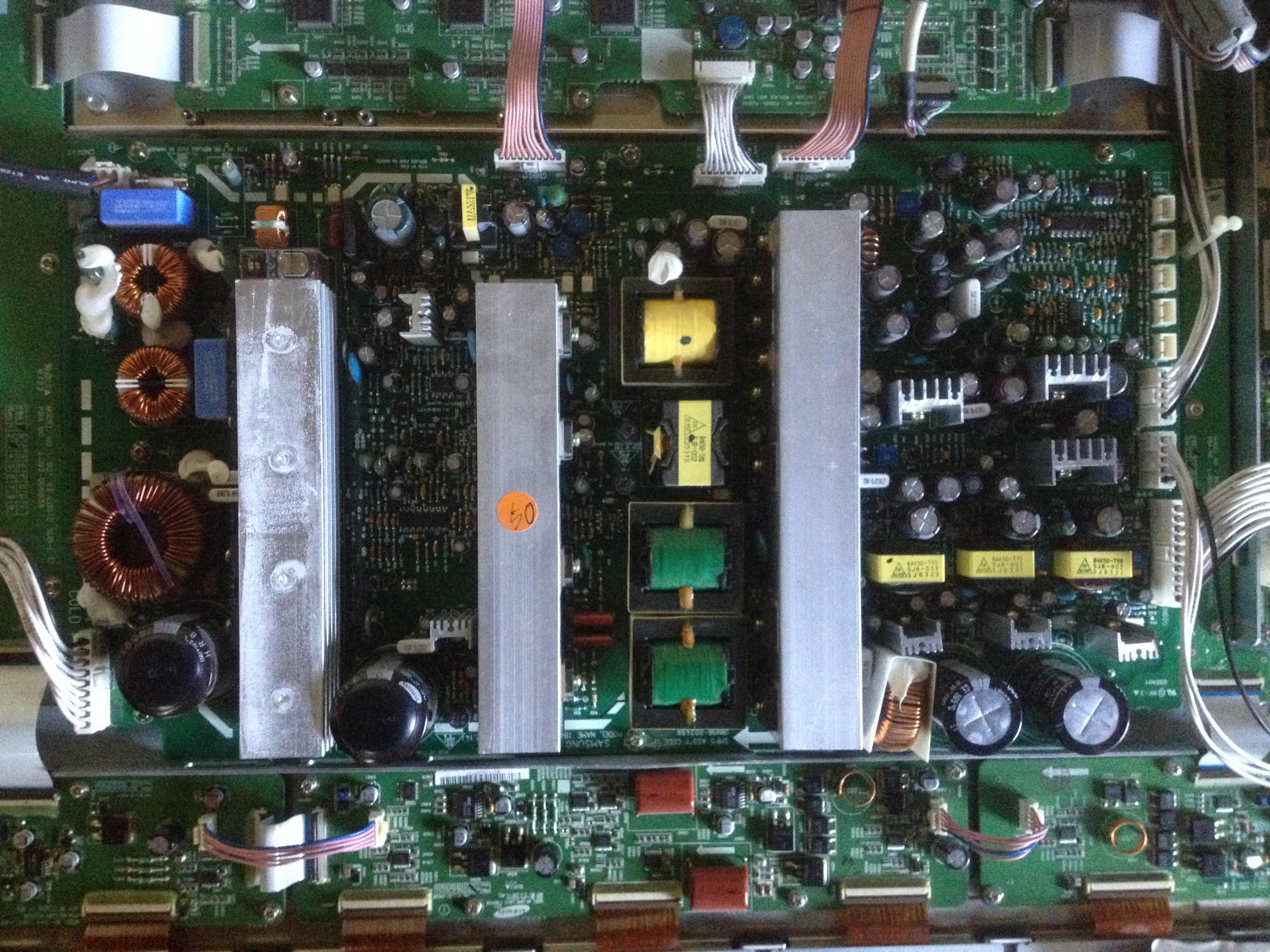

    I have this TV that will not power up.
    I took the back off and check for the 5vdc stby voltage on the power supply at connector CN804 and the test point and I am getting 2.9vdc. The PS ON voltage is 1.6vdc on connector CN802.
    When I use the power button on the side of the set I hear a click then a short fizzle sound next to connector CN804. When the TV is originally plugged in there is a red led on the front. When I push the power button it blinks 5 times then it goes out.
    Here are some pics of the power supply.
    Any help would be appreciated.

      Re: samsung hpn5039 ax50p3 doesn't power up.
      Changed power supply. Get stby 5vdc getting ps on voltage.
      Checked
      V5D- 5.3vdc .... 2.1vdc
      VG- 15vdc.... 14.8 vdc
      Vscan- 95vdc..... 78vdc
      Vs- 88vdc..... No volts
      Vest....126vdc .... No volts
      Ve..... 115vdc.... No volts
      Va...... 76vdc..... 78vdc
      Can anybody help?
      • Alastair E
        Chief Womble
        • Mar 2013
        • 1963
        • U.K.
        You have no Vs.....
        Check for shorts on the Vs line. Try running with first Y-SUS disconnected from PSU, then X-SUS disconnected from PSU--See if the voltage returns at the PSU with either disconnected.
        If not, then you probably have a faulty replacement PSU.
        TELEFIX
        • Bob Neely
          • Oct 2013
          • 41
          Thanks Alastair E.
          I did disconnected the X-sus and Y-sus boards after the post. No change. I guess the PSU is bad. I will look for the short on the VS line.
          Anybody know where I can get the schematic for this unit?
