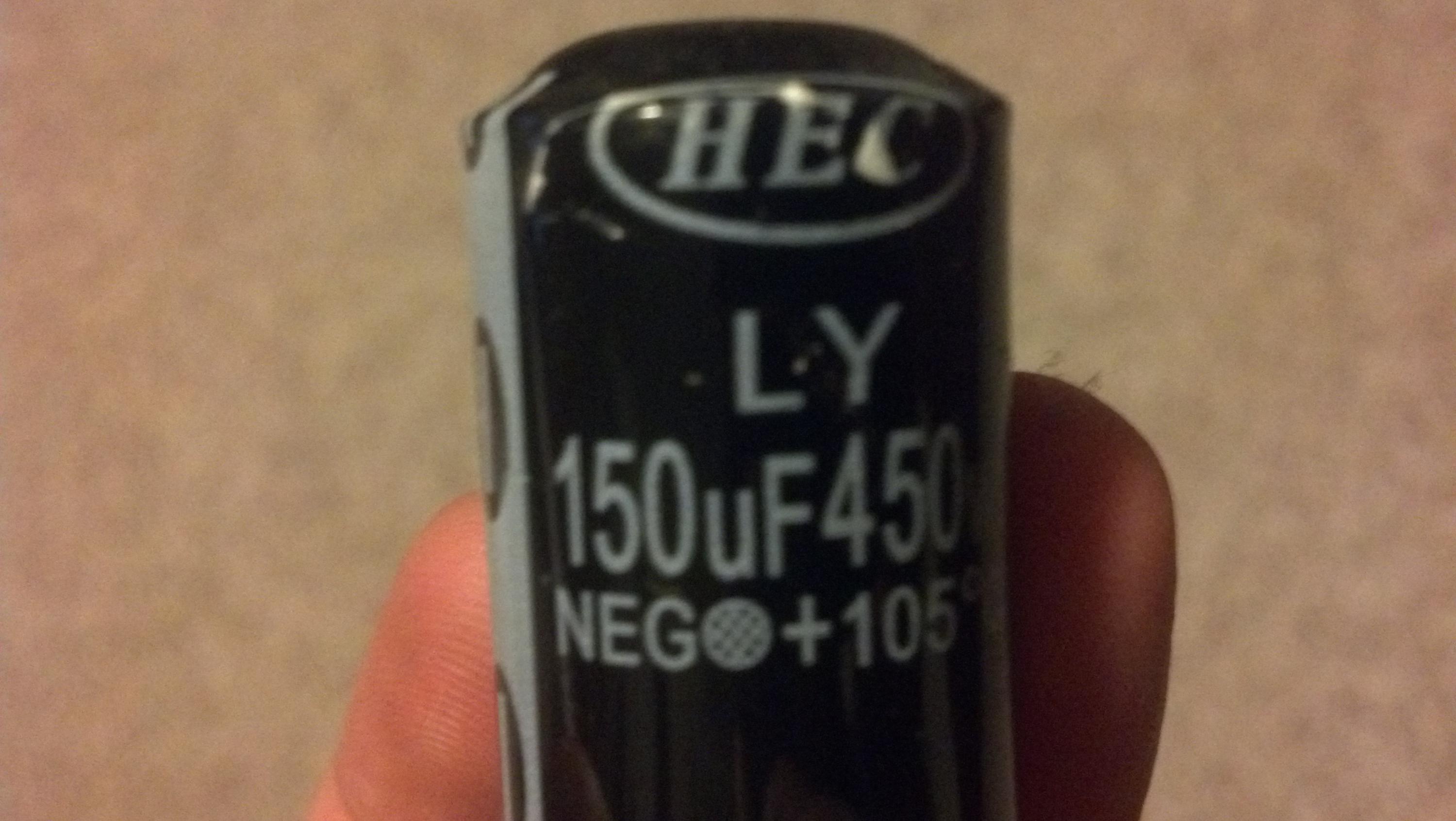

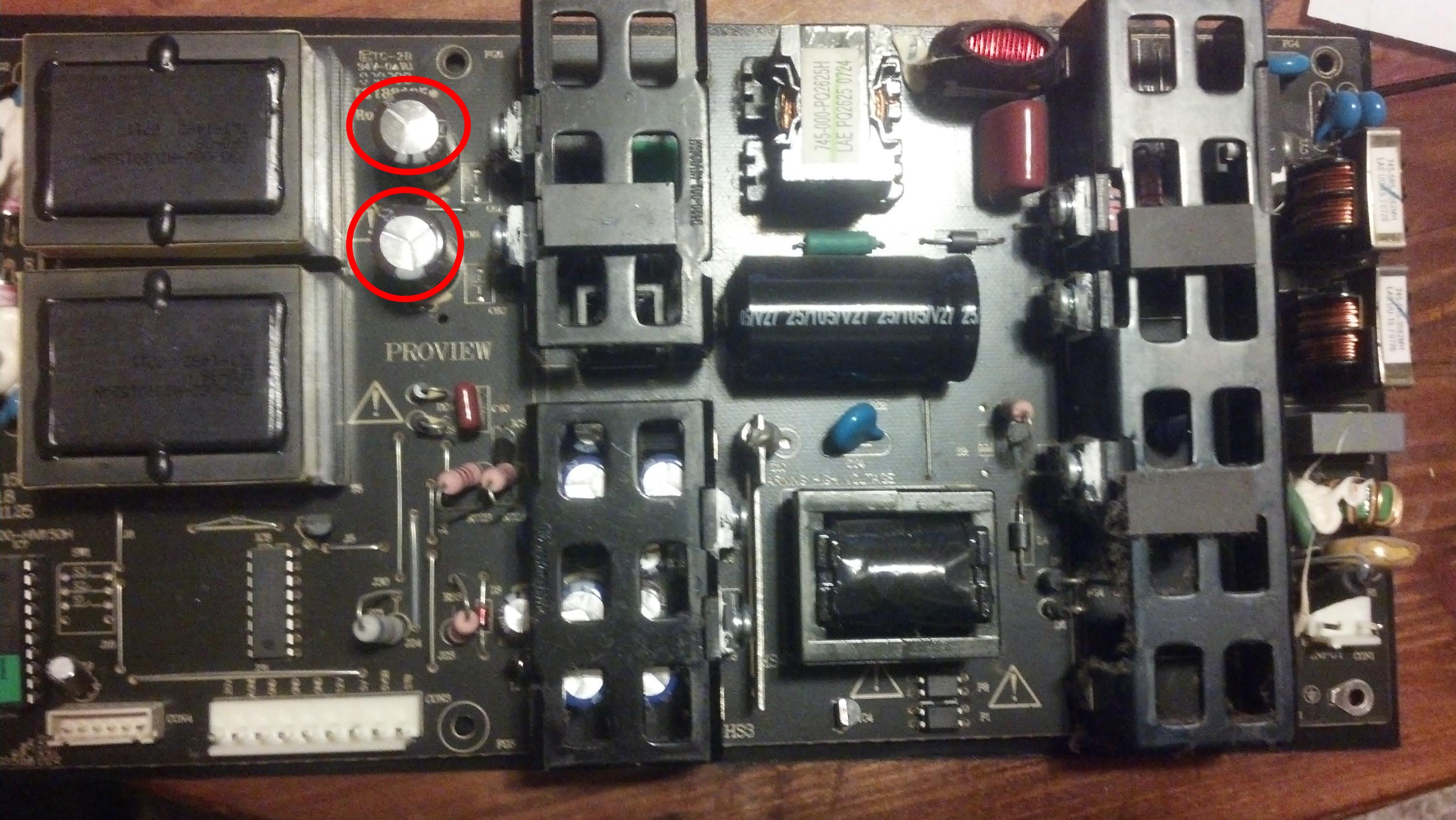

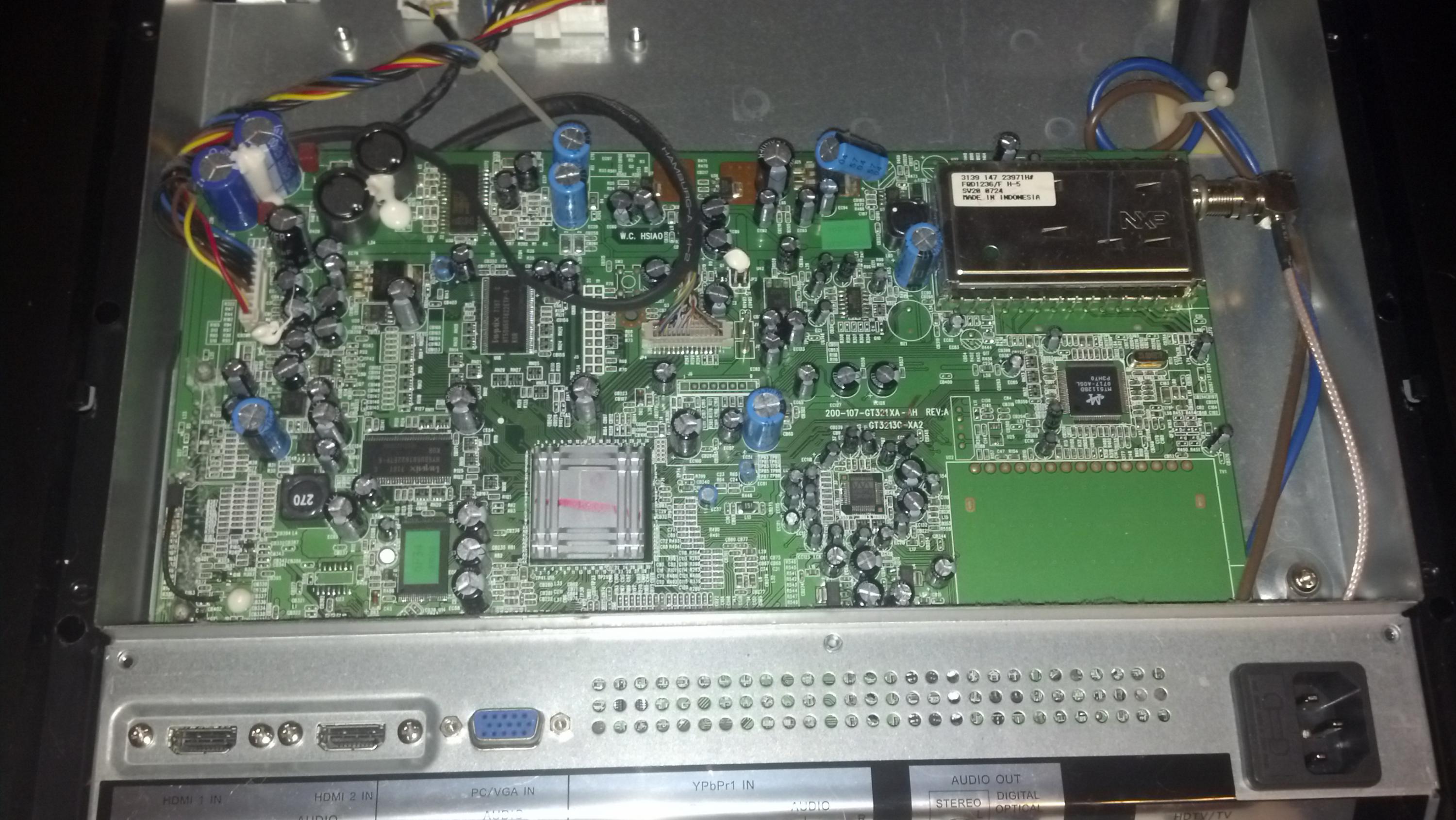

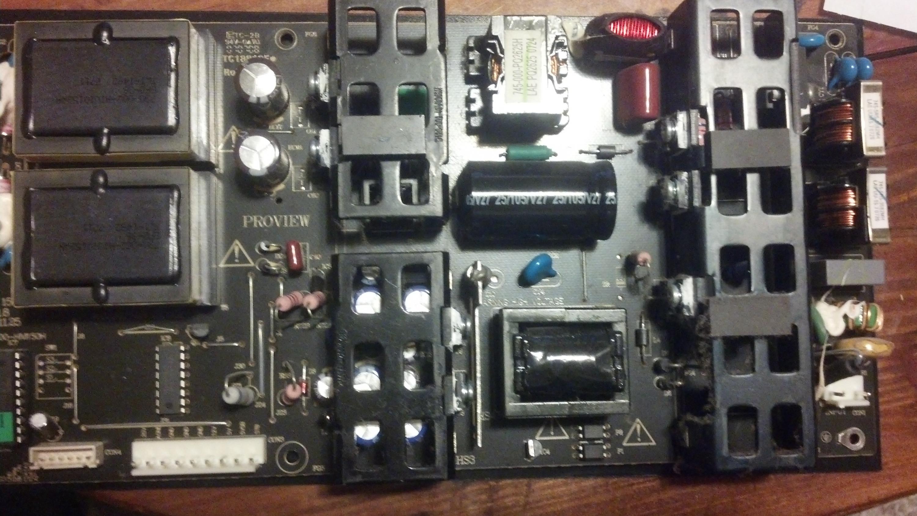

Ok.. to start, Polaroid knew that this was a crappy design so well that they put a "Quick Access" panel on the back which requires removing one screw to access the power and main board. Not a good sign lol. To add insult to injury, let's use scrap metal bars with globs of solder on them for jumpers and junction points! Look at the main board... someone was scared to death of tantalum. You know it's bad when they are using fake knockoff versions of chinese junk knockoff caps. Look at that 450v filter cap. holy shi... anyways, that's my rant lol. enjoy

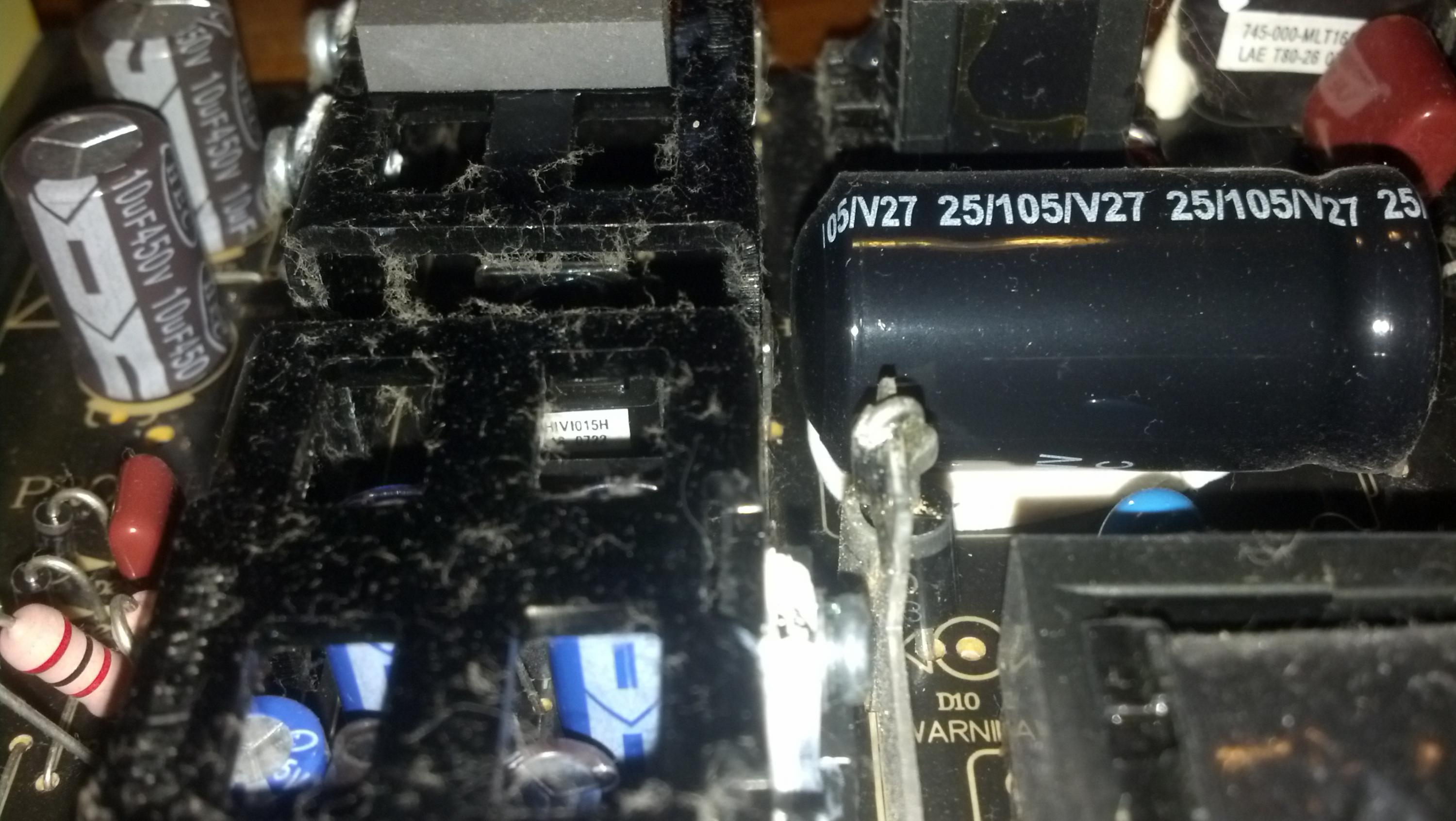

That and the filter cap are the only issues with this one too. Just an extremely cheap/ cheesy designYou Can't Succeed Until You're Willing to FailComment

You should remove that plastic piece off that main filter cap that looks domed, I think it is just a deformed plastic piece. The common problem with no backlghts are due to the two 10uF 450VDC caps by the inveter transformer, from the look of the picture, looks like the top one has slightly domed top.Never stop learning
http://www.badcaps.net/forum/showthread.php?t=24809Comment

That primary cap looks like it's about to pop its top!!ASRock B550 PG Velocita

You should remove that plastic piece off that main filter cap that looks domed, I think it is just a deformed plastic piece. The common problem with no backlghts are due to the two 10uF 450VDC caps by the inveter transformer, from the look of the picture, looks like the top one has slightly domed top.even if it is a silly designed tv
