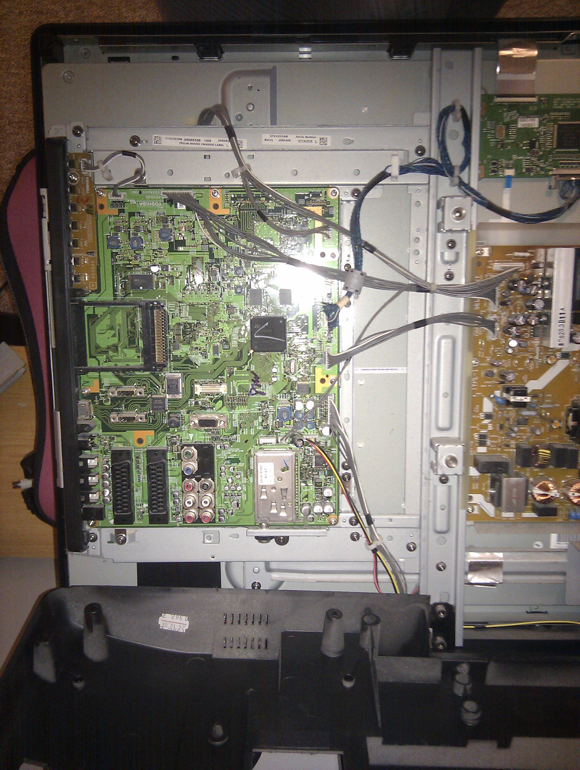

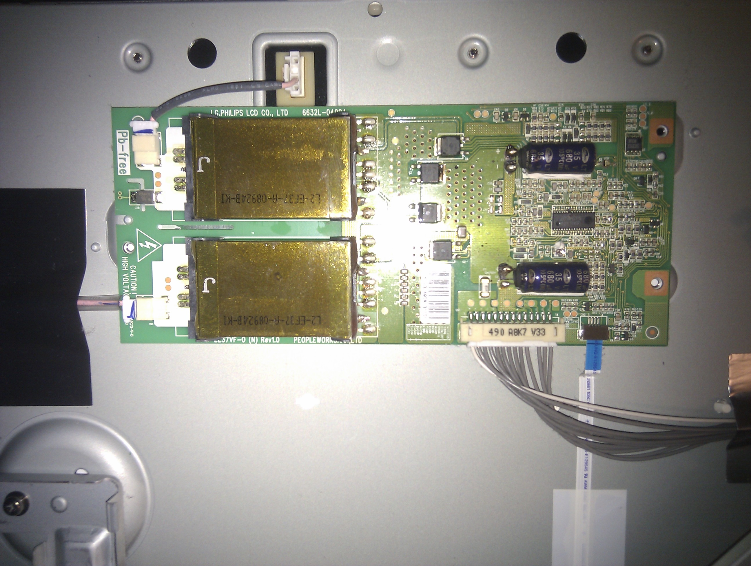

    Good evening all.
    Purchased from new 5 years ago.
    Never had a problem until suddenly while active, screen turned black.
    Usually get a grey image when screen is trying to produce black colour but this is totally black, as if off.
    Power LED turns green as normal as does sound. Remote IR is responsive but no screen action.
    I tried shining a light from the side but to be honest I don't think any light can get through so I cannot confirm if there is a faint image.
    Called toshiba technical support who told me screen malfunction and not economical to repair and tried to sell me another model.

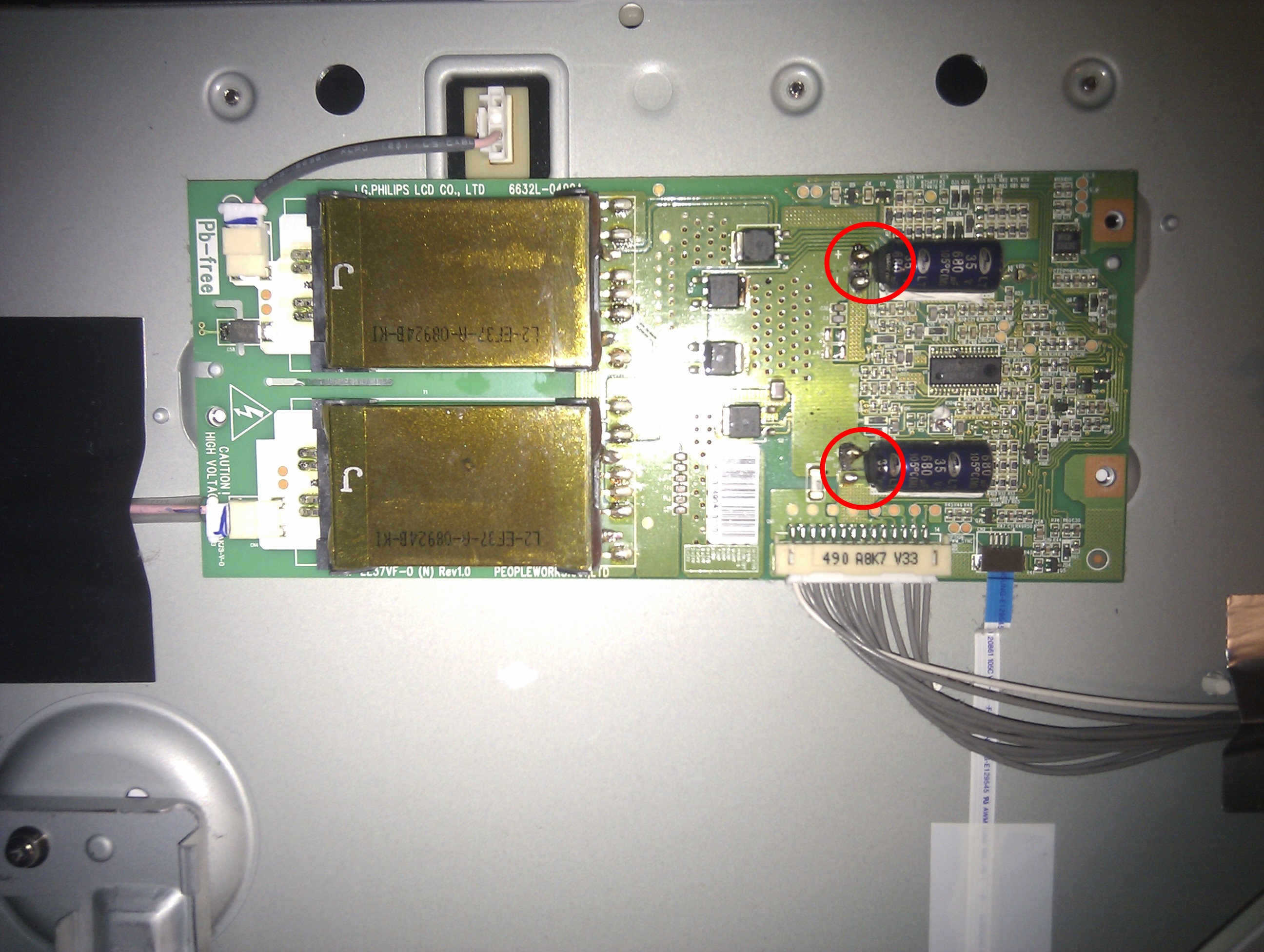

    Contacted a spares website who said the first port of call would be the inverter. I've taken pictures and attached as requested and would be very grateful for any assistance and support.
    Thanks!!
    Re: Toshiba 37XV553DB sudden no video but sound ok
    There are two inverter boards, right?
    It looks like the bottom seal of the caps are popping out.
    You need to check the fuses and see if you do have 24VDC feeding the inverter boards or not.
      Thanks for the fast response.
      I'm not sure if there are two boards; I will have to check under the other side.
      I can confirm that while shining the light directly on the screen I DO get a faint image.
      So now I have to go buy a multimeter to follow your instructions; are either of these ok or do I need something more high tech?
      http://www.argos.co.uk/static/Produc...er/7015603.htm
      http://www.maplin.co.uk/p/mt-2017-la...ltimeter-n60lk
      I am willing to learn and I do have patience so please forgive me if I ask for extra detail.
      When I am checking the fuses, what am I looking for and how do I do it?
      Also, how do I check the voltage please? Where do I put the prongs?
      Thanks so much.

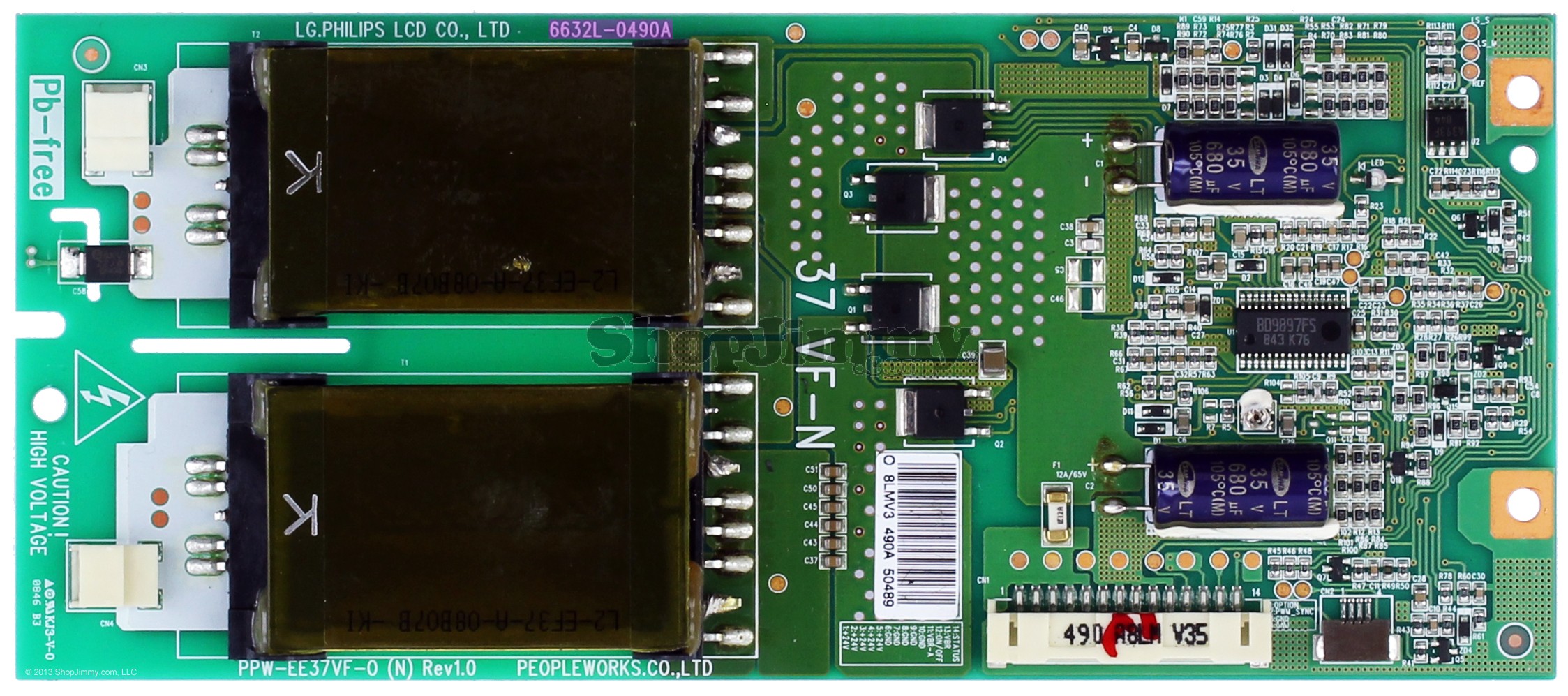

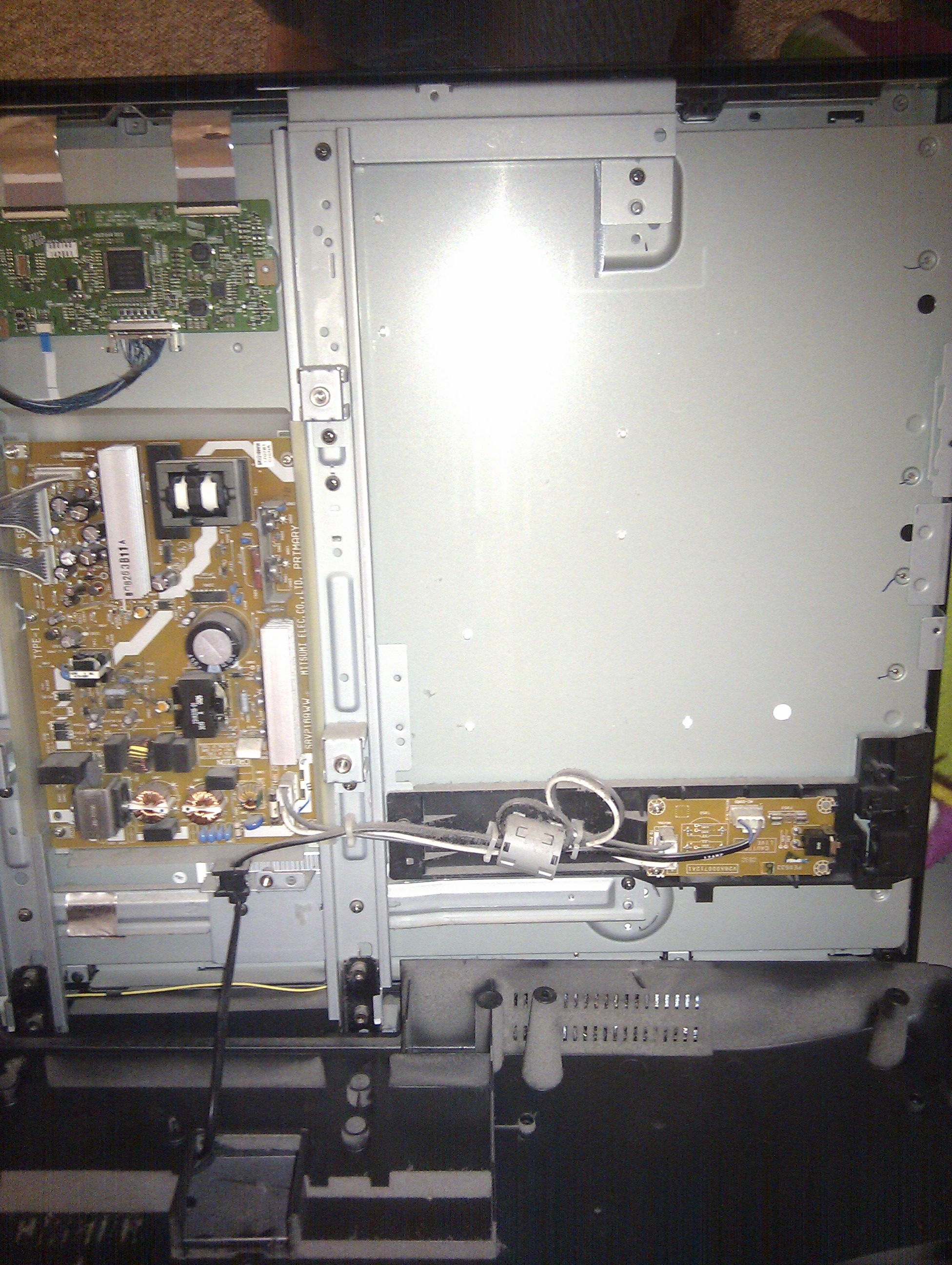

        OK, check with Shopjimmy, it looks liek your TV may use only on Inverter board, but we will know when we see the whole back side of the TV.
        http://www.shopjimmy.com/lg-philips-...t-inverter.htm
        If you look at the picture of the inverter board from Shopjimmy, you can easily see that the rubber seals are in the right position compared to what yours look like.
        http://www.shopjimmy.com/media/catal...-0490a-top.jpg
        Credit Shopjimmy for providing the pictures. I say you do have two bad caps (SAMWA LT series, they are known for bad caps) at least.
          Definitely.
          Very clear, thanks.
          Does the letter on the rectangular pad matter? Mine states J butr a few I've seen with the same part number state K.
          Any ideas?
          Thanks again.
            The numbers on the barcode will be the one to use.
              Thanks dude, I'll source the right one and give an update!
              • Jess
                • Sep 2014
                • 10
                • uk
                Hi. I wanted to inform you that I had purchased a spare from CHS interactive which has the same product number but a different barcode (I couldn't find a seller that had the same barcode) and the replacement worked.
                Thanks so much for your help.
                  Thanks for the repair follow-up.
