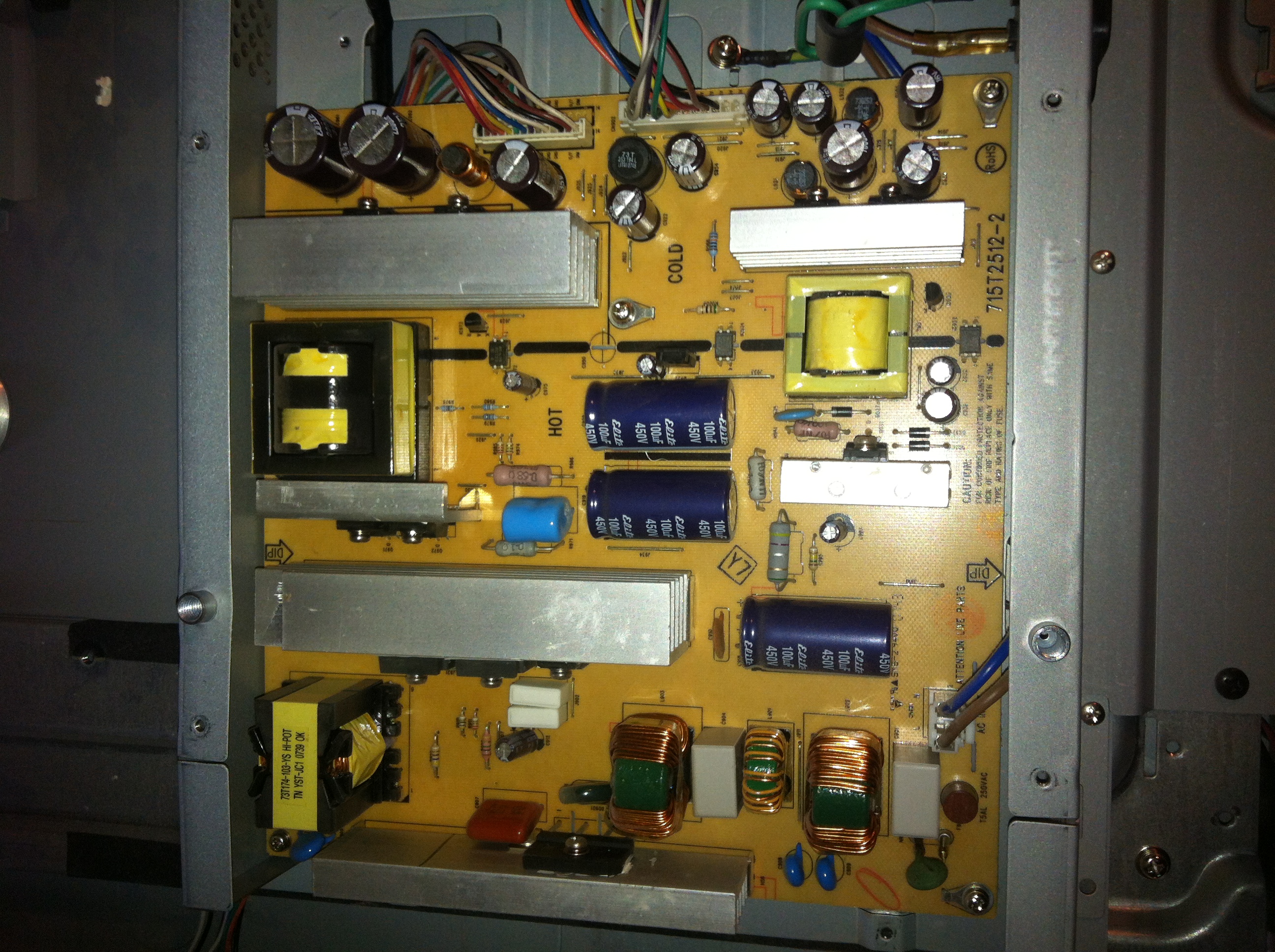

    Hi, I have a Dynex DX-LCD37 with bad cap(s).
    The tv turns on and off by itself.
    The orange light blinks 15 times when it does.

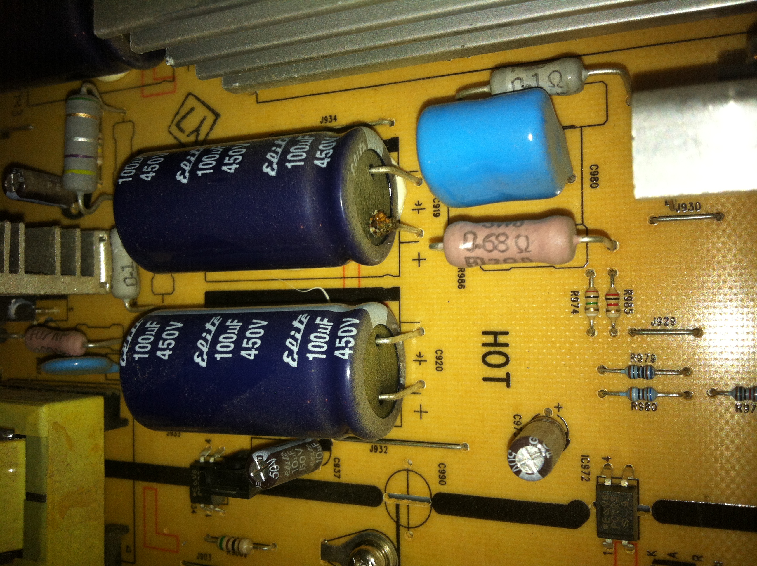

    I have found 1 cap that looks bad. 450v 100uf
    My question is should I just change out the one that looks bad, or all three on the board of the same size.
    There are a lot of caps to choose from here. What one should I get?
    http://www.newark.com/webapp/wcs/sto...&storeId=10194
    Should I look for anything ease?
    Here are my pics- THANKS!

    I would change all 3. If one is bad, the others are probably not far behind.

        Still blinks 15 times and shuts off by it self randomly then turns back on after replacing caps. any help?
          Re: Dynex DX-LCD37 Bad Caps!
          Check the capacitance and ESR of the other caps. Especially those around the connectors on the board *(at the top of the second pic)

                          The cap with the snot hanging out of it? Yeah..that's an issue waiting to happen. So all you did was good to extend the lifespan of the set.
