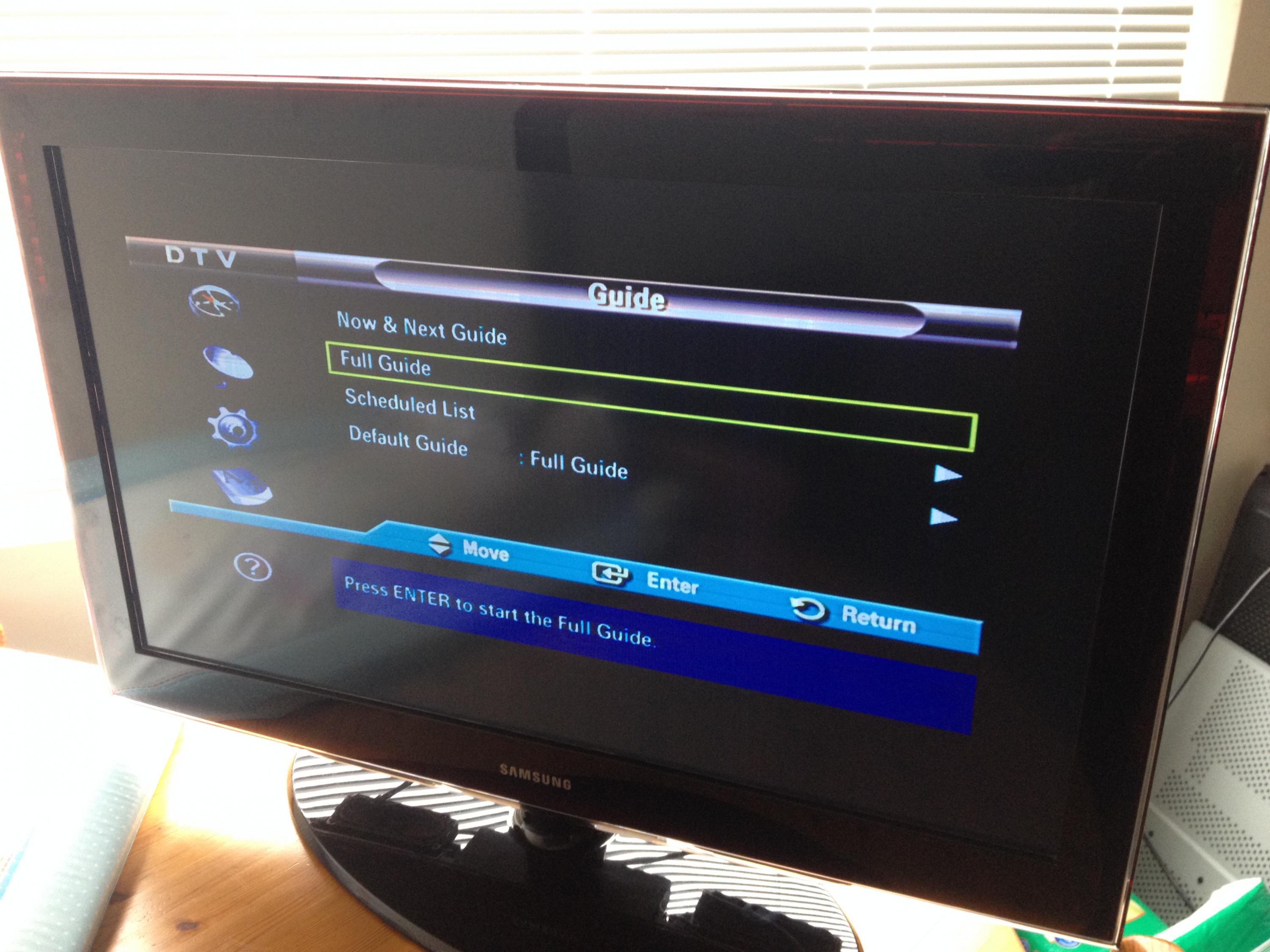

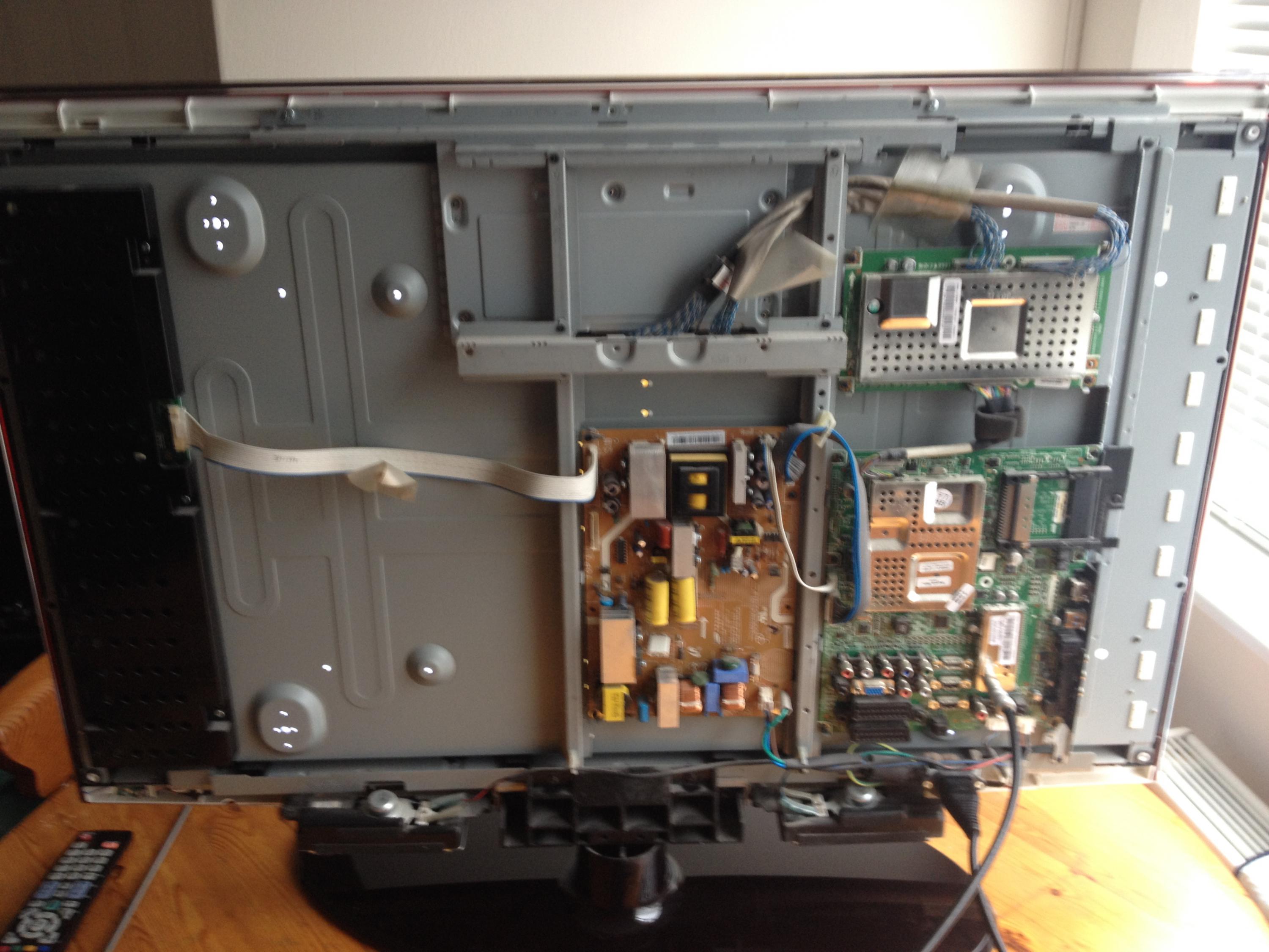

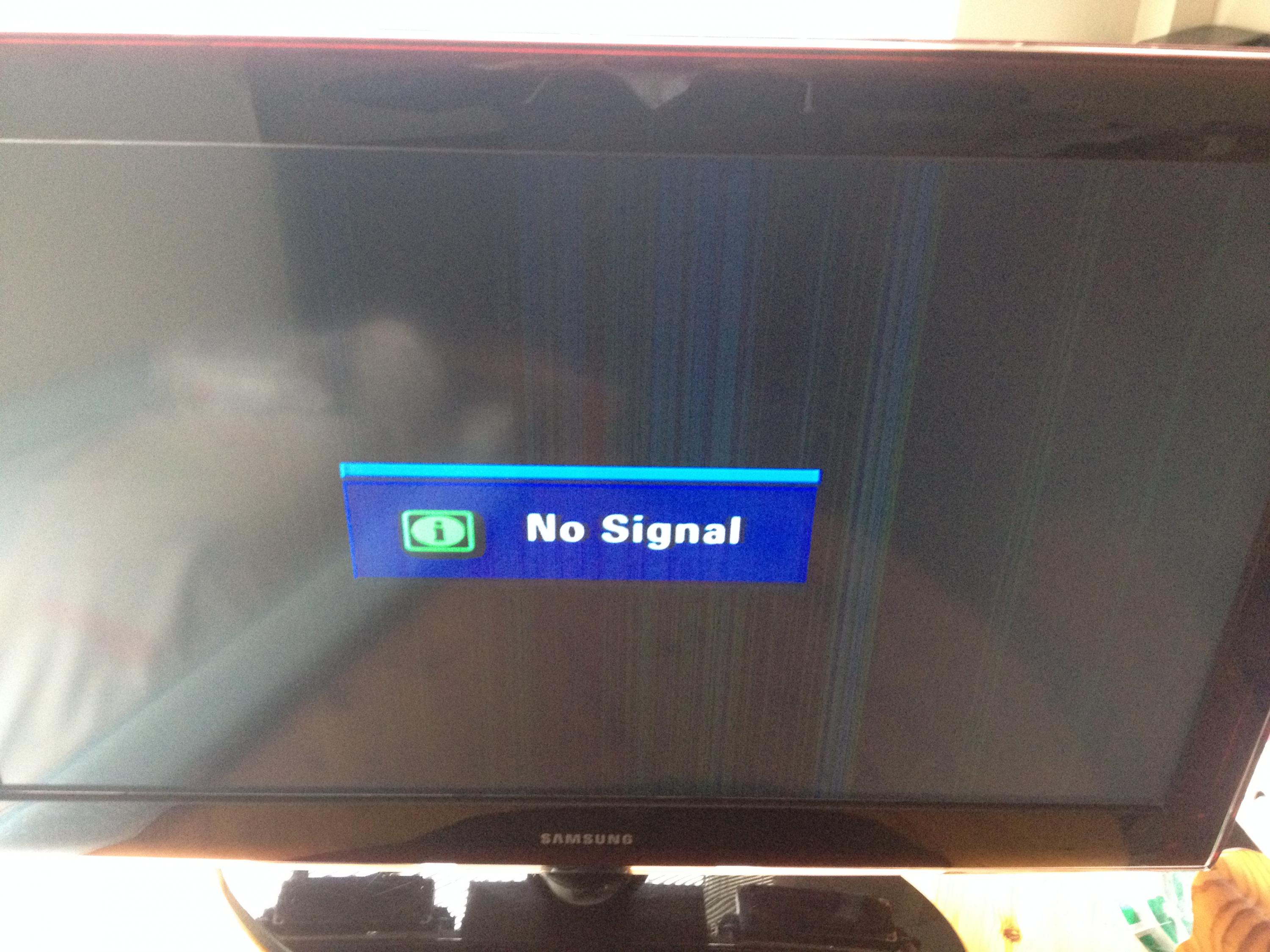

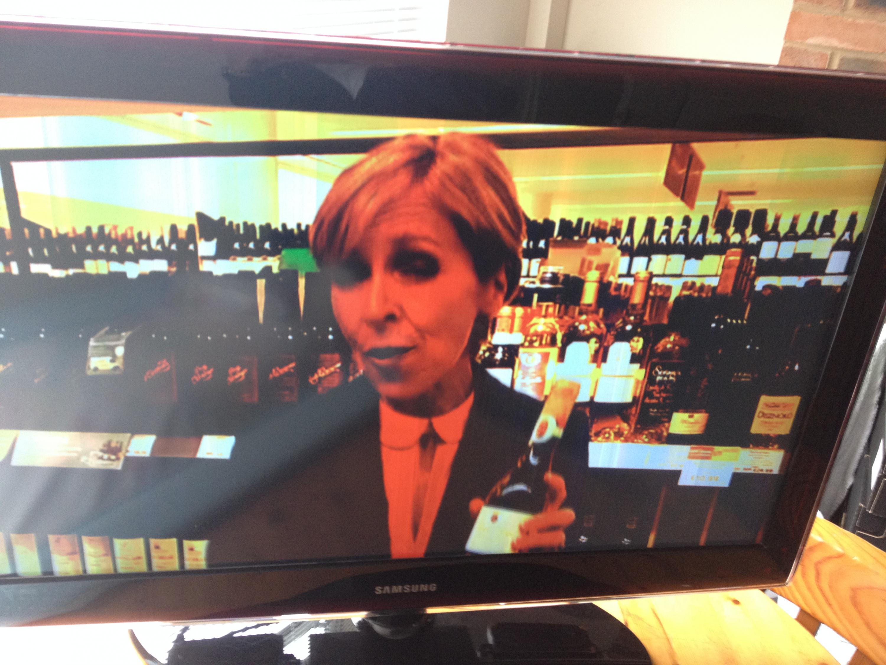

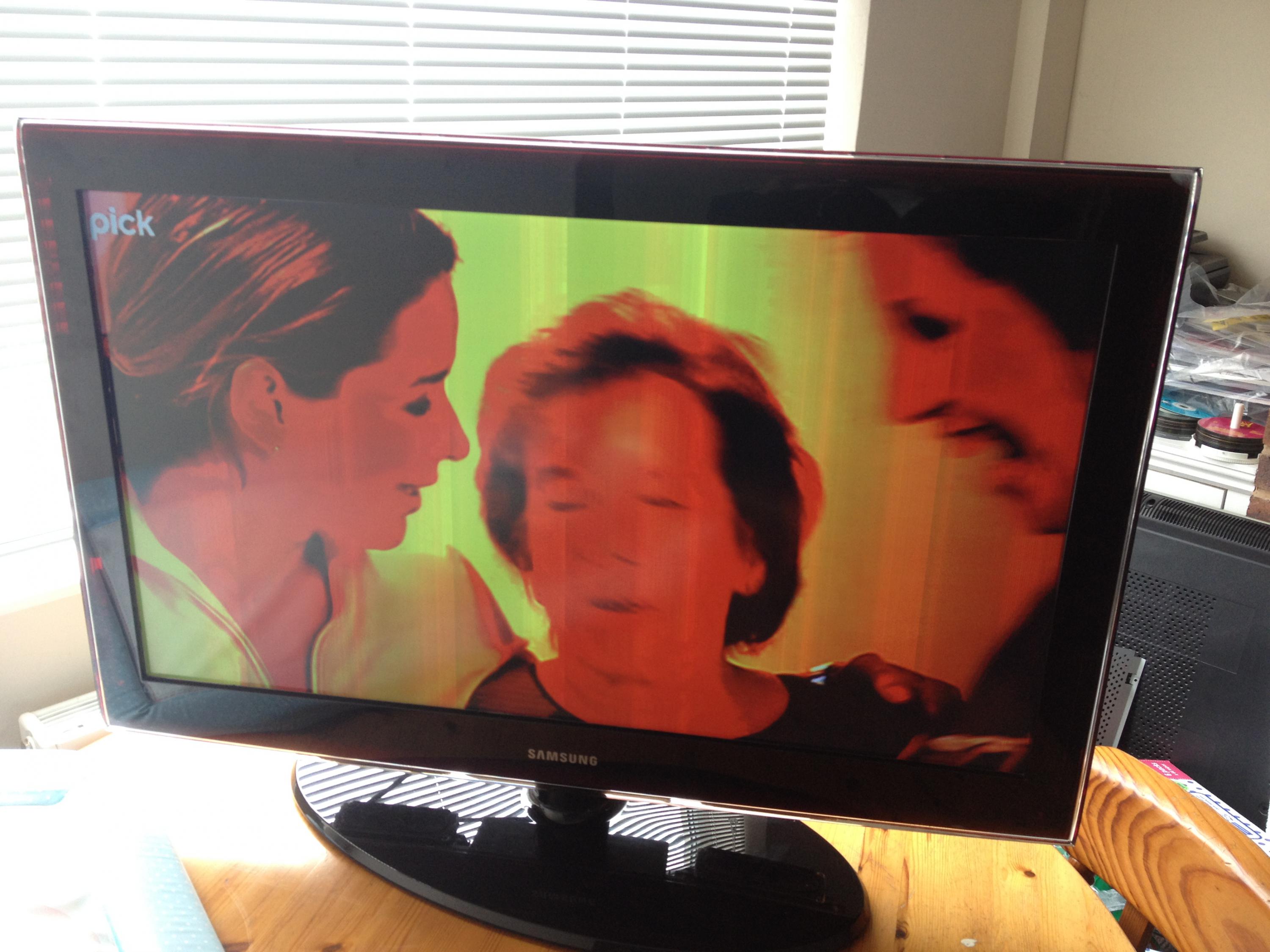

    Hi All
    Got this samsung LE37A656A1F with bad image
    Can you tell me if you think its panel or tcon issue seen a few posts but just wanted an opinion
    Cheers
    Re: Samsung LE37A656A1F - panel or tcon - lines on black screen not on menu
    Looks like AS15-F gamma IC fault, panel is possible too but unlikely.
      Thanks tom i asked cause iv never seen the lines like that with a gamma ic fault, will check the voltages now and post back later
        I've seen it a few times but yes panel is also a possibility, still with cost of gamma IC I think it's worth a shot.
