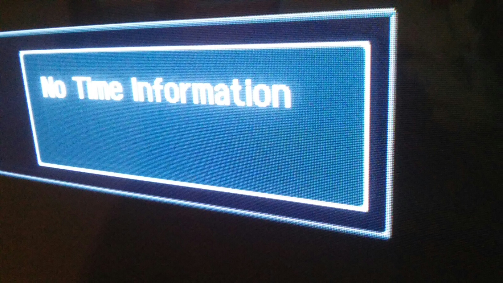

    This week I bought a Samsung Plasma TV, model number PN50B450B1D, for pretty cheap in a pawn shop. It was cheap because it had an issue where the image looked a little staticy all the time, even if there was no input source selected. The tag said that it didn't turn on immediately, and would shut off after 6 hours. This tells me the issue is thermal.

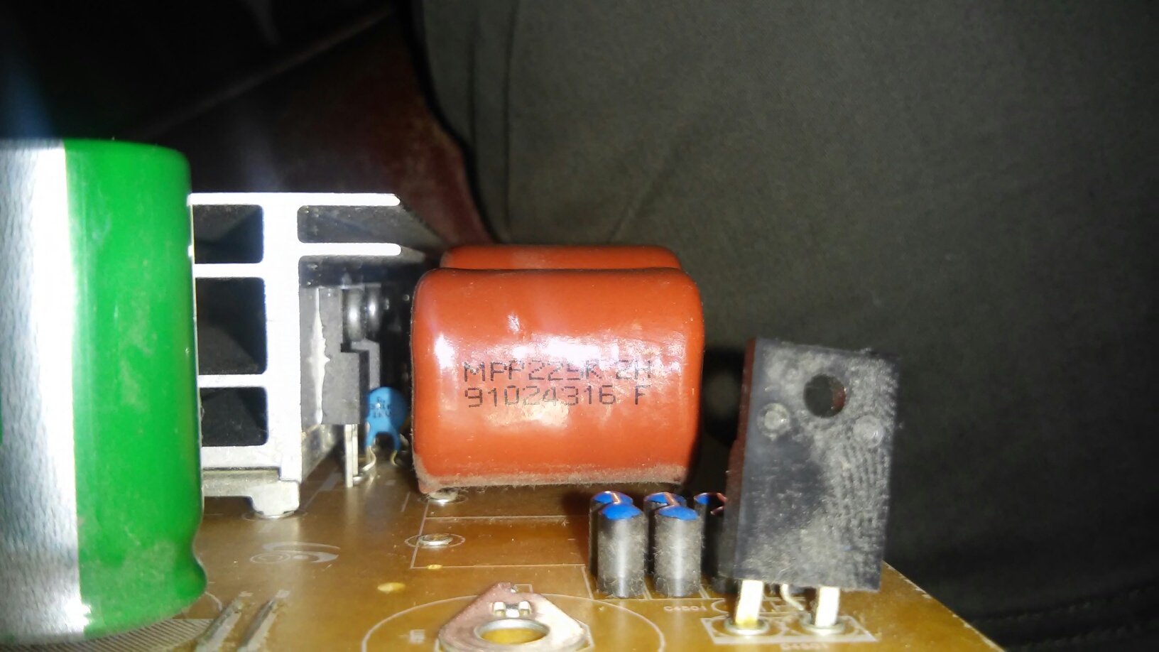

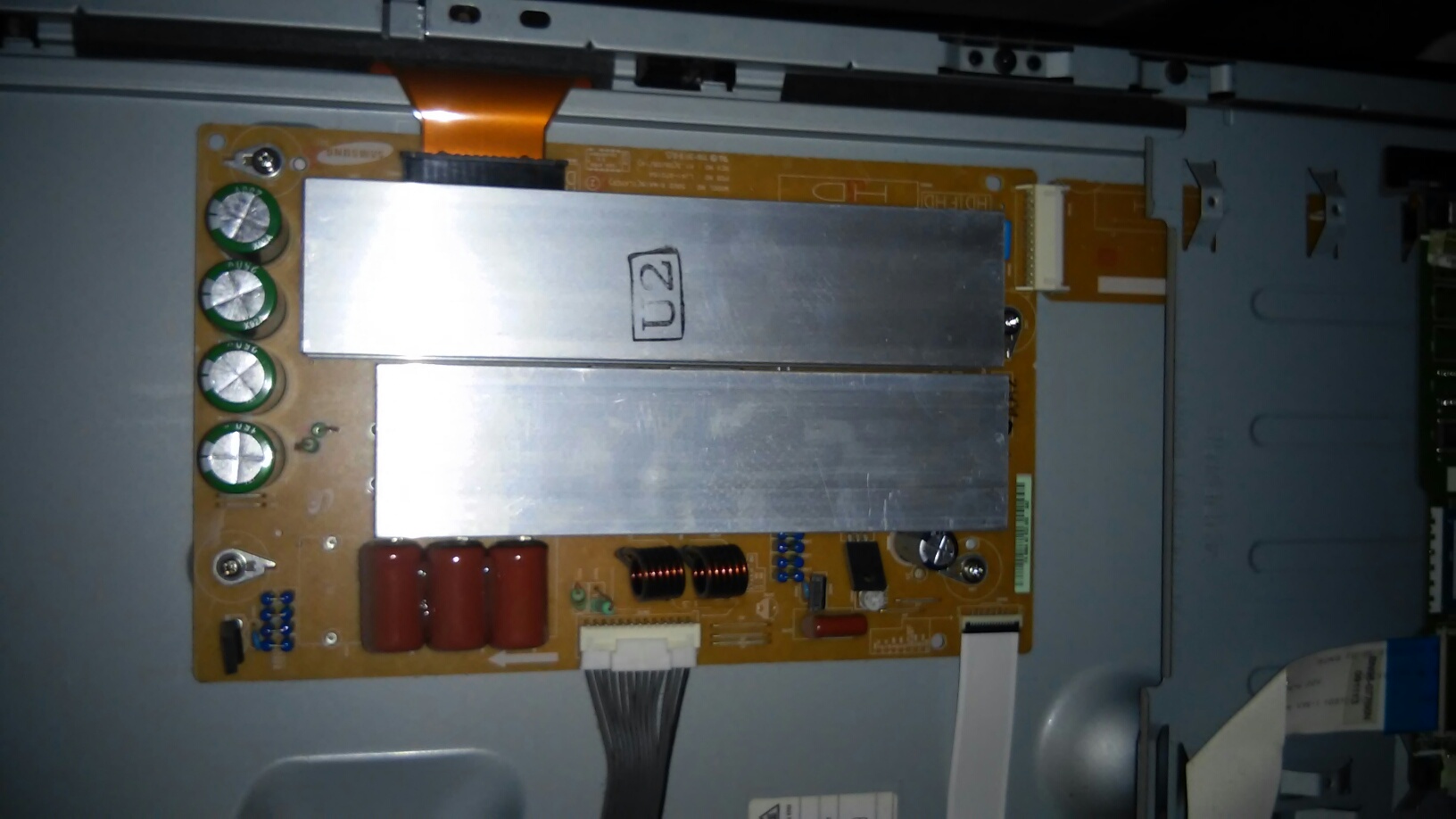

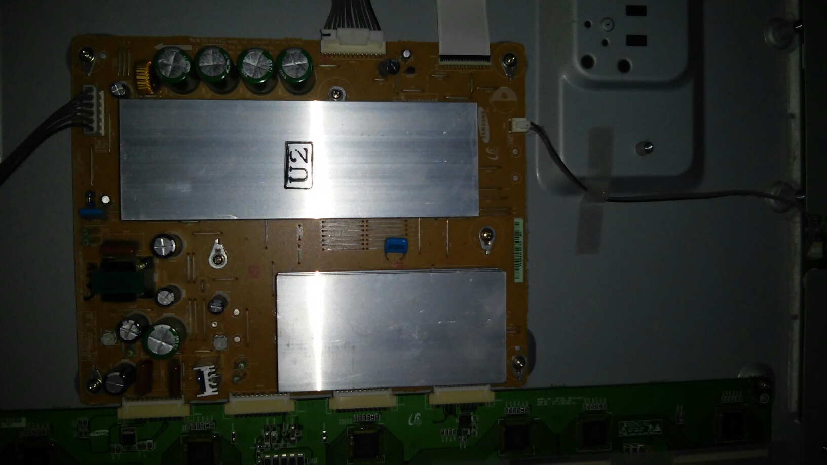

    I brought it home and took it apart, and to my chagrin, found no bulged caps. I put an o-scope on the power supply, and it looked clean, no noise. Both the x-main and y-main boards look fine too, however there's a buzzing coming from both x-main and y-main boards. The y-main board has buzzing near the transformer, so that might be normal, but the x-main has buzzing near a group of a few polypropylene film caps and a pair of TO-220 package transistors/diodes. The buzzing sounds like 60Hz, but I haven't put my scope on any components yet. As far as the possible thermal issue is concerned, all of the heatsinks on both x and y main boards were quite warm to the touch after the tv was only on for about 5 minutes.

    Images of my boards are attached. The picture of the red boxes is the area of buzzing on the x-main board, the red boxes appear to be polypropylene caps, and the diodes/transistors mounted on the heatsink to their left might be culprits too

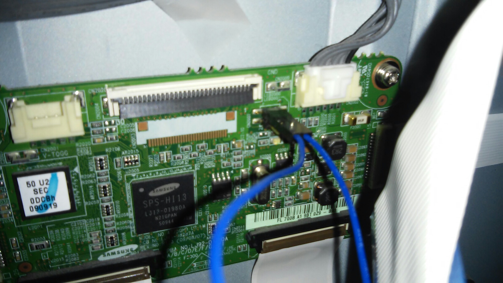

    What you can try is to find the jumper block on the control board (usually under the main board) and jumper pins 3&4. Unplug the connector from main <-> control board then plug it in. You should see test patterns. If the noise is gone you know it was coming from the main board.

      X-main is a good possibility on these. Causes dim, underdiffused image.

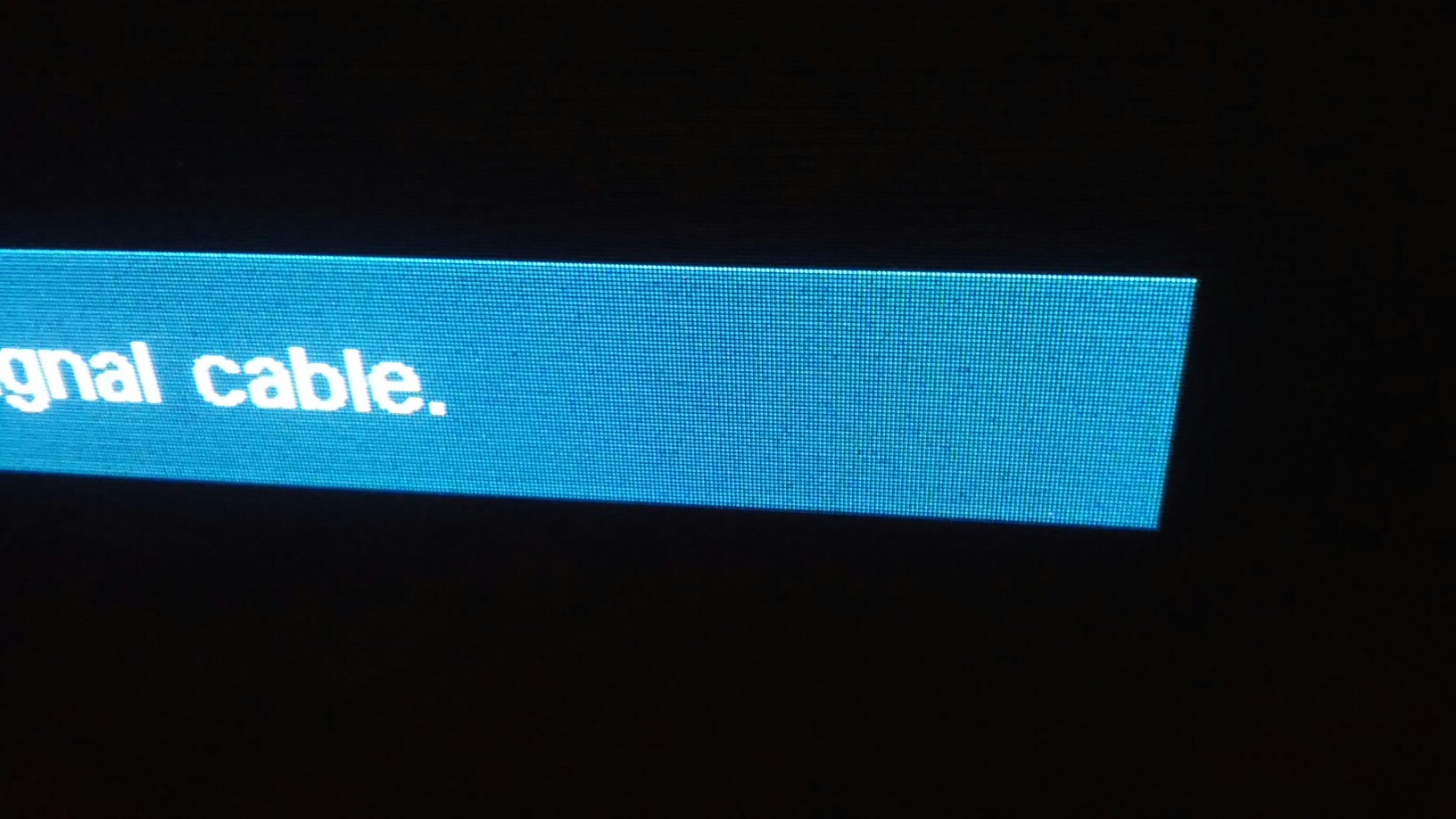

        I took a picture of the "no signal" screen, to show you the analog noise I'm talking about, as well as a picture of the jumpered pins on the control board. The noise is very slight, the colors are all right, but they're just slightly fuzzy
        The test patterns went across the screen, but the noise was still there. I noticed that the tone of buzzing from the x-main board changed, it got quieter or louder and higher or lower depending on the color that was being displayed.

          Re: Samsung 50 inch plasma has analog noise even with no input signal
          Hmm, looks like dithering to me. Most plasmas do this. The Samsung panels tend to be obvious up close. Dithering is where pixels in a region will alternate between two nearby colours to render other colours. The low cost plasma panels can only render something like 100 levels per pixel. Dithering makes this close to 1,000 per pixel.
          Generally, if the dithering is not visible at viewing distance, it is not a fault.
          You would still need to find the problem with it shutting down, of course.
