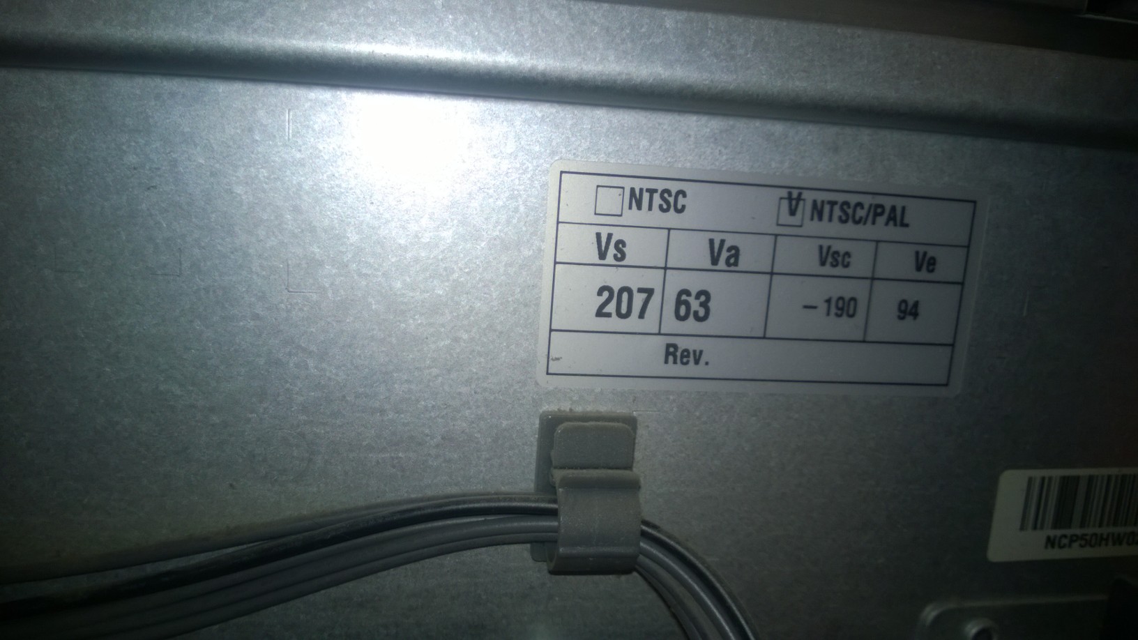

                    just tested the vscan voltage and getting -189 this is lower that the 208 at the top of the board, think this is where the problem lies ?

                      Re: Ps-50q96hd That went pop
                      Post a pic of the label on the back of panel

                          Originally posted by smiddy1980
                          Pic of the post on the yboard
                          Right, so have a look at the sticker and did you see the -190Vsc?
                          that is Vscan and that is what you need to reference your -189V to

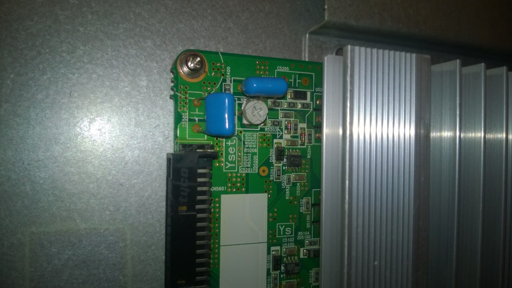

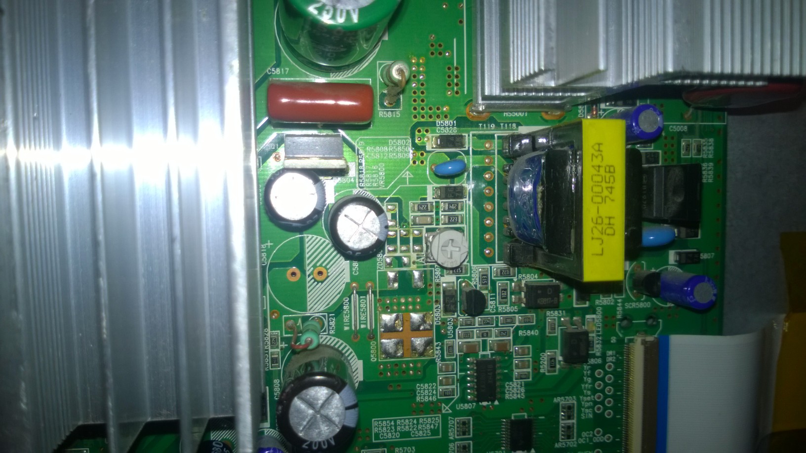

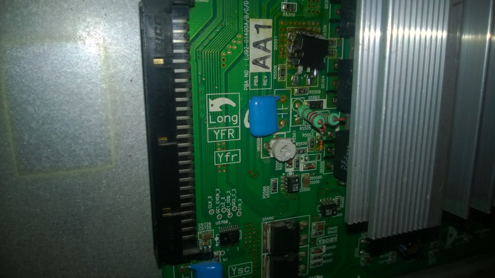

                              At this point don't touch a thing yet. If you have a fine tip permanent marker, grab it as I'm just looking at the pots and we'll need to mark it's current location prior to moving them. That's on the Ymain.
                              I have serious concerns with the B20NK50Z smd fet. what wattage iron have you got?
                              • smiddy1980
                                HELLLLLP
                                • Sep 2014
                                • 57
                                • Scotland
                                #35
                                not sure on the wattage, you think I may have damaged it ?
                                • tw2005
                                  • Oct 2011
                                  • 6458
                                  #36

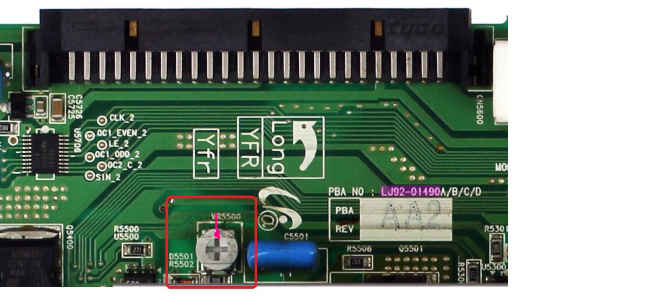

                                  On the ymain
                                  leave Yset alone
                                  Yfr long, marke the arrow pointer and then mark a rference point for it on the board or pot housing to come back to if need be.
                                  Then adjust to match this photo. I'm still checking more of the board, start with this.
