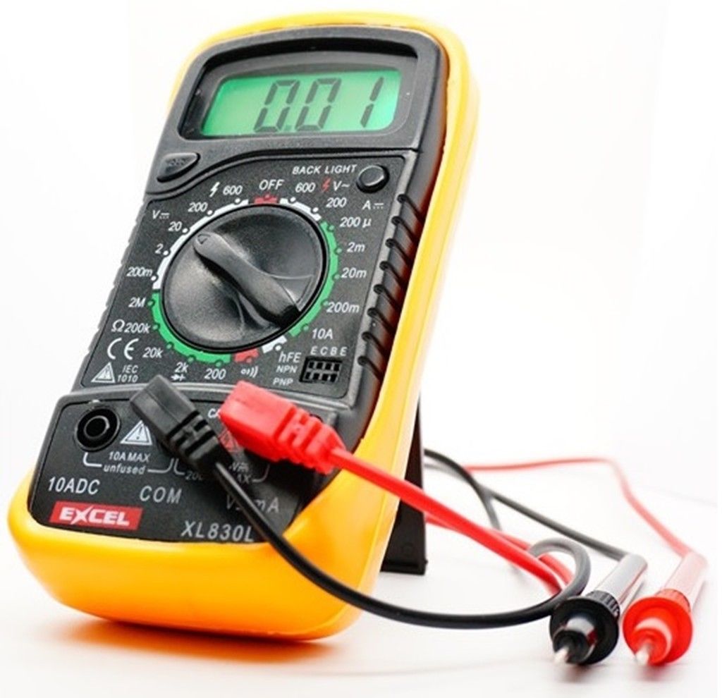

            Bud, Would this meter be good enough?
              Re: Help me Identify this part
              It has good ranges except for the ACV range.
                                          I only visit certain sub-forums here on badcaps.net and will regularly miss threads such as this.
                                          As budm mentioned, your clamp meter does not give enough resolution to determine if your voltage regulator is bad or not. Most regulators have a tolerance of 1 to 2%. See
                                          https://www.badcaps.net/forum/showthread.php?p=470524
                                          If you are going to be repairing more electronics in the future, I suggest getting a better meter than the one you posted. If you are only doing this one time, then the above pictured will be okay for the purposes of troubleshooting this problem.
                                          If you want/need a "better" meter, give me an idea of your budget and I can make suggestions.
                                          PS. Harbor Freight generally gives away the red Centech multimeter for free. I wouldn't recommend for any high voltage or current measurements, but if you are measuring less than 24V DC, it should be fine.
