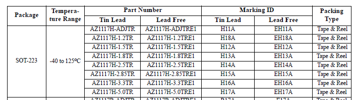

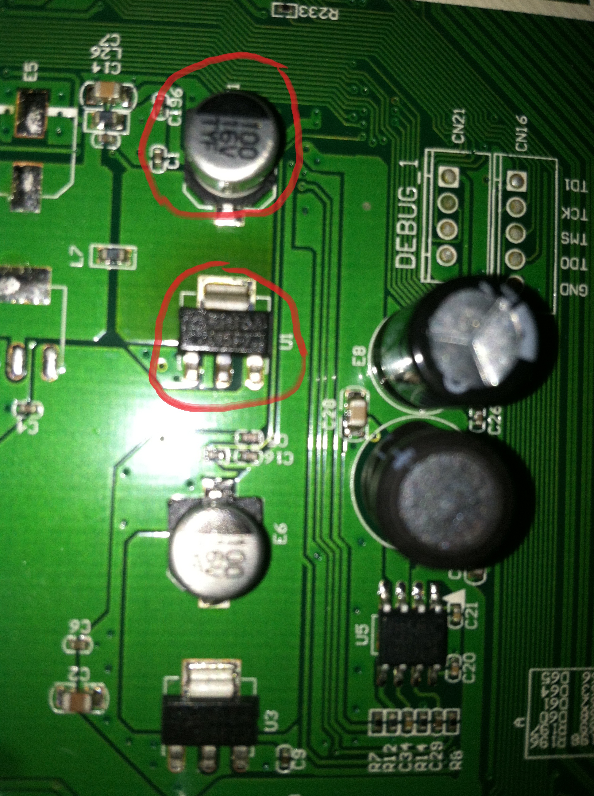

    I have a RCA 37" LCD tv that is completely dead. No standby light or anything. The part circled in red was getting very hot but it is not now. No voltage is showing from it. The exact part under it shows 0v on the first pin 002v on the second pin and 004v on the third pin. The marking on it shows EH16A 015F72,

    U1 is a voltage regulator unsure of the rating due to the picture. The silver can is an aluminum SMD capacitor 16v 100uF

      Check the resistance reading between the two legs of that cap to see if it shows low resistance.

            U1 is AZ1117- 3V3
              Re: Help me Identify this part
              OK, per your picture, the regulator with red circle, put the Ohm meter red probe on the big tab output pin), the black probe on the chassis and take the reading, make sure to report if the reading is in Ohm, K Ohm.
                Ok the one in the circle shows 13.7 and beeps.
                  Sounds like the regulator could be bad
                  -David VanHorn
                    It is either very heavy load or the IC is bad you need to remove the old IC and check the resistance of that big copper pad where the big tab of the IC was connected to see if it still shows 13.7 Ohms.

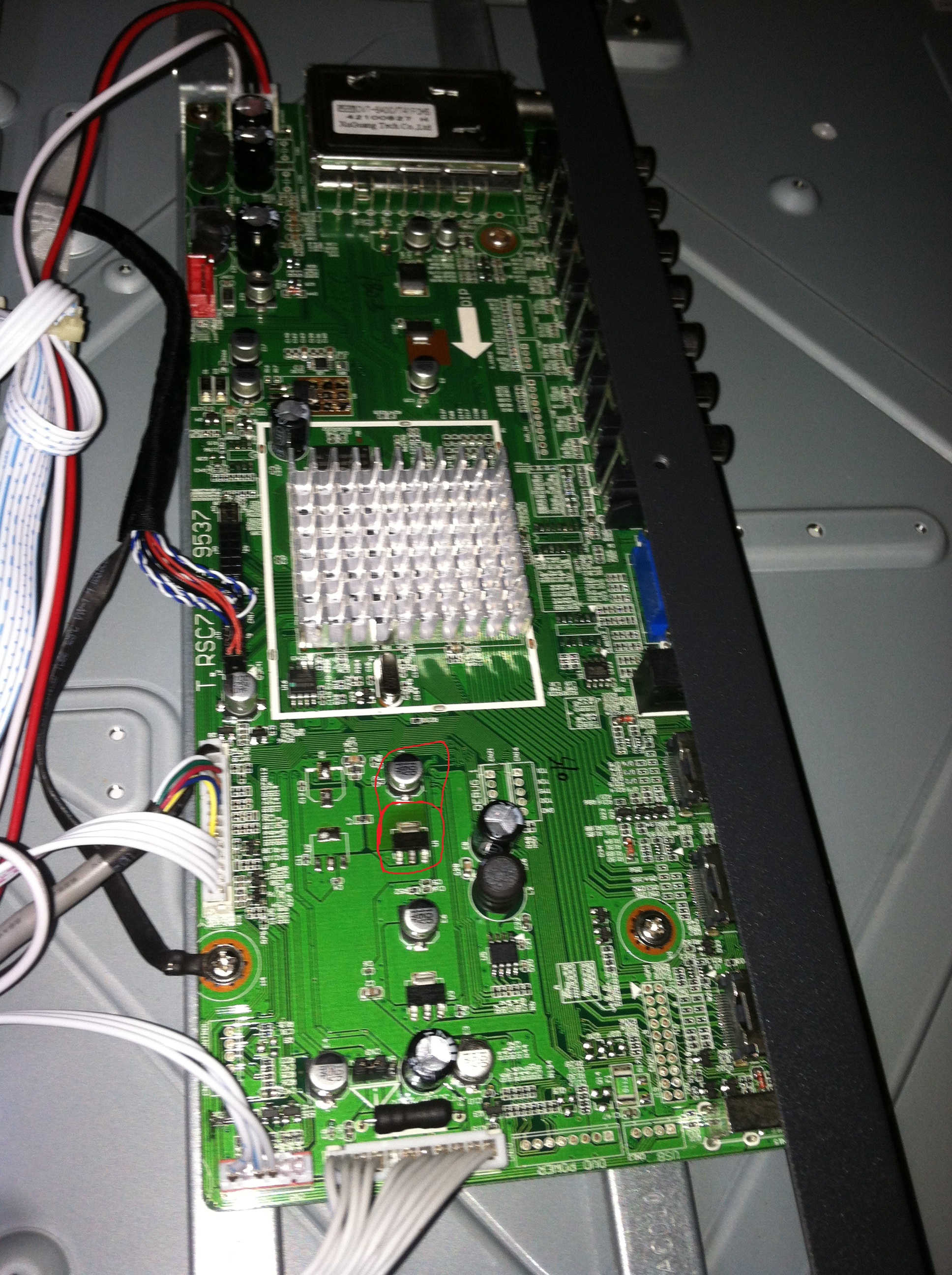

                      Thanks for all the great advice. Can someone please look at the power supply and tell how I would go about shorting what pins to see if the backlights will come on. The inverter wire connects to the main board.[/IMG]
                        You need to show the inverter board connection since this power supply does not have the BL_ON signal that get routed through the power supply board.
                        To get the backlights to come on, you will need to apply 3VDC to PS_ON pin through 100~500 Ohms resistor and 3VDC to the BL_ON pin through the resistor also, and may be the Dimming control pin also. You must disconnect the PS_ON pin and the BL_ON pin to the main board otherwise the main board will force those signal lines LOW and will not allow them to go HIGH.
