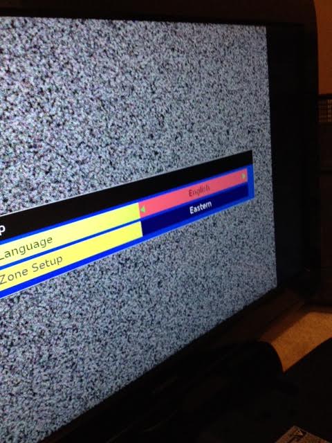

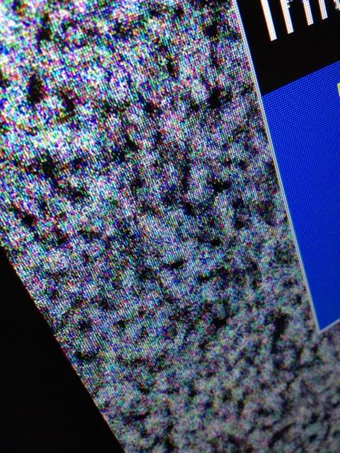

    Toshiba 40FT2U Weird colored screen
    Okay so the Main board was bad (TV wouldn't start, no standby light) and I ordered a mainboard + put it in and now it starts but the colors are weird on the TV. They're almost like a weird opposite - don't know how to describe but pictures are below. I thought it was the T con board but when I got the replacement in Today it has the same colors. The two mainboards have different Revisions on them but look exactly the same. the one I pulled out (bad) was revision 1A, the good one is revision 1D

      Re: Toshiba 40FT2U Weird colored screen
      It is not much use if you dont quote the exact numbers of both boards - the one you had and the one you got - Pictures of the labels would be good.
      Problem may be that this board 431C4A51L01 is very similar to 431C4Q51L01
      but one is for a Chimei panel and one is for a samsung panel so second question would be what panel have you got?
        Check LVDS cable fully seated.
