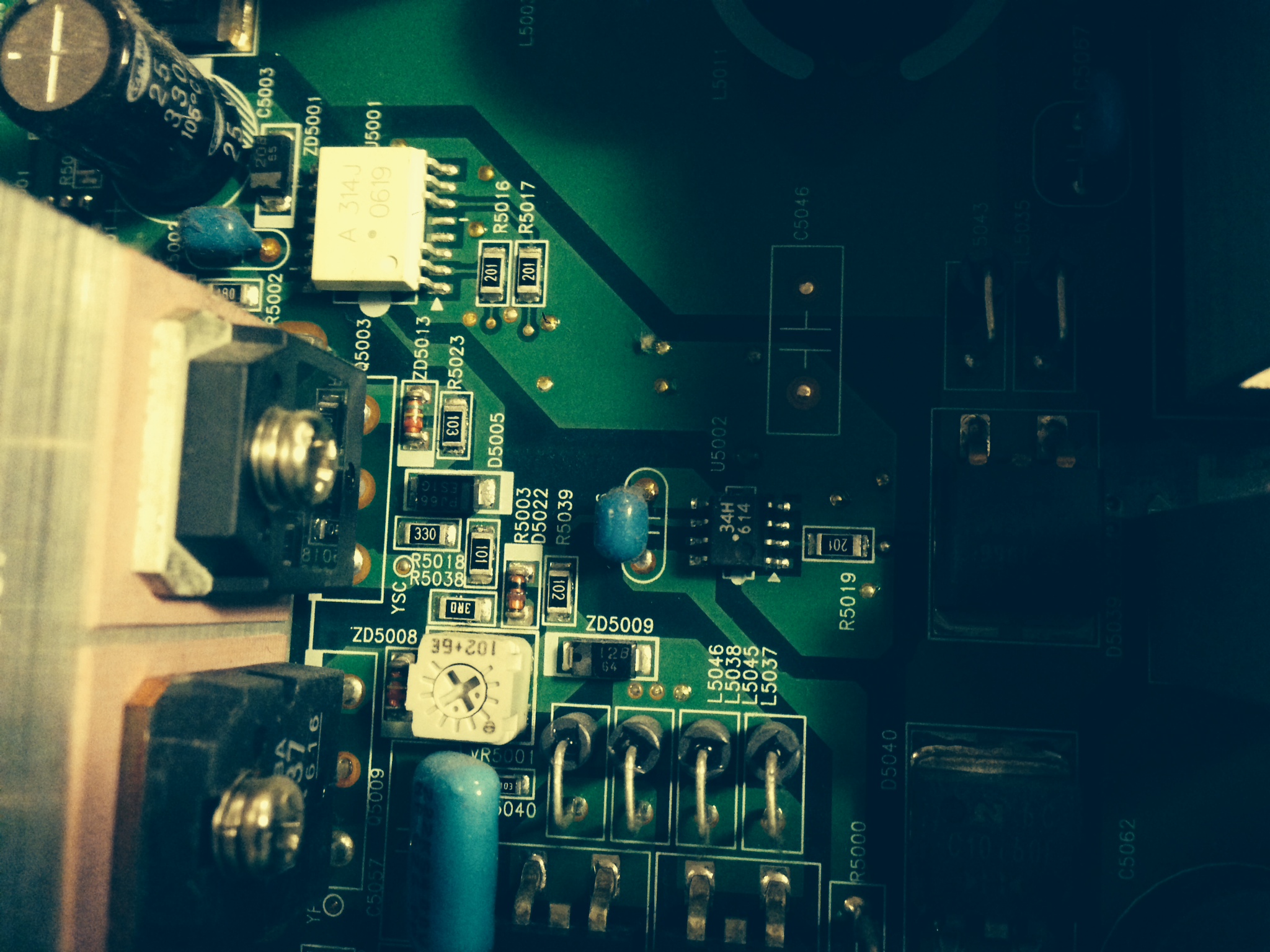

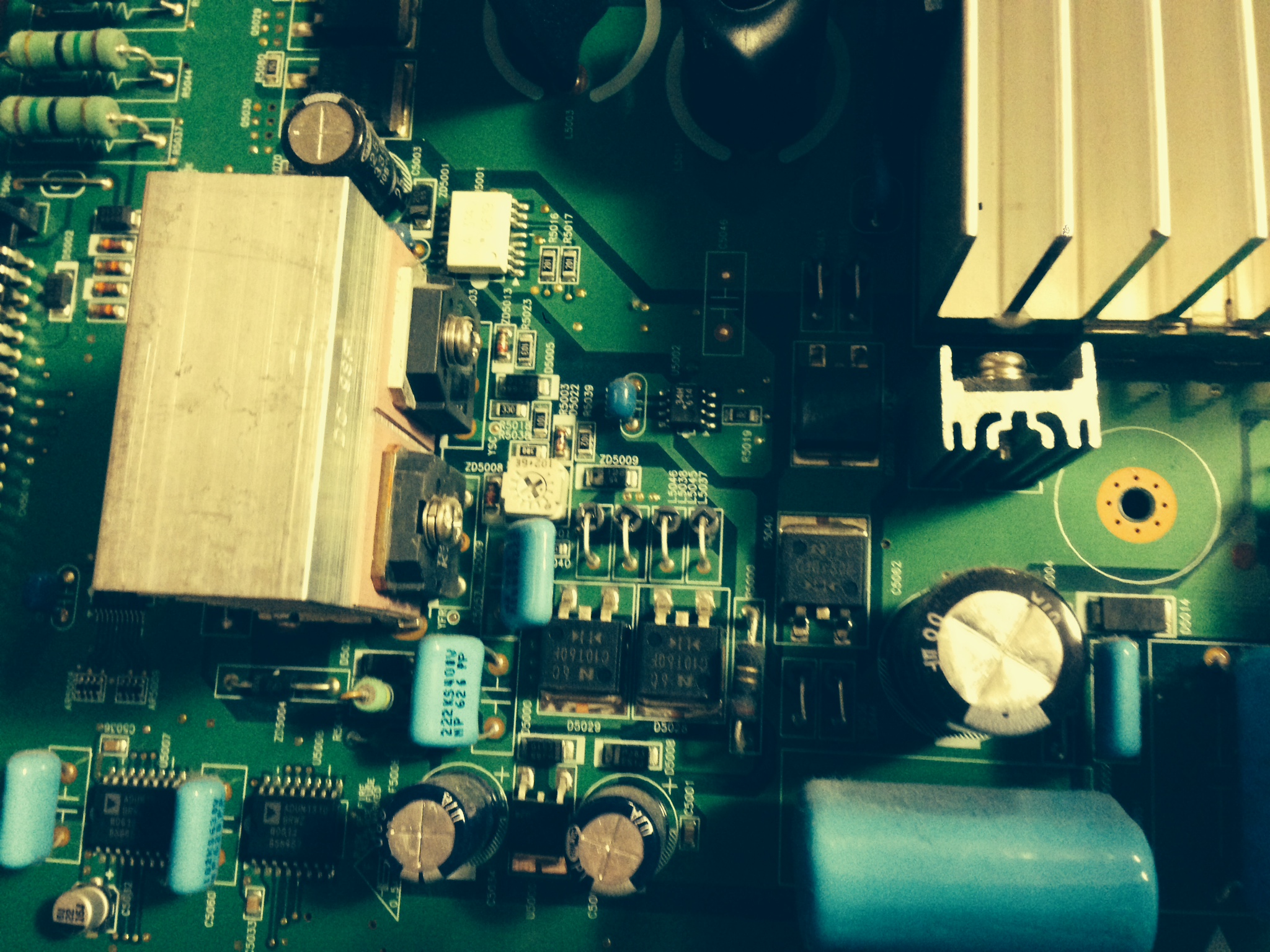

    I decided to check the Y Main Board, as I have read this is usually the cause of my issue. On this Y Main I found one diode (D5005) that was shorted (Showing only ~0.072V drop with Diode Check on DMM). I will order and replace this diode.

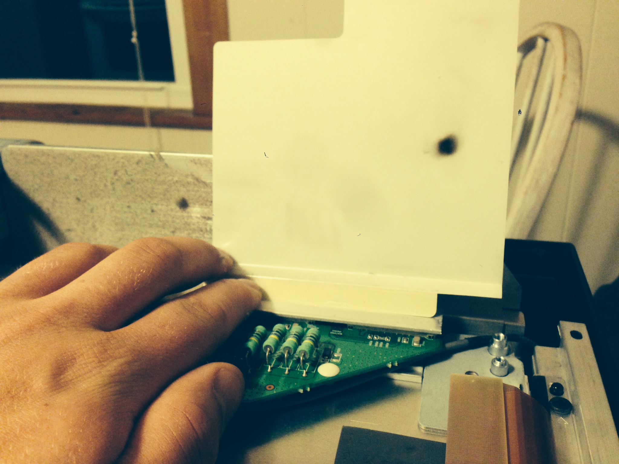

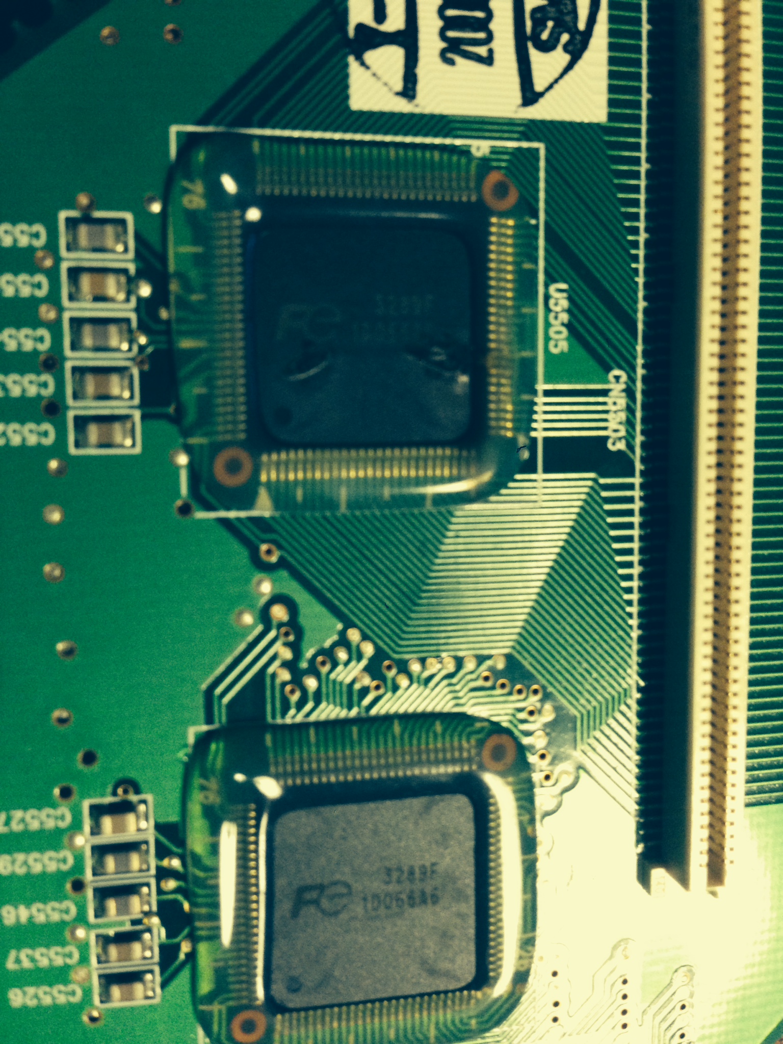

    While removing the Y Main I was forced to remove the Y Main Scans. The Buffer Scan IC located on the lower Y Scan appears to have shorted through the top of the plastic case of the IC. I will also replace the lower Y Scan as I assume this is also defective.

    For clarification, pictures 4 and 5 show the chip that appears to be damaged and the burnt piece of plastic that separated the top of the chip from the component inputs on the side of the TV. Picture 2 shows the location of the diode I measured as bad, and picture 3 is a closer view of just the diode (D5005).

      That diode reading may be erroneous due to the low ohm resistors nearby. Remove the buffers and run the set. Is there a steady green led lit on the ysus ?
        Re: Samsung HP-S5053 Plasma Burnt Buffer Scan IC
        R5000 looks a bit toasty..
