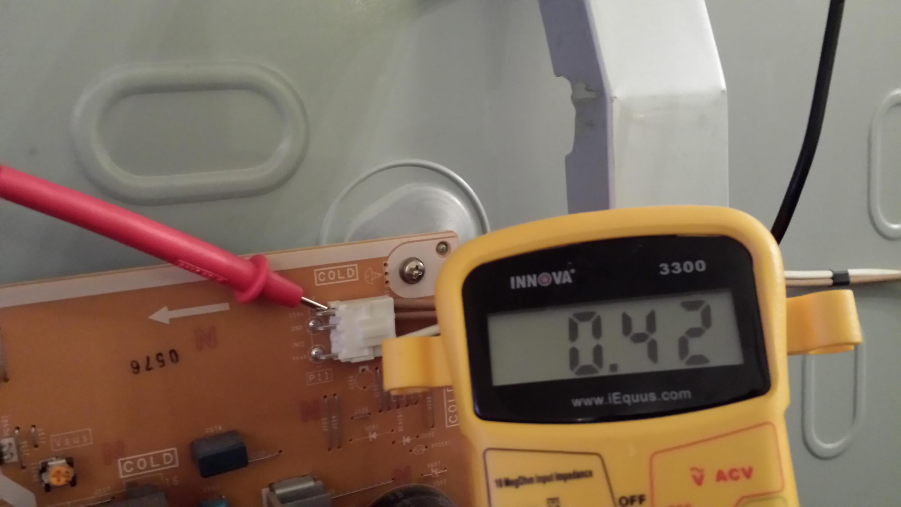

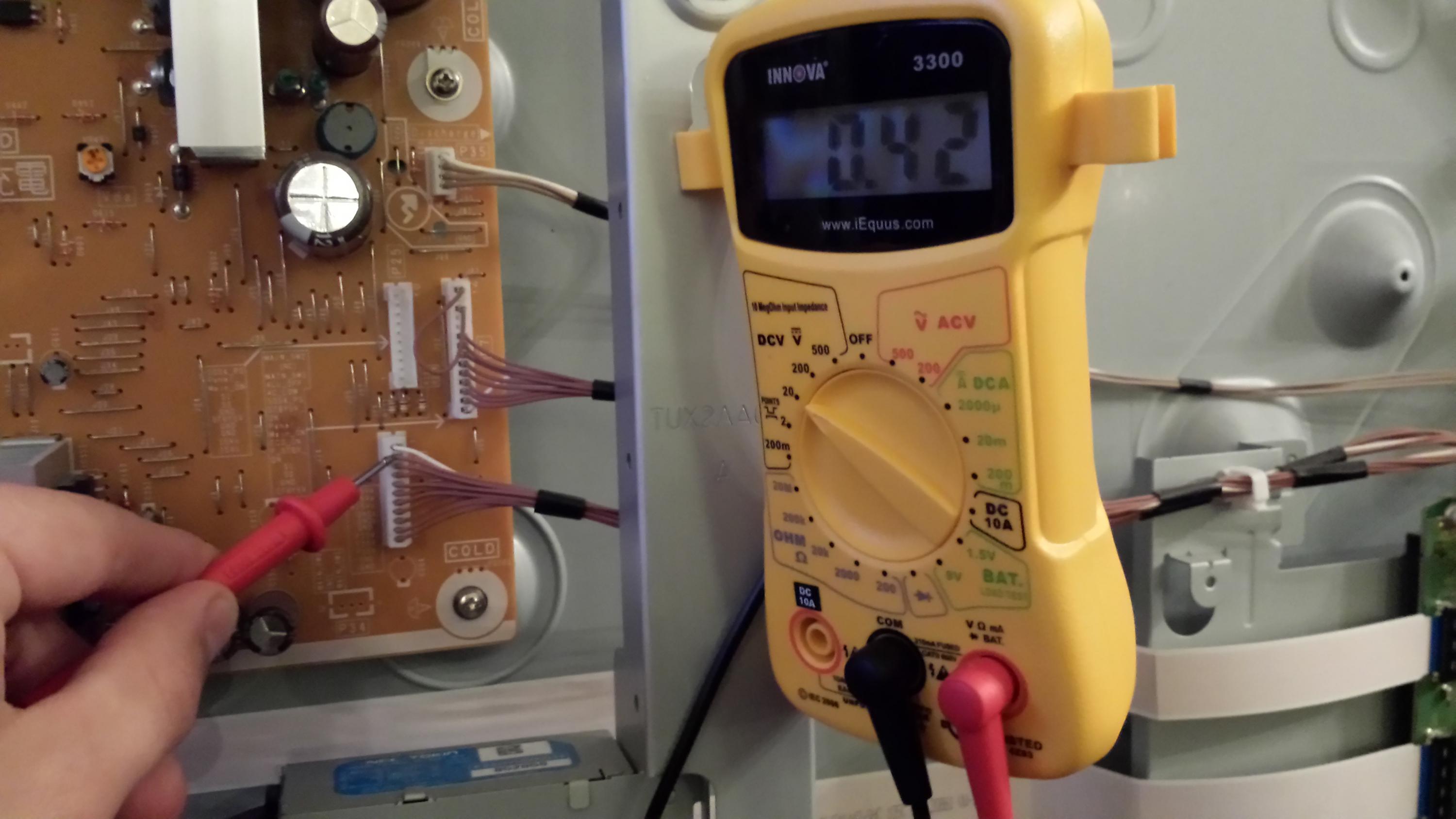

I was given this TV because the previous owner got it diagnosed and didn't want to pay for the repair. He said they diagnosed 2 boards were bad, but couldn't remember the names of the board.
Panasonic TC-P50C2 with 10 Blink failure code.
I attempted to follow this guide of disconnecting boards to find the source of the 10 Blink code:
http://www.justanswer.com/tv-repair/...-replaced.html
When disconnecting the SS board from the PowerSupply, the blink code changes to 7. This leads me to believe the SS board has failed.
When testing the Power Supply using a multimeter, I appear to be getting very low voltages. To be honest, this is the first time I have used a multimeter and was hoping someone could take a look at the attached photos and make sure I'm doing this right.
In both photos, I should be reading 15 Volts by touching the leads on the power supply. It even says 15V next to one of the leads I am touching. It instead however appears to read 0.42 Volts... unless I don't understand what I'm doing which is very possible. The TV is plugged into the wall at the time of testing.
This all leads me to believe that both the Power Supply and the SS board are failed and I should attempt replacing them. Any advice is greatly appreciated.
