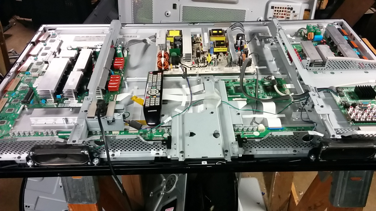

    sound no picture samsung plasma pn50a550s1f
    the Samsung melody comes on but nothing else, the guy prior to me replaced the y main and psu, not knowing what he was doing, but I cant fix plasmas at all, I never have the patience to get it I always get up, but I need to know how to fix a plasma what is the first step in this?

    Re: sound no picture samsung plasma pn50a550s1f
    Any help please?
      Is the LED on the logic board flashing when powered on? It is the board just under PSU on right side. If flashing once a second = good Once every five seconds = problems.
