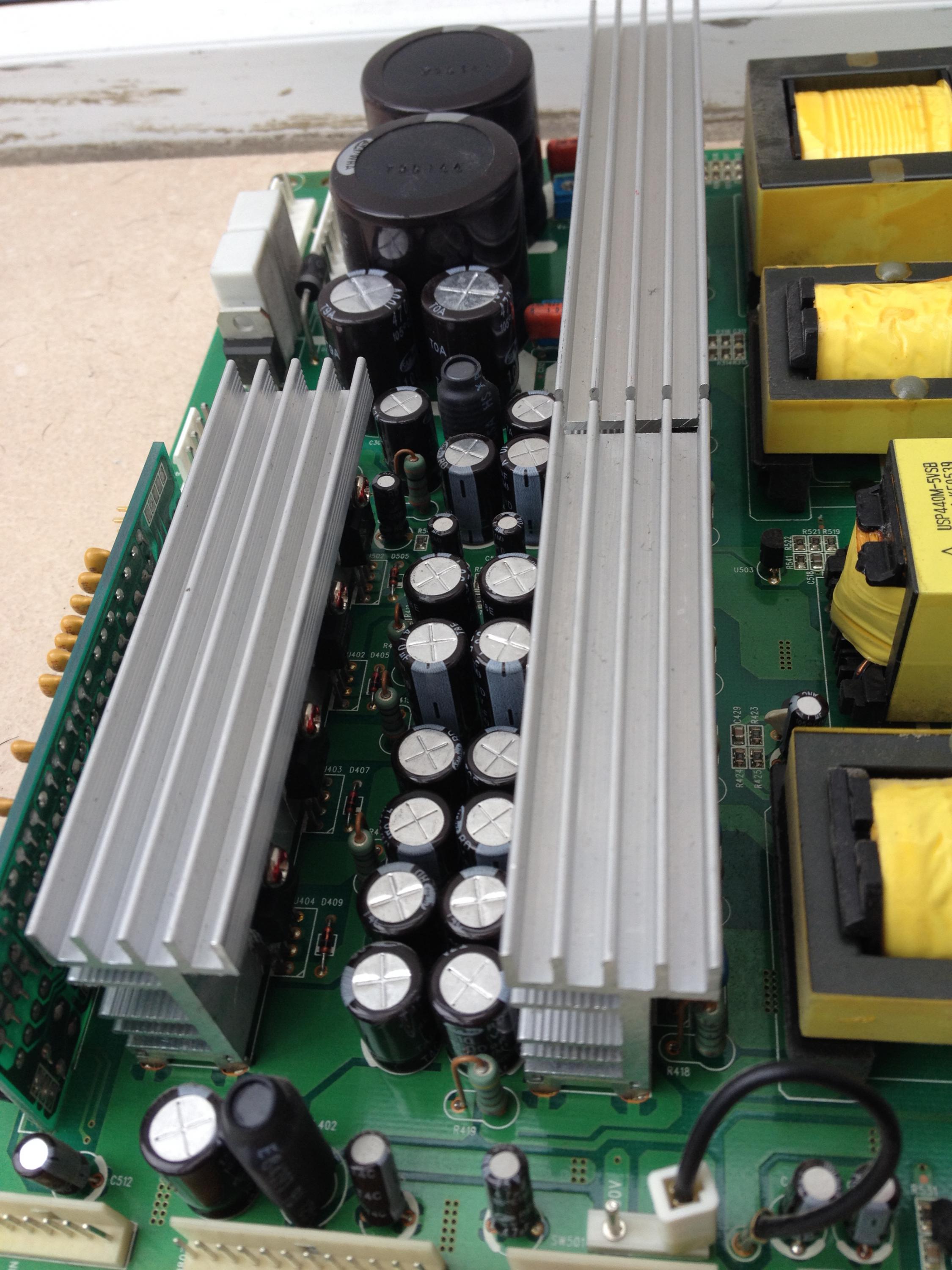

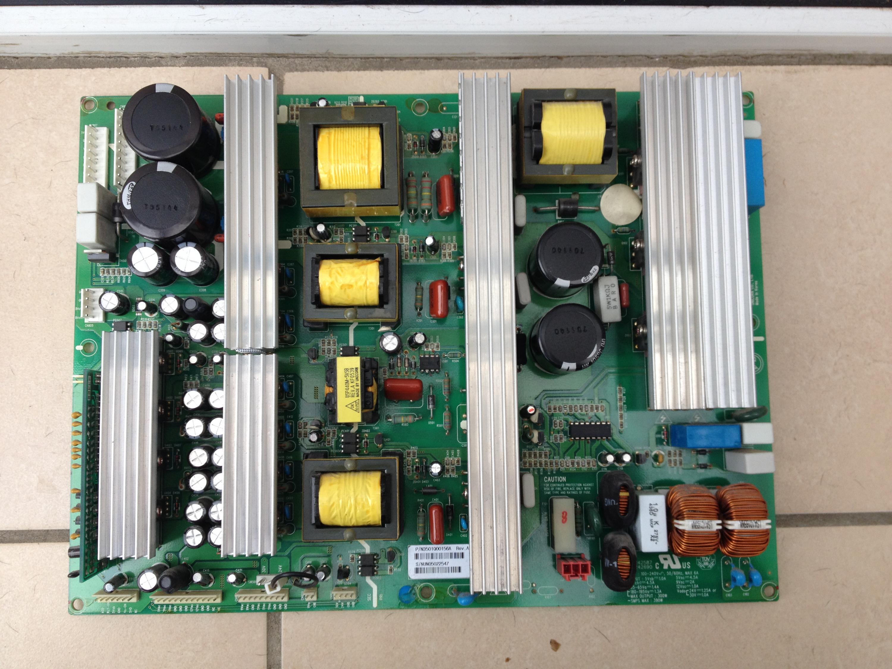

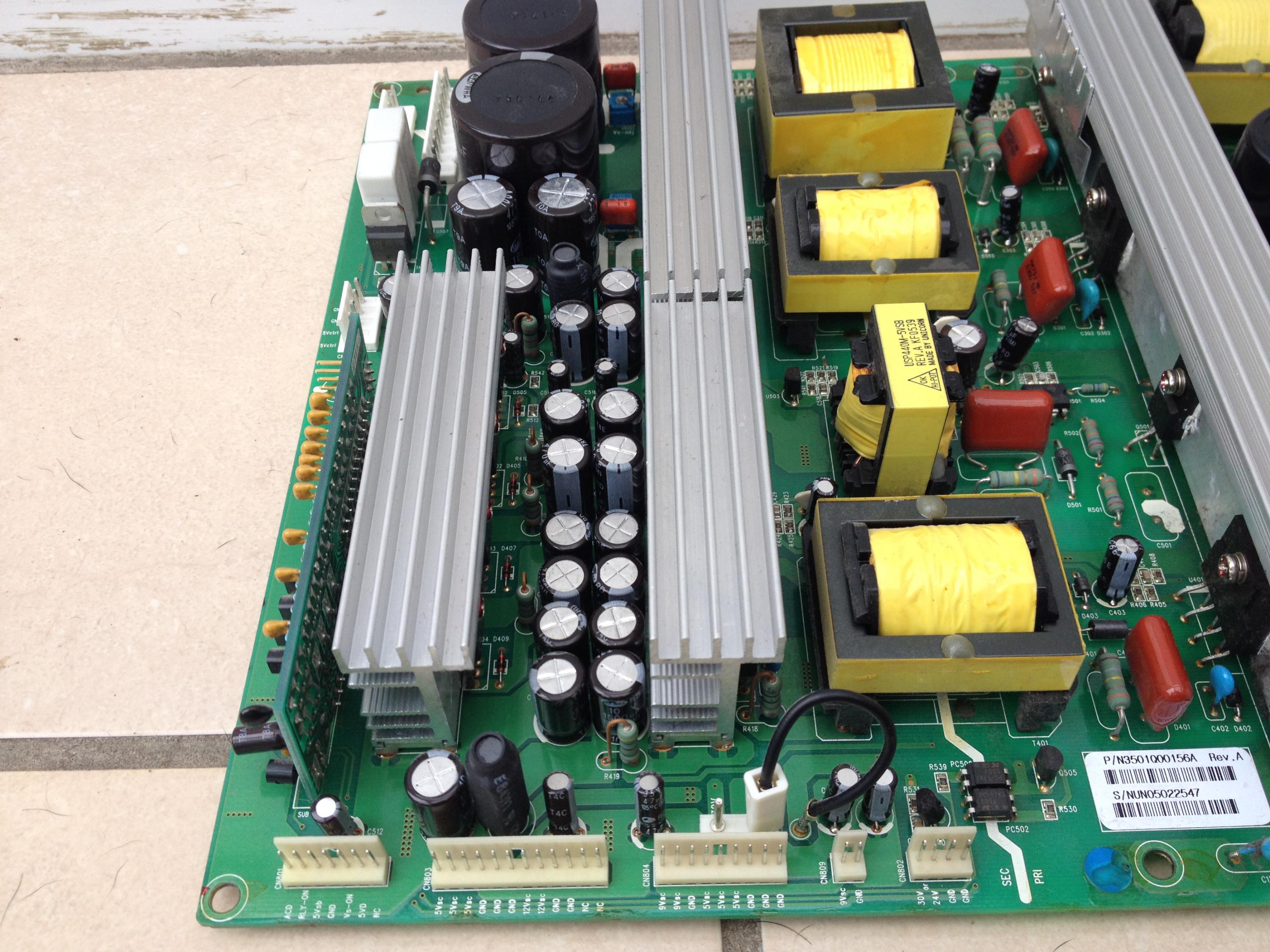

    Hi all
    Got this freebie LG PDP42V7 badged as a Hyundai HPT-4260
    Problem is red LED powers after first click - ( standy by fine )
    Press power then light turns blue and you have a delay until another click and it stays like that
    Using DMM voltage comes up for a split second then shuts off again
    if i apply heat to PS then it works as normal and i get a picture
    dosnt take much heat to get working so hard to narrow down, iv seen other threads on this so i replaced the caps in the center row
    C210 50v 1UF
    C203 50v 10UF
    C310 50v 1UF
    C303 50v 10UF
    C505 25v 220UF
    C504 35v 47UF
    C428 50v 1UF
    C403 50v 10UF
    These have made no difference, does any one suspect or know of a set of caps i should concentrate on as there are quite a lot on this board and all look good
    Cheers

      Have you replaced all the small ones on the primary side? Check for cold joints too.

        primary side being the left with the majority of caps on? - no i havnt just wanted to get suggestions befor i did
        iv check for cold joints re-flowed most the board to make sure
