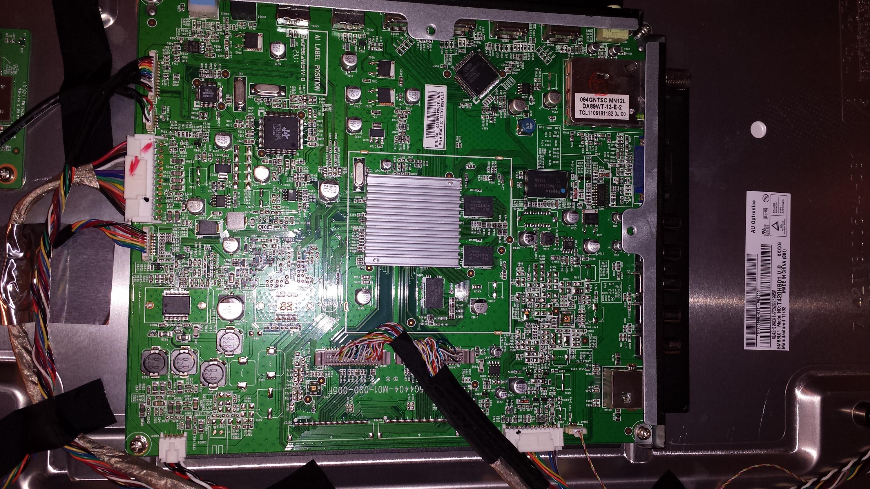

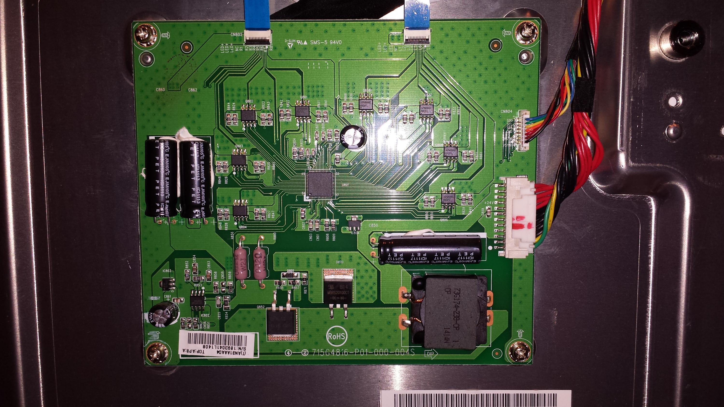

    Dead.. Makes a high pitched that seem to be coming from the power supply board. PS voltages all look good. No lighted Vizio Not sure it lights up on this one. When I unplug the Main board the high pitched squeal goes away.
    Mainboard issue? Looks like it.
    Re: Vizio M3D420SR Dead
    Pictures of the boards?
      Here ya go!
        Update:
        Sent the mainboard for repair to an ebay vendor and he could not fix it.
        It appears this is a very common issue and new mainboards are impossible to find as well as working used versions.
        I will try a bit longer to get one but I may end up tossing this one back in the junk pile.
