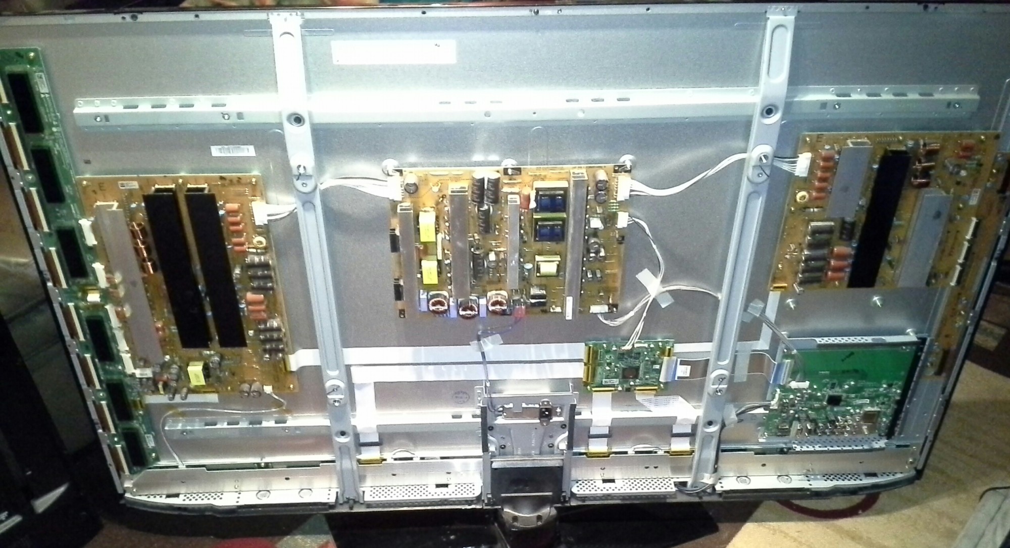

    This is a common issue on these models. It is caused by some cold solder joints under the Y-sustain and Z-sustain. Easily fixed. Can you post a picture of your Y- and Z-sustain boards, I will highlight where the solder needs to be reworked.

                  Is there a picture showing which boards I need to examine and which parts of the board specifically to look at? IIRC, the Y is on the rear left of the TV and Z is on the rear right? Other than that, I haven't seen much info.
                    Re: LG 60" 60PV450 lower half flickering where white, only on HDMI
                    I don't have any for your exact model as I've only seen the PZ series doing this, but if you post some pictures of the boards in your set I can highlight the component in question.

                        Pic is attached
                        • DriftinJim
                          • Sep 2014
                          • 12
                          https://www.badcaps.net/forum/attach...7&d=1391444646
                          I'm guessing I should look at those parts on both Y-sus and Z-sus boards.
                            In that picture, the three white clips on the bottom right, how do I remove them? Do I squeeze the ends?
                              I was able to separate them. Just took some finesse. Y-sus looks good but Z-sus has one post/solder that is black and crusted. Will resolder and see how it goes.

                                  Yes, they were pretty tight. With all screws removed, the board would hang there just by those connectors and a slight tug would not budge it. I took a tiny flat head screwdriver and inserted it between the two pieces and then twisted it, pushing the connectors apart. I did that repeatedly on each connector back and forth until they all were wiggling free. Same for Y-sus board which has 5 of those connectors.
                                  As mentioned, Z-sus had one charred post on the back side of the board, under the coils and a couple other joints at the coils that were in the early stages of cracking. Y-sus looked mostly okay but I went ahead and soldered all 6 points on each board and it is now back together and working fine.
                                  Thanks to Tom for pointing me in the right direction.
