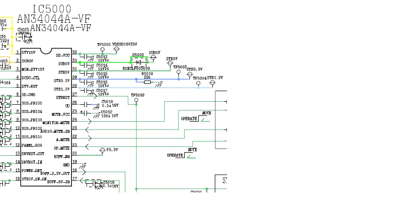

                Pin 30 is 5Vstdby in, 29 is 3.3v out, 28 is 1.2v out. careful not to short out adjacent pins, blk probe on and earth point like where the screws mount the PCB and red tip on the IC pin you want to measure.
                Could be tight , I've never had to check an A board this way, but I reckon if 5v is reaching that chip and no 3.3/1.2 out I think that would confirm A board.
                If the 5v was missing then possibly trace back through the cct , not sure if any surface fuse is present on that line or not, have not looked and I 'm about to hit the sack as very late/early here and I work(try to LOL)
                Yeah , a bit tricky for a beginner I guess. Just be aware of where the AC goes in and the PSU, don't get casual touching heatsinks etc and zap yourself.

                  Re: Tc-p50x3 no sign of life
                  IC5000 from a GT30A manual

                      Hey TW. I checked the ic5000 chip. I have 4.9 v on pin # 30. I have .2 v coming out of pin #29. And nothing out of pin # 28. Does this confirm it's the A board? If so, is there a way to track down the culprit of the problem within the board or is the only fix replacing the entire board? Also, does this mean the power board is ok, or is there no way to tell for sure? I want to thank you one more time for being patient and walking a dummy through this! Thanks.

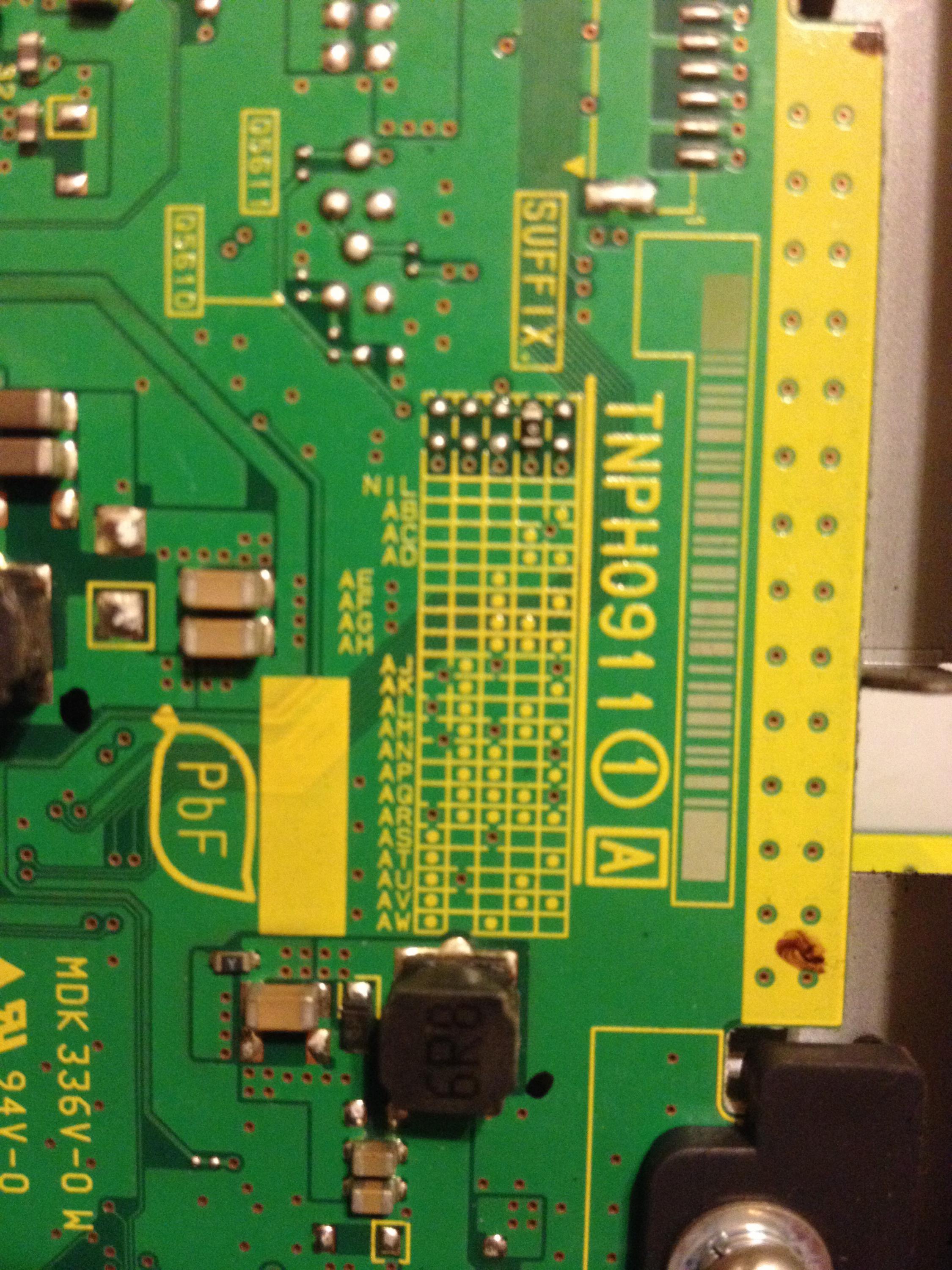

                          Ok I will try and confirm this. My next problem is. I located the model number of the A board and did a search for it. Numerous boards came up that I can order that look just like mine. However, according to one of the sites I have to determine the suffix from a suffix grid on the board in order to get the right part. Is this true? If so, I believe the suffix is "ac". (Tnph0911ac). I attached a picture if you can confirm this.
                          When I do a search for this, nothing comes up. Do you know where I can find this correct part at? If possible I would like to order it from somewhere that has some type of return policy. Again thanks for all your help!
                          • bhawks1028
                            • Sep 2014
                            The image shows that you have an "AC" board
