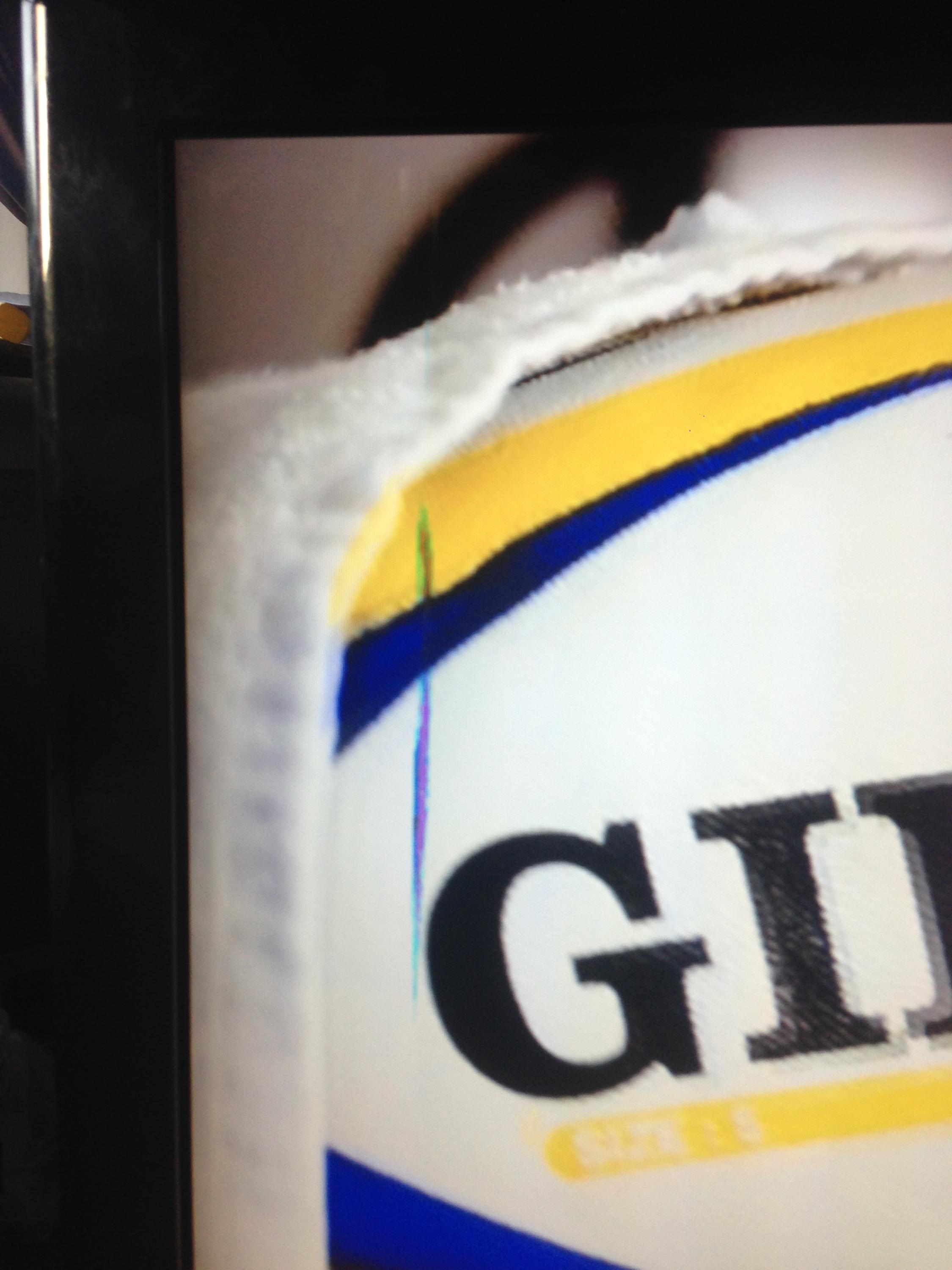

    Morning fellow Cappers,
    Picked up a 52" Samsung LCD. Model - LE52M87BD

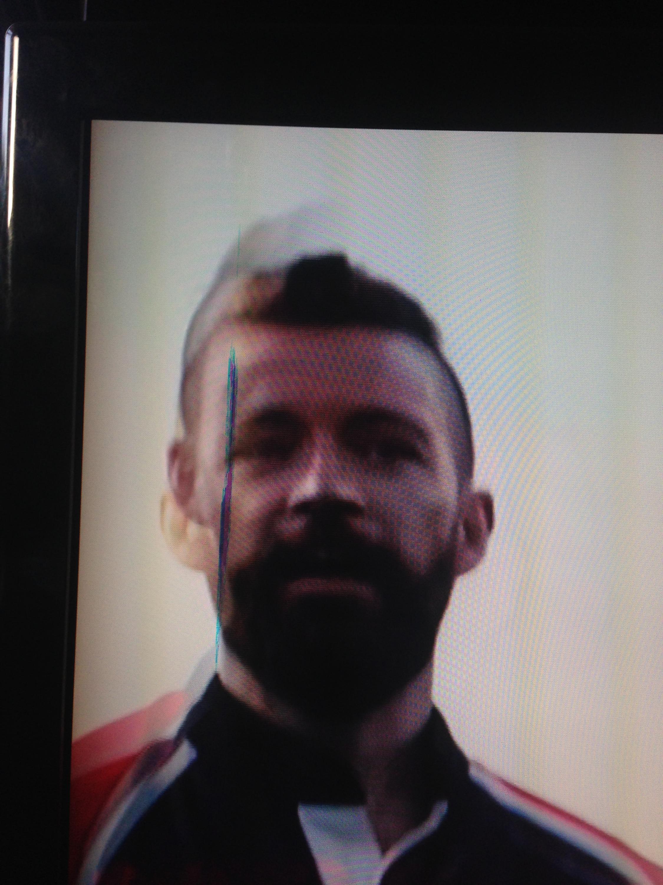

    Powering problems initially, powers up now and again with 'crackling' coming from inside, (Common dry joint on transformer problem. ) Had it powered up without doing any repairs yet and get the following mark on the Panel (Sorry pictures arent the best - will upload more clearer ones soon)
    My question is has anyone seen this issue before and could narrow it down for me. I'm thinking Tab bond, but unsure as its only a slight 8" approx vertical line near top left on screen, I would have thought if Tab Bond it would be full vertical line.?? Just hoping its not the panel itself - although i wont be bothered as I will use this as external comp monitor/games TV.
    Many thanks in advance for advice,
    Steve
    Re: Panel/Tab Bond or Other? (( Samsung 52" LE52M87BD ))
    Some kind of panel leakage or damage due to excessive pressure, I don't think it can be fixed.
      Legend tom66, saves me ripping it right down. Many thanks for the quick reply.
      Will get it cleaned out and give the power board a good check over.
      Thank you
