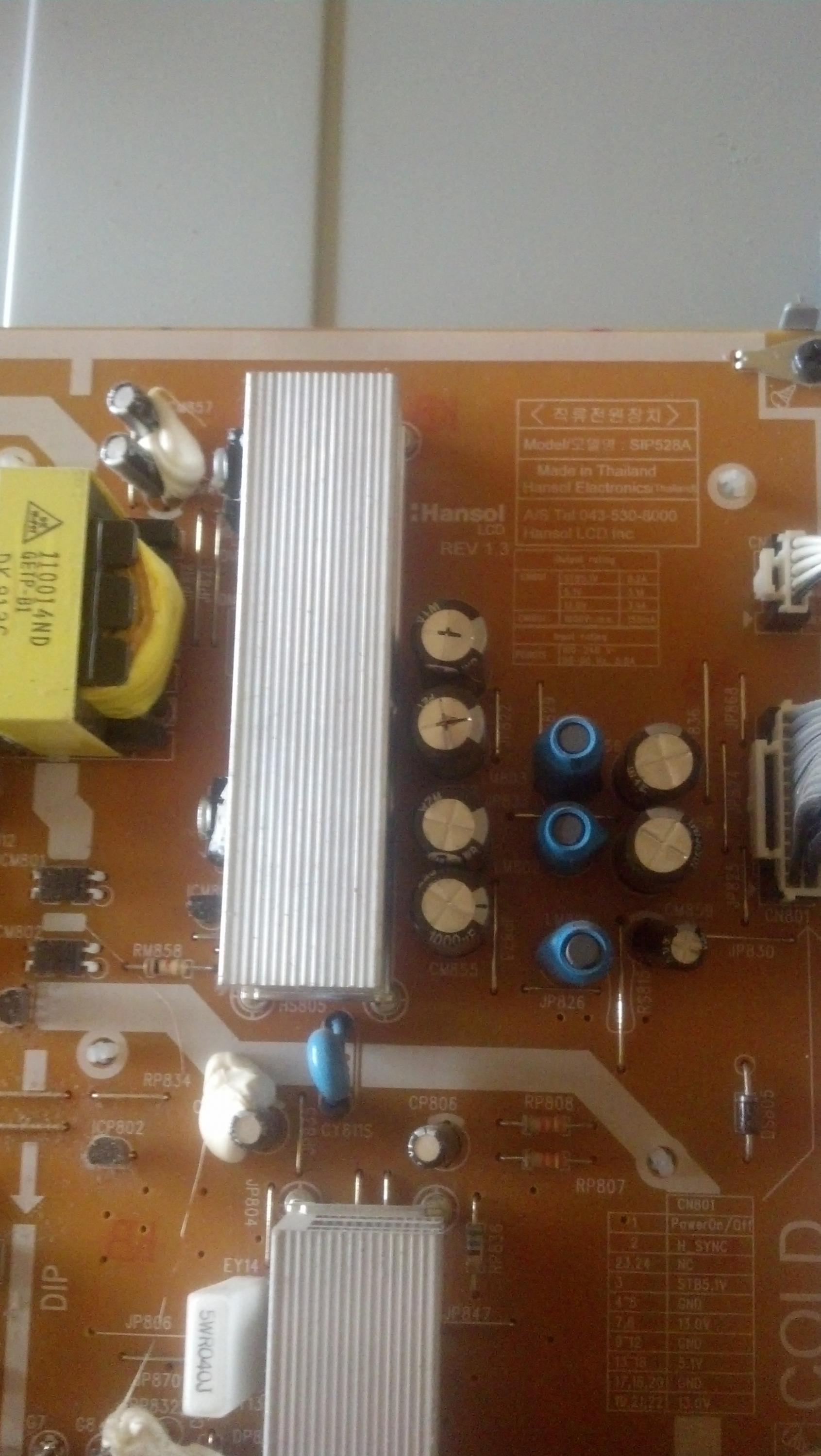

    Samsung LN52A650A1F Power recycles
    Attempts to Power On, recycling continuously. Associate commented that it's T-Con, replaced with new T-Con (TriState) and it recycles appx 12 times, then stays on and operates normally.
    Anyone have any ideas, bad T-Con, Power Supply, Main Board, ?
    Thank you!

    Re: Samsung LN52A650A1F Power recycles
    I'm guessing main or power supply. I recently sold a LN52A750R1FXZA to a friend. It's started doing the same thing. I haven't had much time to get over there and check it out. From what I can find on the net, it looks like it's main board related. I'll definitely keep my eye on this thread.
      How are the caps in the power supply? Standby voltage is solid? I have seen so many of this symptom in Samsung due to bad caps.
        As always, I make assumptions prior to actually seeing the unit. I had assumed T-Con, so I tossed good money for nothing. Now that I've replaced with a good T-Con, and no change, I'm going to assume power supply. I'll have a chance to bench test it tomorrow, will update.
          Didn't notice it when I replaced the t-con, but now the 2 ea 25V 1000uF caps are definitely bulging. Are there any others I should replace just to be safe?
            Replace them all as a set (but not the big 450v one) so you do not have to open it up again.
              Replaced the caps and unit is working fine, thanks Bud!
                Thanks for the repair follow-up.
