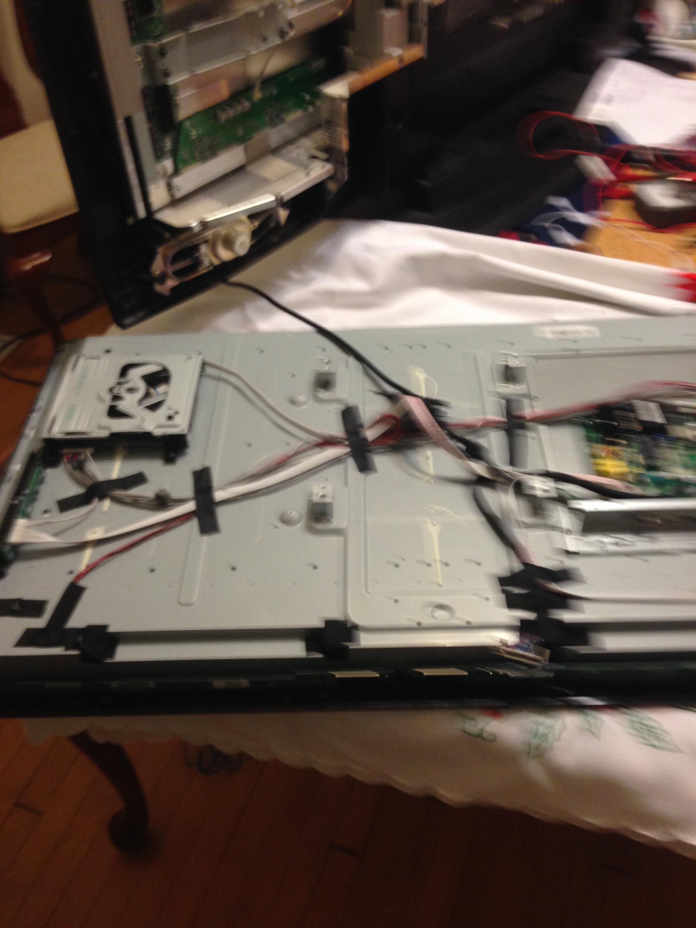

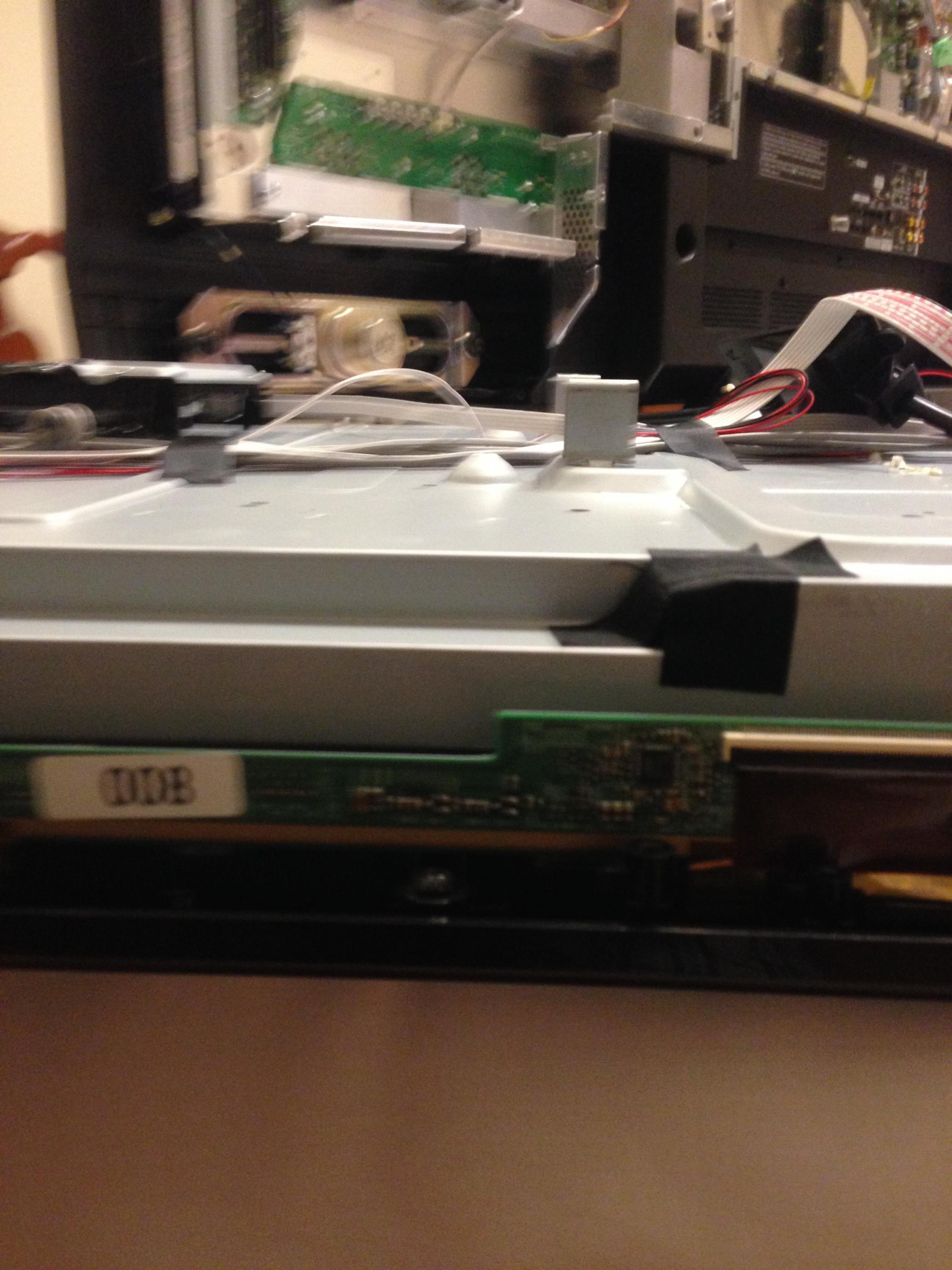

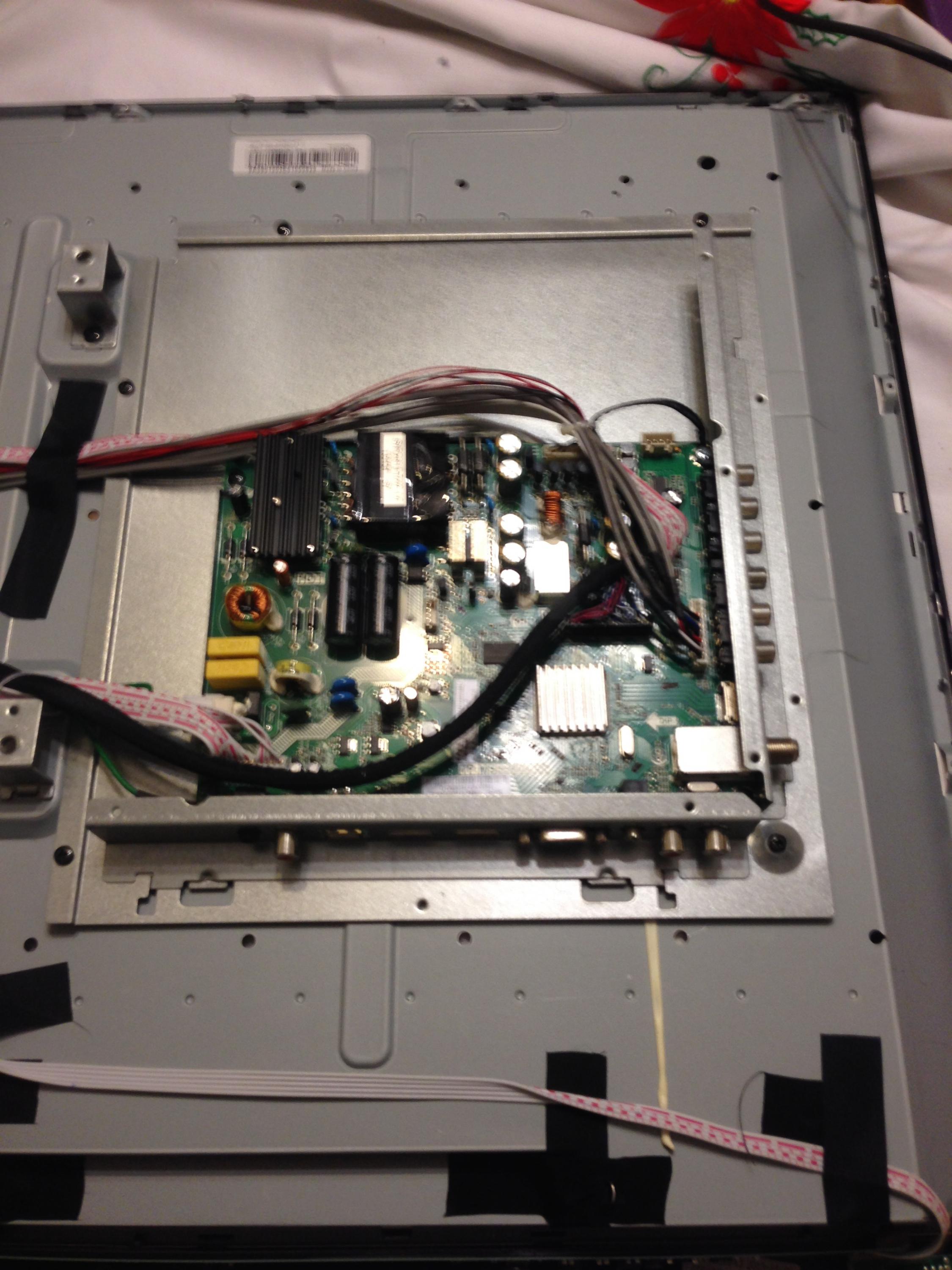

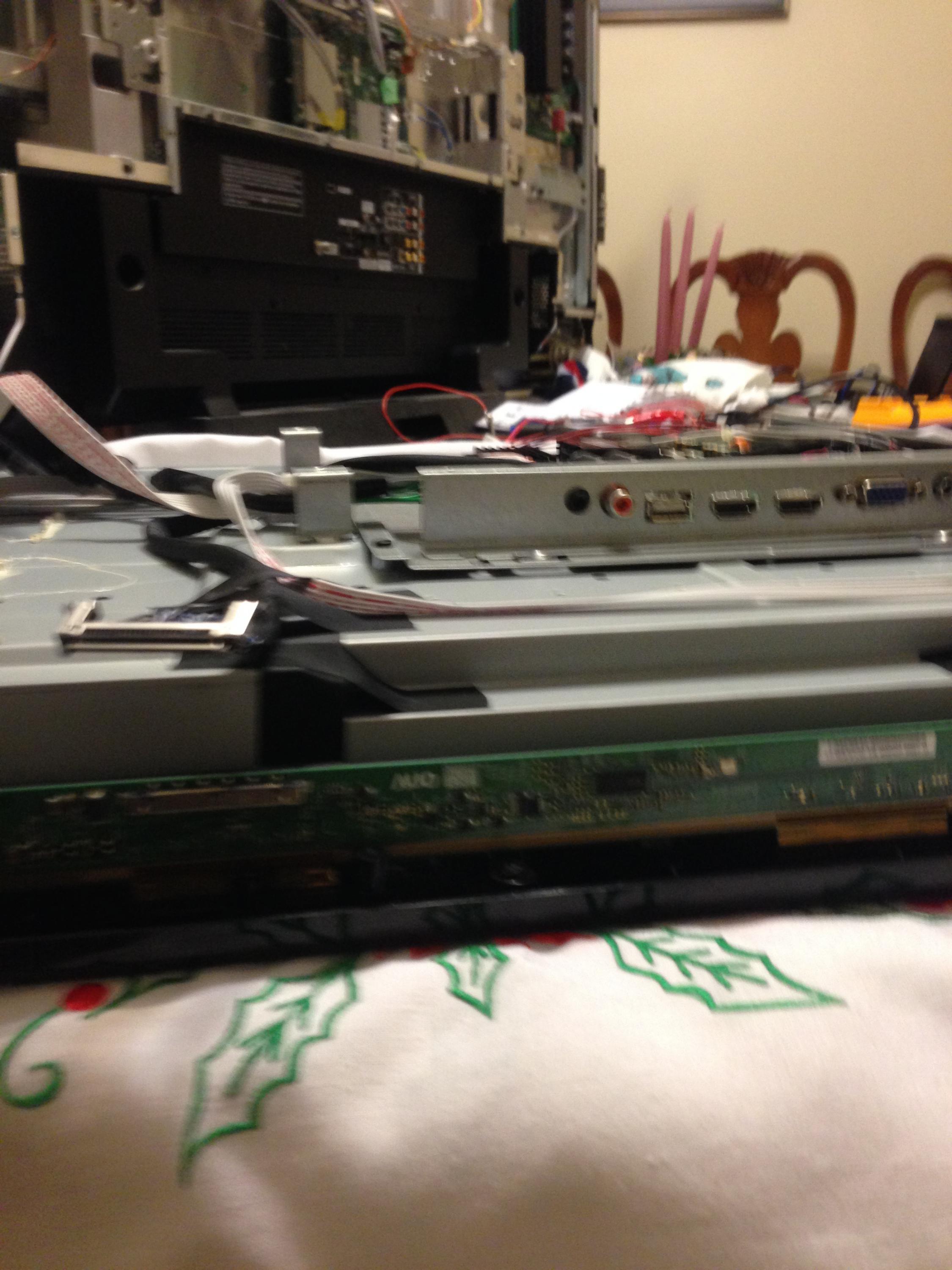

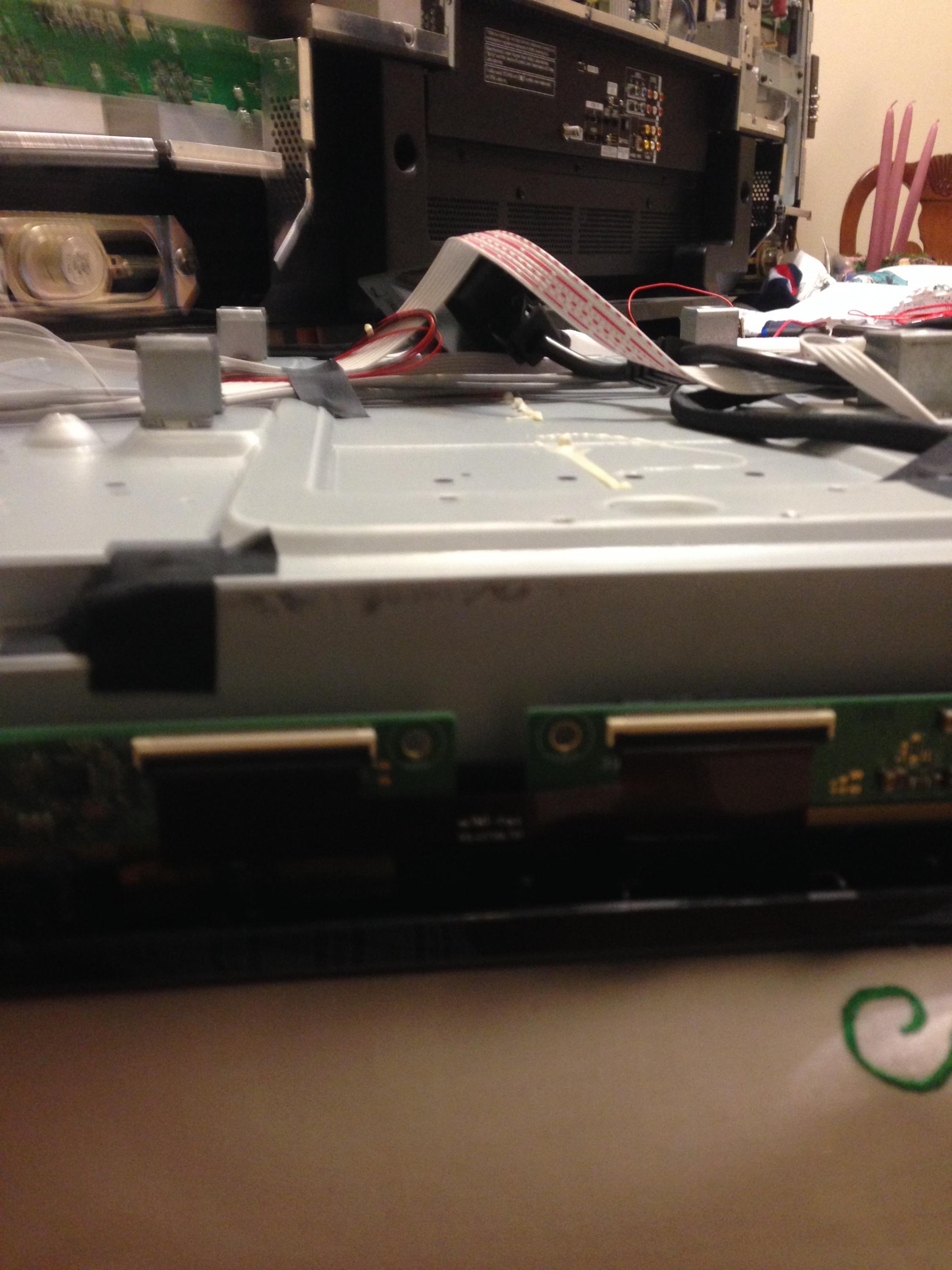

    The video flickers. Cannot find any service manual or schematic for this tv. It is a tv/dvd combo. Here are some pics of the unit, assuming the small boards are the buffer. Here are some pics of the boards. Not much too see. Do the boards with the ribbon cables control the video, or is there a power supply or backlight issue.

        If you put it on a blue screen does it still flicker? Need to see if its the image or the backlights.

                Usually if you set it on a source with no signal you will get a solid blue screen. But it sounds like it is a common problem in the back light of this model to have 3 with similar troubles in quick succession. If you get into the settings you may be able to find a setting labelled Energy Saving or something along those lines. Turn it off and see if it quits pulsing. I think it may be using pulse width modulation to keep down the power usage but it is set at too low of a frequency.

                  I checked the voltages in the inverter cct and used alligator clips to test. When I am taking voltage the backlight comes on and stays on. I found the voltages should be about 30V but it was moving around between 28-61 volts. Could this be a cap issue or semiconductor.
                    Re: RCA 42" RLDEDV3988-a flickering video
                    if the only thing you did was clip in your test leads it sounds like something is loose. However if the voltage is still pulsing while your clipped in look at the power supply, I suppose it could be faulty caps. BTW this tv wont have an inverter circuit as it is using leds, just power to feed the strings of leds and some kind of feed back for fault protection.

                      Hello, firstly check the voltages coming out of the main psu and check that they are in spec.
                      I have seen a tv almost exactly like this but with a different inverter that had the same problem my mate ended up replacing the main board and the psu as the main board was generally glitchy and the psu was out putting bad voltage.

                        I fixed the TV. I was doing voltage measurement on the secondary side inverter section and found an open surface mount resistor. Replaced the part and problem solved. Thanks for the input guys.
