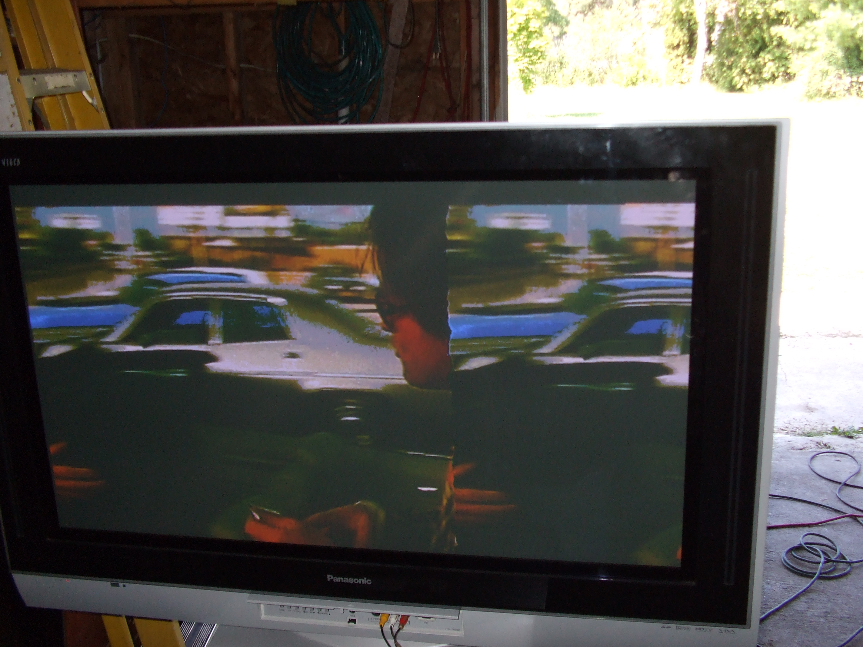

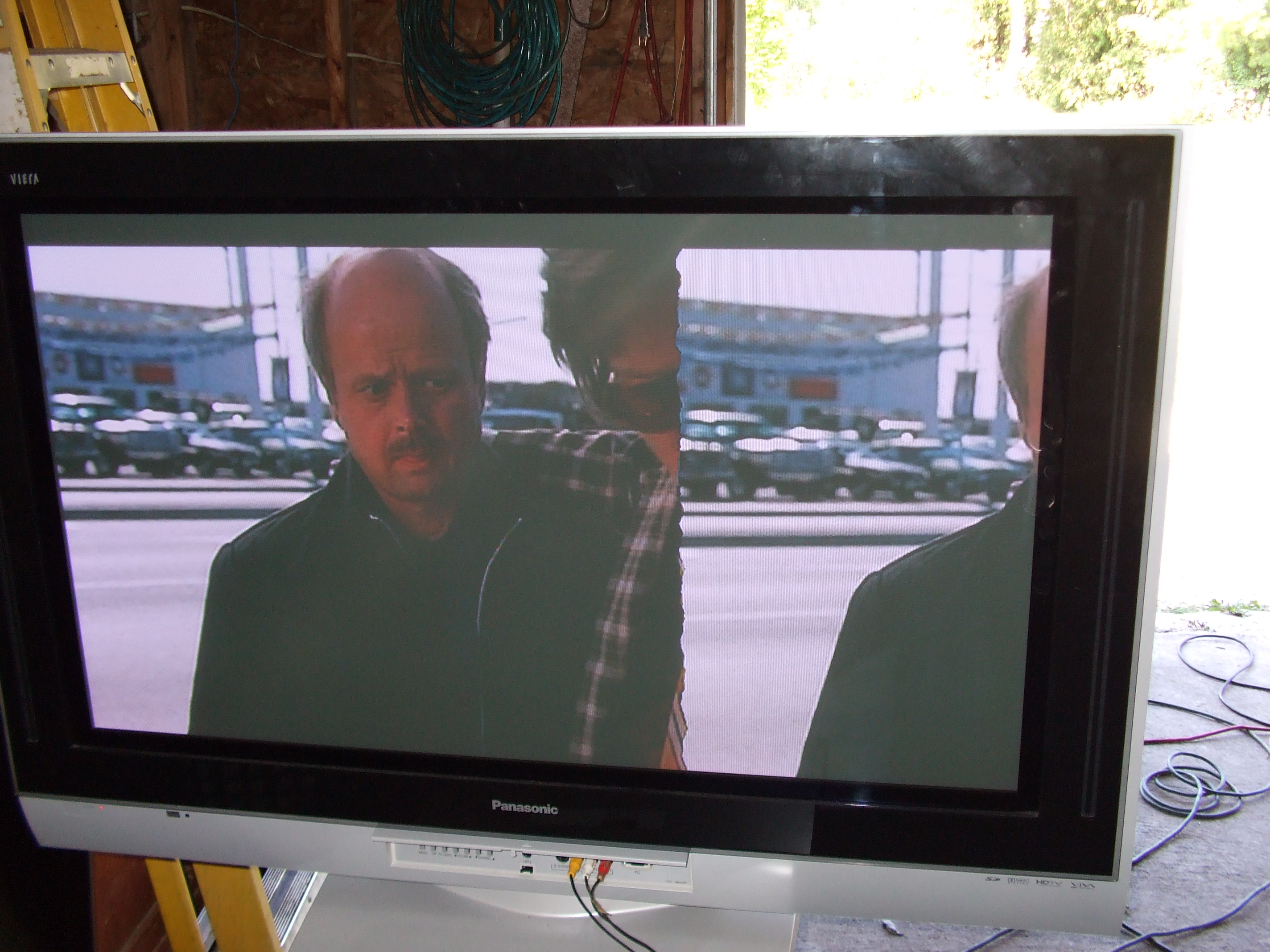

    Pansonic TH-42PX25 double half picture
    Nice dumpster find,,,starts right up ,,normally find sustain board issues,,this one plays nice ,,problem is has 2 left side of screen running on both halves,,what piece would be suspect??? thanks gbaum

    As for the fault, does that split between the two halves wobble, or is it fixed as it is?

      Re: Pansonic TH-42PX25 double half picture
      The picture on both halves is very stable,,,the line between the two pictures is very wiggly

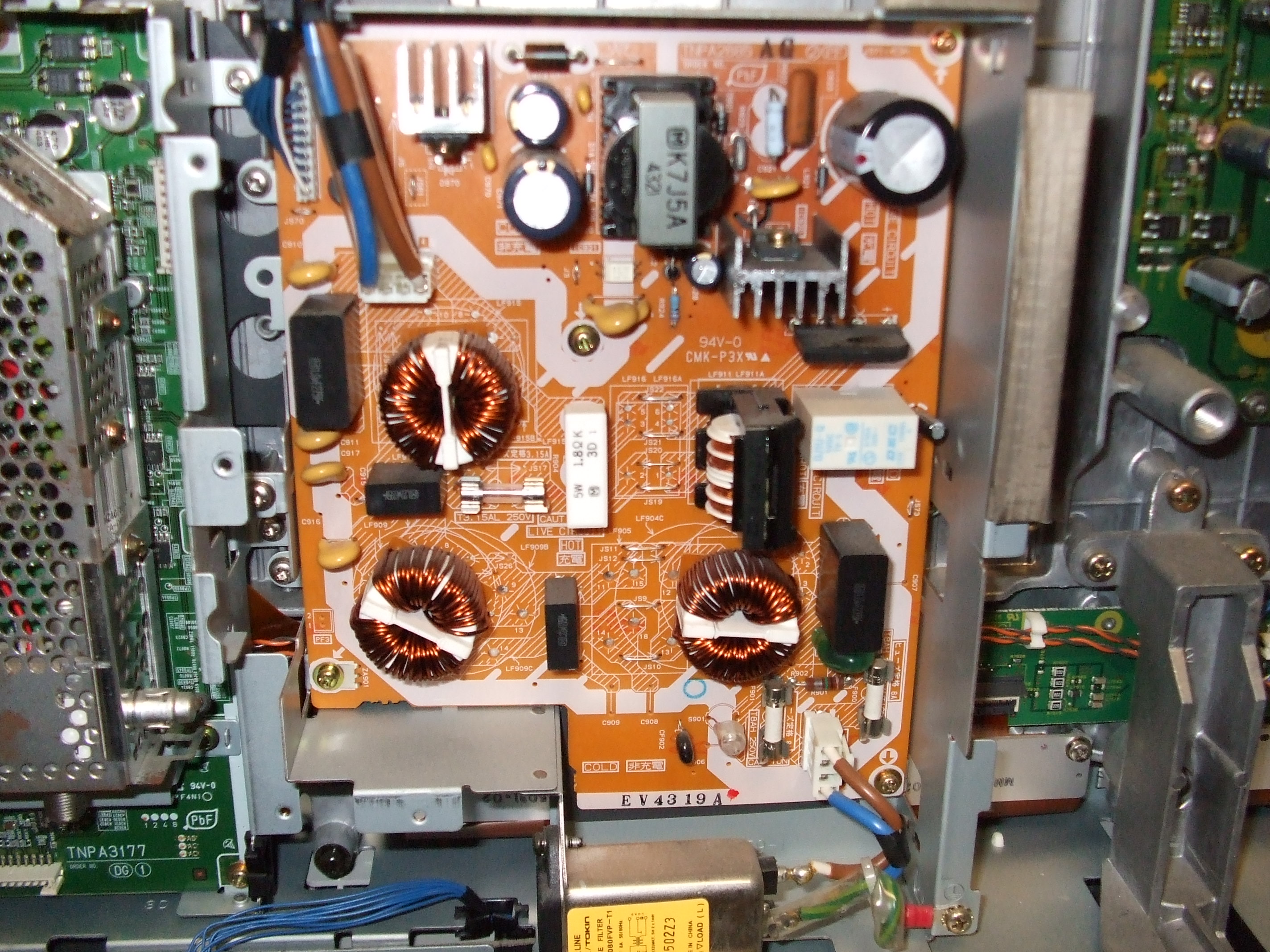

        from the pics...the power supply seems ok. check the main board for problems. looks like a processor chip. need more pics of the inside

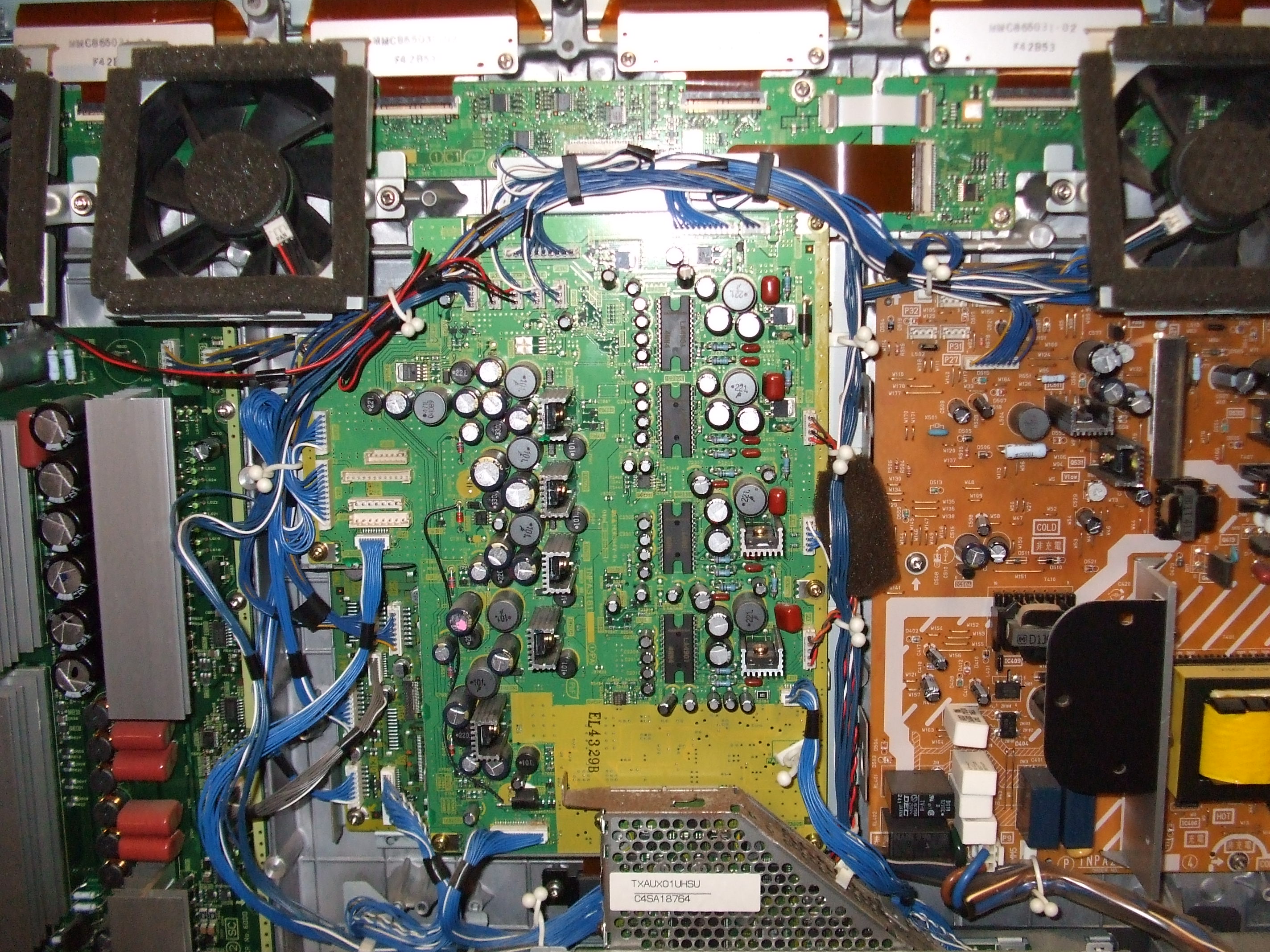

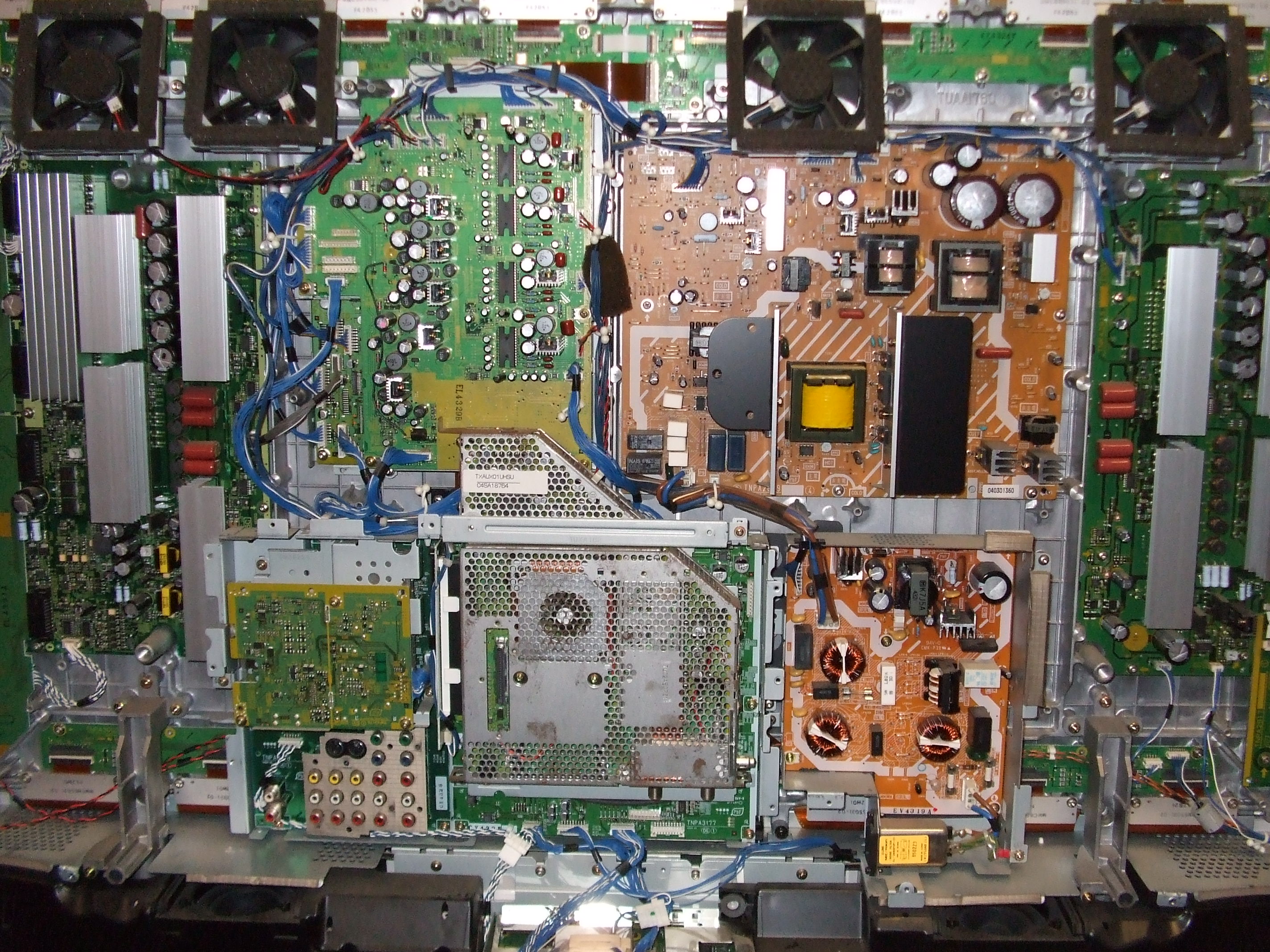

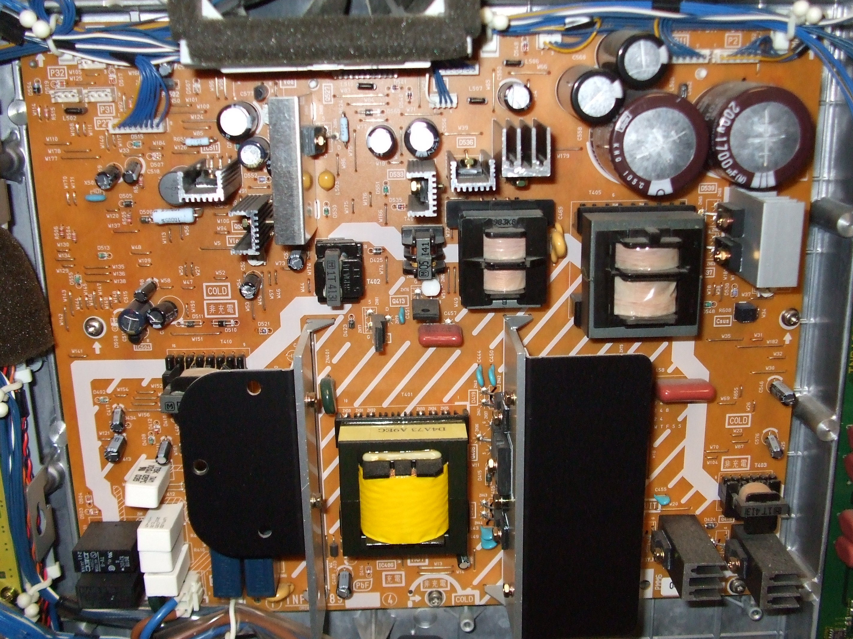

            Is this a tv chasis or part of the space shuttle????...
            several shots of the chassis... the 2 large caps on secondary power board are bulging on top some what,,other than that ,,rest looks good
              Did more testing/research on this set,,,,when you go to set-up screen,,,the screen is totally normal,,,now select computer monitor mode, it works perfect....Which ever board controls some of the input other than vga has a problem....
              This is going to be used as a computer monitor / shop display,,,so really don't need to put more time in it other than to assemble the back!!!!
