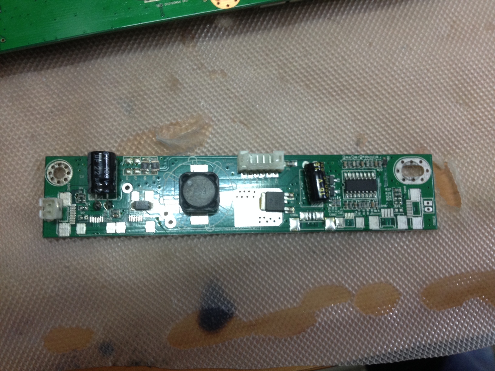

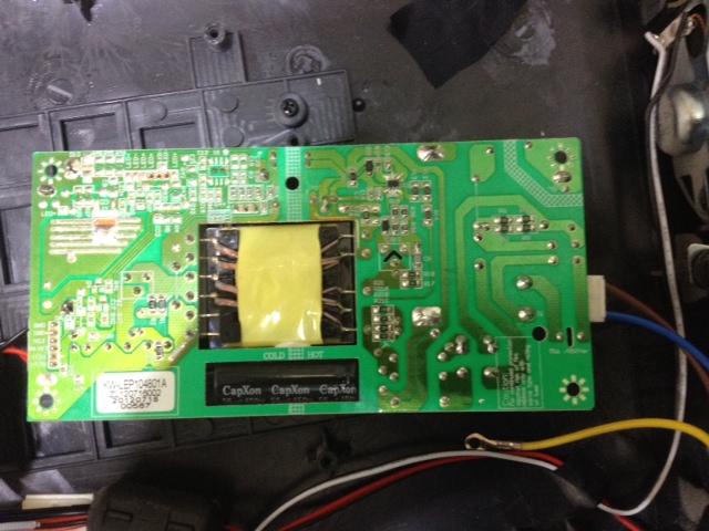

    hi guys the tv is so dark and has a problem with the backlight but in other hand i can see that the tv is working ( i can see the logo of inova)
    please guys help me

    i think this is the inverter
      Re: inova nt24 24 inch backlight problem
      Your pics are very dark - not good for troubleshooting - is this a led tv - The small board in the last picture what is that? led controller?
        it's lcd it's not led
          Well I cant see an inverter or inverter transformer/s
          What is that small board - Board number??

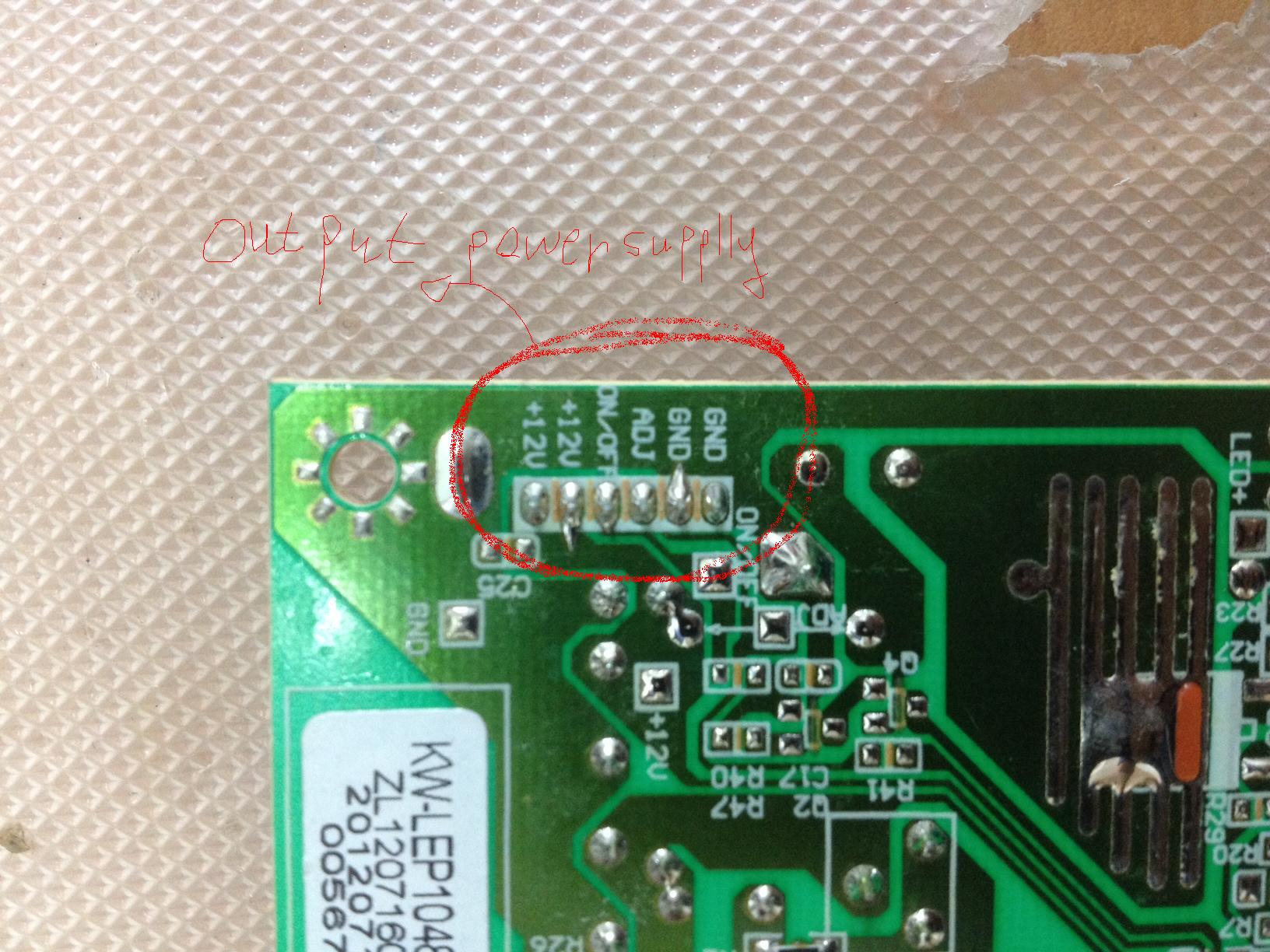

            That looks like an LED power supply, but I can't see an output connector??

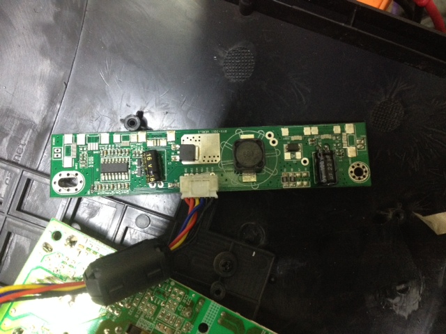

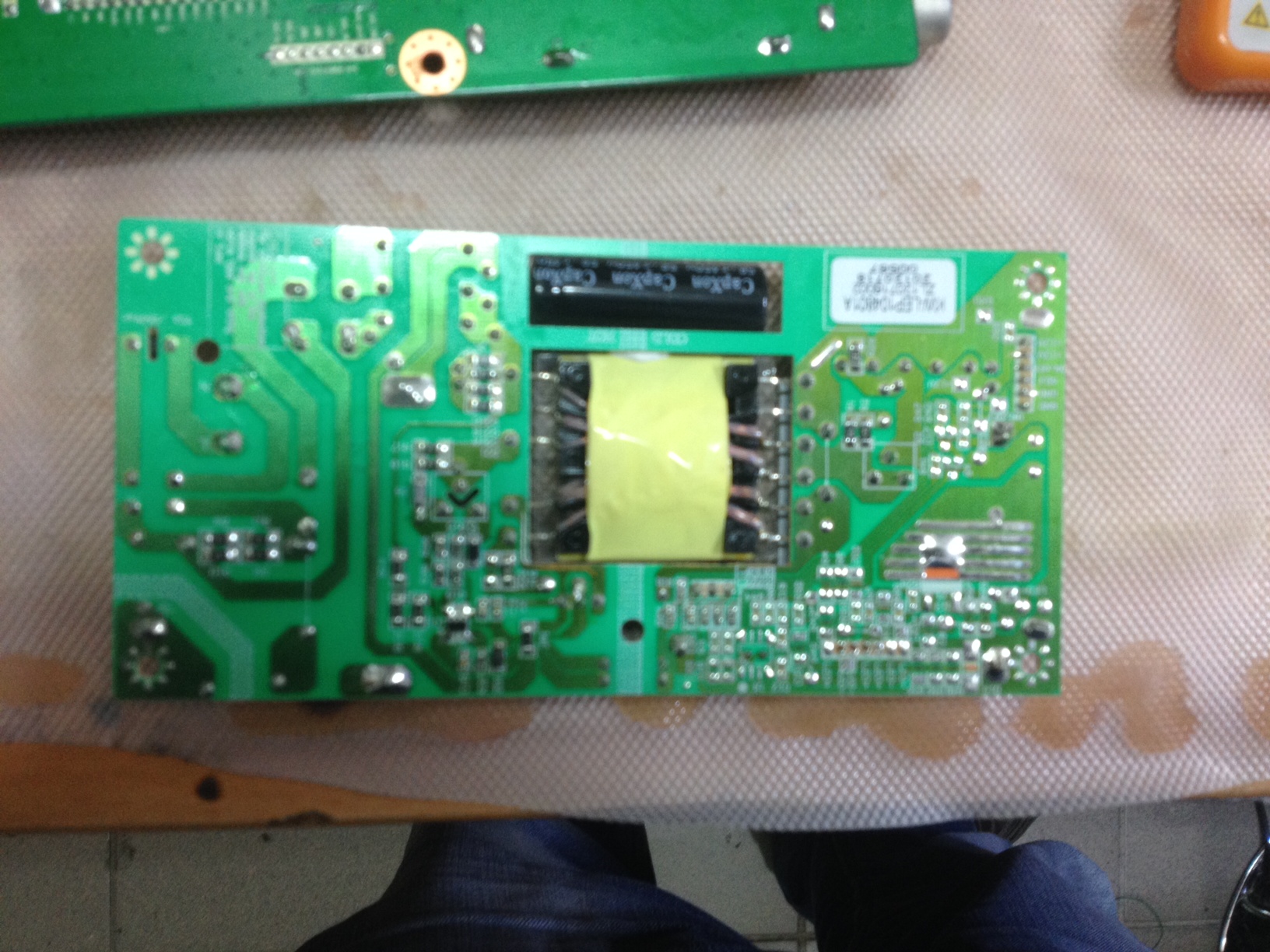

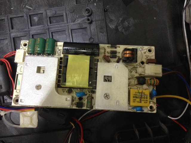

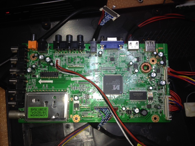

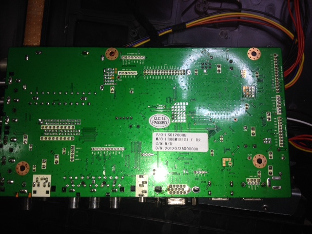

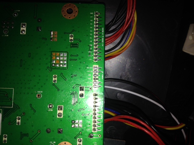

                these are the rest of the boards , one is logic and the second is the power supply

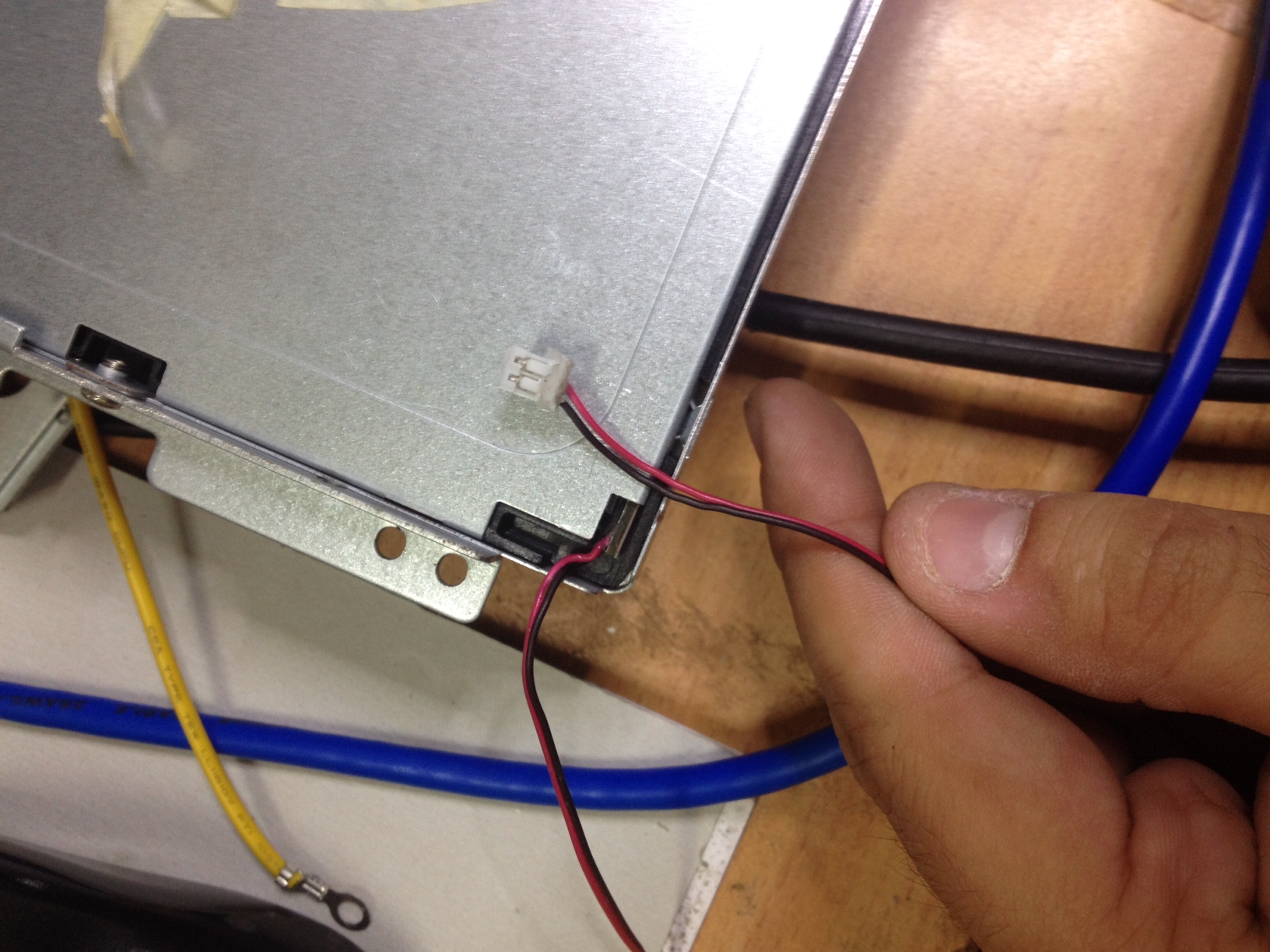

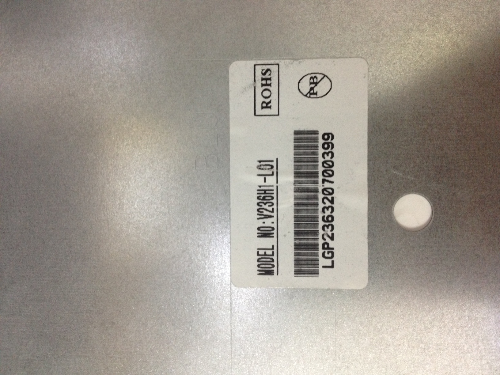

                    this is the model of the screen and the little cable that connect to the inverter
                      why there is no backlight but i can see that the screen is working

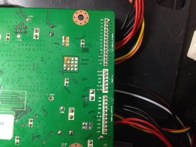

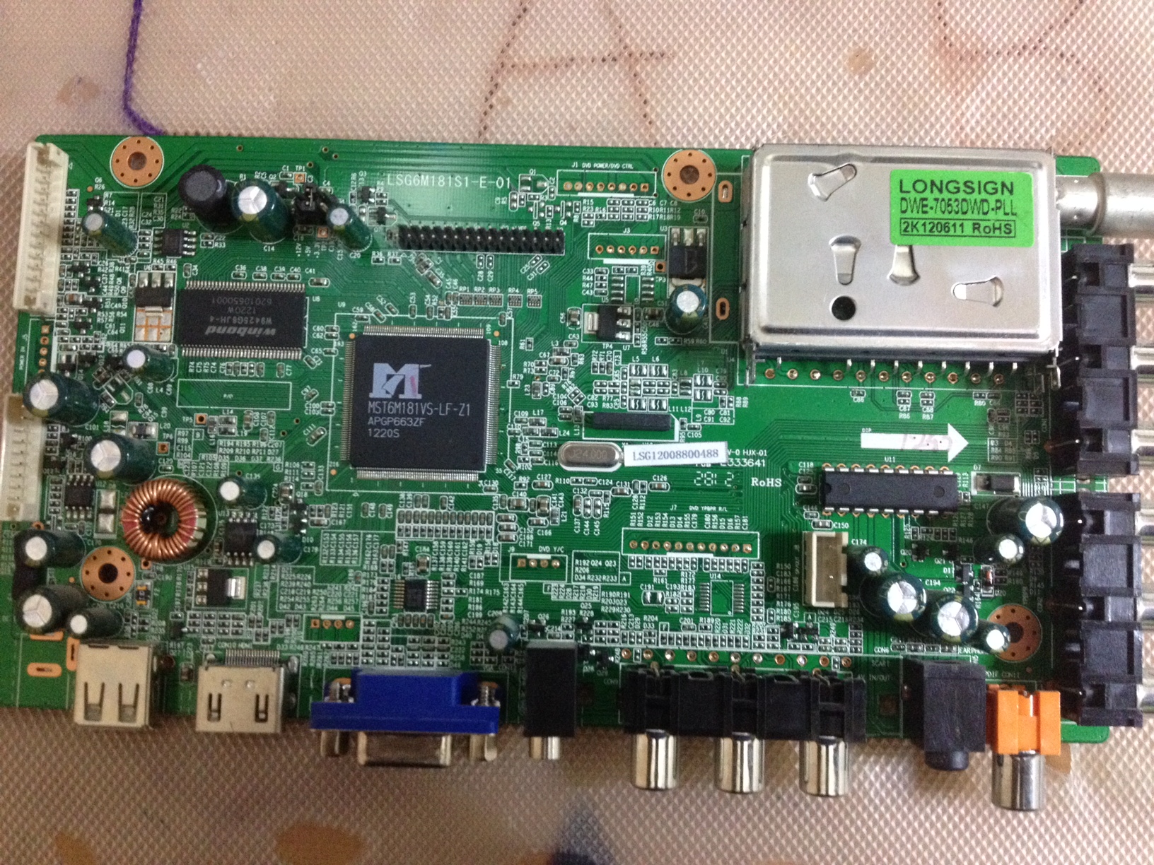

                        logic board

                          In this case it is not an inverter but an LED driver, because this screen does not use CCFL, it uses LED backlight.
                          So you can use your multimeter to measure the voltage across the red and black on the LED driver with everything connected and see if it is OK or not.
                            it told me 69 volt

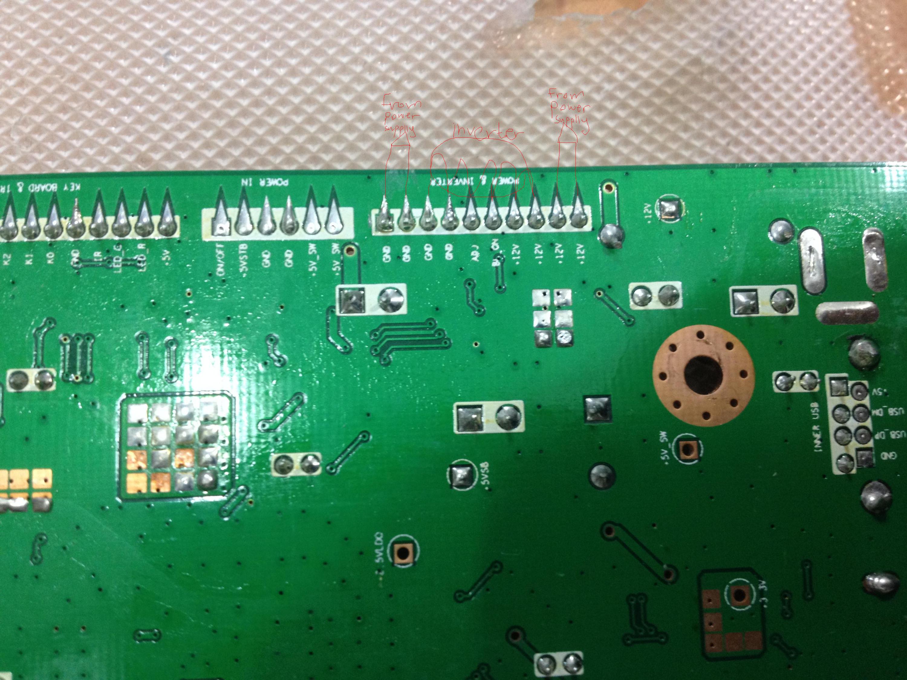

                              power supply
                                it should be more than 69 volt right?
                                  do you mean to check the voltage of those pins that has red circle mark?
                                  i have already checked those and it give me 69 votls , is it enoght voltage to let the backlight power on ?
                                    Sounds reasonable for a 24" panel, unfortunately I cannot find any info to tell for sure but it seems OK. I think the fault therefore is with an LED in the panel.

                                        so the led panel not the boards ?
