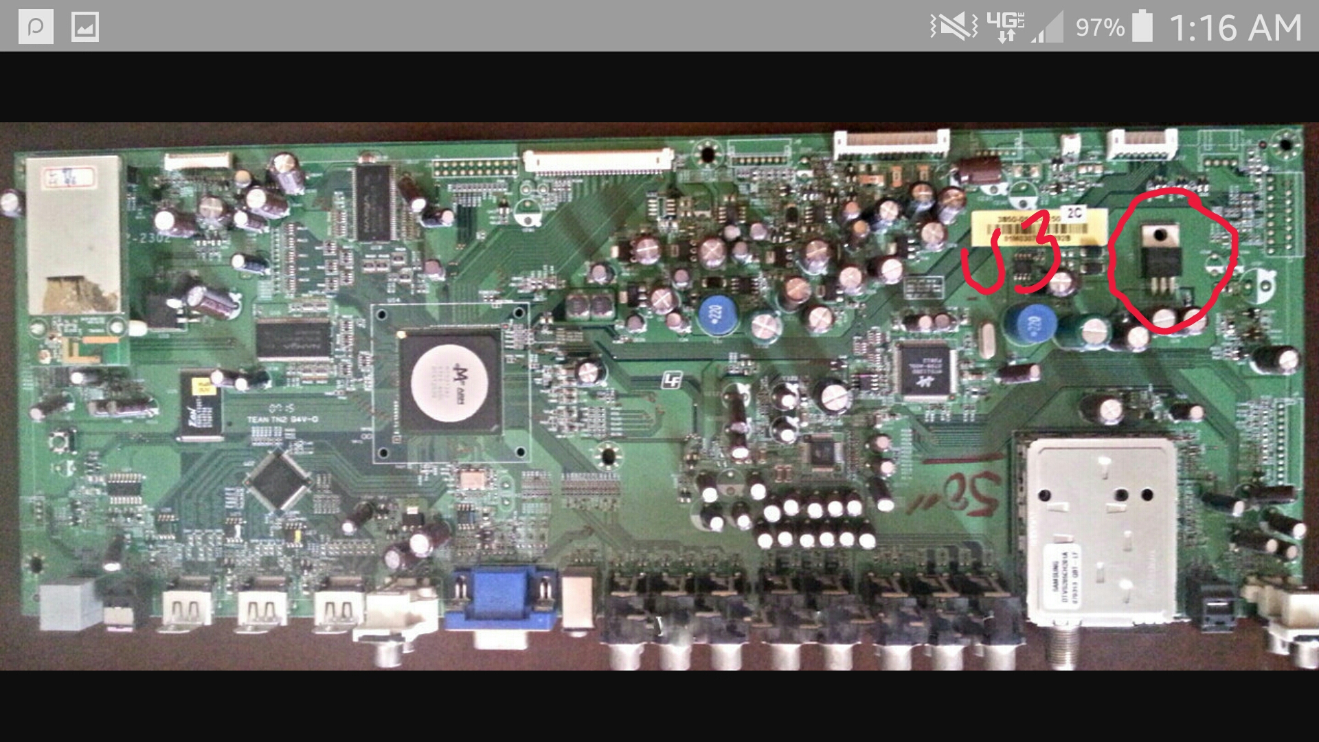

Vizio jv50p HDTV10A no power no relay click
  • ajt9170
    • Aug 2014
    • 3
    • us
    Vizio jv50p HDTV10A no power no relay click
    Hi All, I repaired this plasma about 4 years ago for the power supply caps issue by replacing the power supply with one from a older P50HDM part number USP700M-50LP, I had in my parts graveyard.
    This unit works anywhere from 12 to 20 hours daily without any issues.
    A few days ago I fell asleep with the tv on. When I awoke the tv had no sound, on screen volume indicator worked, images and osd worked fine, I also changed the source to TV ant but got no channels or image, tried other inputs and worked fine but still no sound.
    I decided to restart the unit but after switched off it would not power up again. I unplugged it and waited about an hour, but it made no difference, the vizio logo wound stay orange ant not change to white, also when plugged in the relays would not click at all.
    SO I figured power supply again and rebuilt the old one, pop open the back panel expecting to see some bad caps but everything seemed fine.
    Installed the rebuilt power supply anyway but nothing happened, same issue, no relay click.
    Checked voltages on ASD= 4.5 , 5vsb= 5v, all else is 0.
    So I figured that the problem must be the main board since the tv worked fine untill I turned it off Plus not having tv tuner operation.
    I found another fellow on this forum with a similar situation but that unit at least had the relays activating. His problem was solved by replacing a LDO, the one he replaced is actually OK on mine.
    PlainBill uploaded a picture indicating all the LDO on that board, unfortunately I have no reference voltages for them. Some measure 3.5 others 2.6 and still others nothing at all.
    Any help will be greatly appreciated.
  • ajt9170
    • Aug 2014
    • 3
    • us
    Re: Vizio jv50p HDTV10A no power no relay click
    Guess ill keep talking to myself, found one regulator on main board that was bad, replaced it and all is back to normal.
    • shawt99
      • Oct 2016
      • 22
      Re: Vizio jv50p HDTV10A no power no relay click
      hello i know it has been a couple of years but i was wondering if you remembered which voltage reulator it was you replaced. i have a jv50phdtv10a tv that i am working on. the set powers up (logo turns white) however i have no sound or picture, but i do have the u33 regulator that feeds u7 and u9 putting out a stead 3.28 volts. i am at a loss.
        Re: Vizio jv50p HDTV10A no power no relay click
        So what are the DCV reading on all 3 pins of those regulator ICs? That will be a start.
        • shawt99
          • Oct 2016
          • 22
          Re: Vizio jv50p HDTV10A no power no relay click
          hello sorry for the slow response it has been a busy couple of days. the voltages on the 3 pins are as follows.
          u33- in 4.8v
          out 3.28v
          adjust 1.2v
          i managed to find a service manual for that particular main board and the u33 as well as the u7 and u9 voltages are all correct. however at the j10 connector, pins 10, 11, and 12, all labeled 5vsc should put out around 5v. when i powered the unit on, there are no relay clicks, no image and no sound but the vizio logo does turn from orange to white. the voltage readings on that j10 connector at the corresponding pins is only reading .80 volts. but i am thinking that because there are no relay clicks the power board is not being turned on as i am not getting 12v readings off the pins.
            Re: Vizio jv50p HDTV10A no power no relay click
            Vout of the Adjustable 1117 series is = 1.25Vref +Vadj, so the Vout of that U33 should be = 1.25V +1.2V = 2.45V (basically 2.5V).
            • shawt99
              • Oct 2016
              • 22
              Re: Vizio jv50p HDTV10A no power no relay click
              yes you are absolutly right, that was my mistake i had the voltages mixed up with another regulator. the adjustment pin on u33 is reading 2.2. so the 1.25 ref and the 2.2 adjust would come to 3.3 volts which is what the service manual is saying should be the output on u33.
              • shawt99
                • Oct 2016
                • 22
                Re: Vizio jv50p HDTV10A no power no relay click
                well the problem was staring me in the face the entire time hidden under a piece of tape. during my search to check the regulators on the main board i could not find u10. searched and searched and searched but couldnt find it. then i happened to take a quick look at the board while taking a break from another project and found the missing regulator under a piece of tape, and sure enough theres a voltage issue because the out pin got so hot it broke off, on all 3 boards. (yes i have 3 main boards its a long story) anyhow off to find a new regulator to replace u10 and check its input voltage since i have a feeling its way too high.
                • shawt99
                  • Oct 2016
                  • 22
                  Re: Vizio jv50p HDTV10A no power no relay click
                  well the problem was staring me in the face the entire time hidden under a piece of tape. during my search to check the regulators on the main board i could not find u10. searched and searched and searched but couldnt find it. then i happened to take a quick look at the board while taking a break from another project and found the missing regulator under a piece of tape, and sure enough theres a voltage issue because the out pin got so hot it broke off, on all 3 boards. (yes i have 3 main boards its a long story) anyhow off to find a new regulator to replace u10 and check its input voltage since i have a feeling its way too high.
                  • shawt99
                    • Oct 2016
                    • 22
                    Re: Vizio jv50p HDTV10A no power no relay click
                    oh, cancel that apparently the middle pin, even though theres a spot to solder a pin that is labled vO doesnt have to be soldered. the tab is the output and the output is 2.6, which is right where it should be.
                      Re: Vizio jv50p HDTV10A no power no relay click
                      Originally posted by shawt99
                      oh, cancel that apparently the middle pin, even though theres a spot to solder a pin that is labled vO doesnt have to be soldered. the tab is the output and the output is 2.6, which is right where it should be.
                      It is the same setup as the 1117, the middle pin in connected internally to the big tab.
                      • shawt99
                        • Oct 2016
                        • 22
                        Re: Vizio jv50p HDTV10A no power no relay click
                        I discovered that the hard way lol. I did manage to get the rest of the regulators readings they are as follows.
                        U. Vin. Vout. Adj.
                        33. 4.3. 3.36. 2.07
                        8. 4.82. 3.28. 2.04
                        4. 4.3. 3.26. 2.02
                        3. 0. 0. 0. ????????
                        7. 3.37. 1.26. .02
                        9. 3.37. 1.49. 0?????
                        35. 4.3. 3.2. 1.99
                        10. 4.29. 2.61. 1.36
                        2. 4.3. 3.23. 2
                        Any thoughts on why u3 has no in or out voltage??
                          Re: Vizio jv50p HDTV10A no power no relay click
                          Is U3 also 1117? It can be that the rest of the switched power supplies are not on at this point.
                          • shawt99
                            • Oct 2016
                            • 22
                            Re: Vizio jv50p HDTV10A no power no relay click
                            No u 3 is not a 1117. It's larger, I'm unable to get the exact number off it at the moment. I'm also wondering if it's part of the circuit that is responsible for turning on the psu. I'm trying to find out what pin on the j10 connector turns it on so I can short it with the standby voltage and see if the relays click.
                            • shawt99
                              • Oct 2016
                              • 22
                              Re: Vizio jv50p HDTV10A no power no relay click
                              Here it is.
                                Re: Vizio jv50p HDTV10A no power no relay click
                                Look to be LM7805 or something like that.
                                As you can see, there are 3 SMD fuse by the connector that goes to the power supply board and one of them should have 5VDC at both ends which will be the standby power supply, the other two fuse are fed by switched power supplies which probably are not on right now but you can check all those 3 fuses just to make sure they are OK first.
                                • shawt99
                                  • Oct 2016
                                  • 22
                                  Re: Vizio jv50p HDTV10A no power no relay click
                                  I've actually checked those fuses lol. The 5v fuse is on and reading 5 volts at both ends. The other two fuses both have continuity. Oddly the voltage reading on them was around .8 which was the same voltage I was getting at the 5vsc pins going from the psu to the main.
                                    Re: Vizio jv50p HDTV10A no power no relay click
                                    Right now the main board is not sending the PS-ON to turn on the rest of the power supplies so there will be no Voltages on the other two fuses, only the 5VSTBY is working, so more in-dept troubleshooting of the main board is required. May be something is locking out the main board from sending the signal.
                                    Last edited by budm; 11-02-2016, 10:00 AM.
                                    • shawt99
                                      • Oct 2016
                                      • 22
                                      Re: Vizio jv50p HDTV10A no power no relay click
                                      It was working after I replaced u33, then after about 6 hours picture and sound went out. Vizio logo still turns white but no relay clicks and no picture or sound.
                                      • shawt99
                                        • Oct 2016
                                        • 22
                                        Re: Vizio jv50p HDTV10A no power no relay click
                                        new update, replaced the main board, tv turned on and ran great for about 5 minutes then a fuzzy sound and nothing, no sound no picture. something keeps burning up the main board
                                        • CoinCoin88
                                          Garage door RX unit (Cardin S38C) does not short relay to send opening signal
                                          by CoinCoin88
                                          I'm turning to the Badcaps community to help me troubleshoot the radio Rx card from my (old) garage door opener. While I could just ditch that card and replace the whole system, I first would like to understand "why" it suddenly stopped working, because that's just how I am wired...!
                                          Some basics: the receiver works on a 30.875 Mhz frequency. Yes, I'm aware this is not in use anymore in a looot of places. It does not use any rolling code, it's just a regular dip-switch code that you have to set up on both the receiver and transmitter. The receiver...
                                          09-15-2025, 03:36 AM
                                        • SS454
                                          vizio e650i-a2 backlight flashes then turns off
                                          by SS454
                                          vizio e650i-a2 (LWJAOZBP Serial) led backlight flashes then turns off, has video (via flashlight) and audio.
                                          panel: au optronics T650HVN05.4
                                          72 led total on 12 strips, 6 led per strip wired in three groups of 24 (led driver board has three anode and three cathode pins)
                                          link to datasheet: https://datasheetspdf.com/pdf-file/8.../T650HVN05.4/1
                                          Vizio 56.04219.641G (liteon PA-3231-01WN-LF) Power Supply Unit
                                          https://www.shopjimmy.com/vizio-56-0...-power-supply/
                                          Vizio 55.75J01.001G (91.75J10.004G) Main Board...
                                          08-20-2020, 03:57 PM
                                        • jm1234
                                          9V relay temperature 40C
                                          by jm1234
                                          Hi, I'm seeing one 9V relay having temperature 40C on its 9V (primary) side. Does that seem right? I switched 2 relays on that board and the temperature was the same (on the same position), so I'm sure it's not a faulty relay. I measured voltage on that relay and it was 9.5V DC, so that looks good. I don't see any other relay on that board having that kind of temperature and they have 9V on them too.
                                          I thought maybe the transistor that is switching this relay keeps switching on/off, so I also checked for AC and there was almost none: 0.3V using mV range. No steady frequency was shown, but...
                                          05-09-2024, 03:03 AM
                                        • edugimeno
                                          Biomass Boiler not driving cleaner motor relay. ENERTRES BIOMASA BI-650
                                          by edugimeno
                                          Hi everyone!
                                          I have this board that suddenly stopped supplying power to an output that drives an interchanger cleaner motor.
                                          I checked while the board was in place with all wires attached and there's no AC voltage on the corresponding plug X5
                                          This X5 is driven by fuse F8 (tested OK) which comes from the second orange relay
                                          To make sure there are no charcoaled contacts inside the relay, I got a 24VDC power supply and got it ready to manually power up the coil side of these relays.
                                          I respected the polarity, positive to cathode of protecting diode
                                          So provided all...
                                          04-18-2024, 01:15 PM
