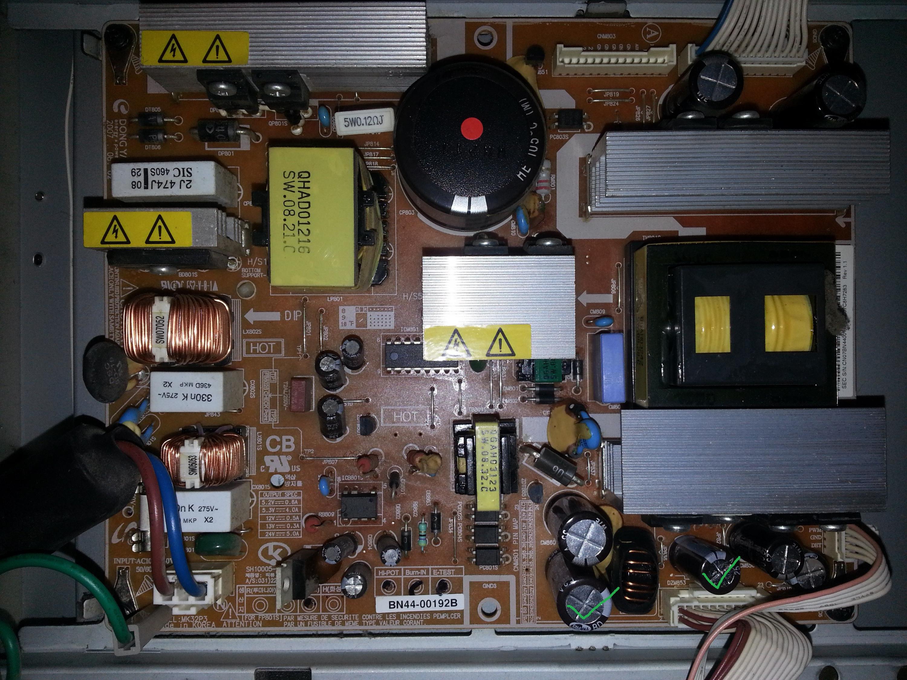

    Power board sticker reads BN44-00192B - Rev 1.1
    All 10v caps on power board recently replaced with 25v (just 2 caps)

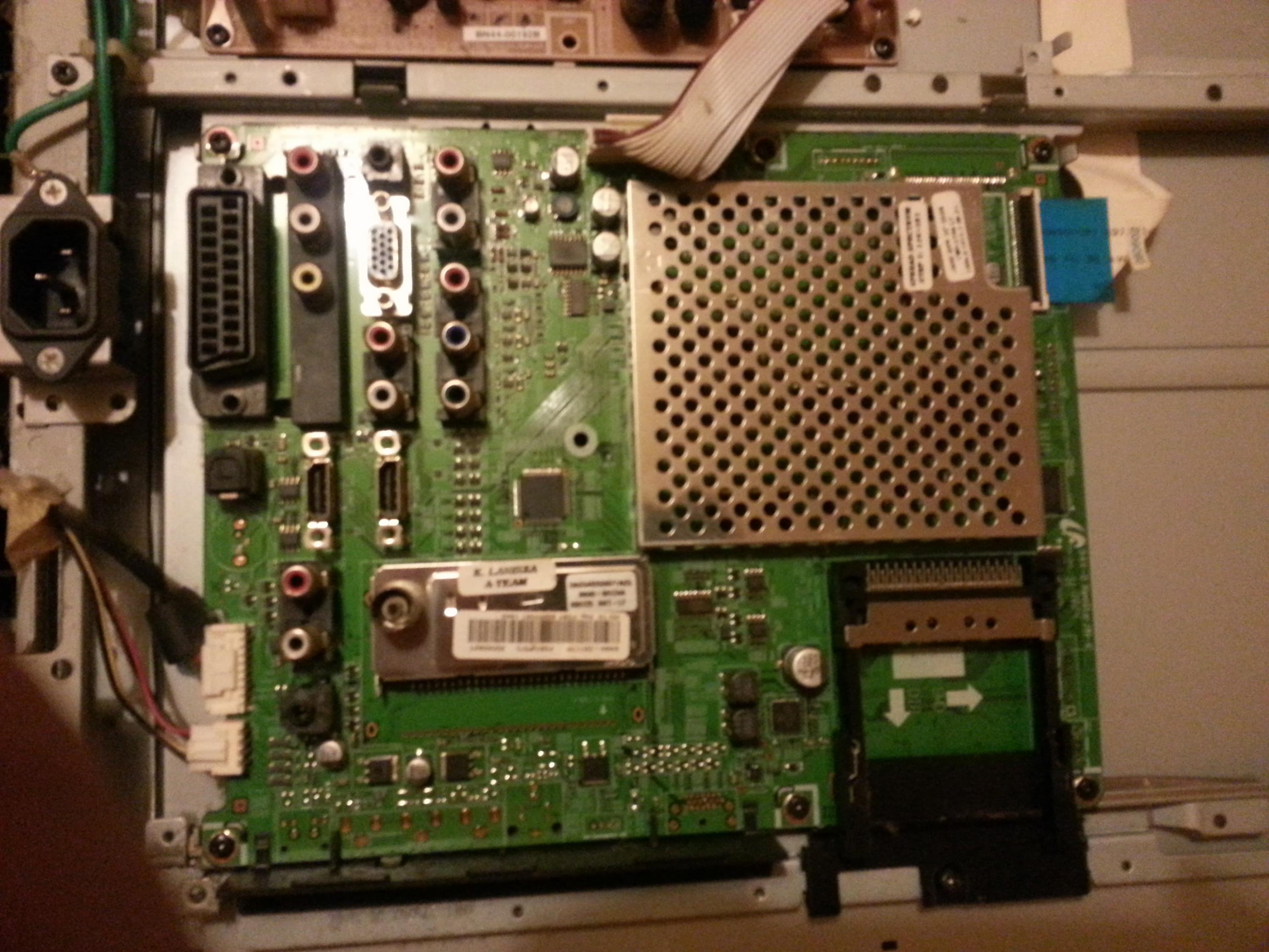

    Main board

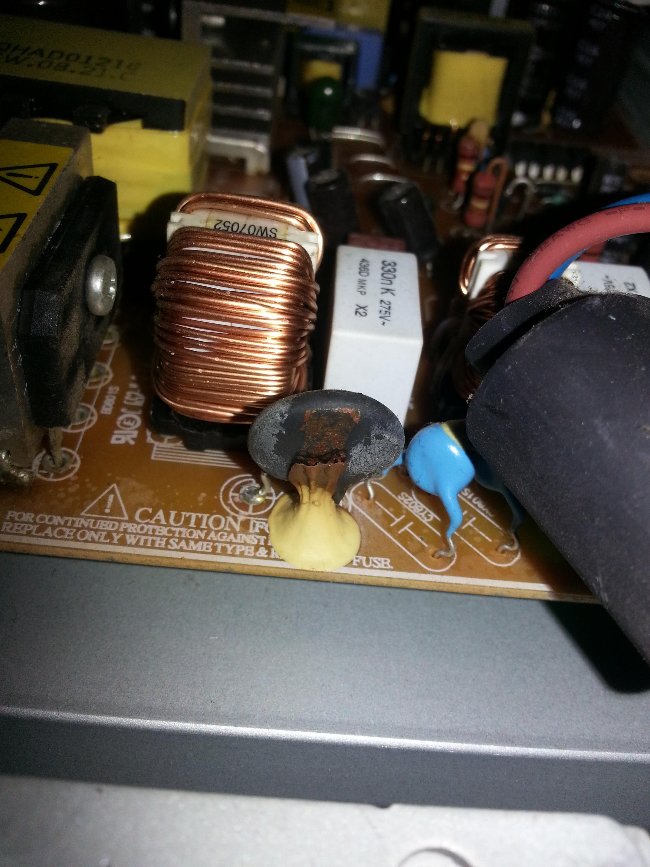

    Cracked glue?
    Power board showing number BN44-00192B - bottom right: ticks show recently replaced 10v->25v caps

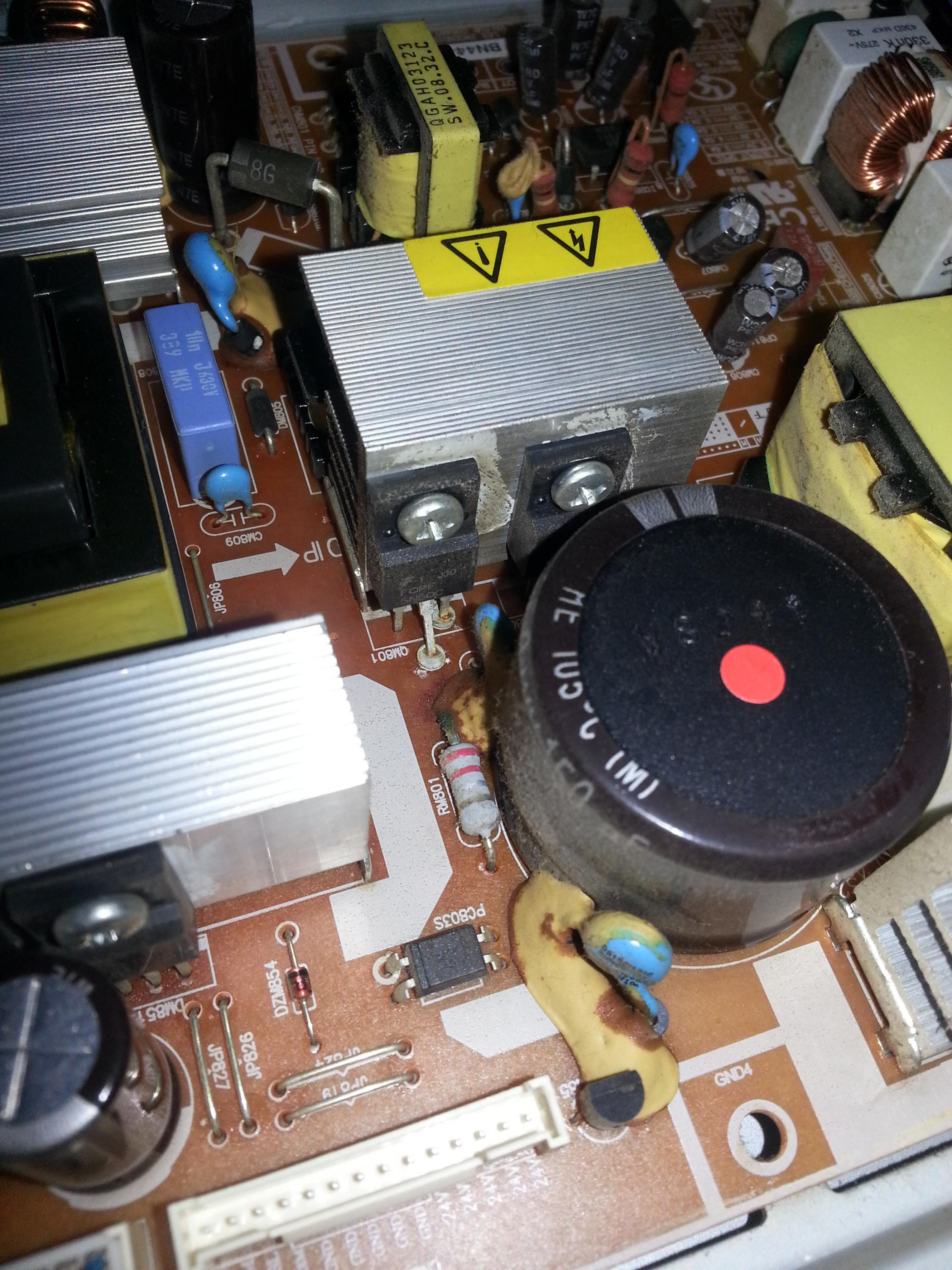

    More manky glue

      Ther is no pint in suggesting anything else until you remove all the glue. It has become conductive in places and will get worse.
      It is not easy you have to work away at it slowly ,obviuosly without damaging the board/components - some people have reported it soften (only slightly) with repeated coats of IPA

        Sorry about the huge thread - how do I get someone to delete it, report it? Was reluctant to use that as it says it's not for that purpose.
        That is fine, I will remove the glue next then and report back. I take it when the glue has 'gone conductive', it can be identified by the discolouration - like near the main capacitor in my photos? Like I say it's a learning process for me so I want to arm myself with as many facts as poss.
        Thank you Selldoor, I will catch you soon

          When its gone conductive it will be brown but it is also corrosive so it corrodes first then
          becomes conductive it really is awful stuff - you cant always see the brown if it under a blob of it. Budm has a whole set of pictures of it.
