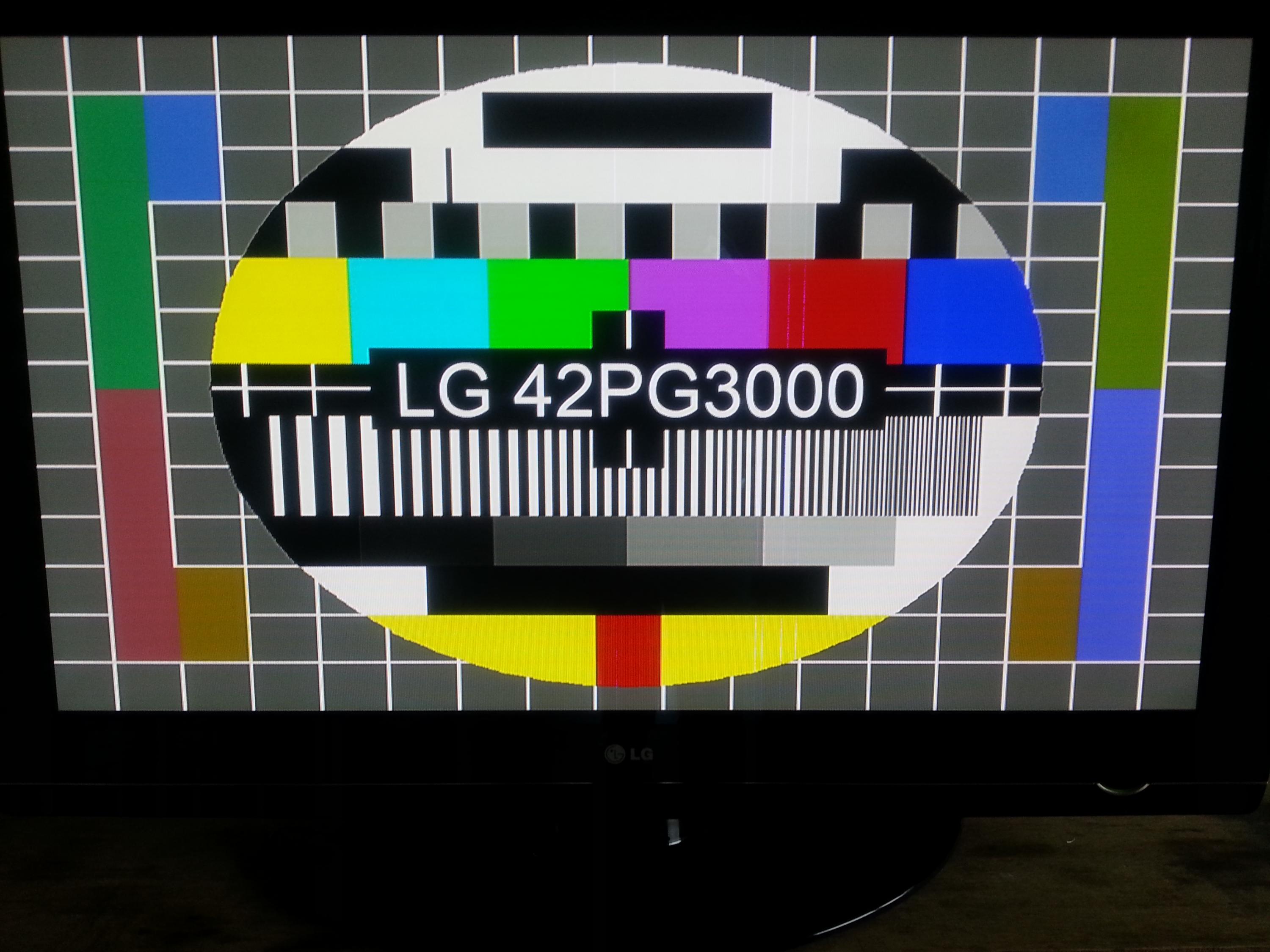

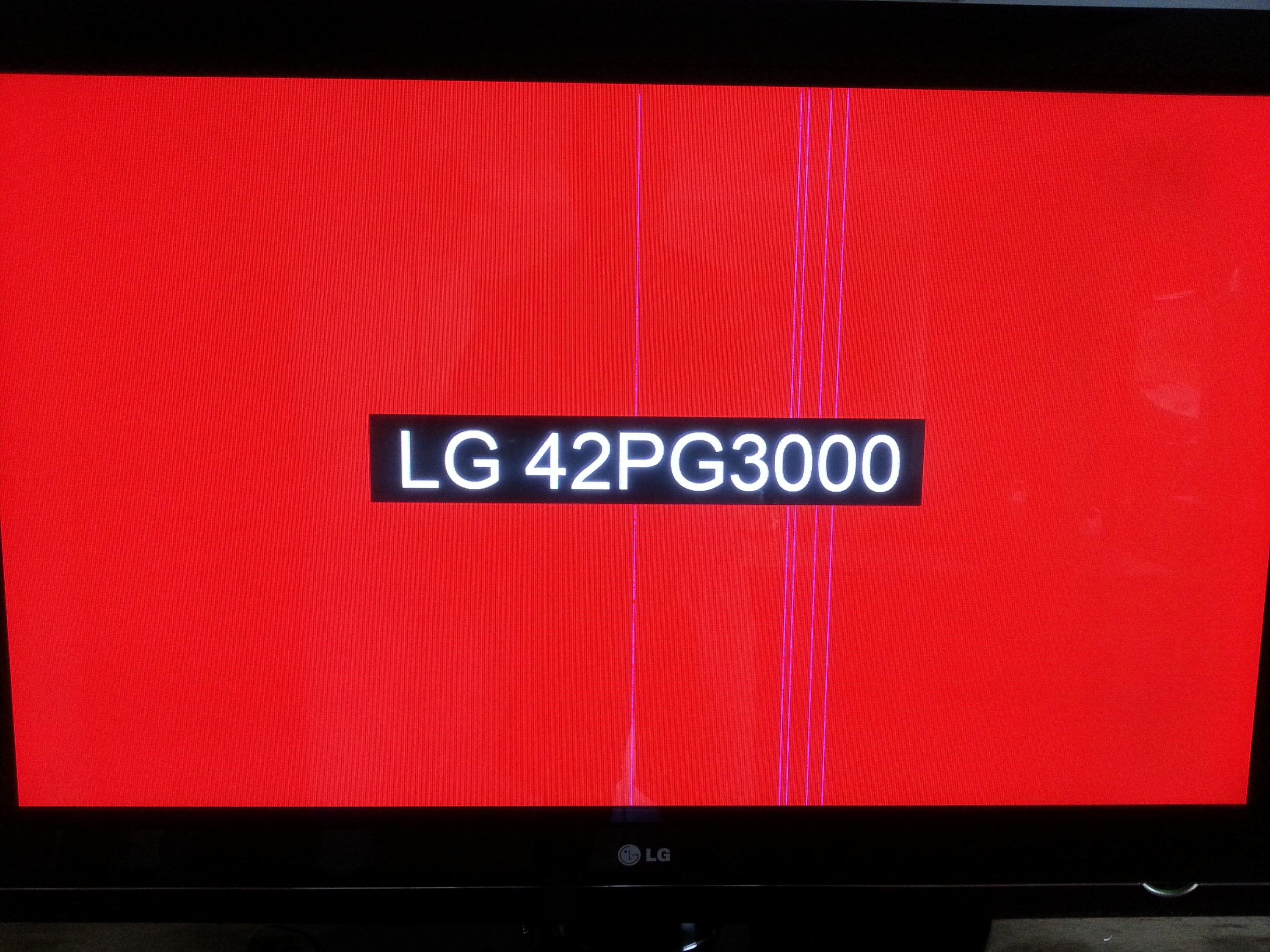

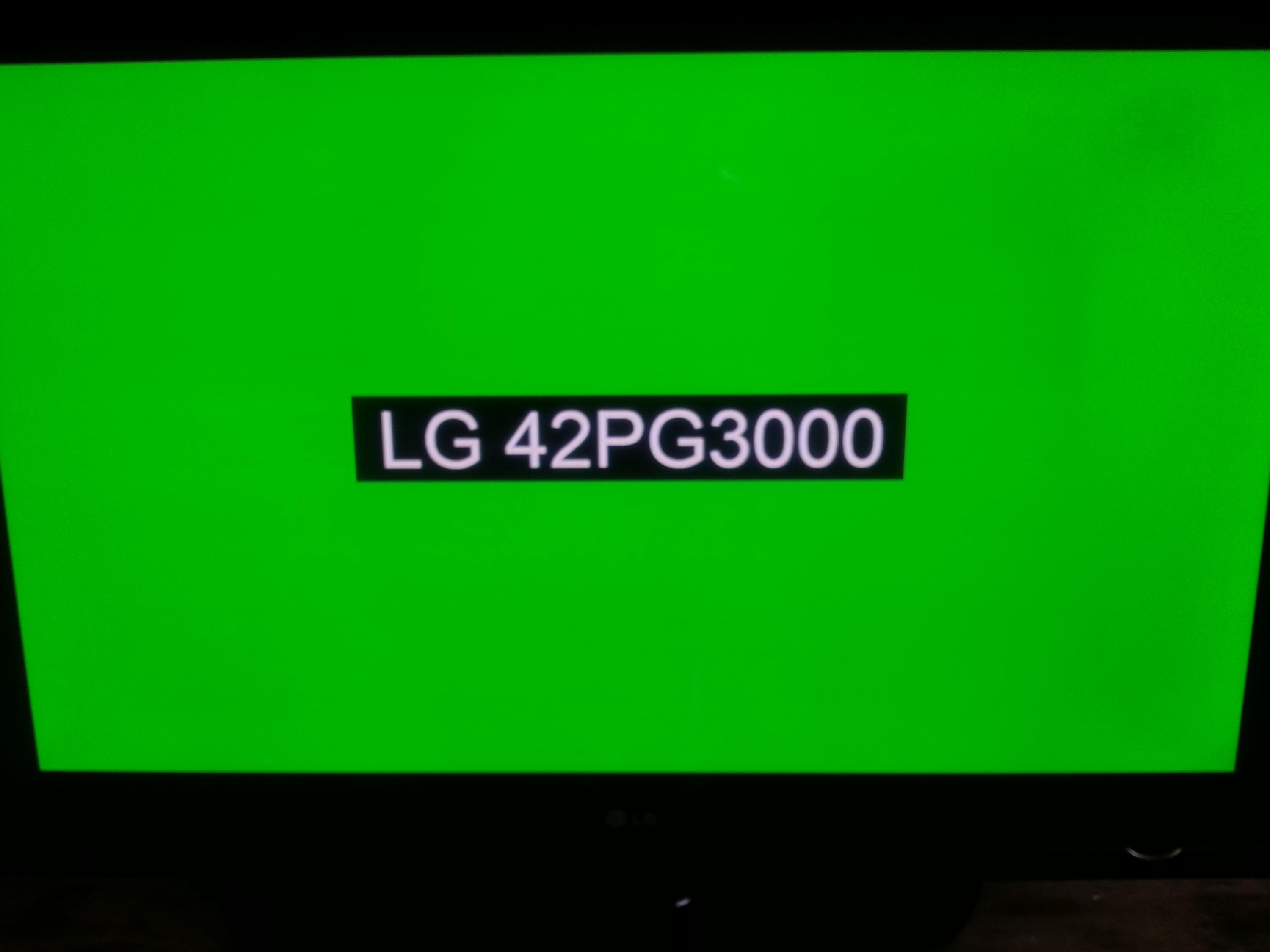

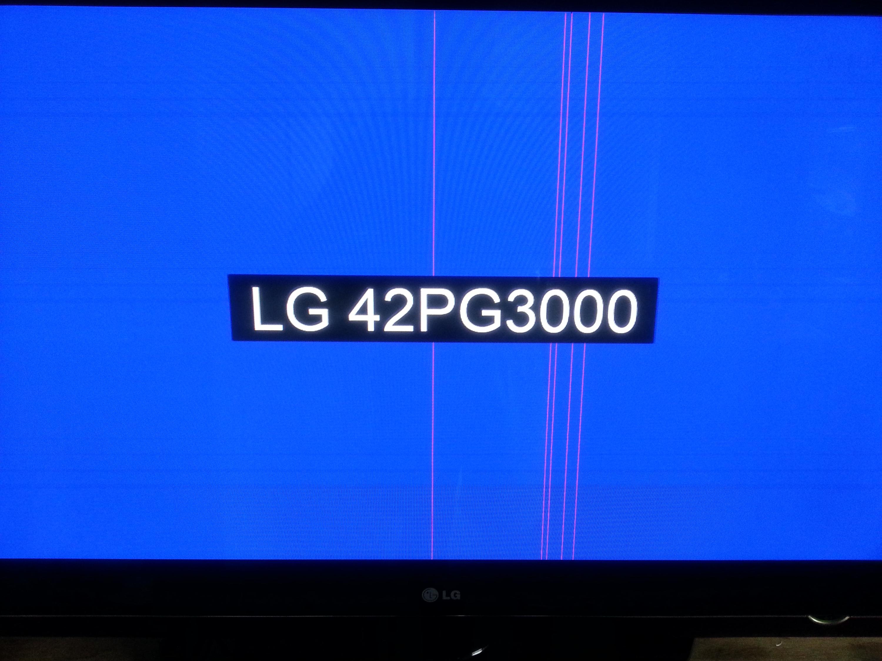

          First, this is my first post on this forum...
          I have exactly the same problem as Mikeyboy2007.
          After repairing the PSU for capacitors (C232, C233, C234, C235, C236 & C241); the tv starts without problem but I have 5 vertical lines on the full height of the image.
          I used a software (http://www.webalice.it/fulvio.cornetta/) to generate signals for tv and we can see that the lines do not appear if the image is green or red (see photos ).
          Is this problem also a faulty plasma screen?
          Thank you for your help.
