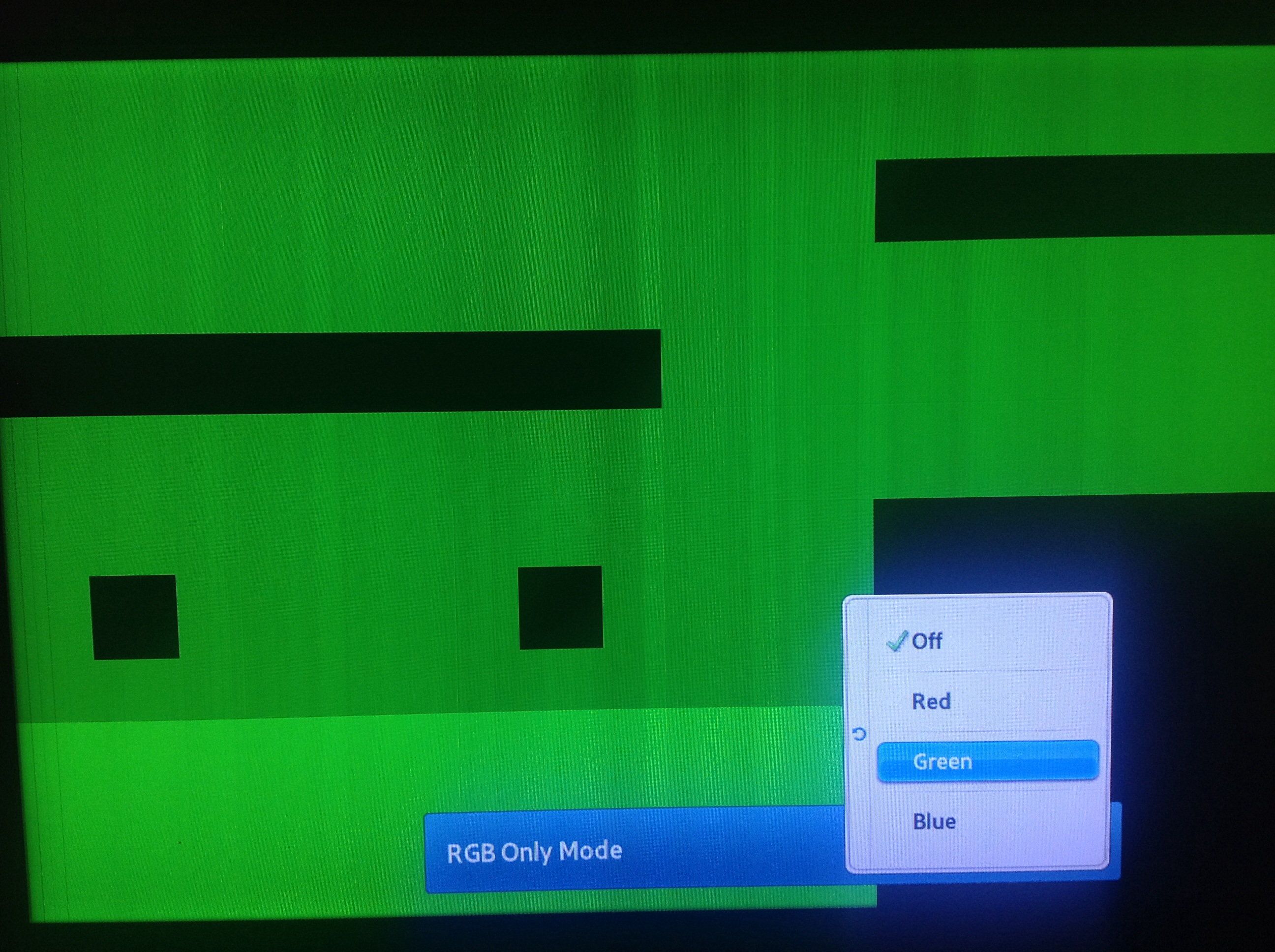

    Hi guys, hoping someone might help me diagnose a fault with my tv. I'll try to include as much detail as possible.
    The set is a Samsung UE46D7000 46" 3D LED, about 30 months old. Recently started getting thin vertical lines which appear to be on top of the picture. On a busy screen they're not really noticeable but on solid colours they are very prominent. For some reason if you turn the colour down to zero they completely disappear.
    Up to now I have:
    1. Disconnected and reseated all cable connections - no change.
    2. Replaced main board - no change.
    3. Replaced TCON board - no change.
    Hopefully I have attached some pictures below to illustrate the problem. Thank you for your assistance.
    Sorry, won't let me add more than one picture.
    Re: Samsung UE46D7000 vertical lines on top of picture
    It looks like a bad LCD panel to me, which would make the TV scrap. This is a very common fault on Samsung D series TVs, particularly 40/46 inch panels. Sorry there is probably nothing you can do.
      That's what I expected to hear unfortunately but thanks for your advice, damn thing cost me £1800 when it was new.
                      Tom66: what do you make of this mate, just ran the built in test pics on the Napoli and Genoa chips using the engineers service menu and the lines aren't there, perfect picture, go back to normal tv and lines are back again on any input - Sky, Freeview, XBox.
                        Uh... well, that's odd. You changed the T-con though... so it could be unfortunate bad luck with getting a second T-con that was bad. Sometimes the patterns can hide the fault. On the normal TV screen, can you see if turning off Motion Enhancer makes any difference?
