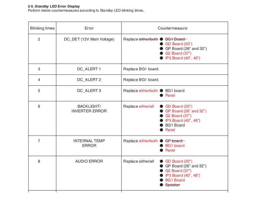

    Hi, i have a this tv broken a few years ago and i am trying to fix it if its possible and easy to do it.
    When i turn it on it blinks eight times and i already plug off all the audio that plug in. So may i know what the problem is and how to fix it. Thank you.
  • meziey80
    • Jul 2014
    • 2
    • malaysia
    Re: Sony Bravia Tv 32 inch KLV 32V400A
    i do have same problem, same model, its blink 8 times, still searching forum for solution.
    problem coz by audio, maybe hdmi ic
      Check this?
      Regards
