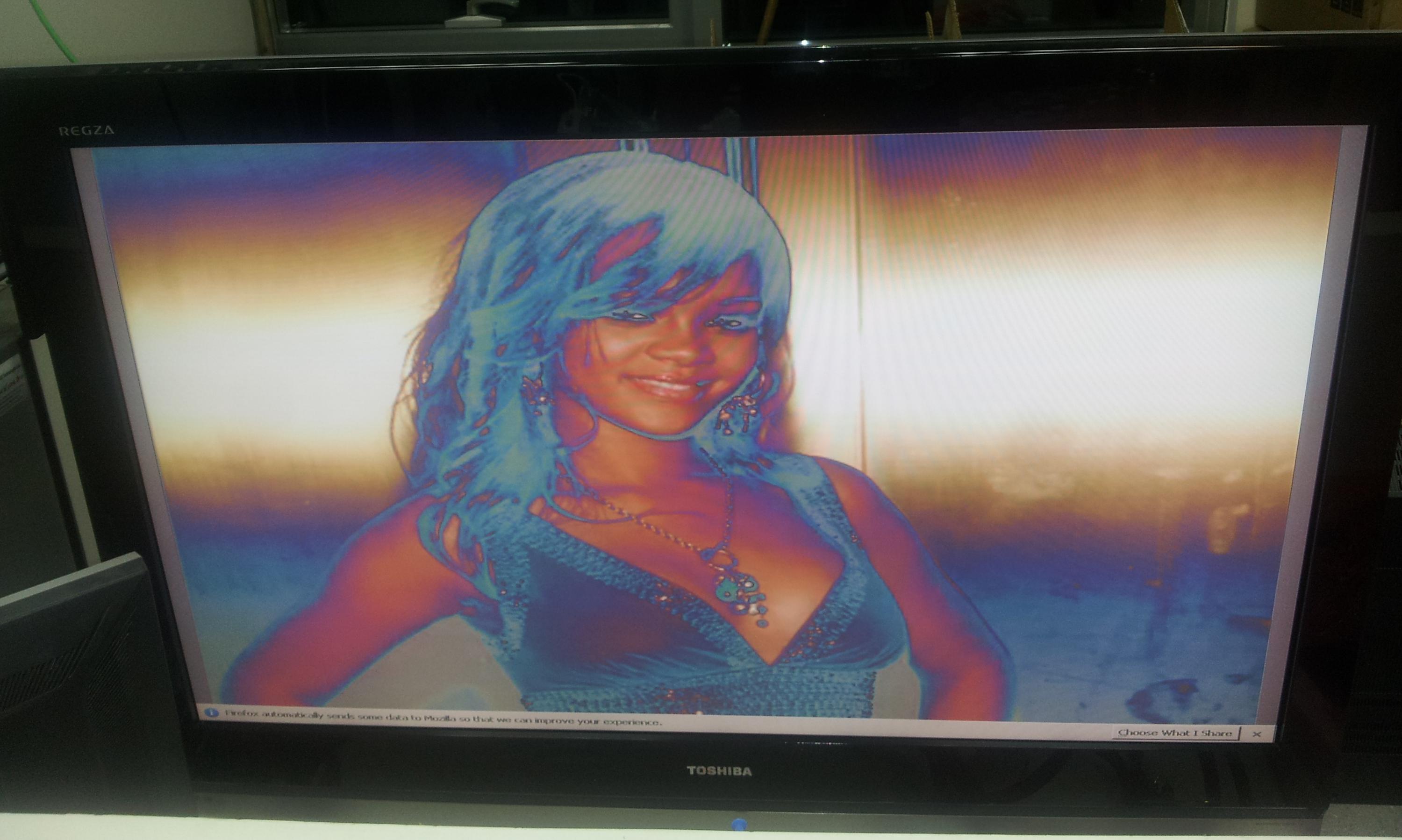

    Please see attached pics.
    I'm trying to fix this set but don't know which part is responsible for displaying the correct colors.
    Can you please guide me where to look.
    Tried the A/V , Scart , VGA inputs so far - they all show the same distorted colors.
    Will try HDMI tomorrow.

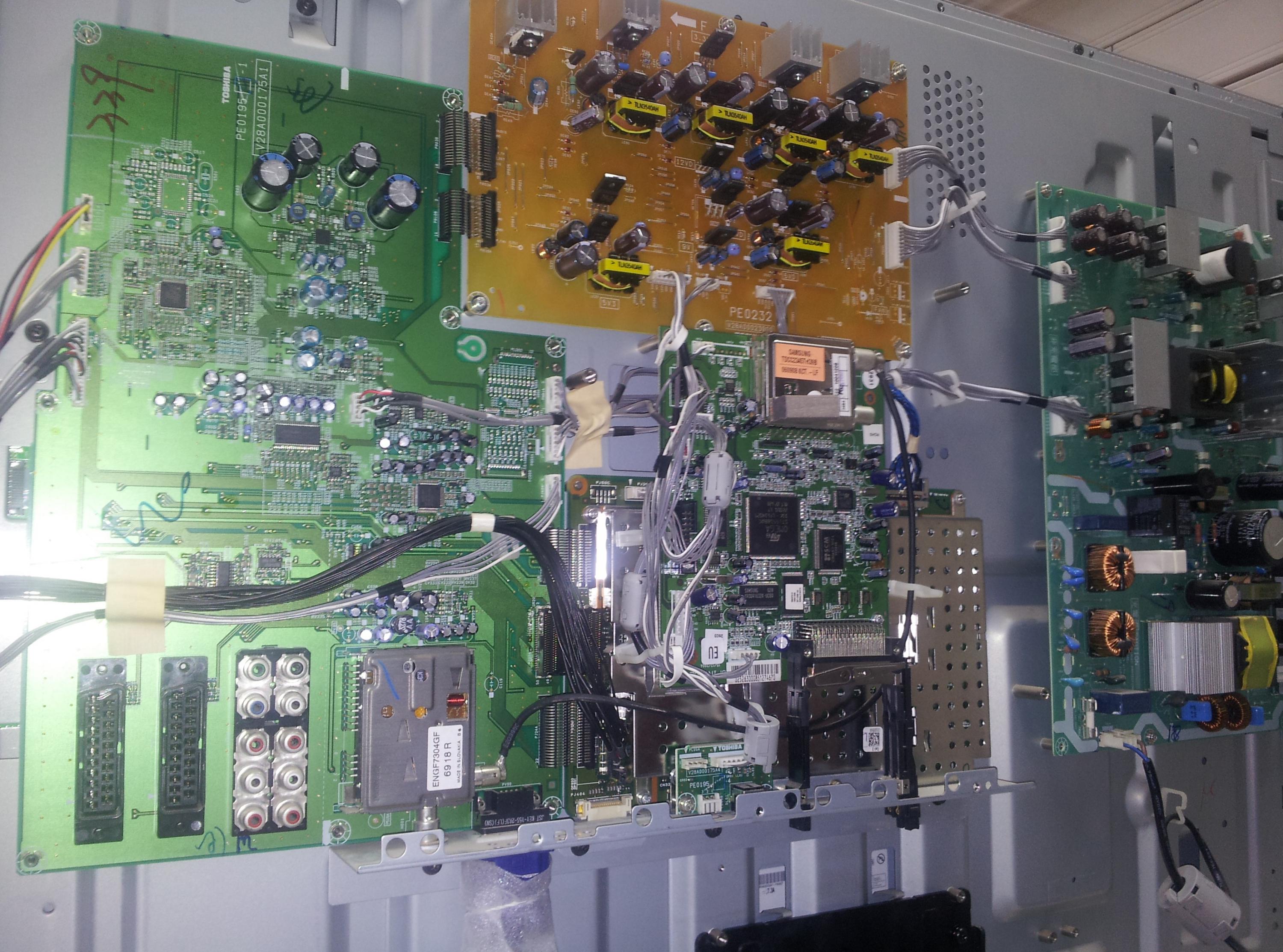

    You need to find the TCON Board - its usually buried.
    If you use the search above there is another thread for this set which has mention of
    a schematic that might help
      Re: Toshiba REGZA TV 42WLT68 - colors problem
      U6 AS15 Gamma IC.
      http://www.shopjimmy.com/auo-55-42t0...-con-board.htm

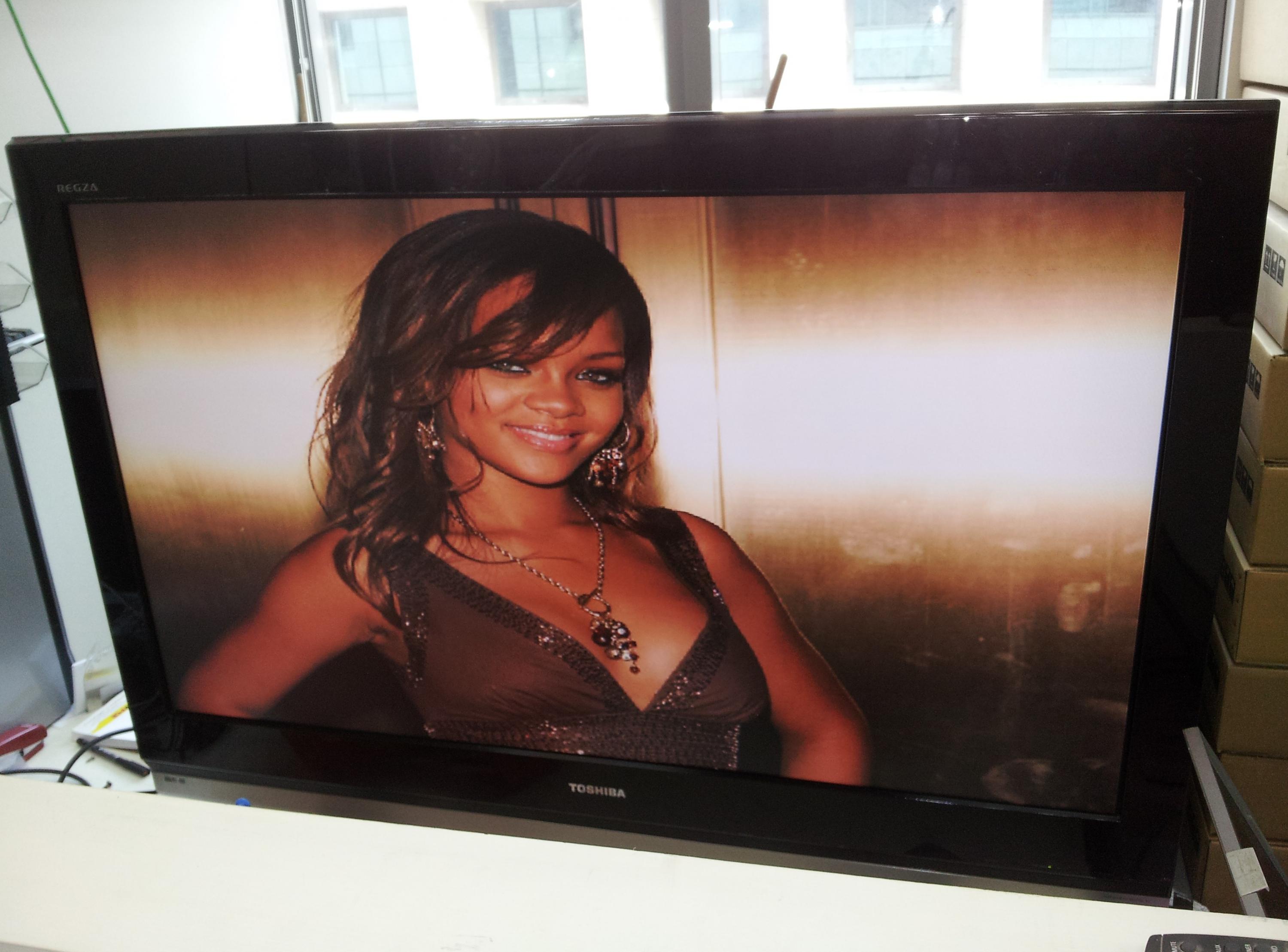

        Originally posted by budm
        Success !
        Replaced AS15-F Gamma IC on T-CON board (PN: T420XW01 / 06A39-1A) and now colors are back to life.
        Thanks very much budm, selldoor and BadCaps community.
        Cheers.
