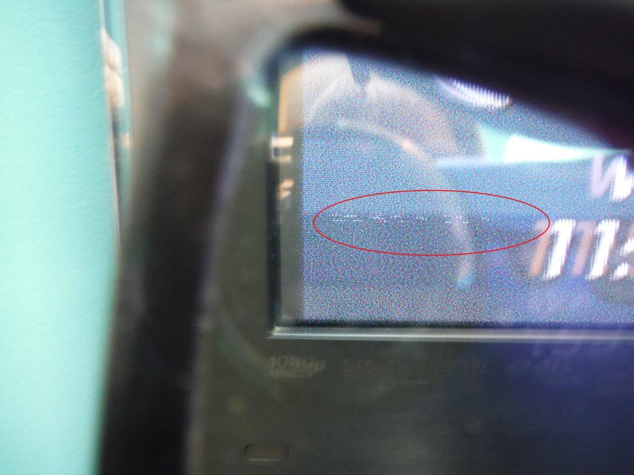

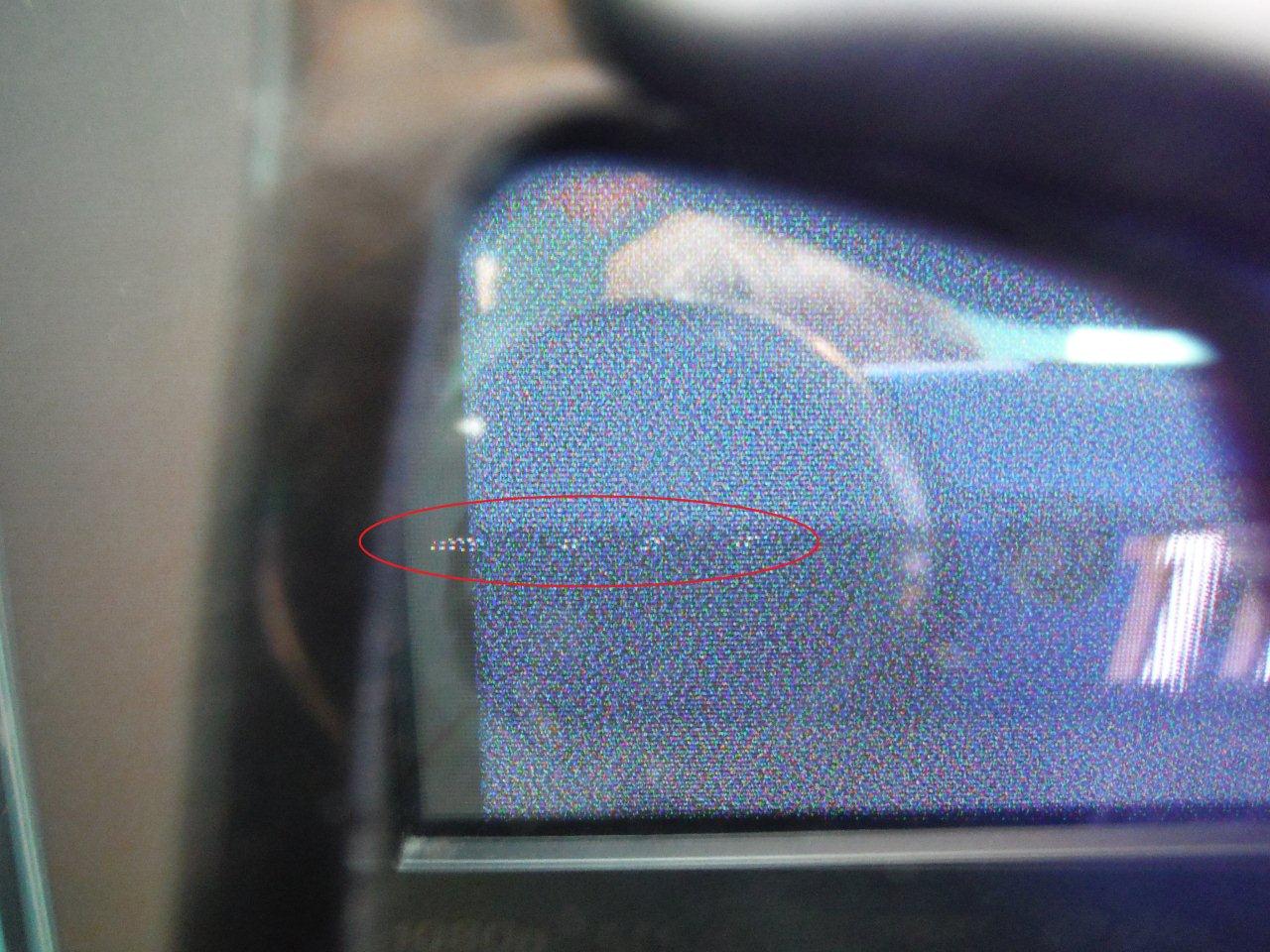

    I have a Samsung PN50C7000YF that I picked up that would hang during power up. Troubleshot to main (Jumper to check Logic board test patterns was OK). Sourced used one and now TV powers up fine and everything was looking good untill...I tried 3d. I'm getting random small horizontal "lines" of white dots out of ONLY the left eye in 3d mode. When watching 2d...or 3d with my left eye closed...the picture is perfect.
    I'm not too sure about the 3d architecture, but I'm assuming this can only be that I recieved a defective main...can anyone confirm what could cause a 3D picture issue in only one eye?

    Never mind....cleaned and reseated LVDS cable and all is good...did not think that would affect only one eye image...but aparently so.

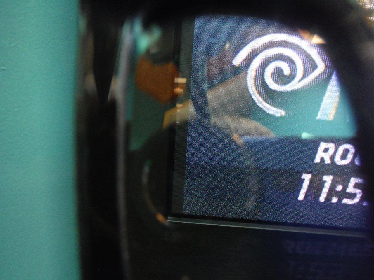

        pics attached...2 through left lens of 3d glasses...one through right.
