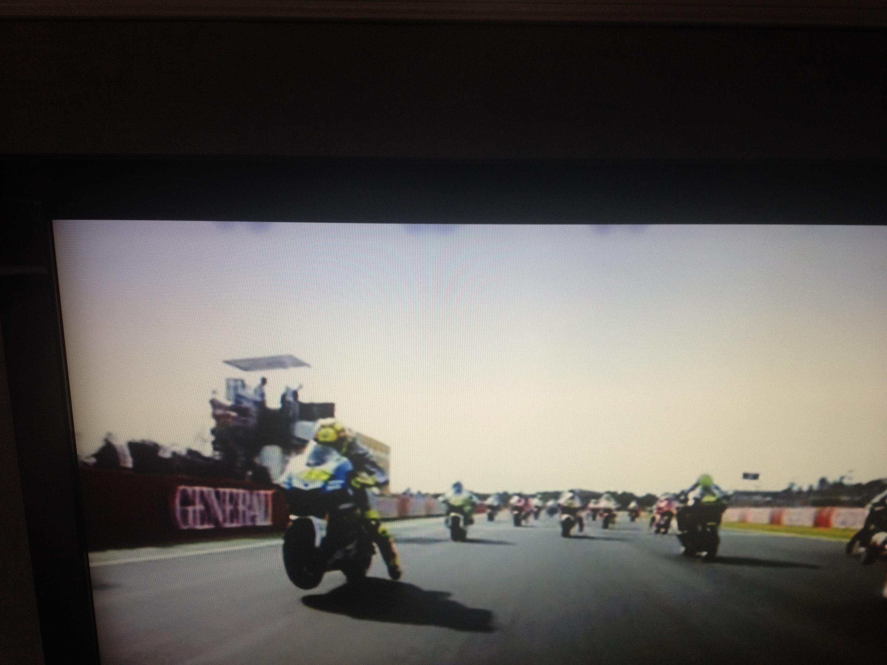

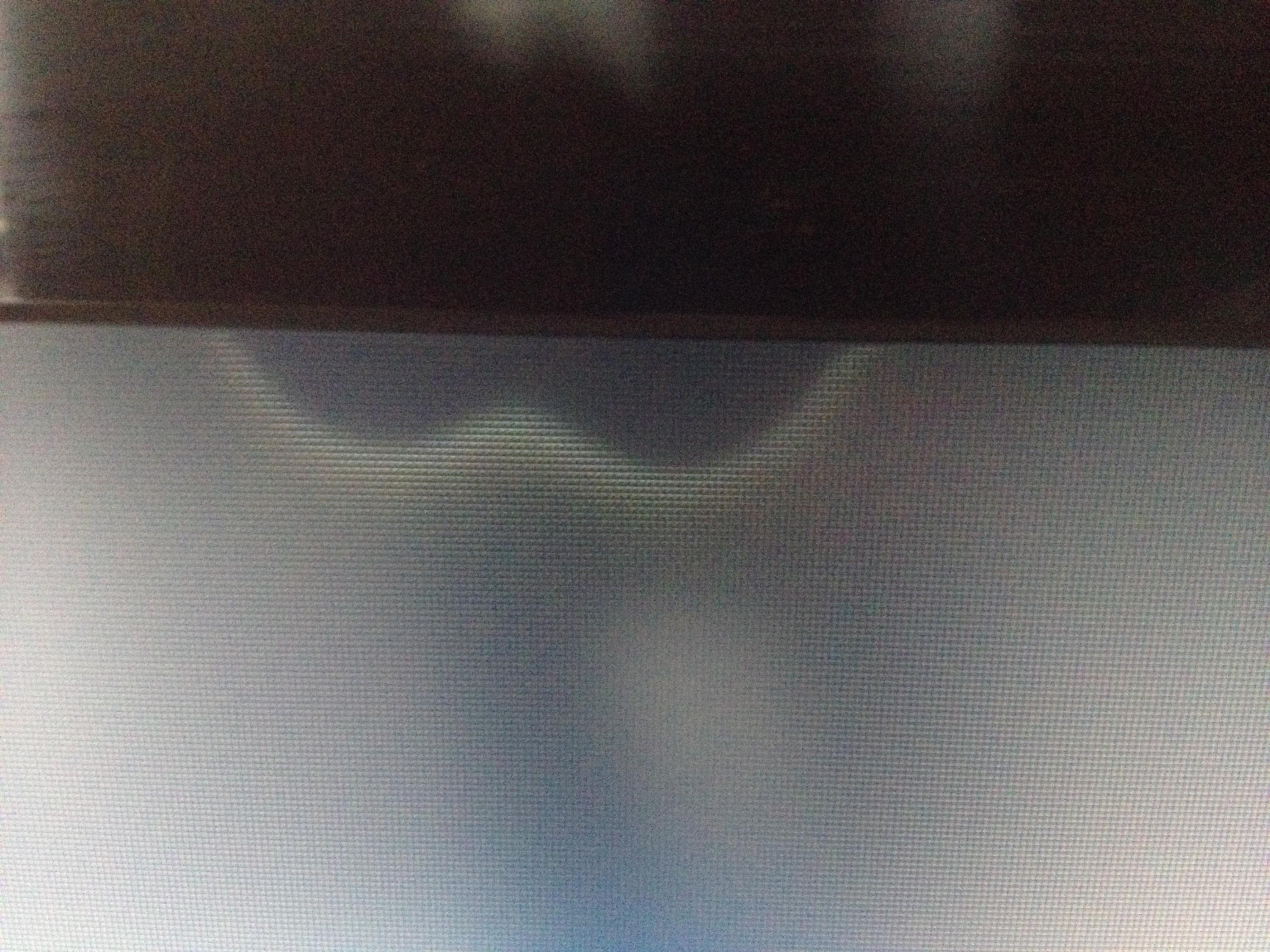

    take a look at the pics i have for this tv, it was fine 2 weeks ago,
    just got it out to test to sell it and this is what has come up on screen along the top,look like w
    5 marks, what do you think ?

    LG panel? Pretty common. Harmless effect of being too cold. Let it warm up for about an hour, and it won't happen till it gets very cold again (e.g. left in a shed or utility room.) At room temperature, they never seem to pop up again. Not sure what causes it, but always fades.

      Re: TECHWOOD 42inch LCD, blobs
      i have seen this before from a tv that was stored in a garage for 6 months, but never had any idea that would cause that prob.
      this one was stored in my spare room for 3 weeks, not turned on untill today, no where near cold in this weather,
      but it no longer matters, as buyer was very happy, and i gave him another £10 off the price.

        forgot to say
        yes the marks did seam to get lighter over the half hour i had it on.
