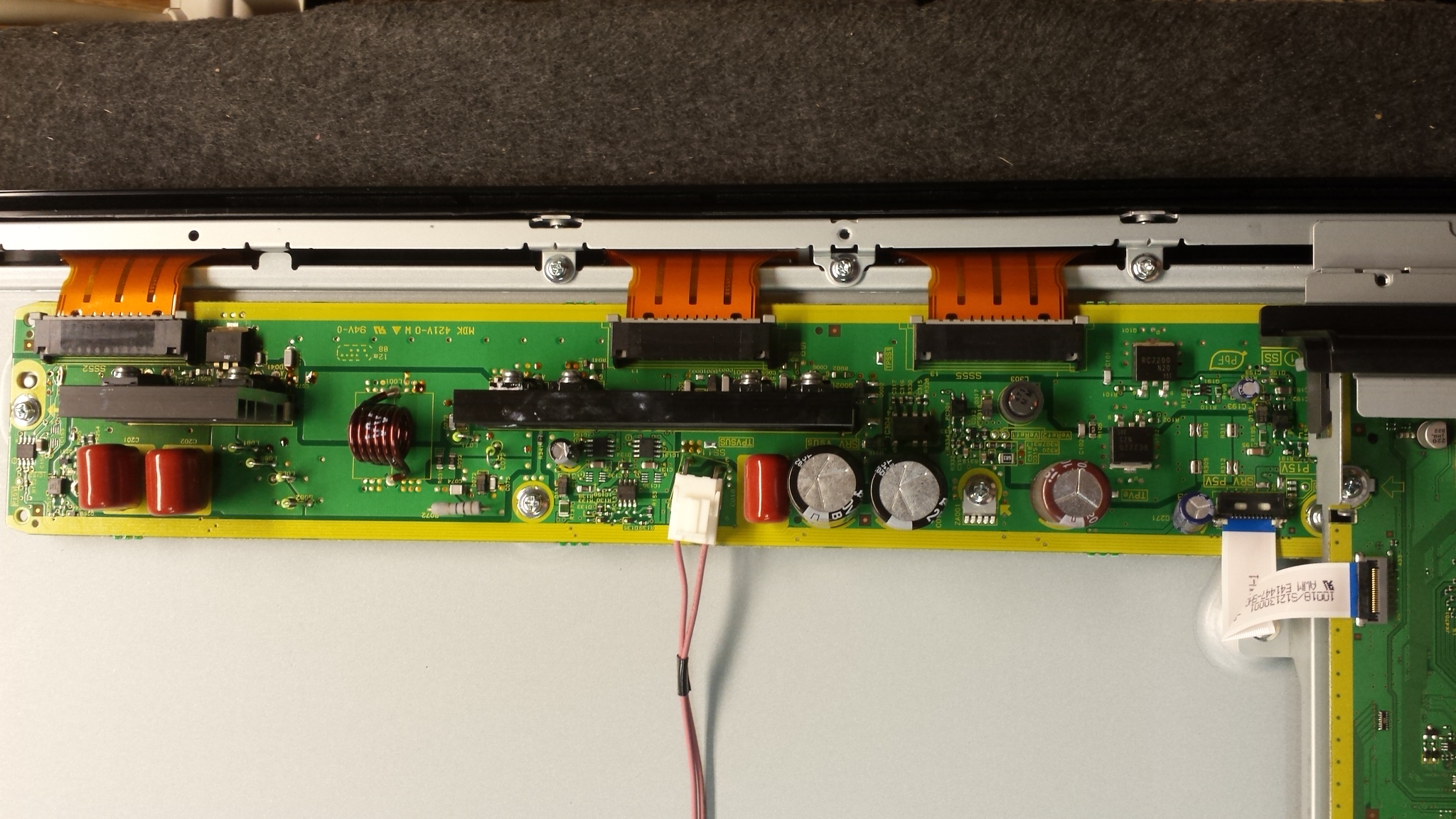

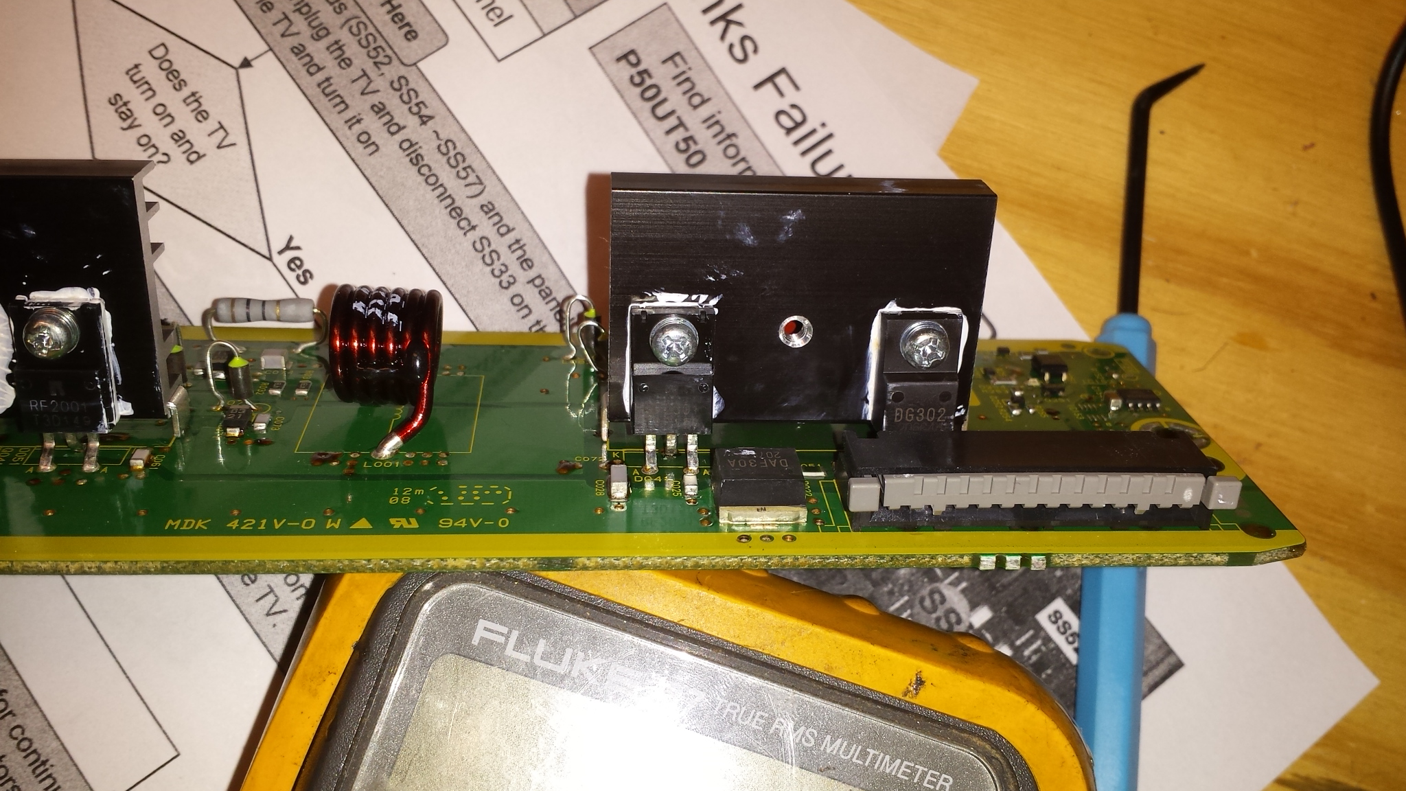

    Pan TC-50PU54 8 Blinks
    SS board RF2001 and DG302 were both shorted causing P.S.
    to shut down. Shop Jimmy has a repair kit but it does not list the bad parts. I hate to assume that the kit has the parts needed. I could not find a data sheet for getting one capable of higher voltage and currents. Someone listed a 5R6 ohm sad resistor but not the footprint size. And a BD8694152 eight pin
    I but could not find it either.

            I have repaired a few of these...The problem is loose screws to the chassis causing bad earthing....

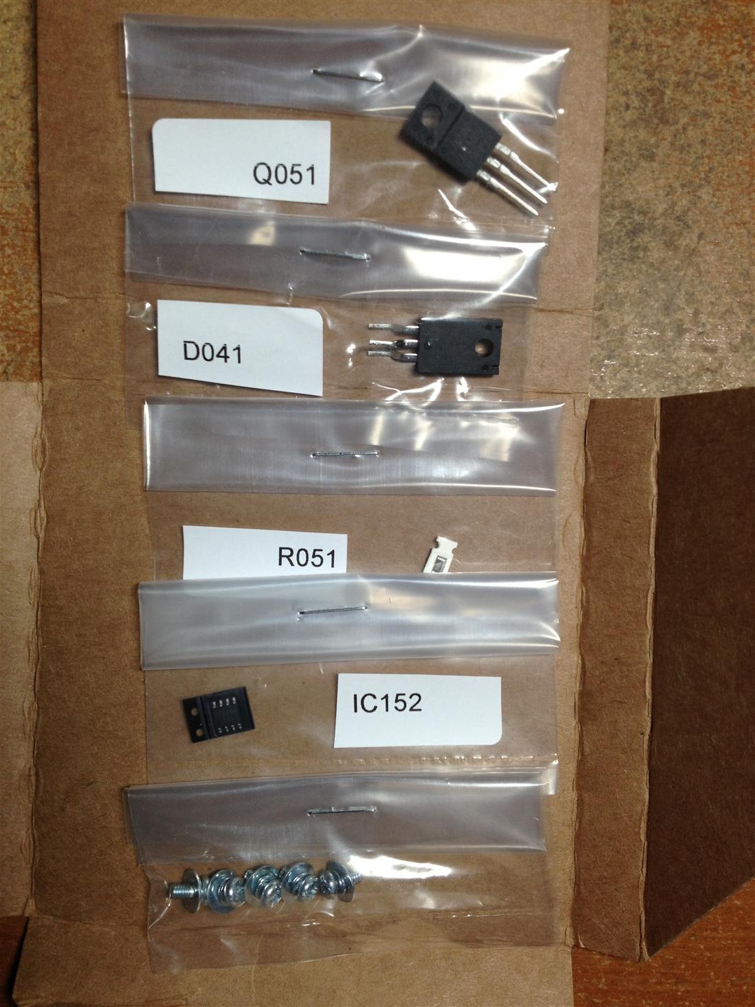

            Now,I have a shop jimmy kit right in front of me here
            TXNSS1SDUU repair kit
            In the kit are:
            Q051=DG302
            IC501=BD8694
            D041=RF2001
            R051=5R6
            Bag with the 5 screws that have washers on them...
            So far every board i did,it was these 4 components....

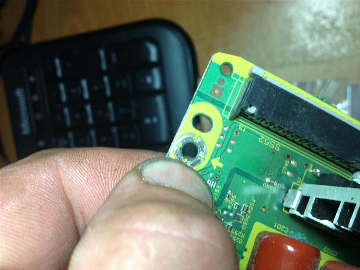

            You can see at the places where the screws are,that it has been bad contact(arching)...I always sand thse areas of a bit for a clean contact....
            Hope this helps

                So have you actually found that driver IC bad or just replacing because it's in the kit?
                Any chance you can post a picture of the kit contents for future reference including any documentation supplied?
                • martino
                  Not so "senior"
                  • Aug 2013
                  • 997
                  • canada
                  Re: Pan TC-50PU54 8 Blinks
                  First one I did,I tried to skip the IC(being lazy) and it told me really fast that YES,I needed to replace the IC as well...
                  The once I did after I just replaced all 4 parts blindly....(A been there,done that thing I guess)
                  I will take a picture of it tomorrow,not much to it,4 parts,each in their own little bag labeled as where they go and a single piece of paper showing what each part is...

                        pics as promised...I seem to have lost the piece of paper that was in it,but like I said,no info or "how to" on it....
                        Pic#3 shows the bad connection you need to clean up before installing new screws,I sand them off a bit myself...
