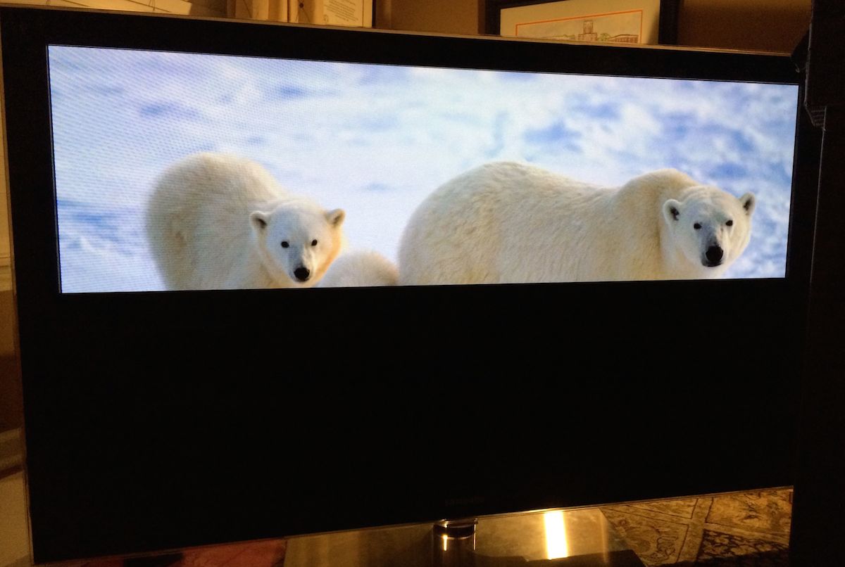

    The video on my 58" Samsung plasma stopped working a couple weeks ago. When powering on, it would click a few times like normal, but the screen would never power on. The screen does not glow, but there is audio.

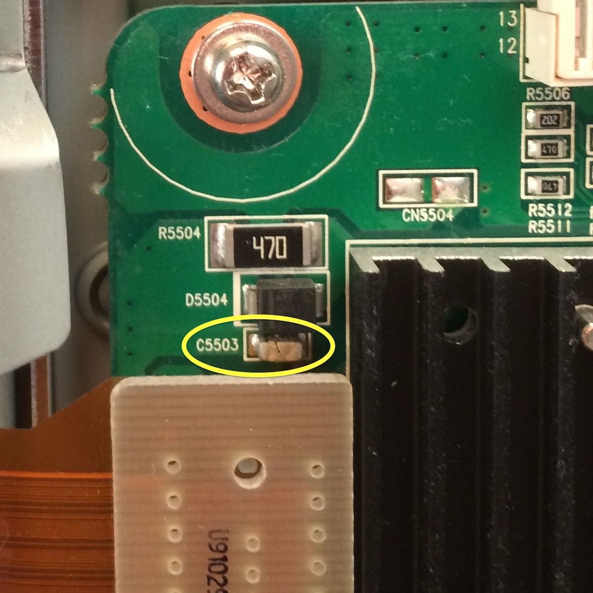

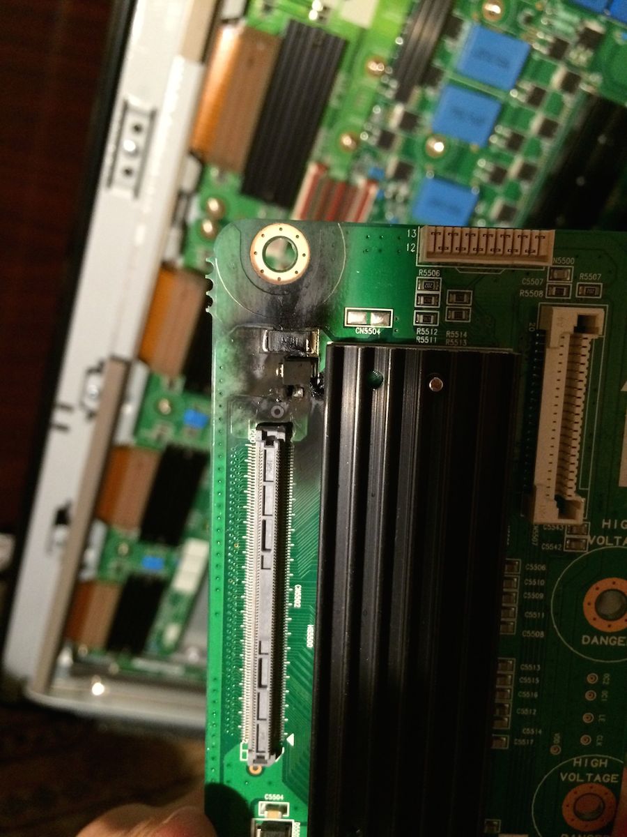

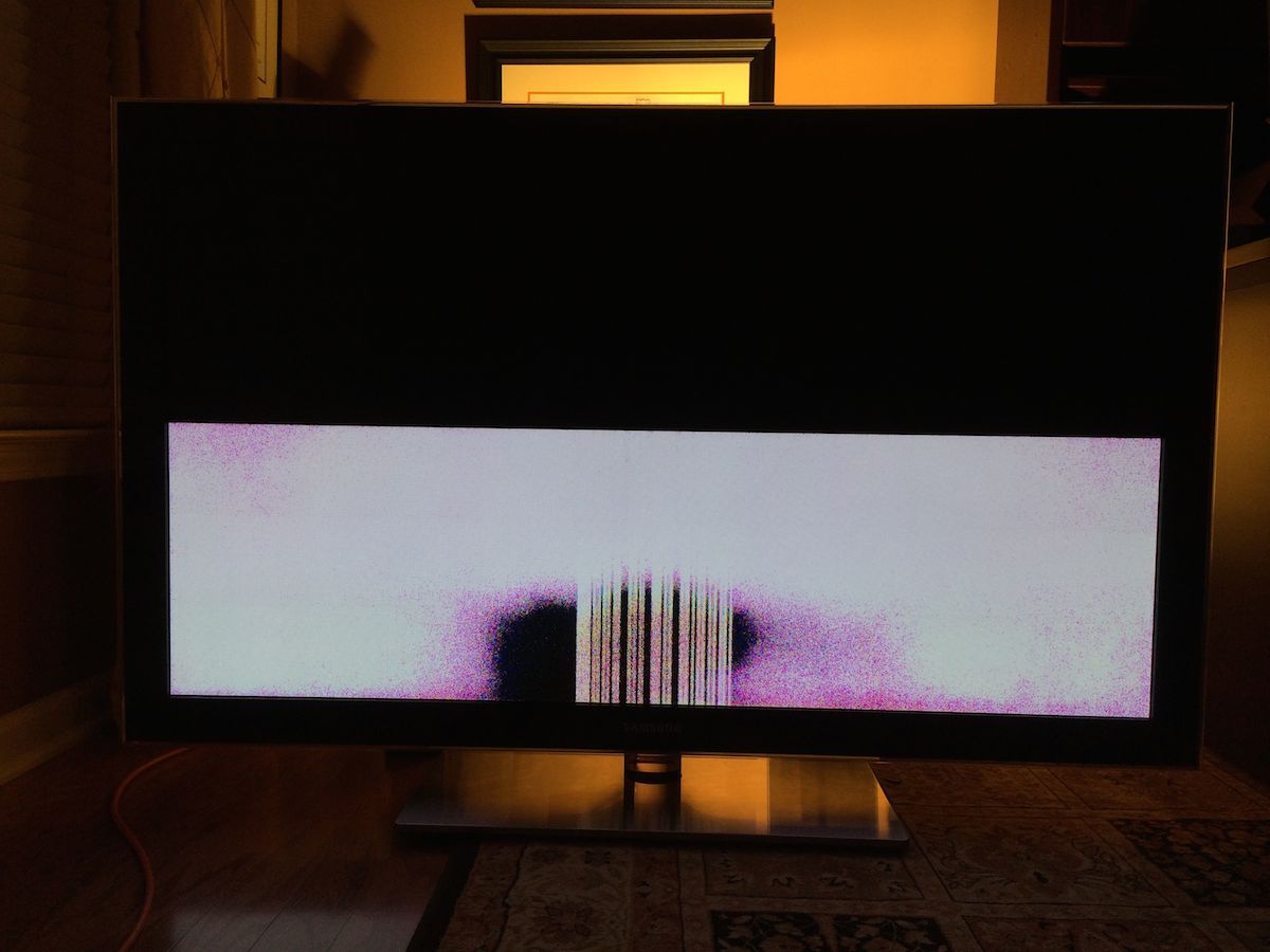

    I opened it up and noticed that an arc would occur a few seconds after powering up - on what I think is a surface mount capacitor (attached image) on the lower Y buffer. I disconnected the lower buffer and powered on the TV and the upper half of the screen came on. I tried the same test with the lower buffer and the bottom half of the screen came on, but it wasn't clean. After a couple power on/off cycles, the capacitor started smoking and the lower half won't come on anymore.
    After reading that buffer/y main boards should be replaced together, I ordered both buffers and the y main board and installed all three. Upon powering up with all boards connected, I still have audio but no video. I can get the upper half of the screen to come on though. Here is my current situation:

    I've attached pics of the original lower buffer before/after burning up. You can see a small crack in the capacitor C5503 that was arcing on power up. The picture of the lower screen was taken prior to the capacitor burning up. I can only get the upper half to come on now.

    Maybe clean up the board and remove the shorted ic and try running it with one ribbon plugged in at a time ?

      It is fairly common on plasmas that you can only get 1/2 a pic with one of the buffers installed - in fact I only know of a few Panasonic models which will give you 1/2 pic in both cases.
      Did the failed resistor occur in the same area as the outputs tested bad? For example did you only get shorts on the top most ribbon. That could indicate a panel short although that would be bad luck because AFAIK, there are no reports of panels killing buffers on these sets...

        There were shorts on the top and middle outposts. The burned out resistor is above the top outpost, right next to it. I have another lower buffer being shipped today. I'll test it before installing it.
        So that surface mount component is a resistor and not a capacitor? I was thinking that the R,D,C prefixes were for resistor, diode, capacitor.
