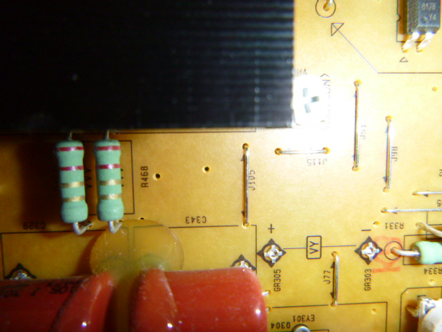

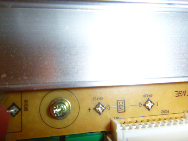

    These contact points with these labels were all could find. didn't recognize a specific resistor for either.
    I tested those contact points and the voltage for both were jumping 13v down to 1.4v

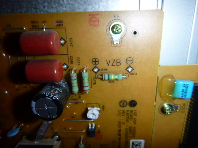

      I also found the VZB points on the Zsus. is that the resistor under the markings?
        Re: Lg 3d plasma 60pz550 i've got sound but no picture
        Ah OK so this set does not use resistors, that is fine.
        Since the voltages are jumping, please try pulling the Y-buffer boards out from the Y-sustain. You will need to unscrew them then pull them back slightly. The orange ribbons hooking them to the panel can stay.
        Then see if the voltages stabilise.
