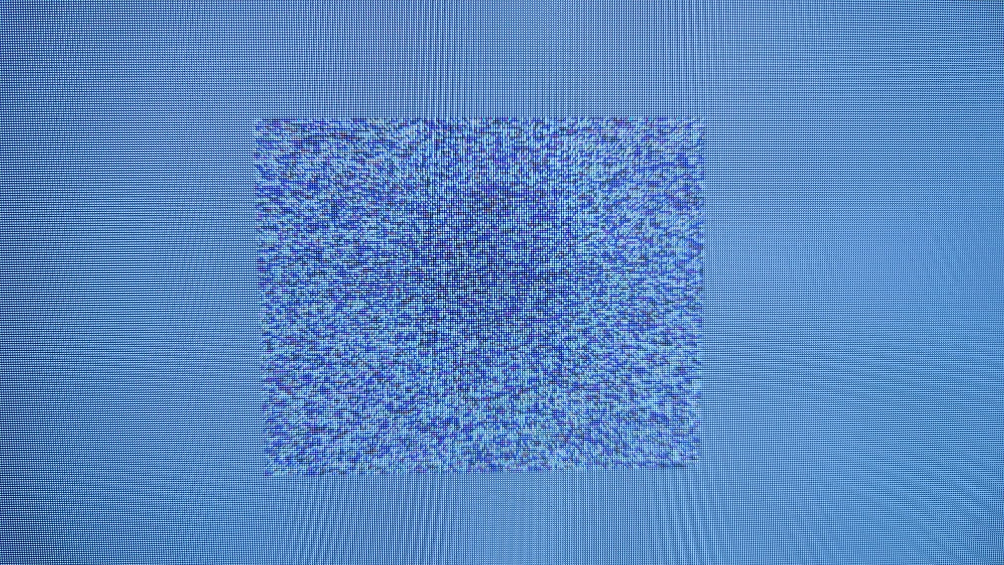

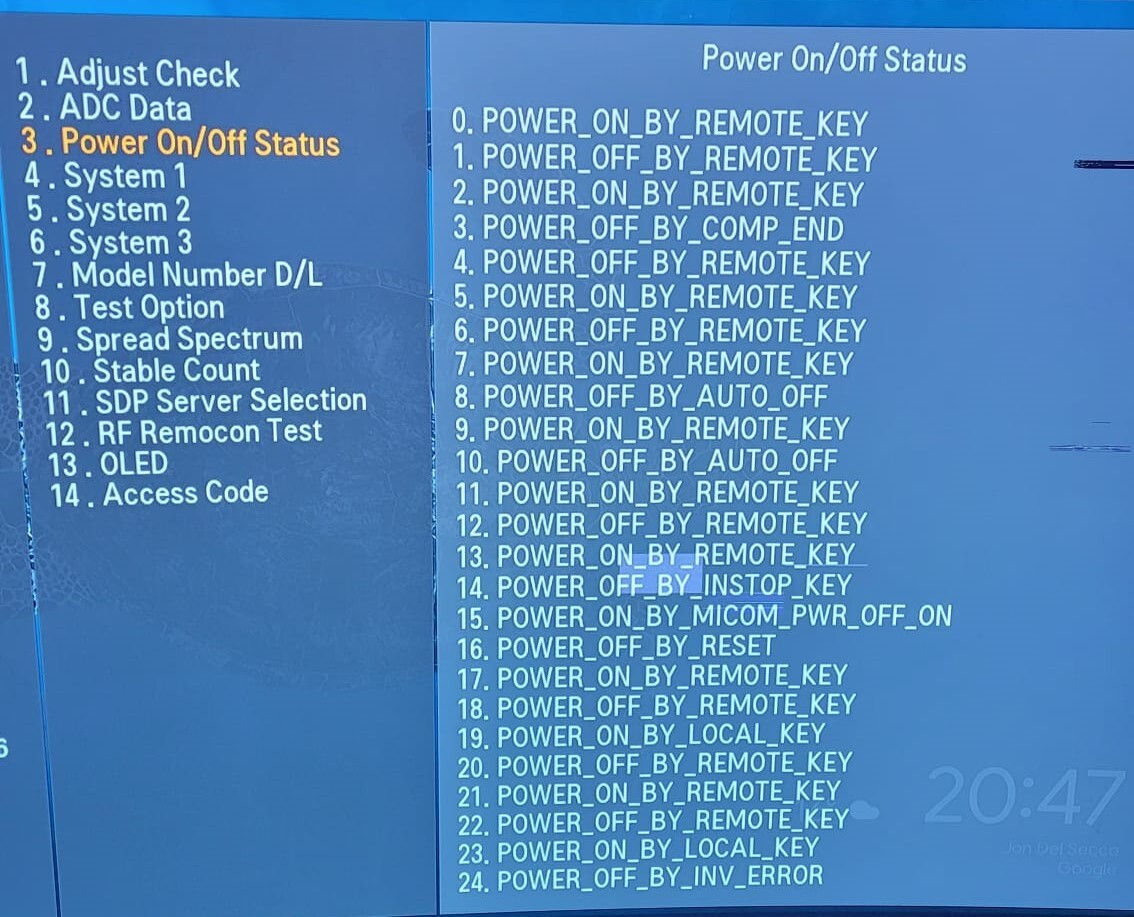

LG 55EG960V artifact
  • Bobby B
    • Apr 2025
    • 15
    • france

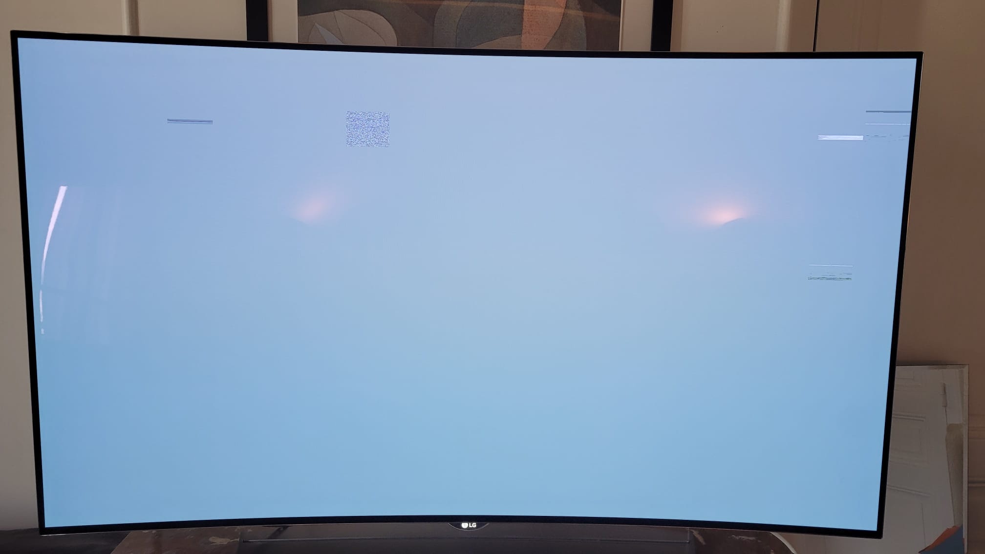

    Someone gave me that old TV, with few artifacts on the far sides and I didn't mind. However the places of the artifacts are changing when I turn the TV on and off.
    Any chance this could be fixable?
  • Diah
    • Feb 2013
    • 6532
    this is pixel refresh issue
    1- reset after cleaning 2 LVDS and ribbon cables from both side., ( DONT SWAP ribbon cables places or direction )
    2- send with service remote IN_STOP
    • Bobby B
      • Apr 2025
      • 15
      • france
      Thank you very much for your suggestions
      I tried both but they didn't work. I have a new patern that appeared (before I tried anything, so it's not my fault 😅 )
      If you have any other idea, I would be very grateful 😃

      • Diah
        • Feb 2013
        • 6532

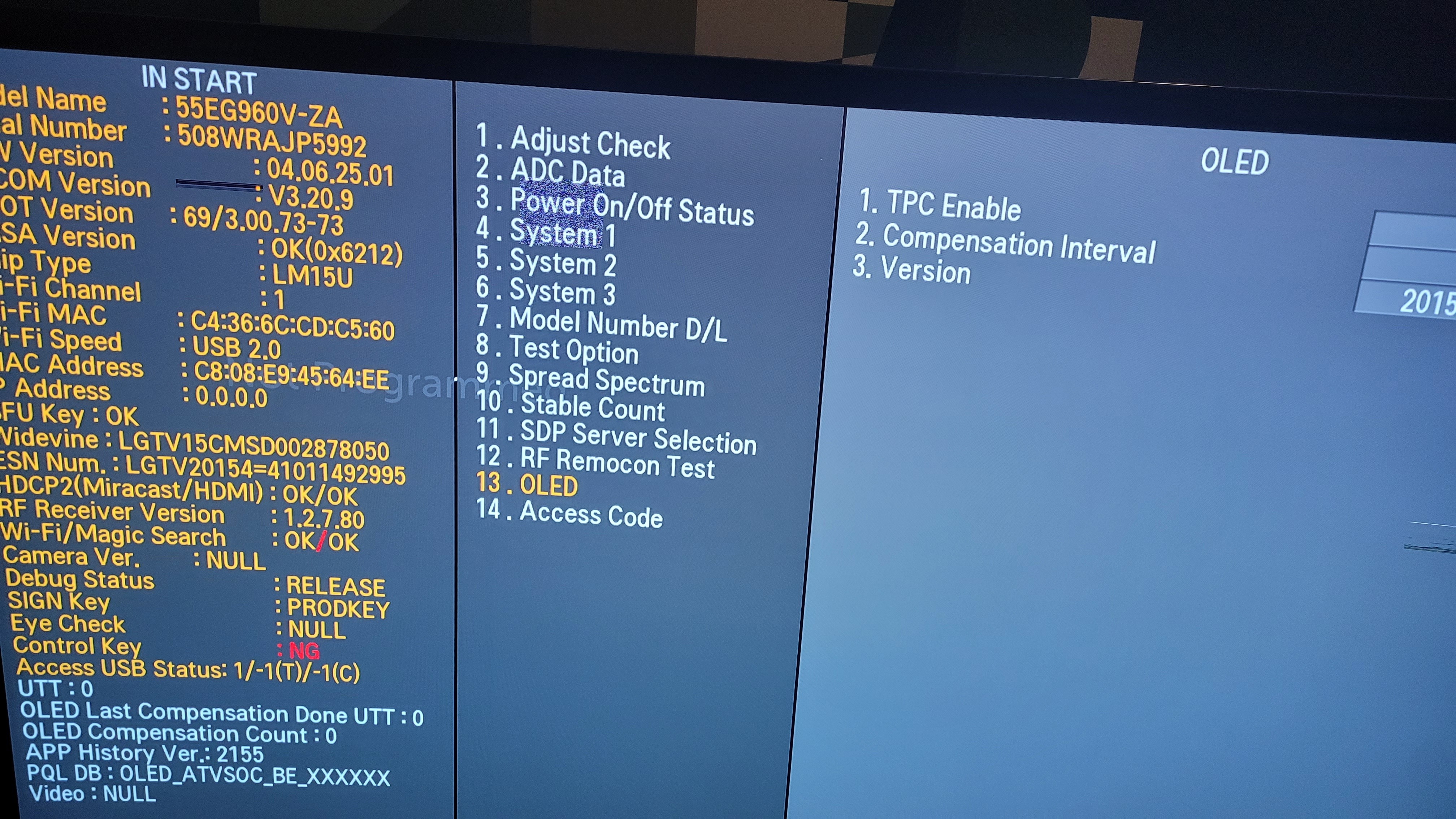

        send IN_START menu then go to OLED option post photo of yours screen keys

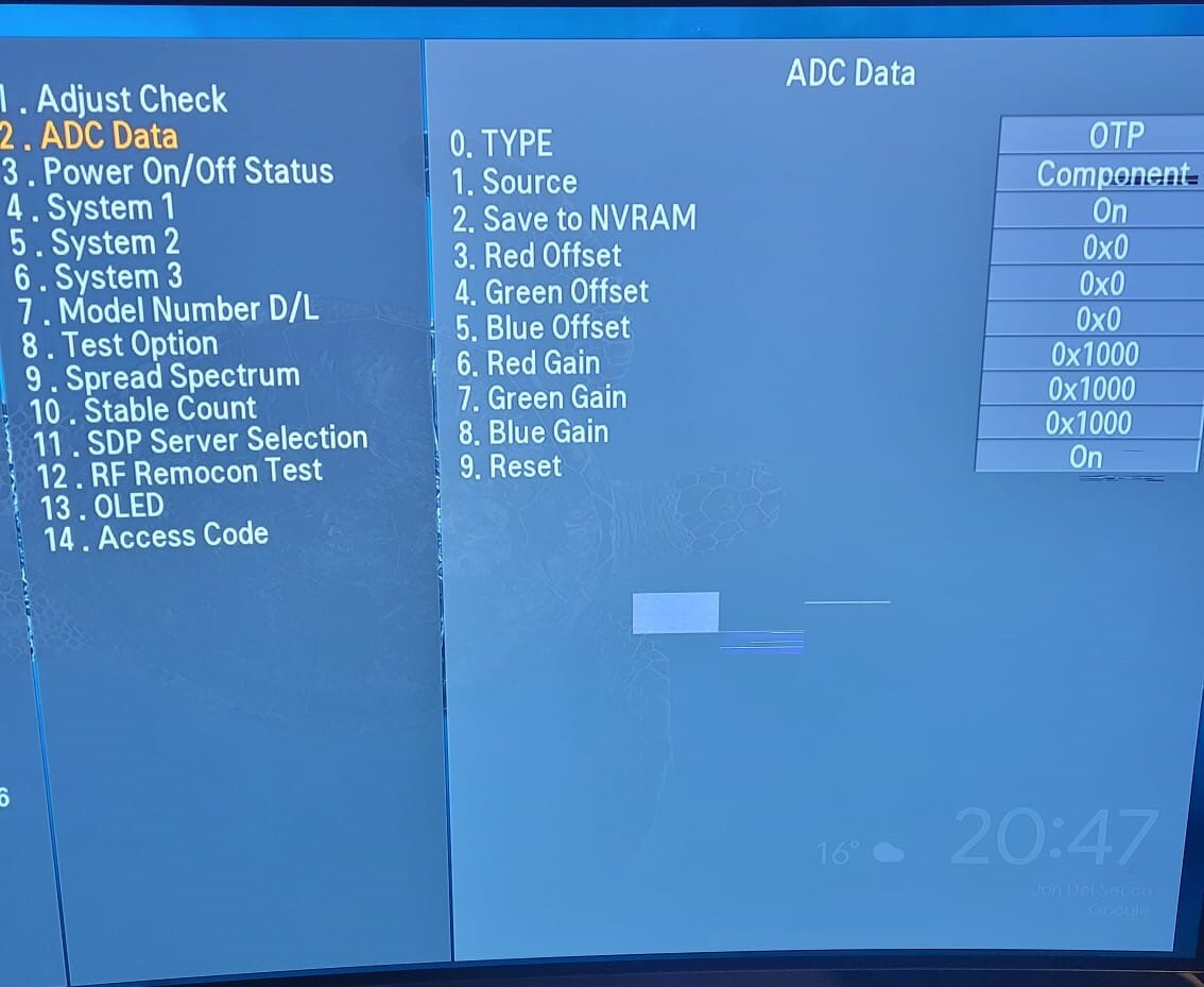

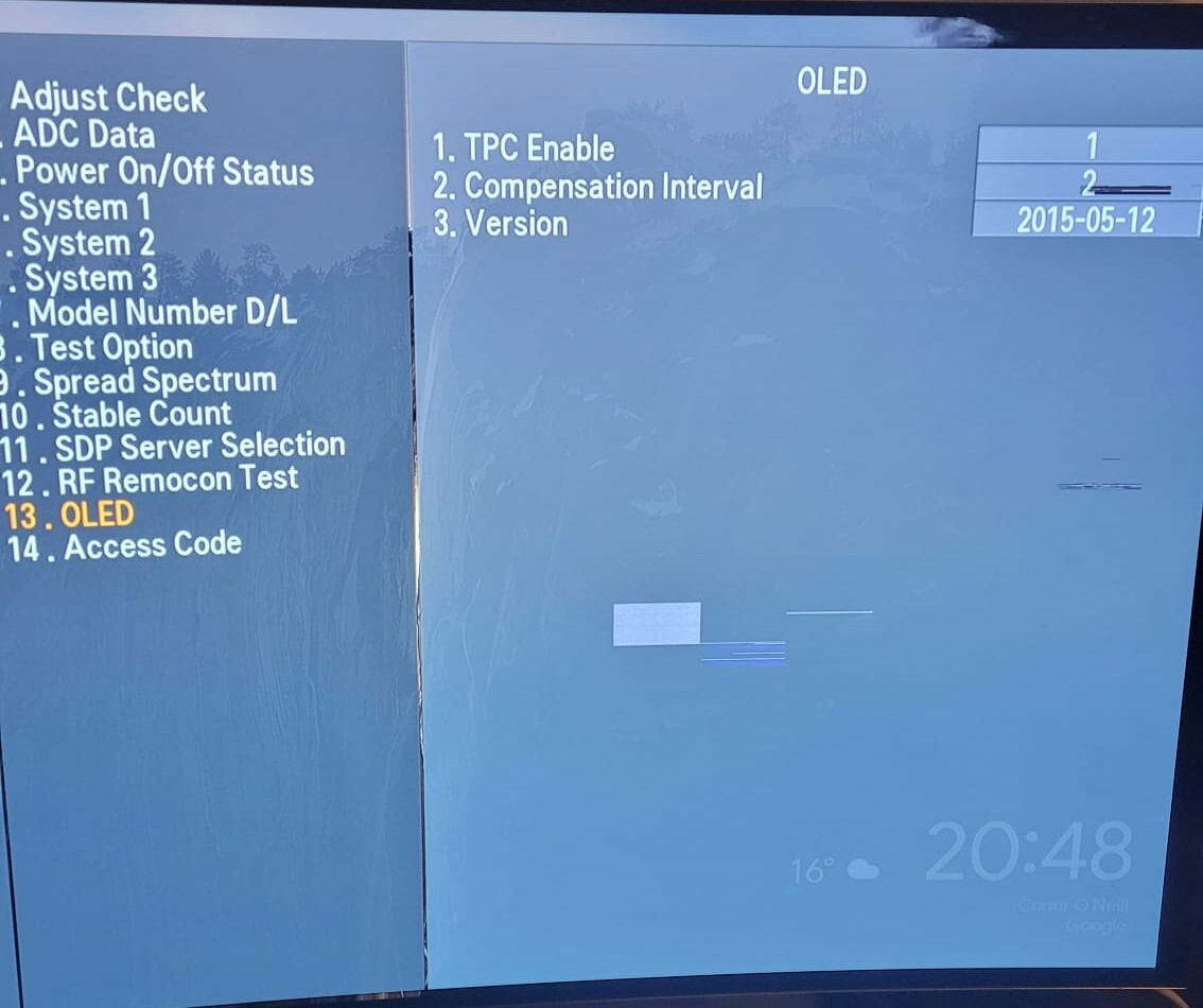

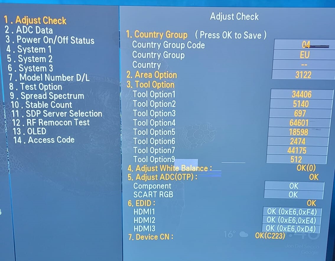

          • Bobby B
            • Apr 2025
            • 15
            • france

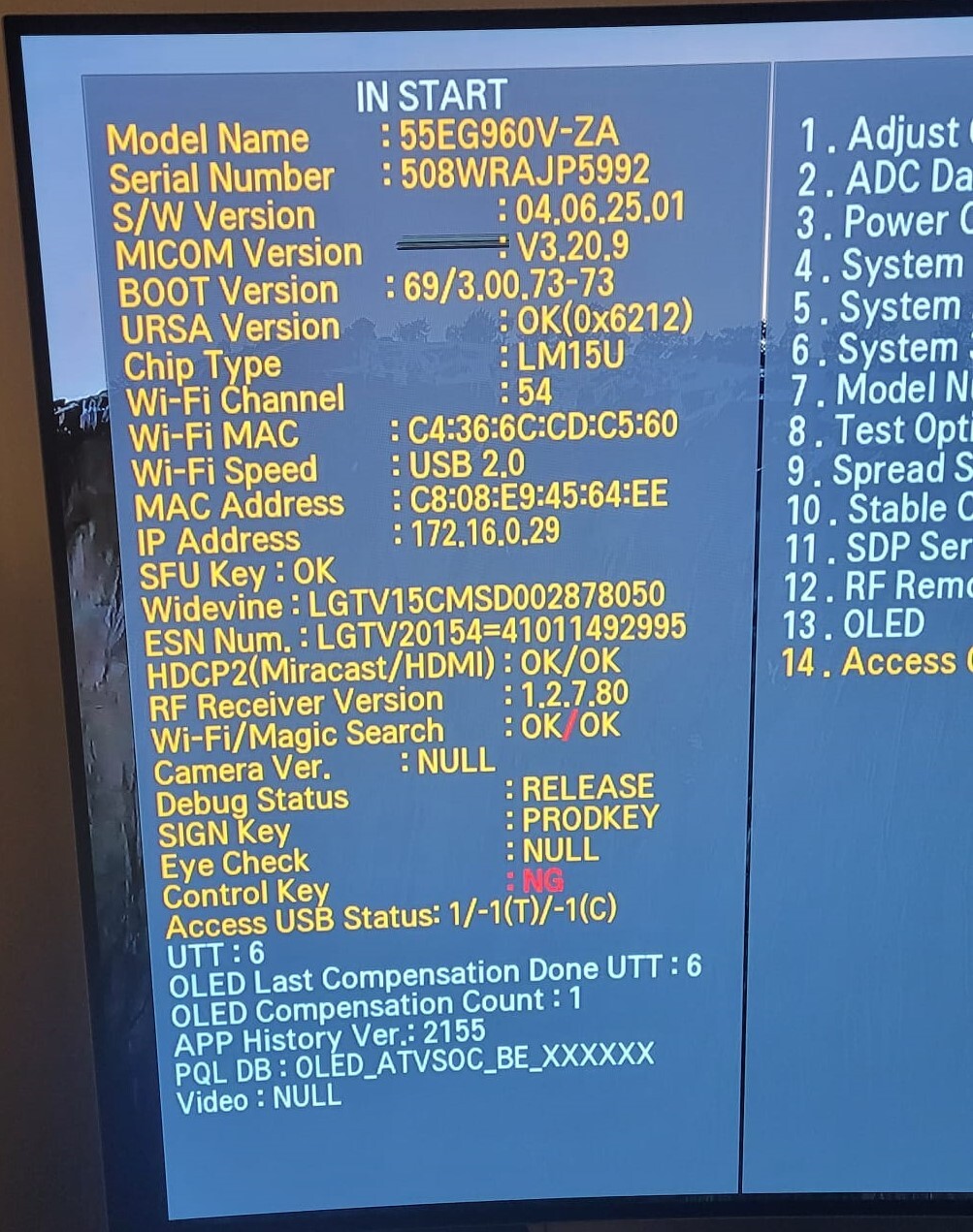

            I changed the ribbons and it's turning on again! The artifacts are still here however.
            Here is what I see in the OLED menu, I am not sure if this what you asked for.Click image for larger version
            • Davi.p
              Hobbist Tech
              • Sep 2009
              • 4529
              • Italy - Milan
              Hi, you need to perform the screen test to see wether is a main board fault (example ram fault) or tcon fault (again ram fault/emmc fault), try to select 8. Test Option and see what it proposes.. depends on test result you can press down the aboves to see what changes, it can even be the main cpu or tcon cpu.. last of the checks is on the el.capacitors from the power board to the rest, especially tcon..

              • Diah
                • Feb 2013
                • 6532
                Here is what I see in the OLED menu, I am not sure if this what you asked for.Click image for larger version  Name:	20250915_225134.jpg Views:	0 Size:	1.80 MB ID:	3725775
                use it as its... time to time do Pixel Refresh , you can count how many time it did via e_Z Adj menu

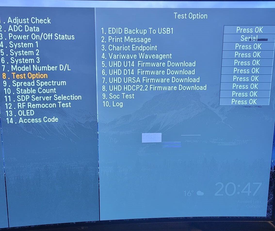

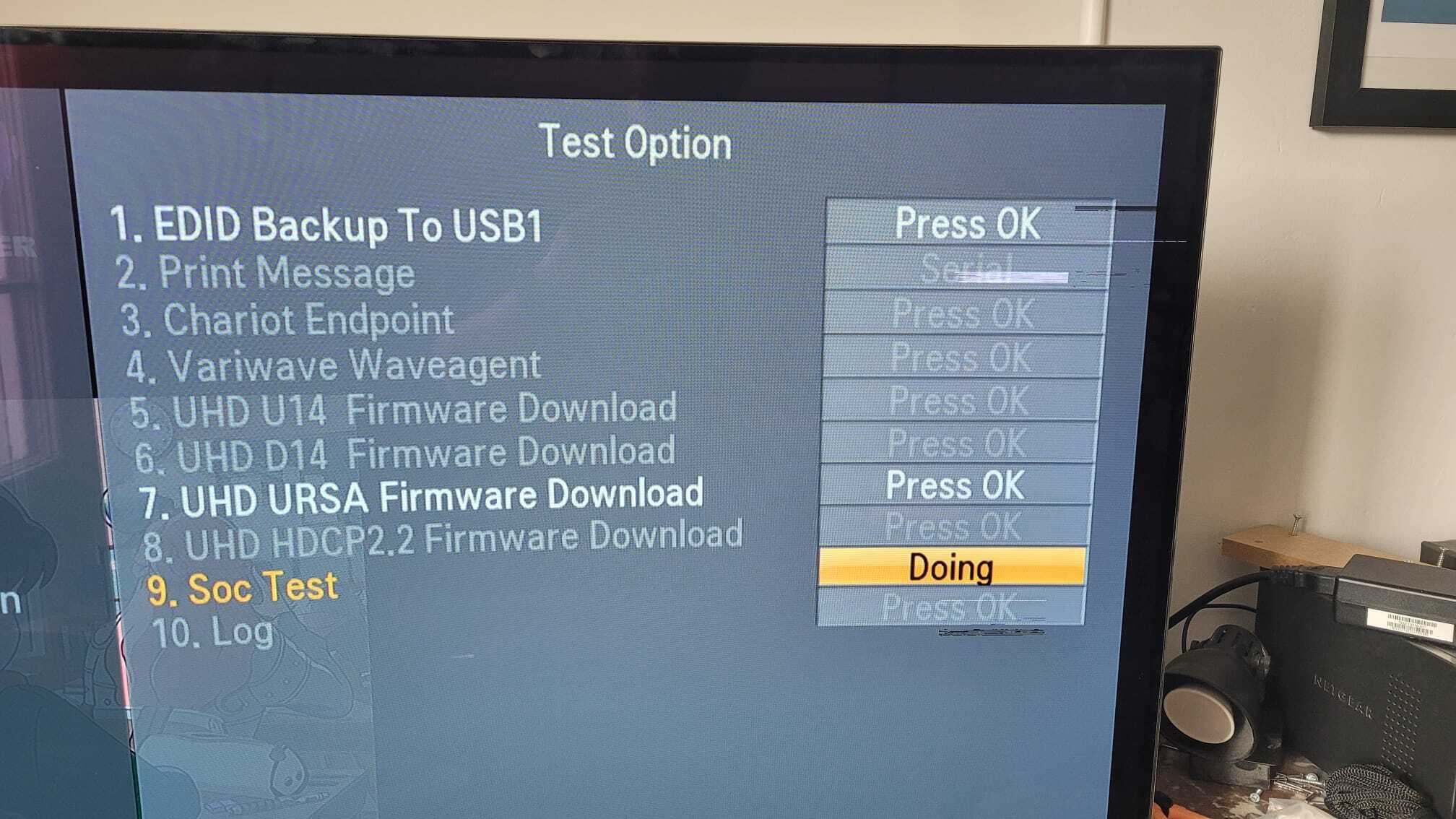

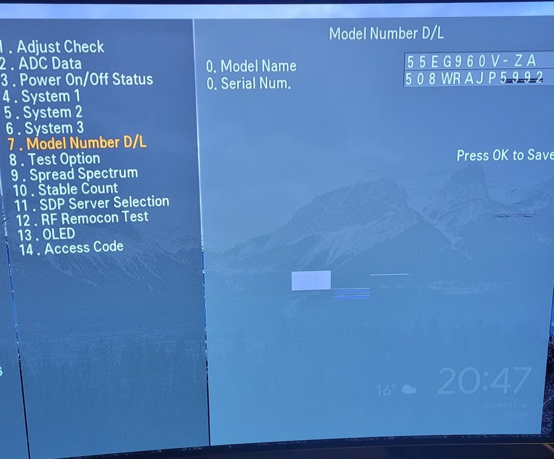

                • Bobby B
                  • Apr 2025
                  • 15
                  • france

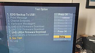

                  There are 2 options to update some firmware.
                  There is also a Soc test. It runs 10-15 min, then the tv turns off by herself.
                  Not a good sign I guess.

                    • Bobby B
                      • Apr 2025
                      • 15
                      • france
                      Correction from my previous post : The TV just go to sleep for inactivity. I put some music on the TV to prevent that, and the test will run more than 1 hour without doing anything. Click image for larger version
Name:	WhatsApp Image 2025-09-16 à 10.32.07_f6d4f90c.jpg
                      • Davi.p
                        Hobbist Tech
                        • Sep 2009
                        • 4529
                        • Italy - Milan

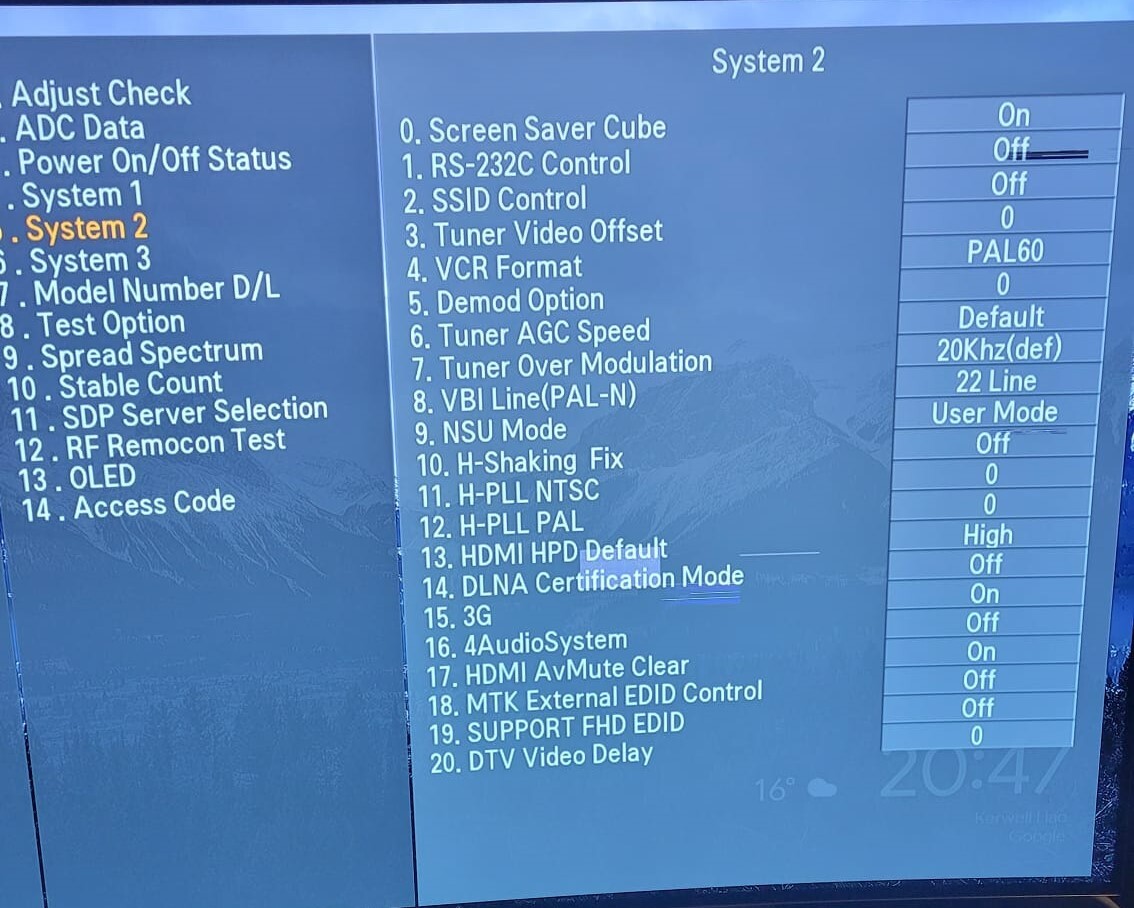

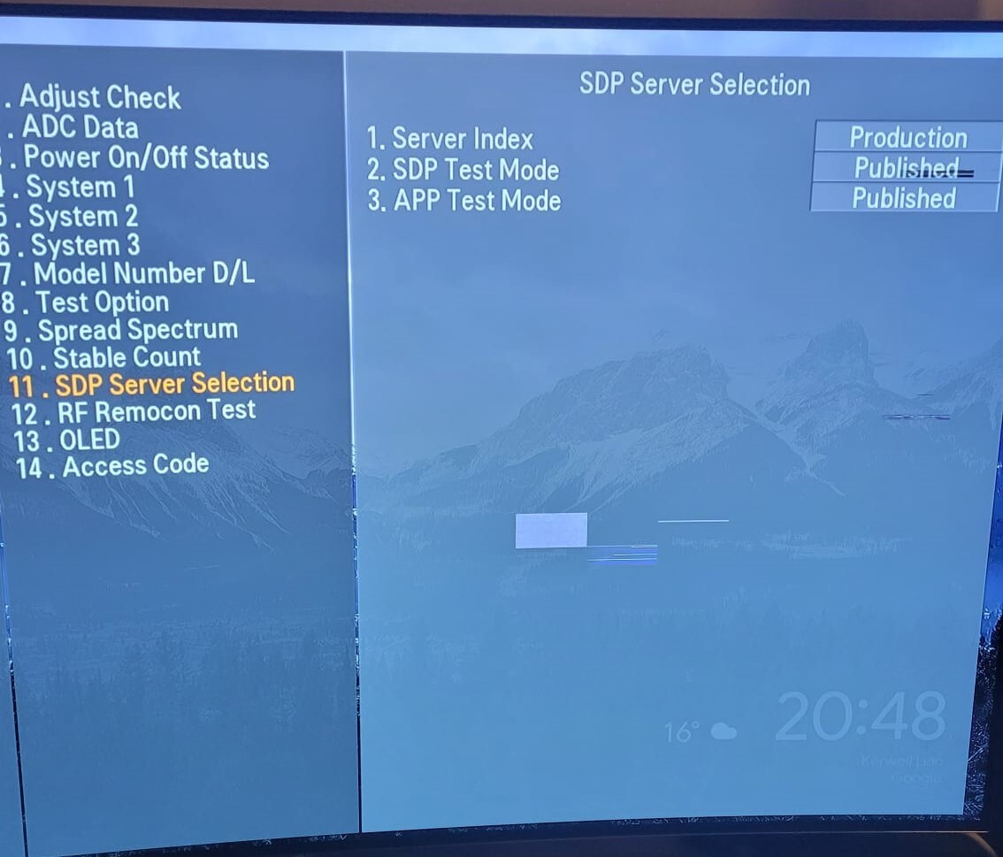

                        If you haven't knowledge BETTER ASK before doing anything in Service Menu, now show me "13. OLED" menu, we are searching for a "Post FRC test" or the like..
                        about the pixel refresh as someone call it or Screen calibration is a self running task, i do not remember but i think it is performed after 2 hours of constant TV turn on, i have to check at home some manuals.. or you can search LG oled discussions here last 1 year.. I guess your donor have runned it long to consider it faulty, so do not expect much it will restore itself.. for the few i know.. the SoC test good is a good news, maybe you'll end buying a less expensive T-con

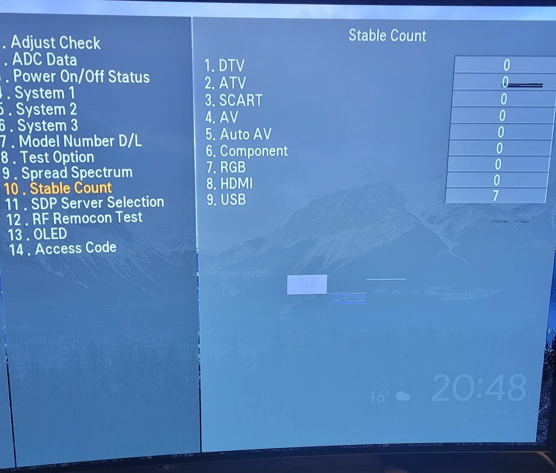

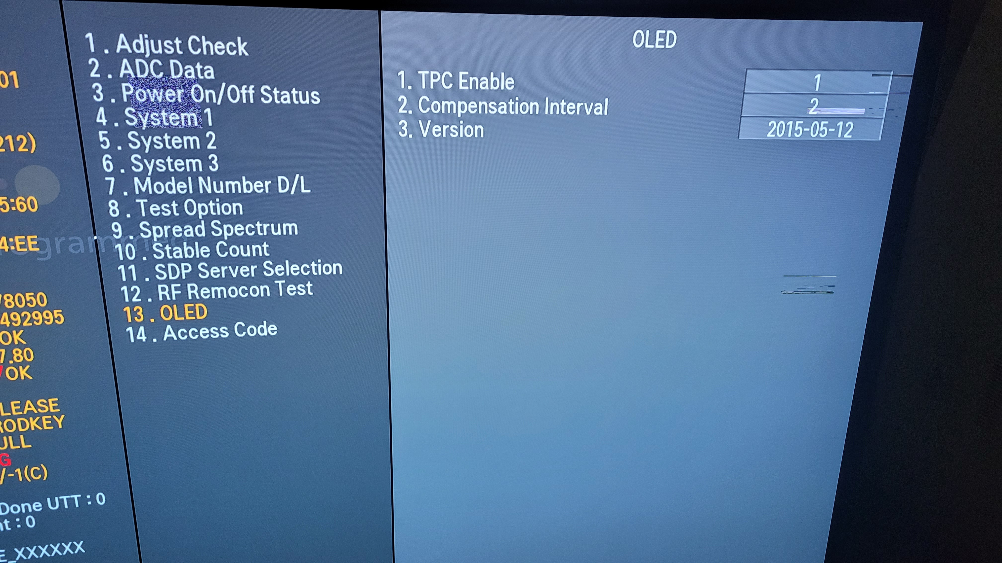

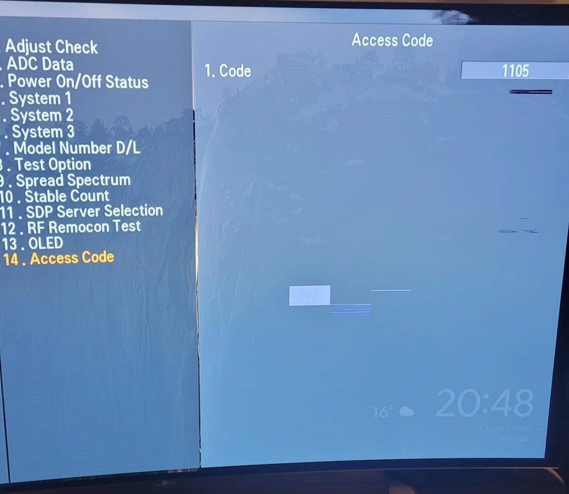

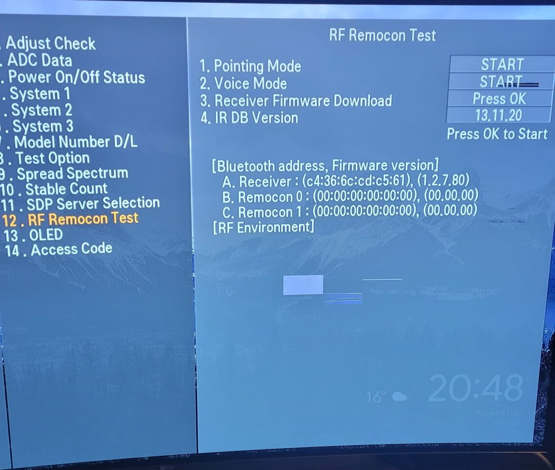

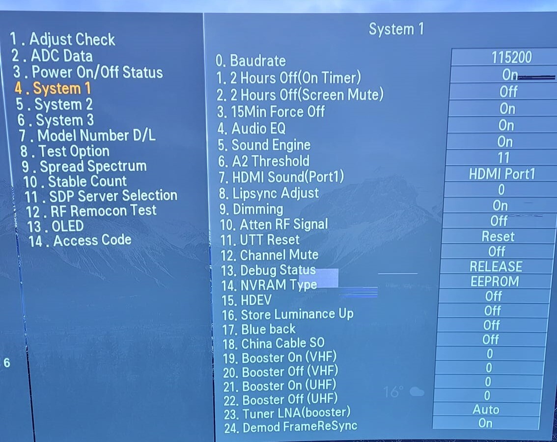

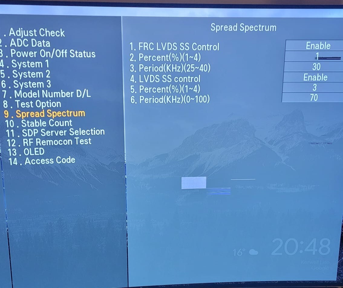

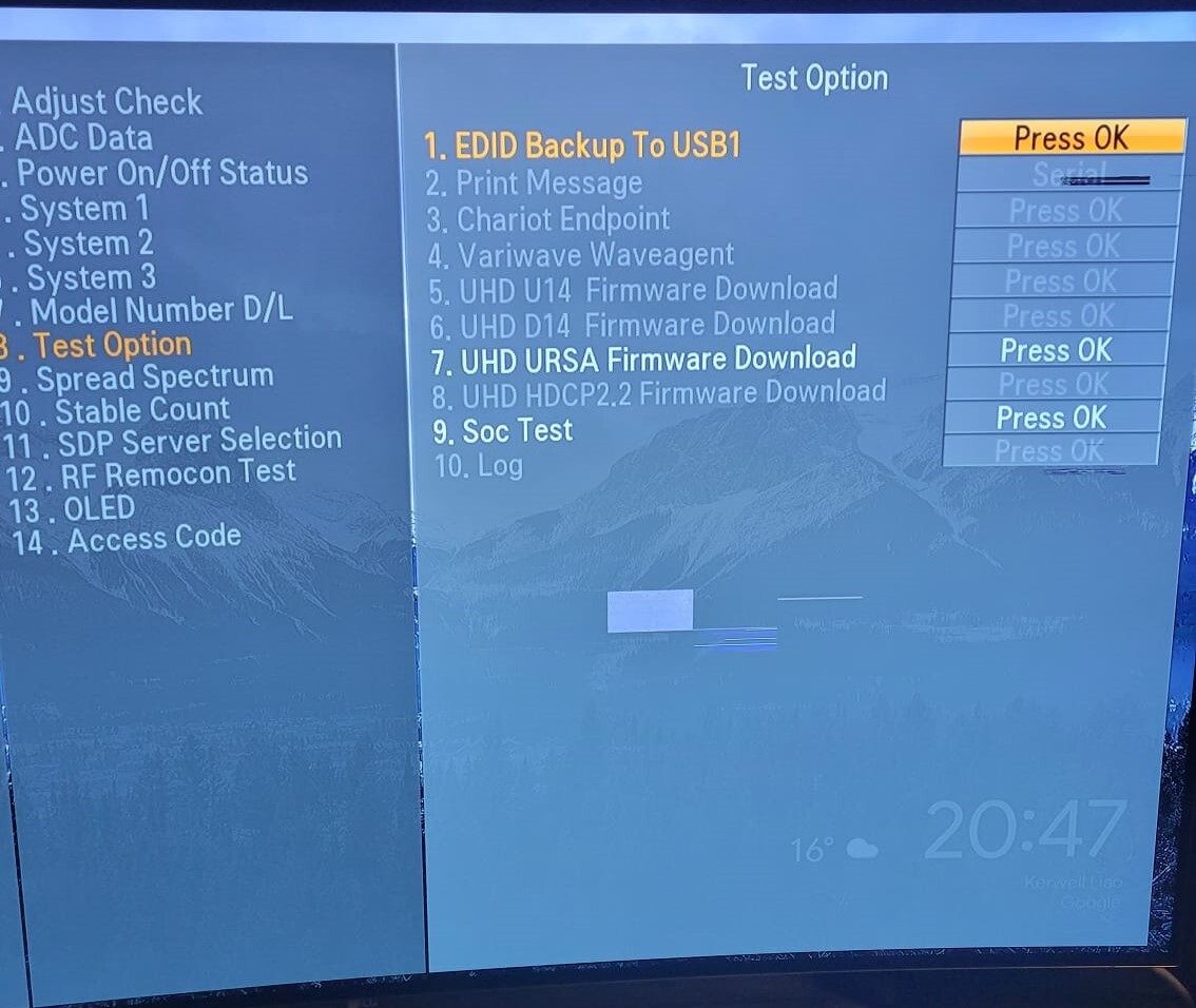

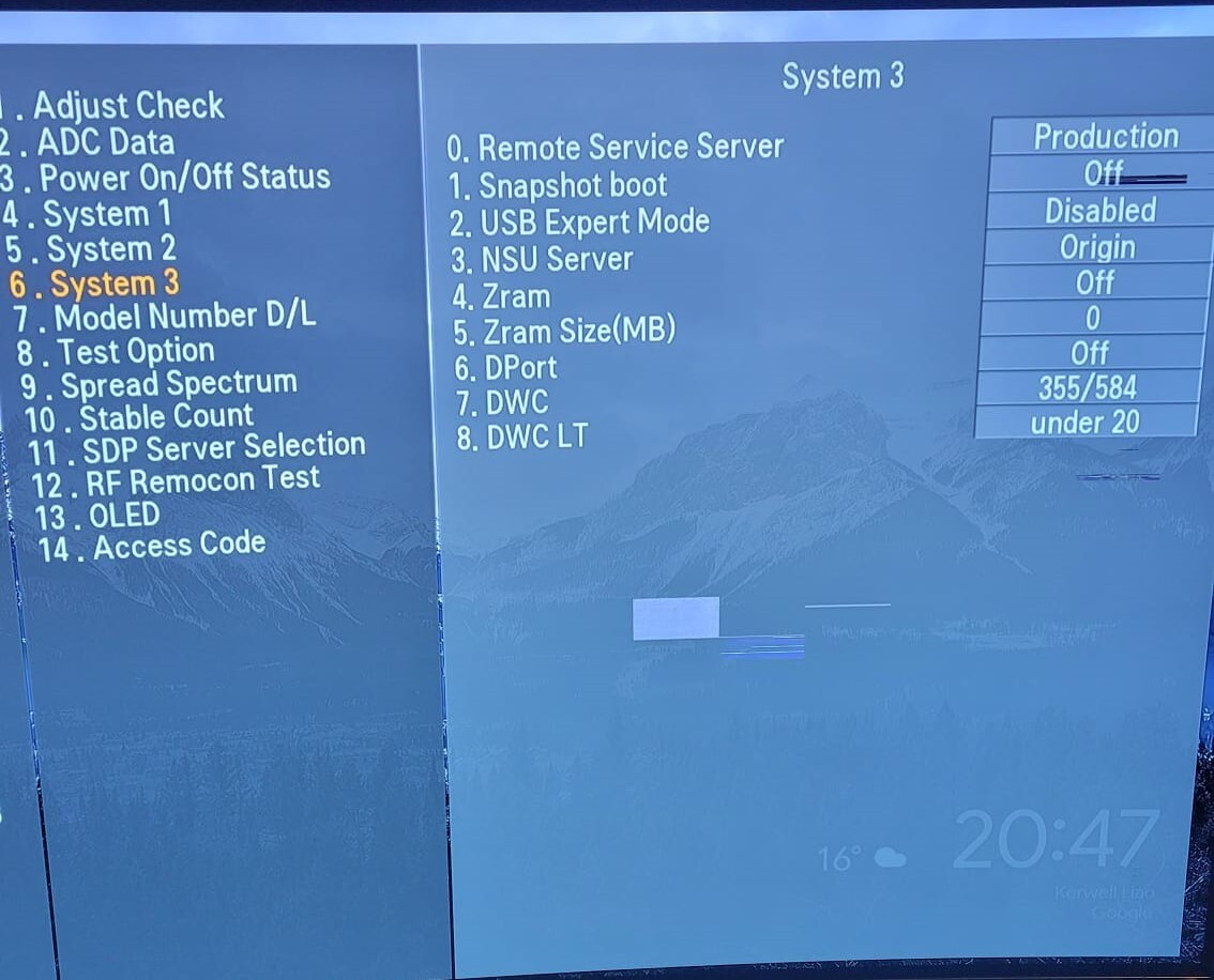

                        • Bobby B
                          • Apr 2025
                          • 15
                          • france
                          I took a picture of each menu. I did not see anything that looks like FRC.
                          I left the TV on for a couple of hours (without any changes) but when I turned it back on, some artefacts had dissappeared and some new ones had appeared. Maybe the pixel refresh was triggered and did something.

                          • Diah
                            • Feb 2013
                            • 6532
                            we have in this forum same model threats where we solved it, so you have 2 option
                            1- as my early post #8
                            2- downgrade the firmware to low version... then upgrade it to last version.., as this set not belong to you... they may changed boards on it.... with this action will be the firmware of MB / MICOM/ and T-CON driver boards same parameter version. search here i did wrote how to downgrade and where to download all LG firmware versions

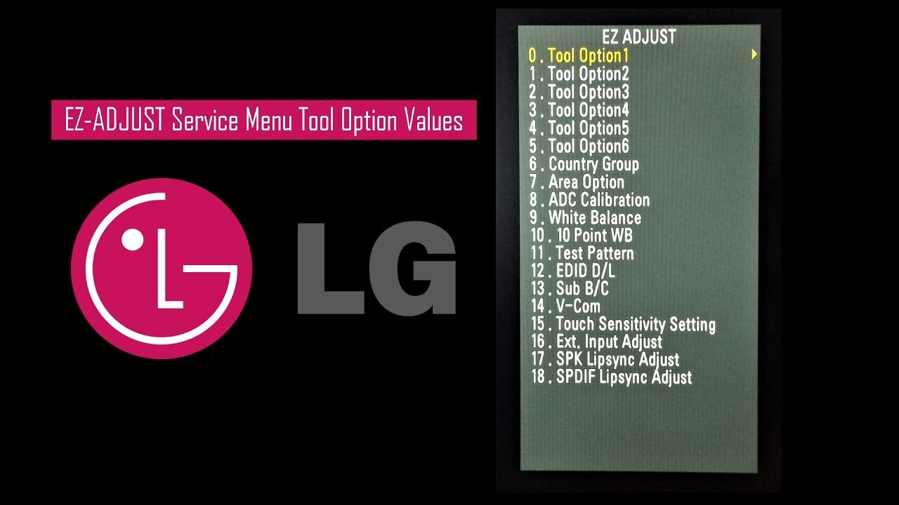

                                  Bobby do not listen to that poor element, their messages are incomprehensible
                                  I saw this image from the internet.. as you can see probably the item Test Patttern like Samsung can lead to screen.test patterns.. plesse ignore that Deutch sir
                                  • Davi.p
                                    Hobbist Tech
                                    • Sep 2009
                                    • 4529
                                    • Italy - Milan
                                    This from a video... the test is very poor, not as Samsung service mode, we don't see if is a pre FRC, post FRC and so on..
                                    if only full colors with no graphics then probably are TCON generated, and this is what we need)
                                    Try to cycle "Pattern Type" otpions and show me..
