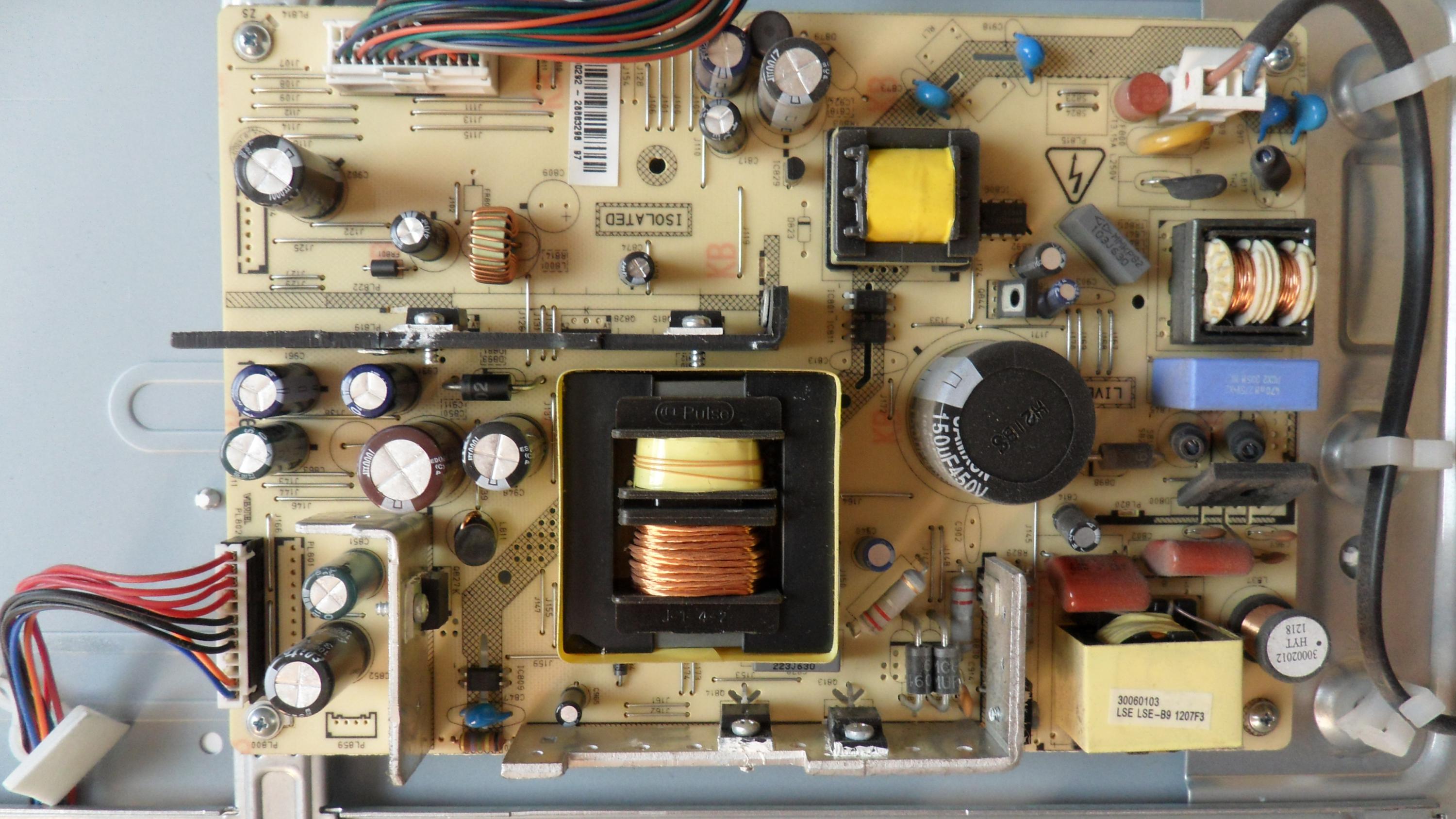

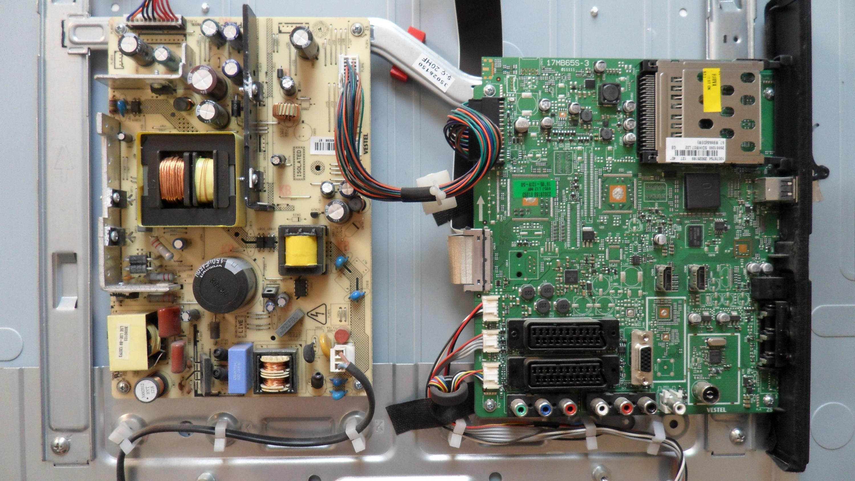

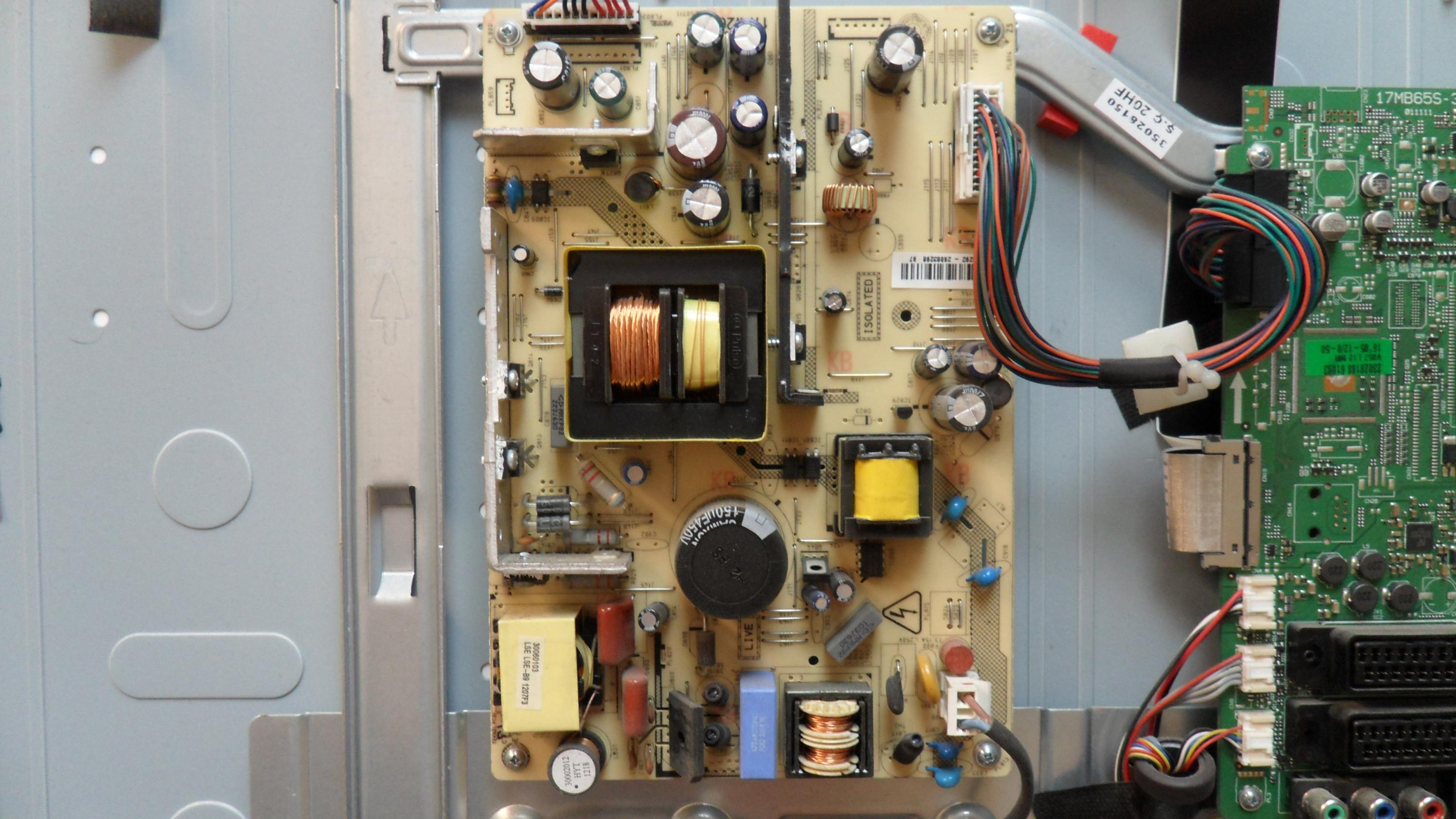

    I have acquired a Polaroid P40LCD12 that stopped working today. The Power LED is just constantly blinking and the tv wont turn on. I removed the back but can not see any indication of voltages on any of the connector points. Can anyone point me in the right direction to a service manual or schematic or help me out with the voltages?
    Power supply model number 17PW26-5

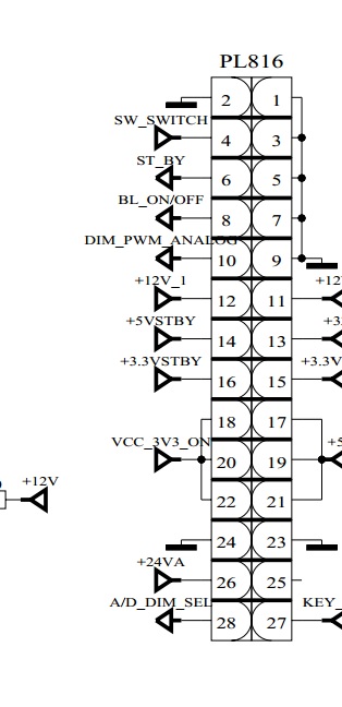

    26-4 is very similar, and this schematic has the voltages on it.
    Set is made by Vestel - so same as Technika, Sanyo, etc.
    Blinking standby light immediately is a protect fault - can be bad firmware or a power supply/main board power supply fault.

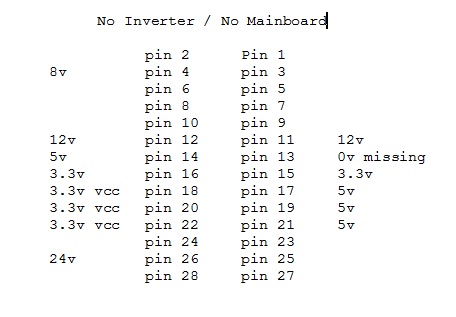

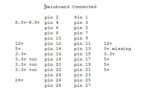

        I've checked voltages from connector PL816 and as soon as I connect the tv to a power outlet voltages are available(see pics) apart from pin13, and this is the same whether I have inverter and mainboard connected or disconnected. Another abnormality is pin 4 SW_SWITCH fluctuates between 8.5v and 8.9v with mainboard connected.
        Any help appreciated

            That voltage is normal for that line. It's a way for the main board to put the PSU in deep sleep. With the voltage high like that it runs normally.
            Problem probably on main board
